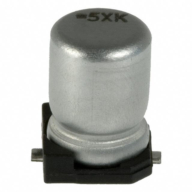

BMVK500ADA1R5MD60G
BMVK500ADA1R5MD60G
    NCC(贵弥功)
    插件
    1.5 µF 50 V 铝电解电容器 径向,Can - SMD 105°C 时为 1000 小时
BMVK500ADA1R5MD60G 数据手册
SURFACE MOUNT ALUMINUM ELECTROLYTIC CAPACITORS Bi-polarized, 105C MVK-BP @Bi-polarized chip type for the circuit, of which polarity is frequently reversed @Solvent-proof type (see PRECAUTIONS AND GUIDELINES) @Pb-free design bi-polarized MVK ?SPECIFICATIONS Items Characteristics Category Temperature Range Rated Voltage Range Capacitance Tolerance Leakage Current Dissipation Factor (tane) Low Temperature Characteristics (Max. Impedance Ratio) Endurance Shelf Life -40 to +105C 6.3 to 50Vdc P20% (M) (at 20C, 120Hz) I=0.05CV or 10MA, whichever is greater. Where, I : Max. leakage current (MA), C : Nominal capacitance (MF), V : Rated voltage (V) (at 20C after 2 minutes) 6.3V 10V 16V 25V 35V 50V Rated voltage (Vdc) 0.35 0.26 0.24 0.20 0.18 0.18 tanE (Max.) (at 20C, 120Hz) 6.3V 10V 16V 25V 35V 50V Rated voltage (Vdc) 2 2 2 2 3 4 Z(-25C)/Z(+20C) 3 3 4 6 8 10 Z(-40C)/Z(+20C) (at 120Hz) The following specifications shall be satisfied when the capacitors are restored to 20C after the rated voltage is applied for 1000 hours at 105C, however the polarization shall be reversed every 250 hours. Capacitance change [P30% of the initial value D.F. (tanE) [300% of the initial specified value Leakage current [The initial specified value The following specifications shall be satisfied when the capacitors are restored to 20C after exposing them for 500 hours at 105C without voltage applied. Capacitance change [P25% of the initial value D.F. (tanE) [200% of the initial specified value Leakage current [The initial specified value ?PART NUMBERING SYSTEM ?DIMENSIONS [mm] 1 3 4 5 6 7 8 9 10 BP0.2 W AP0.2 LP0.3 L 5.7 5.7 5.7 A 4.3 5.3 6.6 12 13 14 15 16 ?MARKING 17 18 B 4.3 5.3 6.6 C 5.1 5.9 7.2 W 0.5 to 0.8 0.5 to 0.8 0.5 to 0.8 EX) 35V4.7MF Supplement code Size code Capacitance tolerance code Capacitance code (ex. 4.7MF:4R7,10MF:100) Taping code Terminal code Voltage code (ex. 6.3V:6R3,10V:100,50V:500) Series code Category P CP0.2 0.3max. Size code D 4 D60 5 E60 6.3 F60 11 B MV K AAA A DA AAA M AAA G @Terminal Code : A FDP0.5 2 P 1.0 1.4 1.9 94K 4.7 35V Please refer to "A guide to global code (surface mount type)" ?STANDARD RATINGS WV (Vdc) 6.3 10 16 25 35 Cap (mF) Size code tane Rated ripple current (mArms/ 105c,120Hz) 10 22 47 6.8 15 33 4.7 10 22 3.3 6.8 15 2.2 4.7 10 D60 E60 F60 D60 E60 F60 D60 E60 F60 D60 E60 F60 D60 E60 F60 0.35 0.35 0.35 0.26 0.26 0.26 0.24 0.24 0.24 0.20 0.20 0.20 0.18 0.18 0.18 14 25 39 13 22 35 12 20 32 10 17 28 8.8 15 23 WV (Vdc) Part No. BMVK6R3ADA100MD60G BMVK6R3ADA220ME60G BMVK6R3ADA470MF60G BMVK100ADA6R8MD60G BMVK100ADA150ME60G BMVK100ADA330MF60G BMVK160ADA4R7MD60G BMVK160ADA100ME60G BMVK160ADA220MF60G BMVK250ADA3R3MD60G BMVK250ADA6R8ME60G BMVK250ADA150MF60G BMVK350ADA2R2MD60G BMVK350ADA4R7ME60G BMVK350ADA100MF60G 50 (1/1) Cap (mF) 0.10 0.15 0.22 0.33 0.47 0.68 1.0 1.5 2.2 3.3 4.7 6.8 Size code tane Rated ripple current (mArms/ 105c,120Hz) D60 D60 D60 D60 D60 D60 D60 D60 E60 E60 F60 F60 0.18 0.18 0.18 0.18 0.18 0.18 0.18 0.18 0.18 0.18 0.18 0.18 1.3 1.9 2.3 2.8 3.4 4.1 5.5 7.5 10 13 16 20 Part No. BMVK500ADAR10MD60G BMVK500ADAR15MD60G BMVK500ADAR22MD60G BMVK500ADAR33MD60G BMVK500ADAR47MD60G BMVK500ADAR68MD60G BMVK500ADA1R0MD60G BMVK500ADA1R5MD60G BMVK500ADA2R2ME60G BMVK500ADA3R3ME60G BMVK500ADA4R7MF60G BMVK500ADA6R8MF60G CAT. No. E1001E
