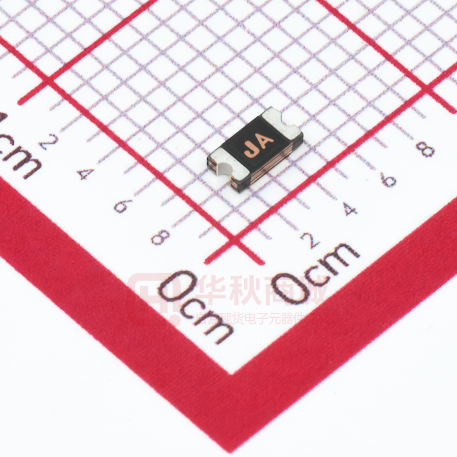

    PTC自恢复保险丝 1206 48VDC I=100A Pd=600mW
ASMD1206-020-48V 数据手册
PRODUCT DATASHEET Surface Mount PTC Devices ASMD1206 Series Surface Mount PTC Devices ASMD1206 Series Surface Mount PTC Devices Description The ASMD1206 series provides miniature surface mount overcurrent protection with holding current from 0.05A to 3.5A. This series is suitable for wide range of applications in modern electronics where space is limited. Features ● RoHS compliant and lead-free ● Low profile ● Halogen-free ● Fast response to fault current ● Compact design saves board space ● Compatible with high temperature solders Agency Approvals Agency Applications File Number E472196 ● Battery PCM ● Game console port protection ● USB hubs, ports and peripherals ● Optical disk drives ● Set-top-box and HDMI ● General electronics Regulation Standard 2002/95/EC EN14582 JDT Fuse Industrial Co., Ltd www.jdtfuse.com Page 1/8 Revised 04/02/20 ASMD1206 Series Surface Mount PTC Devices Performance Specification Model V max (V dc) I max (A) I hold I trip Pd @25°C (A) @25°C (A) Typ. (W) Maximum Time To Trip Resistance Current (A) Time (Sec) R i min R1max (Ω) (Ω) ASMD1206-005 60.0 100 0.05 0.15 0.4 0.25 1.5 3.60 50 ASMD1206-005-24V 24.0 100 0.05 0.15 0.4 0.25 1.5 3.60 50 ASMD1206-010 60.0 100 0.1 0.25 0.4 0.5 1.0 1.60 15 ASMD1206-010-24V 24.0 100 0.1 0.25 0.4 0.5 1.0 1.60 15 ASMD1206-012 60.0 100 0.12 0.29 0.4 0.5 1.0 1.60 15 ASMD1206-012-24V 24.0 100 0.12 0.29 0.4 0.5 1.0 1.60 15 ASMD1206-016 16.0 100 0.16 0.37 0.4 1.0 0.3 1.00 6.0 ASMD1206-016-24V 24.0 100 0.16 0.37 0.4 1.0 0.3 1.00 6.0 ASMD1206-016-33V 33.0 100 0.16 0.37 0.4 1.0 0.3 1.00 6.0 ASMD1206-020 24.0 100 0.2 0.46 0.6 8.0 0.08 0.35 3.5 ASMD1206-020-30V 30.0 100 0.2 0.46 0.6 8.0 0.08 0.35 3.5 ASMD1206-020-48V 48.0 100 0.2 0.46 0.6 8.0 0.08 0.35 3.5 ASMD1206-025 16.0 100 0.25 0.5 0.6 8.0 0.08 0.35 2.7 ASMD1206-025-24V 24.0 100 0.25 0.5 0.6 8.0 0.08 0.35 2.7 ASMD1206-025-30V 30.0 100 0.25 0.5 0.6 8.0 0.08 0.35 2.7 ASMD1206-025-48V 48.0 100 0.25 0.5 0.6 8.0 0.08 0.35 2.7 ASMD1206-035 6.0 100 0.35 0.75 0.6 8.0 0.1 0.25 1.5 ASMD1206-035-16V 16.0 100 0.35 0.75 0.6 8.0 0.1 0.25 1.5 ASMD1206-035-30V 30.0 100 0.35 0.75 0.6 8.0 0.1 0.25 1.5 ASMD1206-050 6.0 100 0.5 1.0 0.6 8.0 0.1 0.15 0.7 ASMD1206-050-13.2V 13.2 100 0.5 1.0 0.6 8.0 0.1 0.15 0.7 ASMD1206-050-16V 16.0 100 0.5 1.0 0.6 8.0 0.1 0.15 0.7 ASMD1206-050-30V 30.0 100 0.5 1.0 0.6 8.0 0.1 0.15 0.7 ASMD1206-075 6.0 100 0.75 1.5 0.6 8.0 0.2 0.09 0.5 ASMD1206-075-16V 16.0 100 0.75 1.5 0.6 8.0 0.2 0.09 0.5 ASMD1206-075-30V 30.0 100 0.75 1.5 0.6 8.0 0.2 0.09 0.5 ASMD1206-100 6.0 100 1.0 1.8 0.6 8.0 0.3 0.05 0.27 ASMD1206-100-16V 16.0 100 1.0 1.8 0.6 8.0 0.3 0.05 0.27 ASMD1206-100-24V 24.0 100 1.0 1.8 0.6 8.0 0.3 0.05 0.27 ASMD1206-110 6.0 100 1.1 2.2 0.6 8.0 0.3 0.04 0.25 ASMD1206-110-16V 16.0 100 1.1 2.2 0.6 8.0 0.3 0.04 0.25 ASMD1206-110-24V 24.0 100 1.1 2.2 0.6 8.0 0.3 0.04 0.25 ASMD1206-150 6.0 100 1.5 3.0 0.8 8.0 0.3 0.025 0.13 ASMD1206-150-13.2V 13.2 100 1.5 3.0 0.8 8.0 0.3 0.025 0.13 ASMD1206-200 6.0 100 2.0 3.5 0.8 8.0 1.5 0.015 0.08 ASMD1206-200-12V 12.0 100 2.0 3.5 0.8 8.0 1.5 0.015 0.08 ASMD1206-200-16V 16.0 100 2.0 3.5 0.8 8.0 1.5 0.015 0.08 ASMD1206-260 6.0 100 2.6 5.2 0.8 8.0 2.0 0.01 0.06 ASMD1206-300 6.0 100 3.0 6.0 1.0 8.0 4.0 0.01 0.05 ASMD1206-350 6.0 100 3.5 7.0 1.2 10.0 5.0 0.005 0.04 JDT Fuse Industrial Co., Ltd www.jdtfuse.com Page 2/8 Revised 04/02/20 ASMD1206 Series Surface Mount PTC Devices I hold = Hold Current. Maximum current device will not trip in 25°C still air. I trip = Trip Current. Minimum current at which the device will always trip in 25°C still air. V max = Maximum operating voltage device can withstand without damage at rated current (Imax). I max = Maximum fault current device can withstand without damage at rated voltage (V max). = Power dissipation when device is in the tripped state in 25°C still air environment at rated voltage. Pd Ri min/max = Minimum/Maximum device resistance prior to tripping at 25°C. R1max = Maximum device resistance is measured one hour post reflow. CAUTION : Operation beyond the specified ratings may result in damage and possible arcing and flame. Environmental Specifications Conditions Test Resistance change Passive aging +85°C, 1000 hrs. ±5% typical Humidity aging +85°C, 85% R.H. , 168 hours ±5% typical Thermal shock +85°C to -40°C, 20 times ±33% typical Resistance to solvent MIL-STD-202,Method 215 No change Vibration MIL-STD-202,Method 201 No change   Ambient operating conditions : - 40 °C to +85 °C Maximum surface temperature of the device in the tripped state is 125 °C Thermal Derating Curve Percentage of Derated Current Derating Curves for ASMD1206 Series 160 140 120 100 80 60 40 20 0 -40 -20 0 20 40 60 80 Temperature (°C ) JDT Fuse Industrial Co., Ltd www.jdtfuse.com Page 3/8 Revised 04/02/20 ASMD1206 Series Surface Mount PTC Devices Average Time-Current Curve 3.5 3.0 2.6 2.5 2.0 1.5 1.0 1.1 A 750 500 350 250 160 200 125 100 100 50 mA TIME IN SECONDS 10 1 0.1 0.01 0.10 1 10 CURRENT IN AMPERES Thermal Derading Chart Model Maximum ambient operating temperature (Tmao) vs. hold current (Ihold) - 40°C - 20°C 0°C 25°C 40°C 50°C 60°C 70°C 85°C ASMD1206-005 0.074 0.066 0.058 0.05 0.0425 0.0375 0.035 0.03 0.0275 ASMD1206-010 0.148 0.132 0.116 0.10 0.085 0.075 0.07 0.06 0.055 ASMD1206-012 0.18 0.16 0.14 0.12 0.10 0.09 0.08 0.07 0.07 ASMD1206-016 0.24 0.21 0.18 0.16 0.14 0.13 0.12 0.11 0.10 ASMD1206-020 0.30 0.26 0.23 0.20 0.17 0.15 0.14 0.12 0.11 ASMD1206-025 0.37 0.33 0.29 0.25 0.22 0.20 0.17 0.15 0.12 ASMD1206-035 0.50 0.45 0.40 0.35 0.30 0.27 0.24 0.21 0.15 ASMD1206-050 0.71 0.64 0.57 0.50 0.42 0.39 0.35 0.31 0.25 ASMD1206-075 1.14 1.01 0.88 0.75 0.65 0.59 0.54 0.49 0.41 ASMD1206-100 1.45 1.31 1.15 1.00 0.84 0.77 0.69 0.61 0.48 ASMD1206-110 1.60 1.45 1.30 1.10 0.95 0.80 0.72 0.66 0.55 ASMD1206-150 2.18 1.94 1.72 1.50 1.28 1.17 1.06 0.96 0.77 ASMD1206-200 2.88 2.63 2.34 2.00 1.74 1.58 1.42 1.17 0.93 ASMD1206-260 3.43 3.22 2.93 2.60 2.23 2.03 1.87 1.57 1.35 ASMD1206-300 4.05 3.66 3.36 3.00 2.50 2.28 2.00 1.62 1.35 ASMD1206-350 4.65 4.23 3.92 3.50 2.92 2.68 2.35 1.91 1.42 JDT Fuse Industrial Co., Ltd www.jdtfuse.com Page 4/8 Revised 04/02/20 ASMD1206 Series Surface Mount PTC Devices Soldering Parameters TP 20~40 S TP 260 Ramp-up Profile Feature Critical Zone TL to TP TL 217 tL Tsmax Temperature (°C ) Preheat Tsmin Ramp-down ts Preheat 60~180 s 25 3℃/second max. (Ts max to T p) 60~150 s 200 150 Average Ramp-Up Rate Pb-Free Assembly -Temperature Min(Ts min) 150℃ -Temperature Max(Ts max) 200℃ -Time(Ts min to Ts max) 60~180 seconds Time maintained above: t 25°C to peak Time Recommended reflow methods: IR, vapor phase oven, hot air oven, N2 environment for lead-free Recommended maximum paste thickness is 0.25mm Devices can be cleaned using standard industry methods and solvents. Note 1:All temperature refer to topside of the package, measured on the package body surface. Note 2: If reflow temperatures exceed the recommended profile, devices may not meet the performance requirements. -Temperature(TL) 217℃ -Time(tL) 60~150 seconds Peak Temperature(Tp) 260℃ Ramp-Down Rate 6℃/second max. Time 25℃ to Peak Temperature 8 minutes max Storage Condition 0℃~35℃,≤70%RH Physical Dimensions(mm.) JDT Fuse Industrial Co., Ltd www.jdtfuse.com Page 5/8 Revised 04/02/20 ASMD1206 Series Surface Mount PTC Devices A Model B C D E Min. Max. Min. Max. Min. Max. Min. Min. ASMD1206-005 3.0 3.6 1.5 1.9 0.6 1.2 0.15 0.1 ASMD1206-010 3.0 3.6 1.5 1.9 0.6 1.2 0.15 0.1 ASMD1206-012 3.0 3.6 1.5 1.9 0.6 1.2 0.15 0.1 ASMD1206-016 3.0 3.6 1.5 1.9 0.4 1.0 0.15 0.1 ASMD1206-020 3.0 3.6 1.5 1.9 0.4 1.0 0.15 0.1 ASMD1206-020-30V 3.0 3.6 1.5 1.9 0.4 1.0 0.15 0.1 ASMD1206-020-48V 3.0 3.6 1.5 1.9 0.4 1.0 0.15 0.1 ASMD1206-025 3.0 3.6 1.5 1.9 0.4 1.0 0.15 0.1 ASMD1206-025-30V 3.0 3.6 1.5 1.9 0.4 1.0 0.15 0.1 ASMD1206-025-48V 3.0 3.6 1.5 1.9 0.4 1.0 0.15 0.1 ASMD1206-035 3.0 3.6 1.5 1.9 0.35 0.8 0.15 0.1 ASMD1206-035-16V 3.0 3.6 1.5 1.9 0.35 0.8 0.15 0.1 ASMD1206-035-30V 3.0 3.6 1.5 1.9 0.4 0.9 0.15 0.1 ASMD1206-050 3.0 3.6 1.5 1.9 0.35 0.8 0.15 0.1 ASMD1206-050-13.2V 3.0 3.6 1.5 1.9 0.35 0.8 0.15 0.1 ASMD1206-050-16V 3.0 3.6 1.5 1.9 0.35 0.8 0.15 0.1 ASMD1206-050-30V 3.0 3.6 1.5 1.9 0.5 1.0 0.15 0.1 ASMD1206-075 3.0 3.6 1.5 1.9 0.35 0.8 0.15 0.1 ASMD1206-075-16V 3.0 3.6 1.5 1.9 0.5 1.0 0.15 0.1 ASMD1206-075-30V 3.0 3.6 1.5 1.9 0.5 1.0 0.15 0.1 ASMD1206-100 3.0 3.6 1.5 1.9 0.35 0.8 0.15 0.1 ASMD1206-100-16V 3.0 3.6 1.5 1.9 0.5 1.0 0.15 0.1 ASMD1206-100-24V 3.0 3.6 1.5 1.9 0.5 1.0 0.15 0.1 ASMD1206-110 3.0 3.6 1.5 1.9 0.35 0.8 0.15 0.1 ASMD1206-110-16V 3.0 3.6 1.5 1.9 0.5 1.0 0.15 0.1 ASMD1206-110-24V 3.0 3.6 1.5 1.9 0.5 1.0 0.15 0.1 ASMD1206-150 3.0 3.6 1.5 1.9 0.5 1.0 0.15 0.1 ASMD1206-150-13.2V 3.0 3.6 1.5 1.9 1.0 1.6 0.15 0.1 ASMD1206-200 3.0 3.6 1.5 1.9 0.7 1.6 0.15 0.1 ASMD1206-200-12V 3.0 3.6 1.5 1.9 0.7 1.6 0.15 0.1 ASMD1206-200-16V 3.0 3.6 1.5 1.9 0.7 1.6 0.15 0.1 ASMD1206-260 3.0 3.6 1.5 1.9 1.0 1.6 0.15 0.1 ASMD1206-300 3.0 3.6 1.5 1.9 1.0 1.6 0.15 0.1 ASMD1206-350 3.0 3.5 1.5 1.9 1.0 1.6 0.15 0.1 Termination Pad Characteristics Terminal pad materials:Tin-plated Nickel-Copper Terminal pad solder ability:Meets EIA specification RS186-9E and ANSI/J-STD-002 Category 3 JDT Fuse Industrial Co., Ltd www.jdtfuse.com Page 6/8 Revised 04/02/20 ASMD1206 Series Surface Mount PTC Devices Packaging Quantity and Marking 2.0±0.1 Part Number 1.9±0.1 Quantity ASMD1206 3500 pcs/reel Tape & reel packaging per EIA481-1 1.0±0.1 1.0±0.1 Tape And Reel Specifications (mm) Governing Specifications EIA 481-1 W 8.15 ± 0.3 P0 4.0 ± 0.10 P1 4.0 ± 0.10 P2 2.0 ± 0.05 A0 1.95 ± 0.10 B0 3.40 ± 0.10 B1max. 4.35 D0 1.50 + 0.1, -0 F 3.5 ± 0.05 E1 1.75 ± 0.10 E2min. 6.25 T 0.6 T1max. 0.1 K0 1.04 ± 0.1 Leader min. 390 Trailer min. 160 Reel Dimensions   A max. 178 N min. 60 W1 9 ± 0.5 W2 12.6 ± 0.5 Storage And Handling ● Storage conditions:40°C max, 70% R.H. ● Devices may not meet specified performance if storage conditions are exceeded.Technology Corp. JDT Fuse Industrial Co., Ltd www.jdtfuse.com P1 P2 D0 P0 E1 F W T D2 K0 A0 B0 H W4 W3 D C W2 W F W1 H1 Page 7/8 Revised 04/02/20 ASMD1206 Series Surface Mount PTC Devices Part Number System ASMD 1206 - Special Voltage Rating(Optional) Holding Current Rating Device Dimensions: Length/width(Unit:1/100 inch) Size 3216 mm / 1206 inch Surface Mount Device Cross Reference Cross Reference Model Tyco / PolySwitch® Littelfuse / POLY-FUSE® Polytronics / EVERFUSE® ASMD1206-005 - - - ASMD1206-010 - - - ASMD1206-012 nanoSMDC012F 1206L012 SMD1206P012TF ASMD1206-020 nanoSMDC020F 1206L020 SMD1206P020TF/24 ASMD1206-025 - 1206L025 SMD1206P025TF ASMD1206-035 nanoSMDC035F 1206L035 -SMD1206P035TF ASMD1206-050 nanoSMDC050F 1206L050 SMD1206P050TF ASMD1206-050-13.2V nanoSMDC050F/13.2 1206L050/15 SMD1206P050TF/15 ASMD1206-075 nanoSMDC075F 1206L075 SMD1206P075TF ASMD1206-075-16V nanoSMDC075F/16 1206L075/16 SMD1206P075TF/16 ASMD1206-100 - - - ASMD1206-110 nanoSMDC110F 1206L110 SMD1206P110TF ASMD1206-150 nanoSMDC150F 1206L150 SMD1206P150TF ASMD1206-200 nanoSMDC200F 1206L200 SMD1206P200TF “PolySwitch” is a registered trademark of Tyco Electronics. “POLY-FUSE” is a registered trademark of Littelfuse,Inc. “EVERFUSE” is a registered trademark of Polytronics Technology Corp. JDT Fuse Industrial Co., Ltd www.jdtfuse.com Page 8/8 Revised 04/02/20
