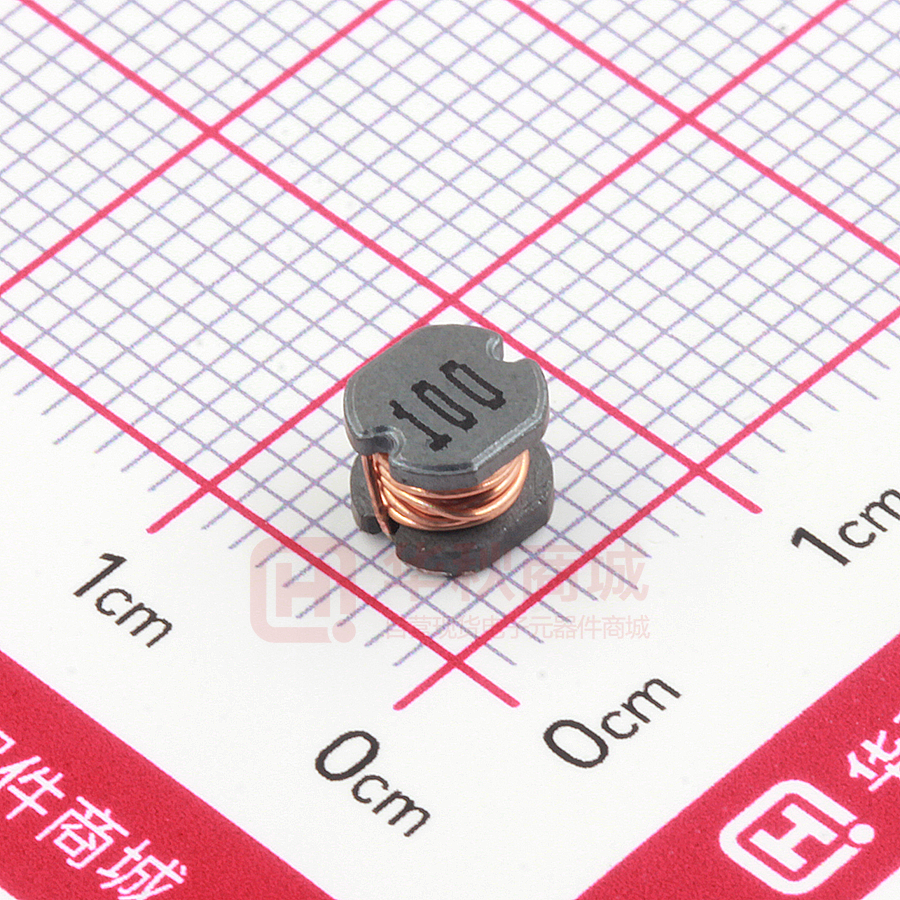

    SMD,5.8x5.2mm
    功率电感 10μH ±10% 1.42A 87.9mΩ IND_5.8X5.2MM_SM 4.50mm 5.80 x 5.20mm
CY54-10UH 数据手册
深圳市首韩科技有限公司 SHENZHEN SHOUHAN TECHNOLOGYCO.,LTD Tel: 0755-27597601 Fax: 0755-27597491 承 认 书 产品名称 Project: 贴片电感 科 规格型号 Part No: 有 户 Customer: 技 客 限 公 司 SPECIFICATION FOR APPROVAL 韩 CY54-10UH 首 贵公司承认印 Approal slgnatures 签 章/Signatures 深 圳 市 料 号/Part No. 日期 Date: 拟制/Drawn 李春风 审核/Check 钟华华 批准/Approved 罗孝金 深圳市首韩科技有限公司 1.Features ①. High performance (Isat) realize by metal dust core . ②. Low profile: Thickness max.2.0~5.0mm. ③. Low loss and low resistance. ④. Capable of corresponding high frequency 1MHz~5MHz. ⑤ Ultra low buzz noise, due to composite construction. ⑥. The products contain no lead and also support lead-free soldering. 司 2.Applications area Ideally used in NB/Desktop/server/Graphic card, LCD TV/Projector, etc as DC-DC Converter. 限 C D E F 科 技 B 有 A 公 Externl Dimensions (unit : mm ) G 3. UNIT: mm A:5.2 ± 0.3 B:5.8 ± 0.3 C:4.5 ± 0.35 D:2.15 E:1.7 F:2.15 G:5.5 4. Product Code 54 100 圳 市 CY 首 韩 注:印2号(宽2.9*高1.6)宋体 K Code 代码 TOLERANCE 公差 INDUCTANCE VALUE 电感值 深 DIMENSIONS 尺寸 SERIAL CODE 系列代码 • 电感值Inductance Value (1R0:1.0uH; 100: 10uH; 101:100uH) Tolerance 公差 J ±5% K ±10% L ±15% M ±20% P ±25% N ±30% 深圳市首韩科技有限公司 5. Electrical Characteristics NOMINAL INDUCTANCE ( uH ) 1.0 1.5 DCR (Ω)MAX IDC (A)MAX 100/0.25 13.00m 5.40 100/0.25 16.90m 4.70 100/0.25 19.50m 4.50 CY54-2R2M 1.8 2.2 100/0.25 22.10m 4.00 CY54-3R3M 3.3 100/0.25 31.20m 3.70 CY54-3R9M 3.9 100/0.25 36.40m CY54-4R7M 4.7 100/0.25 52.00m CY54-5R6M 5.6 100/0.25 54.60m 2.80 CY54-6R8M 6.8 100/0.25 58.50m 2.40 CY54-8R2M 8.2 100/0.25 62.40m 2.00 CY54-100K 10 100/0.25 87.90m 1.42 CY54-120K 12 100/0.25 75.40m 1.38 CY54-150K 15 100/0.25 105.30m 1.28 CY54-180K 18 100/0.25 117.00m 1.22 CY54-220K 22 100/0.25 169.00m 1.10 CY54-270K 27 100/0.25 153.40m 950m CY54-330K 33 100/0.25 208.00m 860m CY54-390K 39 100/0.25 214.50m 780m CY54-470K 47 100/0.25 355.00m 710m 56 100/0.25 377.00m 660m 68 100/0.25 390.00m 600m 82 100/0.25 416.00m 570m 100 100/0.25 611.00m 510m CY54-121K 120 100/0.25 754.00m 470m CY54-151K 150 100/0.25 845.00m 380m CY54-181K 180 100/0.25 1.04 360m CY54-221K 220 100/0.25 1.45 340m CY54-271K 270 100/0.25 1.51 310m CY54-331K 330 100/0.25 1.76 280m CY54-391K 390 100/0.25 2.08 260m CY54-471K 470 100/0.25 2.99 240m CY54-561K 560 100/0.25 3.12 220m CY54-681K 680 100/0.25 3.90 200m CY54-821K 820 100/0.25 5.20 190m CY54-820K 深 圳 CY54-101K 市 CY54-560K CY54-680K 公 限 有 技 首 CY54-1R8M 科 CY54-1R5M 韩 CY54-1R0M 司 Test Freq. (kHz/v) PART No. 3.20 3.10 深圳市首韩科技有限公司 • Notes 1. All test data is referenced to 25 °C ambient 2. Operating temperature range - 55 °C to + 125 °C 3. Irms (A):DC current (A) that will cause an approximate ΔT of 40 °C(reference ambient temperature is 25 °C) 4. Isat(A):DC current (A) that will cause L0 to drop approximately 30 % 5. The part temperature (ambient + temp rise) should not exceed 125 °C under worst case operating conditions. Circuit design, component placement, PWB trace size and thickness, airflow and other cooling provisions all affect the part temperature. Part temperature should be verified in the end application. 6.Absolute maximum voltage 30VDC 司 6.Minimum Packaging and storage D 规 格 尺寸 C B CY32 3000 CY42 3000 Φ178±2.0 B Φ90 ± 2.0 C 2.3 CY75 1000 2000 CY77 600 2000 CY105 1000 CY106 800 1500 1500/盘 Standard Quantity (pcs/reel) 1000 首 CY53 Type 21.5 CY73 韩 CY43 技 Standard Quantity (pcs/reel) 科 Type 深 圳 市 • Tearing Off Force Φ330±2.0 D • Tape Carrier Packaging: CY54 7" 限 A 13" 有 A 公 • 包装Packing The force for tearing off cover tape is 15 to 60 grams in the arrow direction under the following conditions Room Temp. ( )℃ 5~35 Room Humidity (%) 45~85 Room atm (hPa) 860~1060 Tearing Speed mm/min 300 • Application Notice Storage Conditions To maintain the solderability of terminal electrodes: 1. Temperature and humidity conditions: Less than 30℃ and 70% RH. 2. Recommended products should be used within 6 months form the time of delivery. 3. The packaging material should be kept where no chlorine or sulfur exists in the air. Transportation 1. Products should be handled with care to avoid damage or contamination from perspiration and skin oils . 2. The use of tweezers or vacuum pick up is strongly recommended for individual components. Bulk handling should ensure that abrasion and mechanical shock are minimized.
