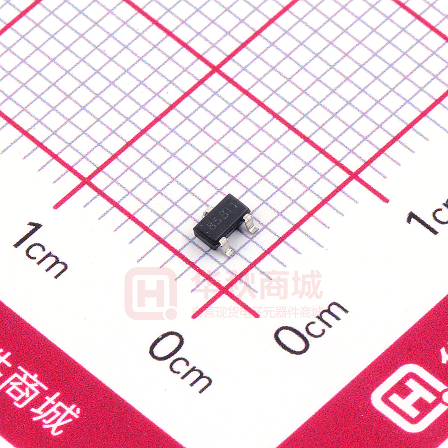

    MOSFETs N-Channel VDS=60V VGS=±20V ID=3A P=1.7W SOT23-3
TSM850N06CX RFG 数据手册
TSM850N06CX Taiwan Semiconductor N-Channel Power MOSFET 60V, 3A, 85mΩ FEATURES KEY PERFORMANCE PARAMETERS ● ● ● ● Low RDS(ON) to minimize conductive losses Logic level Low gate charge for fast power switching Compliant to RoHS directive 2011/65/EU and in accordance to WEEE 2002/96/EC ● Halogen-free according to IEC 61249-2-21 PARAMETER VALUE UNIT VDS 60 V RDS(on) (max) VGS = 10V 85 VGS = 4.5V 100 mΩ Qg 4.6 nC APPLICATIONS ● BLDC Motor Control ● Battery Power Management ● LED backlight SOT-23 Note: MSL 1 (Moisture Sensitivity Level) per J-STD-020 ABSOLUTE MAXIMUM RATINGS (TA = 25°C unless otherwise noted) SYMBOL LIMIT UNIT Drain-Source Voltage PARAMETER VDS 60 V Gate-Source Voltage VGS ±20 V Continuous Drain Current (Note 1) TC = 25°C ID TA = 25°C Pulsed Drain Current Total Power Dissipation Total Power Dissipation IDM TC = 25°C TC = 125°C TA = 25°C TA = 125°C Operating Junction and Storage Temperature Range PD PD 3 2.3 12 1.7 0.3 1 0.2 A A W W TJ, TSTG - 55 to +150 °C SYMBOL LIMIT UNIT Junction to Case Thermal Resistance RӨJC 75 °C/W Junction to Ambient Thermal Resistance RӨJA 124 °C/W THERMAL PERFORMANCE PARAMETER Thermal Performance Note: RӨJA is the sum of the junction-to-case and case-to-ambient thermal resistances. The casethermal reference is defined at the solder mounting surface of the drain pins. R ӨJA is guaranteed by design while RӨCA is determined by the user’s board design. 1 Version: C1811 TSM850N06CX Taiwan Semiconductor ELECTRICAL SPECIFICATIONS (TA = 25°C unless otherwise noted) PARAMETER CONDITIONS SYMBOL MIN TYP MAX UNIT Static Drain-Source Breakdown Voltage VGS = 0V, ID = 250µA BVDSS 60 -- -- V Gate Threshold Voltage VGS = VDS, ID = 250µA VGS(TH) 1.2 1.8 2.5 V Gate-Source Leakage Current VGS = ±20V, VDS = 0V IGSS -- -- ±100 nA -- -- 1 -- -- 100 -- 68 85 -- 80 100 gfs -- 6.7 -- Qg -- 9.5 -- Qg -- 4.6 -- Qgs -- 1.9 -- Qgd -- 1.6 -- Ciss -- 529 -- Coss -- 29 -- Crss -- 3 -- Rg -- 1.5 -- td(on) -- 4.8 -- tr -- 20 -- td(off) -- 9.8 -- tf -- 17 -- VSD -- -- 1 V VGS = 0V, VDS = 60V Drain-Source Leakage Current IDSS VGS = 0V, VDS = 60V TJ = 125°C Drain-Source On-State Resistance VGS = 10V, ID = 2.3A (Note 2) VGS = 4.5V, ID = 2.3A Forward Transconductance Dynamic (Note 2) RDS(on) VDS = 5V, ID = 2.3A µA mΩ S (Note 3) VGS = 10V, VDS = 30V, Total Gate Charge ID = 2.3A Total Gate Charge VGS = 4.5V, VDS = 30V, Gate-Source Charge ID = 2.3A Gate-Drain Charge Input Capacitance VGS = 0V, VDS = 30V Output Capacitance f = 1.0MHz Reverse Transfer Capacitance Gate Resistance Switching f = 1.0MHz nC pF Ω (Note 3) Turn-On Delay Time Turn-On Rise Time VGS = 10V, VDS = 30V, Turn-Off Delay Time ID = 2.3A, RG = 2Ω Turn-Off Fall Time ns Source-Drain Diode Forward Voltage (Note 2) VGS = 0V, IS = 2.3A Reverse Recovery Time IS = 2.3A, trr -- 12 -- ns Reverse Recovery Charge dI/dt = 100A/μs Qrr -- 8 -- nC Notes: 1. Silicon limited current only. 2. Pulse test: Pulse Width ≤ 300µs, duty cycle ≤ 2%. 3. Switching time is essentially independent of operating temperature. ORDERING INFORMATION ORDERING CODE TSM850N06CX RFG PACKAGE PACKING SOT-23 3,000pcs / 7” Reel 2 Version: C1811 TSM850N06CX Taiwan Semiconductor CHARACTERISTICS CURVES (TA = 25°C unless otherwise noted) Output Characteristics Transfer Characteristics 10 10 ID, Drain Current (A) 8 6 8 ID, Drain Current (A) VGS=10V VGS=7V VGS=5V VGS=4.5V VGS=4V VGS=3.5V 4 2 6 4 150℃ -55℃ 25℃ 2 VGS=3V 0 0 0 1 2 3 4 0 1 3 4 Gate-Source Voltage vs. Gate Charge 10 VGS, Gate to Source Voltage (V) RDS(ON), Drain-Source On-Resistance (Ω) On-Resistance vs. Drain Current 0.12 0.1 VGS=4.5V 0.08 0.06 VGS=10V 0.04 0.02 0 VDS=30V ID=2.3A 8 6 4 2 0 0 2 4 6 8 10 0 2 On-Resistance vs. Junction Temperature RDS(on), Drain-Source On-Resistance (Ω) VGS=10V ID=2.3A 1.9 1.7 1.5 1.3 1.1 0.9 0.7 0.5 -75 -50 -25 0 25 50 75 6 8 10 On-Resistance vs. Gate-Source Voltage 2.3 2.1 4 Qg, Gate Charge (nC) ID, Drain Current (A) RDS(on), Drain-Source On-Resistance (Normalized) 2 VGS, Gate to Source Voltage (V) VDS, Drain to Source Voltage (V) 100 125 150 TJ, Junction Temperature (°C) 0.1 0.09 0.08 0.07 ID=2.3A 0.06 0.05 3 4 5 6 7 8 9 10 VGS, Gate to Source Voltage (V) 3 Version: C1811 TSM850N06CX Taiwan Semiconductor CHARACTERISTICS CURVES (TA = 25°C unless otherwise noted) BVDSS vs. Junction Temperature BVDSS (Normalized) Drain-Source Breakdown Voltage Capacitance vs. Drain-Source Voltage C, Capacitance (pF) 700 600 CISS 500 400 300 200 CRSS 100 COSS 0 1.2 ID=1mA 1.1 1 0.9 0.8 0 5 10 15 20 25 30 -75 Maximum Safe Operating Area, Junction-to-Case -25 0 25 50 75 100 125 150 Source-Drain Diode Forward Current vs. Voltage 100 IS, Reverse Drain Current (A) 100 RDS(ON) ID, Drain Current (A) -50 TJ, Junction Temperature (°C) VDS, Drain to Source Voltage (V) 10 1 0.1 SINGLE PULSE RӨJC=75°C/W TC=25°C 0.01 10 25℃ 150℃ -55℃ 1 0.1 0.1 1 10 100 0.2 0.4 0.6 0.8 1 1.2 VSD, Body Diode Forward Voltage (V) VDS, Drain to Source Voltage (V) Normalized Thermal Transient Impedance, Junction-to-Case Normalized Effective Transient Thermal Impedance, ZӨJC 10 SINGLE PULSE RӨJC=75°C/W 1 Duty=0.5 Duty=0.2 Duty=0.1 Duty=0.05 Duty=0.02 Duty=0.01 Single 0.1 0.01 0.001 0.0001 0.001 0.01 0.1 Notes: Duty = t1 / t2 TJ = TC + PDM x ZӨJC x RӨJC 1 10 t, Square Wave Pulse Duration (sec) 4 Version: C1811 TSM850N06CX Taiwan Semiconductor PACKAGE OUTLINE DIMENSIONS (Unit: Millimeters) SOT-23 SUGGESTED PAD LAYOUT (Unit: Millimeters) MARKING DIAGRAM 85 = Device Code Y = Year Code M = Month Code O =Jan P =Feb S =May T =Jun W =Sep X =Oct L = Lot Code Q =Mar U =Jul Y =Nov R =Apr V =Aug Z =Dec 5 Version: C1811 TSM850N06CX Taiwan Semiconductor Notice Specifications of the products displayed herein are subject to change without notice. TSC or anyone on its behalf, assumes no responsibility or liability for any errors or inaccuracies. Information contained herein is intended to provide a product description only. No license, express or implied, to any intellectual property rights is granted by this document. Except as provided in TSC’s terms and conditions of sale for such products, TSC assumes no liability whatsoever, and disclaims any express or implied warranty, relating to sale and/or use of TSC products including liability or warranties relating to fitness for a particular purpose, merchantability, or infringement of any patent, copyright, or other intellectual property right. The products shown herein are not designed for use in medical, life-saving, or life-sustaining applications. Customers using or selling these products for use in such applications do so at their own risk and agree to fully indemnify TSC for any damages resulting from such improper use or sale. 6 Version: C1811
