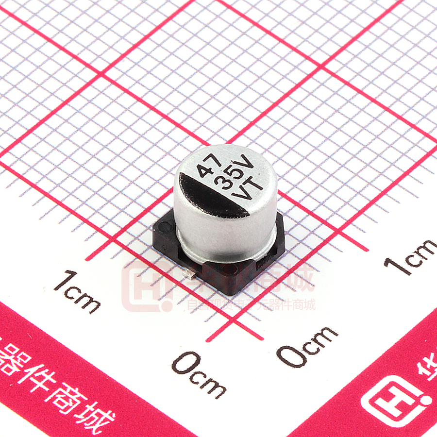

    贴片铝电解电容 SMD,D6.3xL5.4mm 47µF ±20% 35V
VT1V470M0605 数据手册
VT系列鋁電解電容器 Aluminum Electrolytic Capacitors VT SERIES 1.範圍 Scope 適用“VT系列”立式片式鋁電解電容器 This specification covers “VT Series” V-chip aluminum electrolytic capacitors. 2.參考標准 Reference Standard 日本工業標准JIS C-5141、JIS C-5102 3.環境保護標准 Environmental Protection Standard 遵照歐盟指令2002/95/EC. 4.使用溫度範圍 Operating Temperature Range -55C ~ +105C 5.電壓範圍 4 ~ 100V 6.容量範圍 0.1~ 1500F 7.容量偏差範圍 Capacitance Tolerance 20% at 120Hz, 20C 8.漏電流 Leakage Current 2分鐘後讀數 I ≤ 0.01 CV or 3 (A) whichever is greater (after 2 minutes) 9.Tan  測試頻率:120Hz,溫度:20℃ Measurement frequency: 120Hz, Temperature: 20C Rated Voltage (V) Tan  (max.) 4 0.50 6.3 0.30 10 0.24 16 0.20 25 0.18 35 0.14 50 0.14 63 0.12 100 0.12 10.低溫特性 測試頻率:120Hz Measurement frequency: 120Hz Rated Voltage (V) Impedance Ratio Z-25C /Z+20C ZT/Z20 (max.) Z-40C /Z+20C 4 7 15 6.3 4 8 10 3 6 16 2 4 25 2 4 35 2 3 50 2 3 63 2 3 100 2 3 2 VT系列鋁電解電容器 Aluminum Electrolytic Capacitors VT SERIES 11.耐久性 Load Life 105℃施加額定電壓2000小時後,電容器應滿足以下要求 After 2000 hours application of rated voltage at 105C, capacitors meet the characteristics requirements listed. 容量變化率 Capacitance Change 損耗角正切值 Tan  漏電流 Leakage Current 12.高溫儲存 ±30%初始值內 Within 30% of initial value ≤200%初始規定值 200% or less of initial specified value ≤初始規定值 Initial specified value or less Shelf Life 105℃放置1000小時後,滿足以下要求 After storage for 1000H at 105℃±5℃ Capacitance Change Tan  Leakage Current 13.耐焊接熱 Within 30% of initial value 200% or less of initial specified value 300% of less of Initial specified value. Resistance to Soldering Heat 經過回流焊後(參見第6頁)在溫室中恢複後,電容器滿足以下要求 After reflow soldering according to Reflow Soldering Condition (see page 5) and restored at room temperature, they meet the characteristics listed. 容量變化率 ≤±10%初始值 Capacitance Change Within 10% of initial value 損耗角正切值 ≤初始規定值 Tan  Initial specified value or less 漏電流 ≤初始規定值 Leakage Current Initial specified value or less 14.標識 Marking 電容器標識內容如下: Capacitors shall be legibly marked with the following: 1)產品系列 Manufacture’s mark 2)額定電壓和額定電容 Rated voltage and nominal capacitance 3)負極標識 Negative polari 3 VT系列鋁電解電容器 Aluminum Electrolytic Capacitors VT SERIES 15.圖樣 Drawing (Unit: mm) (4~6.3) Positive C±0.2 0.3max. L A±0.2 E B±0.2 D±0.5 A±0.2 0.5Max. Plastic platefom +0.2 -0.1 Negative *L0.3 (Applicable to 6.3 x 7.7) 0.5~0.8 (8, 10) Positive Plastic platform A0.2 E D± 0.5 B± 0.2 A0.2 0.5Max. C± 0.2 0.3max. Negative L0.5 0.8 ~ 1.1 16.尺寸 Dimensions (Unit: mm) DL 45.4 A 1.8 B 4.3 C 4.3 E 1.0 L 5.4 17.編帶說明 55.4 2.1 5.3 5.3 1.3 5.4 6.35.4 2.4 6.6 6.6 1.8 5.4 6.37.7 2.4 6.6 6.6 1.8 7.7 86.5 2.9 8.3 8.3 3.1 6.5 810.5 2.9 8.3 8.3 3.1 10.5 1010.5 3.2 10.3 10.3 4.2 10.5 Taping Specifications 符合標准JIS C0806 Applicable standard JIS C0806 (VT、VS、VE、VW、VK、VH、VNseries) 盒帶 Carrier Tape 17.1.圖樣 Drawing 1 (for 4 ~ 10) 1.5 + 0.1~-0 2.0± 0.1 0.4 1.75± 0.1 4 F± 0.1 W± 0.3 4.0± 0.1 VT系列鋁電解電容器 Aluminum Electrolytic Capacitors VT SERIES 尺寸 Dimension Series RVT 86.5 810.5 1010.5 16.0 16.0 24.0 24.0 12.0 12.0 16.0 16.0 7.5 7.5 11.5 11.5 DL 45.4 55.4 6.35.4 6.37.7 W 12.0 12.0 16.0 P 8.0 F 12.0 5.5 12.0 5.5 7.5 A 4.7 6.0 7.0 7.0 8.7 8.7 10.7 B 4.7 6.0 7.0 7.0 8.7 8.7 10.7 T2 5.8 5.8 5.8 8.3 7.0 11.0 11.0 17.2.卷盤 Reel 3 包裝數量 Package quantity 45.5 卷裝數量Qty./Ree l 2000 pcs. 盒裝數量 Qty./Bag 20000 pcs. 5, 6.35.4 1000 pcs. 10000 pcs. 6.37.7 1000 pcs. 10000pcs. DL 130.5 2.0  382 Max. 50 Min. 23 86.5 1000 pcs. 10000 pcs. 810.5 500 pcs. 5000 pcs. 1010.5 500 pcs. 5000 pcs. A D A 4 14 5 14 6.3 18 8*6.5 18 8*10.5 26 10*10.5 26 18. 無鉛回流焊接 Lead-free Reflow Soldering Condition A. 回流焊條件推薦 Recommended Conditions for Reflow Soldering (1)應采用紅外線及熱風回流焊接,不宜采用汽相加熱回流焊接; A thermal condition system such as infrared radiation (IR) or hot blast should be adopted, and vapor heat transfer systems (VPS) are not recommended. (2)推薦回流焊只進行一次,回流焊次數如果需要二次,必須相隔30分鐘以上; Reflow soldering should be performed one time. If the capacitor has to be reflowed twice, 30 minutes must be layout between each time. (3)無鉛回流焊,請符合下述條件: For lead-free type reflow soldering, please observe proper conditions below: a)從150℃至200℃的預熱時間在180秒鐘以內; The time of preheating from 150°C to 200°C shall be within maximum 180 seconds; b)電容器頂部溫度超過217℃的焊接時間不超過tL秒; The time of soldering temperature at 217°C measured on capacitors' top shall not exceed tL (second); c)電容器頂部尖峰溫度不超過Tp℃,在5℃範圍內的實際尖峰溫度時間不超過The peak temperature on capacitors' top shall not exceed Tp(°C), and the time within 5°C of actual peak temperature shall not exceed tp (second). 5 VT系列鋁電解電容器 Aluminum Electrolytic Capacitors VT SERIES B.回流焊曲線圖 Classification Reflow Profile *1. Average ramp-up rate is 3℃/second max. *2. Ramp-down rate is 6℃/second max. *3 .Time from 25℃ to peak temperature is 8 minutes max. C. 尖峰溫度允許範圍 Allowable Range of Peak Temperature Size Thickness (mm) Tp(°C) tL (second) tp (second) 4~6.3 2.5 250±0 80 20 8 2.5 240±0 80 10 1010.5L 2.5 235±0 60 10 D.表面安裝推薦尺寸 Recommended Land Size (Unit: mm) Y a Y Size 4 5 6.3 8 10 X 1.6 1.6 1.6 2.5 2.5 Y 2.6 3.0 3.5 3.5 4.0 a 1.0 1.4 2.1 3.0 4.0 X 19.引線原材料 The Raw Materials of Lead Wire Name TPCS Material Fe Cu Sn Percentage 71.35% 20% 8.65% 6 VT系列鋁電解電容器 Aluminum Electrolytic Capacitors VT SERIES 20.電容器代碼標志 Explanation of Part Number Series (RVT) Voltage (35V) Capacitance (47F) Capacitance Tolerance (20%) Case Diameter (6.3*7.7mm) 1 2 3 4 5 6 7 8 9 10 11 12 13 Series Voltage (WV) Capacitance (F) Cap. Tol. (%) Example: VT 1V 470 M 0607 额定电压 R.W.Voltage(V) 4 6.3 10 16 代号 Code 0G 0J 1A 1C 21. 結構 Construction 電解紙 Electrolytic paper 鋁殼 底座 Aluminum case Base plate \ h e Case Size 範例: 外殼尺寸 Case Size (6.3*7.7mm) 電容量允許偏差 Capacitance Tolerance (20%) 電容量 Capacitance (47F) 電壓 Voltage (35V) 系列 Series (VT) 25 35 50 63 100 1E 1V 1H 1J 2A 鋁箔 陽極和陰極 Aluminum foil (Anode & cathode foil) Electrolyte 電解液 Rubber seal Lead wire 電解液 封口膠蓋 引出線 7 VT系列鋁電解電容器 Aluminum Electrolytic Capacitors VT SERIES 22.額定紋波電流的頻率導數 Frequency Coefficient of Allowable Ripple Current Frequency 50Hz 120Hz 300Hz 1kHz 10kHz~ Coefficient 0.70 1.00 1.17 1.36 1.50 23. 最大允許紋波電流 Dimensions & Maximum Permissible Ripple Current Item VT-P/N Capacitance (F) Working Voltage (V) Case Size (DL) Allowable ripple current (mA rms) at 105C, 120Hz 1 VT1C101M0605 100UF 16V 6.3*5.4 63 2 VT1V470M0605 47UF 35V 6.3*5.4 54 3 VT1C221M0607 220UF 16V 6.3*7.7 110 4 VT1A221M0605 220UF 10V 6.3*5.4 110 5 VT1E221M0810 220UF 25V 8*10.5 183 6 VT1H4R7M0405 4.7UF 50V 4*5.4 14 7 VT1E220M0505 22UF 25V 5*5.4 26 8 VT1E100M0405 10UF 25V 4*5.4 15 9 VT0J470M0405 47UF 6.3V 4*5.4 26 10 VT1H100M0505 10UF 50V 5*5.4 25 11 VT1E471M1010 470UF 25V 10*10.2 286 12 VT1A102M1010 1000UF 10V 10*10.2 320 13 VT1E100M0505 10UF 50V 5*5.4 17 14 VT1C470M0605 47UF 16V 6.3*5.4 48 15 VT1V471M1010 470UF 35V 10*10.2 286 16 VT1V221M0810 220UF 35V 8*10.2 195 17 VT1C100M0405 10UF 16V 4*5.4 17 18 VT1A101M0505 100UF 10V 5*5.4 40 19 VT1C470M0505 47UF 16V 5*5.4 33 20 VT1C101M0605 100UF 16V 6.3*5.4 63 21 VT1A221M0605 220UF 10V 6.3*5.4 110 8 4.标称电容量、额定电压、额纹波波电流与外形尺寸参应表 Nominal capacitance,rated voltage,rated ripple current and case size table 9 VT系列鋁電解電容器 Aluminum Electrolytic Capacitors VT SERIES 25. 片式鋁電解電容器一般使用注意事項 Application guideline for V-CHIP aluminum electolytic capacitors A)電路設計 Circuit Design 1) 充分考慮電容器使用和安裝條件在容仕產品目錄的規定範圍內 Please make sure the environmental and mounting conditions to which the capacitor will be exposed are within the conditions specified in RJ’s catalogue. 2) 工作溫度和施加的紋波電流應在容仕產品目錄的規定範圍內 Operating temperature and applied ripple shall be within RJ specification. 3) 在設計電路時,應選擇符合壽命要求的產品 Appropriate capacitors which comply with the life requirement of the products should be selected when designing the circuit. 4) 鋁電解電容器是有極性的,不應加反向電壓或交流電壓。對可能出現反向電壓的電路,應選擇雙極性電 容器。注意:即使雙極性電容器,也不能直接用於純交流電路 Aluminum electrolytic capacitors are polar. Make sure that no reverse voltage or AC voltage is applied to the capacitors. Please use bi-polar capacitors for a circuit that can possibly see reversed polarity. Note: Even bi-polar capacitors cannot be used for AC voltage application. 5)對需要快速和頻繁充放電的電路,不應使用鋁電解電容器,而應選擇特別設計的具有長壽命的電容器 Do not use aluminum electrolytic capacitors in a circuit that requires rapid and very frequent charge / discharge. In this type of circuit, it is necessary to use a special design capacitor with extended life characteristics. 6)不應使用過載電壓 Do not apply excess voltage. ① 直流電壓與紋波電壓疊加後的峰值電壓不應超過額定工作電壓 Please pay attention to that the peak voltage, which is DC voltage overlapped by ripple current, will not exceed the rated voltage. ① 若2個以上電容器串聯,應確保施加電壓低於額定值,而且要並聯一個平衡電阻,以使每個電容器所 加電壓相等。 In the case where more than 2 aluminum electrolytic capacitors are used in series, please make sure that applied voltage will be lower than rated voltage and the voltage will be applied to each capacitor equally by using a balancing resistor in parallel with the capacitor 7)電容器不能應用於下述環境條件下: Aluminum electrolytic capacitors shall not be used under the following environmental conditions: ①(a) 電容器被暴露於水(包括濃縮液)、鹽水或油中。 Capacitors will be exposed to water (including condensation), brine or oil. (b) 周圍環境中有氫化硫、亞硫酸、亞硝酸、氯氣、溴氣、溴化甲烷、氨氣等有毒氣體。 Ambient conditions that include toxic gases such as hydrogen sulfide, sulfurous acid, nitrous acid, chlorine, bromine, methyl bromide, ammonium, etc. 10 VT系列鋁電解電容器 Aluminum Electrolytic Capacitors VT SERIES (c) 周圍環境中有臭氧、紫外線及輻射。 Ambient conditions that expose the capacitor to ozone, ultraviolet ray and radiation. ② 嚴重的振動及機械沖擊超過容仕產品目錄的規定範圍。 Severe vibration and physical shock conditions that exceed RJ specification. 振動的測試條件如下 Vibration test condition: 振動頻率範圍 : 10-55-10Hz vibration frequency range : 10~55~10Hz 掃描頻率 : 10-55-10Hz/分鐘 sweep rate : 10~55~10Hz/minute 掃描方式 : 對數 sweep method : logarithmic 振幅或加速度 :1.5mm (最大加速度為10G) amplitude or acceleration : 1.5mm (max. acceleration is 10G) 振動方向 : X、Y、Z方向 direction of vibration : X, Y, Z direction 測試時間 : 每個方向2小時 testing time : 2 hours per each direction 沖擊一般不適用。 Shock is not applicable normally. 如有特殊要求,請與我們銷售部門聯系。 If a particular condition is required, please contact our sales office. 8) 電解液主要化學溶劑及電解紙為易燃物,且電解液導電。當電解液與PC板接觸時,可能會腐蝕PC板上 的線路,或造成短路,以致產生煙或著火。因此在電容器封口下端不應有任何線路。 The main chemical solution of the electrolyte and the separator paper used in the capacitors are combustible. The electrolyte is conductive. When it comes in contact with the PC board, there is a possibility of pattern corrosion or short circuit between the circuit pattern, which could result in smoking or catching fire. Do not locate any circuit pattern beneath the capacitor end seal. 9) 設計線路板時應確保發熱元器件不靠近鋁電解電容器或PC板的另一面,避免其正好在電容器的下面。 Do not design a circuit board that the heat generating components are placed near the aluminum electrolytic capacitor or on the reverse side of PC board, if that just under the capacitor. 10) 設計線路板時應考慮到電容器的電性能可能隨溫度和頻率的變化而變化。 Electrical characteristics may vary depending on changes in temperature and frequency. Please consider this variation when you design circuits. 11) 當2個以上電容器並聯時,應考慮到通過這些電容器的電流平衡。 When you install more than 2 capacitors in parallel, please consider the balance of current flowing into the capacitors. 12) 在雙面線路板上安裝電容器時,電容器的安裝位置應避開多餘的基板孔和過孔。 While mounting capacitors on double-side PC board, the capacitors should be away from those unnecessary base plate holes and connection holes. B)安裝 Mounting 11 1) 一旦電容器經過安裝及加載,不要再試圖用於其他線路板或其他用途。 2) 貯存超過2年的電容器,其漏電流可能增大。若漏電流增大,請使用1KΩ電阻做充電處理。 Leakage current of the capacitors that have been stored for more than 2 years may VT系列鋁電解電容器 Aluminum Electrolytic Capacitors VT SERIES increase. When leakage current has increased, please perform a voltage treatment using a 1kΩ resistor. 3) 在將電容器安裝在PC板之前,請確認其規格和極性。 Please confirm specifications and polarity before installing capacitors on the PC board. 4) 不要將電容器掉在地上,或不要使用掉在地上的電容器。 Do not drop capacitors on the floor, nor use a capacitor that was dropped. 5) 安裝時請不要損傷電容器。 Do not deform the capacitor during installation. 6) 請注意貼片機的吸頭、產品檢測夾具或對中裝置對電容器的機械沖擊。 Please pay attention to the mechanical shock to the capacitor by suction nozzle of the automatic insertion machine or automatic mounter, or by product checker, or by centering mechanism. 7) 回流焊Reflow soldering ① 請遵守容仕產品目錄中的回流焊條件。 Please follow “Reflow Soldering Conditions” in RJ’s catalogue. ② 當使用紅外線加熱時,請注意加熱程度,因為紅外線吸收率會隨著電容器顏色和大小的不同而改變。 When an infrared heater is used, please pay attention to the extent of heating since the absorption rate of infrared will vary due to difference in the color and size of the capacitor. 8) 將電容器焊接在PC板後,不要傾斜或扭動電容器。 Do not tilt lay down or twist the capacitor body after the capacitor are soldered to the PC board. 9) 不要抓住焊接後的電容器搬動PC板。 Do not carry the PC board by grasping the soldered capacitor. 10)不要讓任何物品接觸焊接後的電容器。如果PC板堆放儲存,請確保PC板或其他零部件不觸到電容器。 Please do not allow anything to touch the capacitor after soldering. If PC boards are stored in stack, please make sure the PC board or other components away from the capacitor. 11)焊接後的電容器不應受到任何已焊接PC板或其他元器件熱輻射的影響。 The capacitors shall not be effected by any radiated heat from the soldered PC board or other components after soldering. 12)清洗: Cleaning ①不能用鹵化清洗劑清洗電容器。如必須使用鹵化清洗劑,請與我們銷售部門聯系。 Do not clean capacitors with halogenated cleaning agent. However, if it is necessary to clean with halogenated cleaning agent, please contact our sales office. ②推薦清洗方法: Recommended cleaning method 使用範圍:任何類型及規格 Applicable : Any type, any ratings 清洗方法:浸泡、超聲波或其他方法的總清洗時間應在2分鐘內。清洗劑溫度應在40℃以下。清洗後 ,應將電容器與PC板一起用熱風吹至少10分鐘。熱風溫度應低於電容器工作溫度。水洗後若不充分吹 幹,可能導致外觀不良,如座板發脹等。 12 Cleaning conditions : Total cleaning time shall be within 2 minutes by immersion, ultrasonic or other methods. Temperature of the cleaning agents shall be 40℃ or below. After cleaning, capacitors should be dried by using hot air for the minimum 10 minutes along with the PC board mounted. Hot air temperature should be within the maximum operating temperature of the capacitor. Insufficient dryness after water rinse may cause VT系列鋁電解電容器 Aluminum Electrolytic Capacitors VT SERIES ③ 避免使用破壞臭氧層的清洗劑以保護環境。 C)安裝後In the Equipment 1)不要直接用手接觸電容器正負極。 Do not directly touch terminal by hand. 2)不要在正負極之間用導體連接,也不要在電容器及其附近濺撒導電液體,如酸堿溶液等。 Do not link positive terminal and negative terminal by conductor, nor spill conductible liquid such as alkaline or acidic solution on or near the capacitor. 3)在使用環境中應避免濺上水或油,避免陽光直射、紫外線照射、輻射、有毒氣體、振動或機械沖擊。 Please make sure that the ambient conditions where the set is installed are free from spilling water or oil, direct sunlight, ultraviolet rays, radiation, poisonous gases, vibration or mechanical shock. D) 維護和檢驗Maintenance and Inspection 請定期檢測安裝在工業設備上的電容器。檢測項目如下: Please periodically inspect the aluminum capacitors that are installed in industrial equipment. The following items should be checked: 外觀:明顯缺陷,如防爆閥打開、電解液泄露等。 Appearance: remarkable abnormality such as pressure relief vent opening, electrolyte leaking, etc. 電性能:電容量、損耗角正切、漏電流等,具體數據參見容仕產品目錄和相關產品規格書。 Electrical characteristics: capacitance, dielectric loss tangent, leakage current and etc., which are specified in RJ’s catalogue or alternate product specification. E)緊急情況 In an Emergency 1)若看見因防爆閥動作而產生的煙氣,請關閉主開關或拔開離合器。 If you see smoke due to operation of safety vent, please turn off the main switch or pull out the plug from the outlet. 2)若吸入氣體或咽下電解液,應立即用水清洗口腔和喉嚨。 If you breathe the gas or ingest the electrolyte, please wash out your mouth and throat with water immediately. 3)若皮膚沾上電解液,請用肥皂和水清洗幹淨。 13 If your skin is exposed to the electrolyte, please wash it away using soap and water. F) 儲存 Storage 1) 不要將電容器儲存在溫度和濕度高的地方。 儲存環境應為溫度:5℃-35℃,相對濕度:
