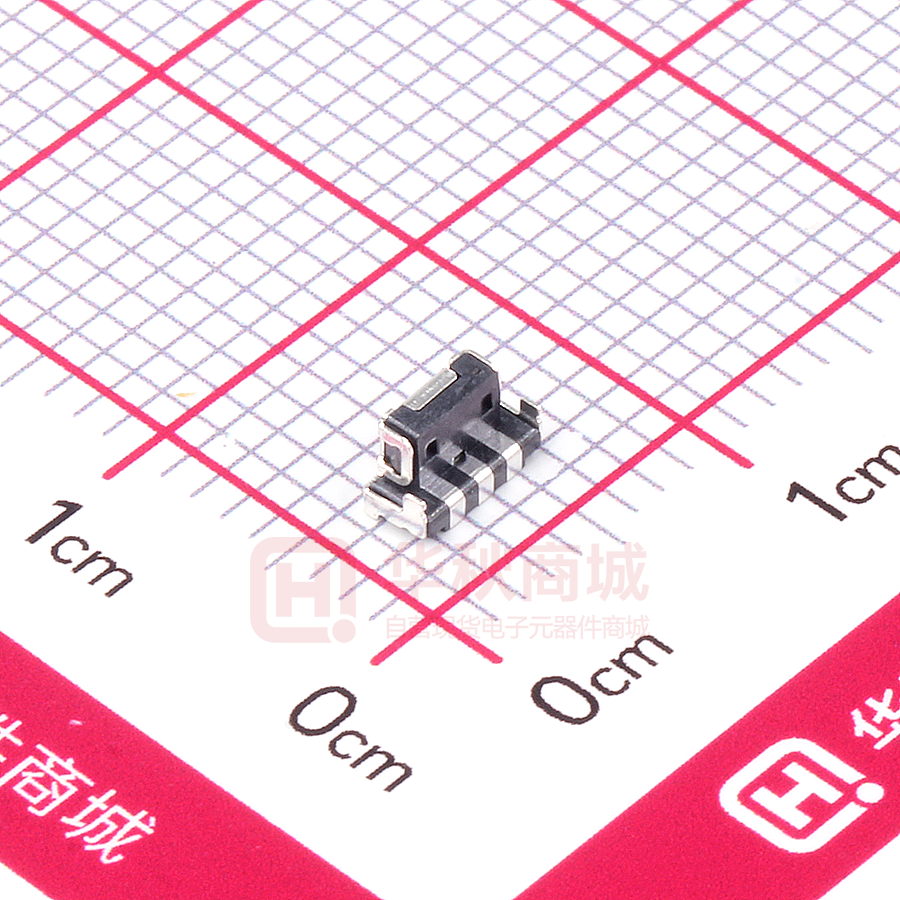

TP14821629 数据手册
A B D C 1.50 [0.059] 0.80 [0.031] 0.80[0.031] 3.00[0.118] 3.80 [0.149] 4.70[0.185] PCB.安装图 0.95[0.037]±0.05 0.65 [0.026]±0.05 1.50 [0.059] 2.25 [0.088]±0.10 2.60 [0.102]±0.10 1.35 [0.053]±0.10 0.70 [0.028] 6 Dustproof film 防尘膜 PI 1 Yellow 黄色 5 Contact 触点 Phosphorous copper 磷铜 1 Ag plating 镀银 4 Pedestal 基座 LCP 1 Black 黑色 3 Reed 簧片 SUS 2 Covered with silver 覆银 2 Cover plate 盖板 Phosphorous copper 磷铜 1 Ag plating 镀银 1 Button 按钮 LCP 1 Black 黑色 NO 序号 Part name 部件名 Material 材料 QTY 数量 Remark 备注 CIRCUIT DIAGRAM ② MM DRAWN BY FUYUAN 台普 A1 ROCPU REVISION DESCRIPTION A ISSUE B X.XX ± 0.10 X.X ± 0.15 X ± 0.25 ANGULAR C PROJCTED PRODUCT NAME: TOLERANCE A3 A2 3 4 UNIT COMMON DATE 2 ③ A4 REV 1 2.20 [0.087] 0.55[0.021]±0.05 2.95[0.116]±0.10 3.70[0.145]±0.05 ① 5 1.60[0.062] 1.10[0.043] 1.50[0.059] 2.20[0.086] 4.75[0.187]±0.30 4 G NOTES: 1.Rating:12VDC 50mA 1.额定值:12VDC 50mA 2.Dielectric Strength:250V AC 2.耐电压:250V AC 3.Contact Resistance:≤50mΩ Max 3.接触电阻:≤50mΩ 4.Insulation Resistance:≥100MΩ 4.绝缘电阻:≥100MΩ 5.Operating Force:160±30gf 5.操作力:160±30gf 6.Life:100,000 times 6.寿命:100,000 times 7.Trip:0.20±0.10mm 7.行程:0.20±0.10mm ③ ① ② 0.40 [0.016] 1.70 [0.067] 0.40 [0.016] 0.10 [0.004]MAX 1 1.35 [0.053] 3-0.60 [0.024] 3 F 3.10 [0.122] 2.30 [0.090] 2 E DATE 2019 CHECKED BY COCO MODEL NO: TP14821629 APPROVAL B ALEN Https: www.rocpu.tw ROCPU TECHNOLONGY CO.,LTD Copies are issued in strict confidence and shall not be reproduced or copied,or used as the basic of manufacture or sale of apparatus without permission D E F G 5
