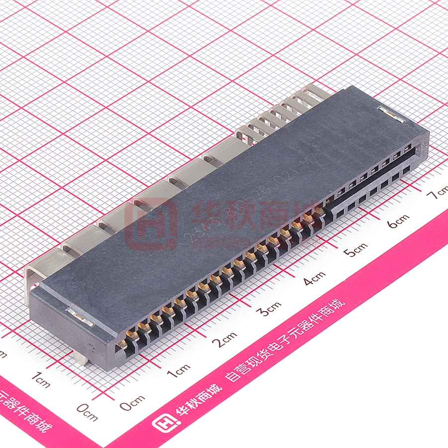

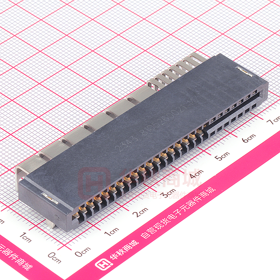

8105260121
8105260121
    MZF(铭泽丰)
    弯插,P=2.54mm
    电源连接器
8105260121 数据手册
1 2 4 3 5 7 6 62.13 22.38 16.40 22.45 F 1 E 3 LOGO 71.00 4 2 SEE NOTES 7 D/C LOCATION & PART NUMBER: YYWW & 81052XXXXX (67.34) 10.00 F 3.80 0.65 A B 5.80 D 3.64 0.60 F E 4. LEAD-FREE AND ROHS COMPLIANT PRODUCT 5. UNLESS OTHERWISE SPECIFIED, ALL TOLERANCES FOLLOW DRAWING COMMON STANDARD. 6. PACKAGING:SEE PACKAGE SPECIFICATION. 7. POWER SINGLE PIN MAX CURRENT 36A (SUM:12 PIN). SIGNAL SINGLE PIN MAX CURRENT 7A (SUM:14 PIN). 8. CONTACT PLATING: CONTACT SEGMENT: NI: 50-120 u",AU:15/30u"; (SEE NOTE1) WELDING SEGMENT: NI: 50-120 u",TIN: 80-140u" 9.DATE CODE LOCATION & PART NUMBER IS SHOWN ABOVE DATE CODE FORMAT:YYWW YY=YEAR WW=WEEK 10. PART NO : +0.15 B 1.16-0.10 3.40 0.60 6.80 0 0.80-0.1 NOTES: 1. ELECTRICAL CHARACTERISTICS 1-1.VOLTAGE RATING: 250V 1-2.CONTACT RESISTANCE:10 MILLIOHMS MAX.INITIAL. 15 MILLIOHMS MAX.AFTER TEST. 1-3.INSULATION RESISTANCE: 1000 MEGOHMS MIN. AT 500 VDC. 1-4.DIELECTRIC WITHSTAND VOLTAGE: 500 VDC RMS. MIN. AT SEA LEVEL. 2. MECHANICAL CHARACTERISTICS: 2-1.TOTAL INSERTION FORCE:70.0 N MAX USE 1.60mm THICKNESS GAUGE. 2-2.TOTAL WITHDRAW FORCE:10 N MIN USE 1.60mm THICKNESS GAUGE. 2-3.CONTACT RETENTION FORCE:0.5 Kgf MIN. 2-4.DURABILITY: 200 CYCLES. 3. ENVIRONMENTAL CHARACTERISTICS: D 81052 6 0 X X X 3.50 3.00 A 2.54 8 2.50 60.96 5.08 17.05 SECTION A-A SCALE 1:1 68.24 C E 0.64 10.05 PACKING TYPE 0: TRAY 1: IC TUBE 0: NO LOGO 1: WITH MZF LOGO CONTACT GOLD PLATING: 2: 30u" GOLD PLATING 3: 15u" GOLD PLATING C 10.00 5.20 (67.00) (66.00) B 3.40 6.80 0.50 F 2.50 10.05 0.50 5.08 17.05 SECTION B-B SCALE 1:1 A 1 2 3 12 COPPER ALLOY SEE NOTES 8 / PART NO. 3 SIGNAL CONTACT 14 COPPER ALLOY SEE NOTES 8 / PART NO. 2 HOOK 2 COPPER ALLOY TIN 80~140u" 1 HOUSING 1 THERMOPLASTIC BLACK MATERIAL PLATING & COLOR GENERAL TOLERANCES (UNLESS SPECIFIED) PRD-2008001/CHANGE SIZE 08/04'20 E D PRD-2004001/ ADD PART NO. 04/02'20 PRD-1905012/CHANGE SIZE 05/22'19 C B PRD-1901004/CHANGE SIZE 01/17'19 PRD-1812012/UPDATED 12/21'18 A NEW RELEASED 12/12'18 DESCRIPTION 4 POWER CONTACT ITEM DESCRIPTION F REV. 4 DATE 5 .X Guangdong MZF Interconnection co., LTD. A3 50 POS 12A R/A P/S ISA CONN 8105260XXX APPROVED: Zlqian 08/04'20 CHECKED: Zqzeng 08/04'20 UNIT DRAWN: mm 6 A DWG NO. 10-1052-04 ECN NO. PRD-2008001 SIZE TITLE: PART NO. 0.30 0.20 0.10 .XX QTY B Jsxu 08/04'20 7 CUSTOMER DWG SCALE SHEET REV. 1:1 1/2 F 8 1 2 4 3 5 12-7.08 7 6 F 14-2.00 5.08 8 1.70 0.50 F 9.20 F 12-2.54 10-7.62 E E 1.00(Au 15/30u" PLATED ON MATING AREA) 65.70 RECOMMENDED GOLD FINGER 60.96 D Y X 5.08 B1 B25 C F 0.90 0.1 X Y 2.54 D 0.1 X Y 17.05 10.05 C A25 A1 2.00(Au 1u"MIN PLATED ON MATING AREA) 4.91 3.64 NOTE 1 2.80 0.1 X Y B B 68.24 RECOMMENDED PCB LAYOUT A GENERAL TOLERANCES (UNLESS SPECIFIED) F PRD-2008004/CHENGE SIZE 08/04'20 E D PRD-2004001/ ADD PART NO. 04/02'20 PRD-1905012/CHENGE SIZE 05/22'19 C B PRD-1901004/CHENGE SIZE 01/17'19 PRD-1812012/UPDATED 12/21'18 A REV. 1 2 3 12/12'18 NEW RELEASED DESCRIPTION 4 DATE 5 .X TITLE: PART NO. 0.30 0.20 0.10 .XX Guangdong MZF Interconnection co., LTD. 50 POS 12A R/A P/S ISA CONN 8105260XXX APPROVED: Zlqian 08/04'20 CHECKED: Zqzeng 08/04'20 10-1052-04 ECN NO. PRD-2008001 SIZE A3 UNIT DRAWN: mm 6 A DWG NO. Jsxu 08/04'20 7 CUSTOMER DWG SCALE SHEET REV. 1:1 2/2 F 8
