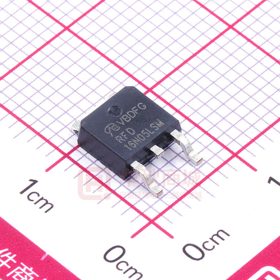

RFD16N05LSM9A-VB www.VBsemi.com RFD16N05LSM9A-VB Datasheet N-Channel 6 0-V (D-S) MOSFET FEATURES PRODUCT SUMMARY 60 • Trench Power MOSFET • 175 °C Junction Temperature rDS(on) (Ω) ID (A)a 0.025 at VGS = 10 V 45 0.030 at VGS = 4.5 V RoHS* 40 COMPLIANT VDS (V) TO-252 Available D G Drain Connected to Tab G D S S Top View N-Channel MOSFET ABSOLUTE MAXIMUM RATINGS TC = 25 °C, unless otherwise noted Parameter Gate-Source Voltage Continuous Drain Current (TJ = 175 °C)b TC = 25 °C TC = 100 °C Symbol Limit Unit VGS ± 20 V 45 ID 35 IDM 100 Continuous Source Current (Diode Conduction) IS 23 Avalanche Current IAS 20 Pulsed Drain Current Single Avalanche Energy (Duty Cycle ≤ 1 %) Maximum Power Dissipation L = 0.1 mH TC = 25 °C TA = 25 °C EAS 20 mJ 100 PD W 3a TJ, Tstg Operating Junction and Storage Temperature Range A - 55 to 175 °C THERMAL RESISTANCE RATINGS Parameter Maximum Junction-to-Ambienta Maximum Junction-to-Case Symbol t ≤ 10 sec Steady State RthJA RthJC Typical Maximum 18 22 40 50 3.2 4 Unit °C/W Notes: a. Surface Mounted on 1" x 1" FR4 board, t ≤ 10 sec. 服务热线:400-655-8788 1 RFD16N05LSM9A-VB www.VBsemi.com SPECIFICATIONS TJ = 25 °C, unless otherwise noted Parameter Symbol Test Conditions Min Typa Max 2.0 3.0 Unit Static Drain-Source Breakdown Voltage Gate Threshold Voltage Gate-Body Leakage V(BR)DSS VGS = 0 V, ID = 250 µA 60 VGS(th) VDS = VGS, ID = 250 µA 1.0 IGSS VDS = 0 V, VGS = ± 20 V ± 100 VDS = 60 V, VGS = 0 V 1 VDS = 60 V, VGS = 0 V, TJ = 125 °C 50 Zero Gate Voltage Drain Current IDSS On-State Drain Currentb ID(on) VDS = 60 V, VGS = 0 V, TJ = 175 °C Drain-Source On-State Resistanceb b Forward Transconductance rDS(on) gfs VDS = 5 V, VGS = 10 V V nA µA 250 50 A VGS = 10 V, ID = 15 A 0.025 VGS = 10 V, ID = 15 A, TJ = 125 °C 0.055 VGS = 10 V, ID = 15 A, TJ = 175 °C 0.069 VGS = 4.5 V, ID = 10 A 0.030 VDS = 15 V, ID = 15 A 20 VGS = 0 V, VDS = 25 V, f = 1 MHz 140 Ω S Dynamica Input Capacitance Ciss Output Capacitance Coss Reverse Transfer Capacitance Crss Total Gate Chargec Qg Gate-Source Chargec Qgs c Gate-Drain Charge Qgd Turn-On Delay Timec td(on) Rise Timec Turn-Off Delay Timec Fall Timec tr td(off) 1500 pF 60 11 VDS = 30 V, VGS = 10 V, ID = 23 A 17 3 nC 3 VDD = 30 V, RL = 1.3 Ω ID ≅ 23 A, VGEN = 10 V, Rg = 2.5 Ω tf 8 15 15 25 30 45 25 40 ns Source-Drain Diode Ratings and Characteristics (TC = 25 °C) Pulsed Current ISM Diode Forward Voltage VSD IF = 15 A, VGS = 0 V 1.0 1.5 V Reverse Recovery Time trr IF = 15 A, di/dt = 100 A/µs 30 60 ns 50 A Notes: a. For design aid only; not subject to production testing. b. Pulse test; pulse width ≤ 300 µs, duty cycle ≤ 2 %. c. Independent of operating temperature. Stresses beyond those listed under “Absolute Maximum Ratings” may cause permanent damage to the device. These are stress ratings only, and functional operation of the device at these or any other conditions beyond those indicated in the operational sections of the specifications is not implied. Exposure to absolute maximum rating conditions for extended periods may affect device reliability. 2 服务热线:400-655-8788 RFD16N05LSM9A-VB www.VBsemi.com TYPICAL CHARACTERISTICS 25 °C unless noted 50 100 VGS = 10 thru 6 V 5V 40 I D - Drain Current (A) I D - Drain Current (A) 80 60 40 4V 20 30 20 TC = 125 °C 10 25 °C 3V - 55 °C 0 0 2 0 4 6 8 0 10 1 2 3 4 5 6 VGS - Gate-to-Source Voltage (V) VDS - Drain-to-Source Voltage (V) Output Characteristics Transfer Characteristics 32 0.10 TC = - 55 °C 0.08 r DS(on) - On-Resistance (Ω) g fs - Transconductance (S) 25 °C 24 125 °C 16 8 0 VGS = 4.5 V 0.04 VGS = 10 V 0.02 0.00 0 5 10 15 20 25 0 10 20 30 40 ID - Drain Current (A) ID - Drain Current (A) Transconductance On-Resistance vs. Drain Current 50 10 V GS - Gate-to-Source Voltage (V) 1000 800 C - Capacitance (pF) 0.06 Ciss 600 400 200 Coss Crss 0 0 VDS = 30 V ID = 23 A 8 6 4 2 0 10 20 30 40 50 VDS - Drain-to-Source Voltage (V) Capacitance 60 0 2 4 6 8 10 12 Qg - Total Gate Charge (nC) Gate Charge 服务热线:400-655-8788 3 RFD16N05LSM9A-VB www.VBsemi.com TYPICAL CHARACTERISTICS 25 °C unless noted 100 2.5 VGS = 10 V ID = 15 A I S - Source Current (A) rDS(on) - On-Resistance (Normalized) 2.0 1.5 1.0 TJ = 150 °C TJ = 25 °C 10 0.5 0.0 - 50 1 - 25 0 25 50 75 100 125 150 TJ - Junction Temperature ( °C) On-Resistance vs. Junction Temperature 4 175 0 0.3 0.6 0.9 1.2 1.5 VSD - Source-to-Drain Voltage (V) Source-Drain Diode Forward Voltage 服务热线:400-655-8788 RFD16N05LSM9A-VB www.VBsemi.com THERMAL RATINGS 100 25 *rDS(on) Limited 10 µs 100 µs I D - Drain Current (A) I D - Drain Current (A) 20 15 10 10 1 ms 10 ms 1 100 ms dc TC = 25 °C Single Pulse 5 0 0.1 0 25 50 75 100 125 150 175 0.1 1 10 100 VDS - Drain-to-Source Voltage (V) *VGS > minimum VGS at which rDS(on) is specified TA - Ambient Temperature (°C) Maximum Drain Current vs. Ambient Temperature Safe Operating Area 2 Normalized Effective Transient Thermal Impedance 1 Duty Cycle = 0.5 0.2 0.1 0.1 0.05 0.02 Single Pulse 0.01 10- 4 10- 3 10- 2 10- 1 1 10 Square Wave Pulse Duration (sec) Normalized Thermal Transient Impedance, Junction-to-Case 服务热线:400-655-8788 5 RFD16N05LSM9A-VB www.VBsemi.com TO-252AA CASE OUTLINE E MILLIMETERS A C2 e b2 D1 e1 E1 L gage plane height (0.5 mm) L4 b L5 H D L3 b3 C A1 INCHES DIM. MIN. MAX. MIN. MAX. A 2.18 2.38 0.086 0.094 A1 - 0.127 - 0.005 b 0.64 0.88 0.025 0.035 b2 0.76 1.14 0.030 0.045 b3 4.95 5.46 0.195 0.215 C 0.46 0.61 0.018 0.024 C2 0.46 0.89 0.018 0.035 D 5.97 6.22 0.235 0.245 D1 5.21 - 0.205 - E 6.35 6.73 0.250 0.265 E1 4.32 - 0.170 - H 9.40 10.41 0.370 0.410 e 2.28 BSC 0.090 BSC e1 4.56 BSC 0.180 BSC L 1.40 1.78 0.055 0.070 L3 0.89 1.27 0.035 0.050 L4 - 1.02 - 0.040 L5 1.14 1.52 0.045 0.060 ECN: X12-0247-Rev. M, 24-Dec-12 DWG: 5347 Note • Dimension L3 is for reference only. 服务热线:400-655-8788 6 RFD16N05LSM9A-VB www.VBsemi.com RECOMMENDED MINIMUM PADS FOR DPAK (TO-252) 0.224 0.243 0.087 (2.202) 0.090 (2.286) 0.420 (10.668) (6.180) (5.690) 0.180 0.055 (4.572) (1.397) Recommended Minimum Pads Dimensions in Inches/(mm) 服务热线:400-655-8788 7 RFD16N05LSM9A-VB www.VBsemi.com Disclaimer All products due to improve reliability, function or design or for other reasons, product specifications and data are subject to change without notice. Taiwan VBsemi Electronics Co., Ltd., branches, agents, employees, and all persons acting on its or their representatives (collectively, the "Taiwan VBsemi"), assumes no responsibility for any errors, inaccuracies or incomplete data contained in the table or any other any disclosure of any information related to the product.(www.VBsemi.com) Taiwan VBsemi makes no guarantee, representation or warranty on the product for any particular purpose of any goods or continuous production. To the maximum extent permitted by applicable law on Taiwan VBsemi relinquished: (1) any application and all liability arising out of or use of any products; (2) any and all liability, including but not limited to special, consequential damages or incidental ; (3) any and all implied warranties, including a particular purpose, non-infringement and merchantability guarantee. Statement on certain types of applications are based on knowledge of the product is often used in a typical application of the general product VBsemi Taiwan demand that the Taiwan VBsemi of. Statement on whether the product is suitable for a particular application is non-binding. It is the customer's responsibility to verify specific product features in the products described in the specification is appropriate for use in a particular application. Parameter data sheets and technical specifications can be provided may vary depending on the application and performance over time. All operating parameters, including typical parameters must be made by customer's technical experts validated for each customer application. Product specifications do not expand or modify Taiwan VBsemi purchasing terms and conditions, including but not limited to warranty herein. Unless expressly stated in writing, Taiwan VBsemi products are not intended for use in medical, life saving, or life sustaining applications or any other application. Wherein VBsemi product failure could lead to personal injury or death, use or sale of products used in Taiwan VBsemi such applications using client did not express their own risk. Contact your authorized Taiwan VBsemi people who are related to product design applications and other terms and conditions in writing. The information provided in this document and the company's products without a license, express or implied, by estoppel or otherwise, to any intellectual property rights granted to the VBsemi act or document. Product names and trademarks referred to herein are trademarks of their respective representatives will be all. Material Category Policy Taiwan VBsemi Electronics Co., Ltd., hereby certify that all of the products are determined to be oHS compliant and meets the definition of restrictions under Directive of the European Parliament 2011/65 / EU, 2011 Nian. 6. 8 Ri Yue restrict the use of certain hazardous substances in electrical and electronic equipment (EEE) - modification, unless otherwise specified as inconsistent.(www.VBsemi.com) Please note that some documents may still refer to Taiwan VBsemi RoHS Directive 2002/95 / EC. We confirm that all products identified as consistent with the Directive 2002/95 / EC European Directive 2011/65 /. Taiwan VBsemi Electronics Co., Ltd. hereby certify that all of its products comply identified as halogen-free halogen-free standards required by the JEDEC JS709A. Please note that some Taiwanese VBsemi documents still refer to the definition of IEC 61249-2-21, and we are sure that all products conform to confirm compliance with IEC 61249-2-21 standard level JS709A.
