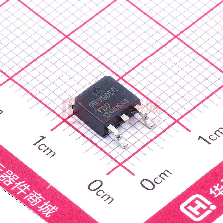

    TO-252(DPAK)
    MOSFETs N沟道 耐压:60V 电流:60A TO-252
FDD13AN06A0-VB 数据手册
FDD13AN06A0-VB www.VBsemi.com FDD13AN06A0-VB Datasheet N-Channel 60 V (D-S) MOSFET FEATURES PRODUCT SUMMARY RDS(on) () ID (A)a 0.010 at VGS = 10 V 58 0.013 at VGS = 4.5 V 56 VDS (V) 60 • 175 °C Junction Temperature • Trench Power MOSFET • Material categorization: D TO-252 G G D S S N-Channel MOSFET ABSOLUTE MAXIMUM RATINGS (TC = 25 °C, unless otherwise noted) Parameter Gate-Source Voltage Continuous Drain Current (TJ = 175 °C)b TC = 25 °C TC = 100 °C Symbol Limit Unit VGS ± 20 V 58 ID 48a 100 IDM Pulsed Drain Current Continuous Source Current (Diode Conduction) IS 50 Avalanche Current IAS 50 EAS 125 Single Avalanche Energy (Duty Cycle  1 %) Maximum Power Dissipation L = 0.1 mH TC = 25 °C TA = 25 °C mJ 136 PD W 3b, 8.3b, c TJ, Tstg Operating Junction and Storage Temperature Range A a - 55 to 175 °C THERMAL RESISTANCE RATINGS Parameter Maximum Junction-to-Ambienta Maximum Junction-to-Case Symbol t  10 sec Steady State RthJA RthJC Typical Maximum 15 18 40 50 0.85 1.1 Unit °C/W Notes: a. Package limited. b. Surface mounted on 1" x 1" FR4 board. c. t  10 s. 服务热线:400-655-8788 1 FDD13AN06A0-VB www.VBsemi.com SPECIFICATIONS (TJ = 25 °C, unless otherwise noted) Parameter Typ.a Max. 2 3 Symbol Test Conditions Min. VDS VGS = 0 V, ID = 250 µA 60 VGS(th) VDS = VGS, ID = 250 µA 1 Gate-Body Leakage IGSS VDS = 0 V, VGS = ± 20 V VDS = 60 V, VGS = 0 V 1 Zero Gate Voltage Drain Current IDSS VDS = 60 V, VGS = 0 V, TJ = 125 °C 50 Unit Static Drain-Source Breakdown Voltage Gate Threshold Voltage ± 100 VDS = 60 V, VGS = 0 V, TJ = 175 °C On-State Drain Currentb ID(on) Drain-Source On-State Resistanceb b Forward Transconductance Dynamic RDS(on) gfs Input Capacitance Ciss Output Capacitance Coss Reverse Transfer Capacitance Crss Total Gate Chargec Qg Gate-Source Chargec Qgs VDS =5 V, VGS = 10 V 0.010 VGS = 10 V, ID = 20 A, TJ = 125 °C 0.016 VGS = 10 V, ID = 20 A, TJ = 175 °C 0.020 VGS = 4.5 V, ID = 15 A 0.013 VDS = 15 V, ID = 20 A 60  S 2650 VGS = 0 V, VDS = 25 V, f = 1 MHz pF 470 225 47 VDS = 30 V, VGS = 10 V, ID = 50 A 70 nC 10 12 Turn-On Delay Timec td(on) 10 20 15 25 35 50 20 30 Rise Turn-Off Delay Timec Fall Timec td(off) µA A VGS = 10 V, ID = 20 A Qgd tr nA 250 60 Gate-Drain Chargec Timec V VDD = 30 V, RL = 0.6  ID  50 A, VGEN = 10 V, Rg = 2.5  tf ns Source-Drain Diode Ratings and Characteristics (TC = 25 °C) 60 Pulsed Current ISM Diode Forward Voltage VSD IF = 20 A, VGS = 0 V 1 1.5 V Reverse Recovery Time trr IF = 20 A, di/dt = 100 A/µs 45 100 ns A Notes: a. For design aid only; not subject to production testing. b. Pulse test; pulse width  300 µs, duty cycle  2 %. c. Independent of operating temperature. Stresses beyond those listed under “Absolute Maximum Ratings” may cause permanent damage to the device. These are stress ratings only, and functional operation of the device at these or any other conditions beyond those indicated in the operational sections of the specifications is not implied. Exposure to absolute maximum rating conditions for extended periods may affect device reliability. 2 服务热线:400-655-8788 2SK2940-VB www.VBsemi.com TYPICAL CHARACTERISTICS (25 °C unless noted) 100 100 VGS = 10 thru 5 V 80 4V I D - Drain Current (A) I D - Drain Current (A) 80 60 40 60 40 TC = 125 °C 20 20 25 °C 2 V, 3 V - 55 °C 0 0 2 0 4 6 8 0 10 1 2 3 4 VDS - Drain-to-Source Voltage (V) VGS - Gate-to-Source Voltage (V) Output Characteristics Transfer Characteristics 120 5 0.015 TC = - 55 °C 0.012 VGS = 4.5 V 25 °C 0.009 125 °C 60 40 20 0 0.006 0.003 0.000 0 10 20 30 I D - Drain Current (A) 40 0 50 20 40 60 80 100 ID - Drain Current (A) Transconductance On-Resistance vs. Drain Current 10 4000 VGS - Gate-to-Source Voltage (V) 3500 3000 C - Capacitance (pF) VGS = 10 V 80 R DS(on) - g fs - Transconductance (S) 100 Ciss 2500 2000 1500 1000 Coss VDS = 30 V ID = 50 A 8 6 4 2 500 Crss 0 0 0 10 20 30 40 50 VDS - Drain-to-Source Voltage (V) Capacitance 60 0 10 20 30 40 50 Qg - Total Gate Charge (nC) Gate Charge 服务热线:400-655-8788 3 FDD13AN06A0-VB www.VBsemi.com TYPICAL CHARACTERISTICS (25 °C unless noted) 100 VGS = 10 V ID = 20 A 2.0 I S - Source Current (A) RDS(on) - On-Resistance (Normalized) 2.5 1.5 1.0 TJ = 25 °C 10 0.5 0.0 - 50 1 - 25 0 25 50 75 100 125 150 TJ - Junction Temperature (°C) On-Resistance vs. Junction Temperature 4 TJ = 150 °C 175 0 0.3 0.6 0.9 1.2 1.5 VSD - Source-to-Drain Voltage (V) Source-Drain Diode Forward Voltage 服务热线:400-655-8788 FDD13AN06A0-VB www.VBsemi.com THERMAL RATINGS 1000 60 Limited by RDS(on)* 100 I D - Drain Current (A) I D - Drain Current (A) 50 40 30 20 10 µs 100 µs 10 1 ms 10 ms 100 ms DC 1 TC = 25 °C Single Pulse 0.1 10 0 0 25 50 75 100 125 TA - Ambient Temperature (°C) 150 175 0.01 0.1 1 10 100 VDS - Drain-to-Source Voltage (V) * VGS > minimum V GS at which R DS(on) is specified Maximum Drain Current vs. Ambient Temperature Safe Operating Area 2 1 Normalized Effective Transient Thermal Impedance Duty Cycle = 0.5 0.2 0.1 0.1 0.05 0.02 Single Pulse 0.01 10- 4 10- 3 10- 2 10- 1 1 Square Wave Pulse Duration (s) 10 100 Normalized Thermal Transient Impedance, Junction-to-Case 服务热线:400-655-8788 5 2SK2940-VB www.VBsemi.com TO-252AA CASE OUTLINE E C2 L3 H D b2 D1 e1 E1 L gage plane height (0.5 mm) e L5 L4 b C A1 INCHES MILLIMETERS A b3 DIM. MIN. MAX. MIN. MAX. A 2.18 2.38 0.086 0.094 A1 - 0.127 - 0.005 b 0.64 0.88 0.025 0.035 b2 0.76 1.14 0.030 0.045 b3 4.95 5.46 0.195 0.215 C 0.46 0.61 0.018 0.024 C2 0.46 0.89 0.018 0.035 D 5.97 6.22 0.235 0.245 D1 5.21 - 0.205 0.265 E 6.35 6.73 0.250 E1 4.32 - 0.170 - H 9.40 10.41 0.370 0.410 e 2.28 BSC 0.090 BSC e1 4.56 BSC 0.180 BSC L 1.40 1.78 0.055 0.070 L3 0.89 1.27 0.035 0.050 L4 - 1.02 - 0.040 L5 1.14 1.52 0.045 0.060 ECN: X12-0247-Rev. M, 24-Dec-12 DWG: 5347 Note • Dimension L3 is for reference only. 6 服务热线:400-655-8788 FDD13AN06A0-VB www.VBsemi.com Disclaimer All products due to improve reliability, function or design or for other reasons, product specifications and data are subject to change without notice. Taiwan VBsemi Electronics Co., Ltd., branches, agents, employees, and all persons acting on its or their representatives (collectively, the "Taiwan VBsemi"), assumes no responsibility for any errors, inaccuracies or incomplete data contained in the table or any other any disclosure of any information related to the product.(www.VBsemi.com) Taiwan VBsemi makes no guarantee, representation or warranty on the product for any particular purpose of any goods or continuous production. To the maximum extent permitted by applicable law on Taiwan VBsemi relinquished: (1) any application and all liability arising out of or use of any products; (2) any and all liability, including but not limited to special, consequential damages or incidental ; (3) any and all implied warranties, including a particular purpose, non-infringement and merchantability guarantee. Statement on certain types of applications are based on knowledge of the product is often used in a typical application of the general product VBsemi Taiwan demand that the Taiwan VBsemi of. Statement on whether the product is suitable for a particular application is non-binding. It is the customer's responsibility to verify specific product features in the products described in the specification is appropriate for use in a particular application. Parameter data sheets and technical specifications can be provided may vary depending on the application and performance over time. All operating parameters, including typical parameters must be made by customer's technical experts validated for each customer application. Product specifications do not expand or modify Taiwan VBsemi purchasing terms and conditions, including but not limited to warranty herein. Unless expressly stated in writing, Taiwan VBsemi products are not intended for use in medical, life saving, or life sustaining applications or any other application. Wherein VBsemi product failure could lead to personal injury or death, use or sale of products used in Taiwan VBsemi such applications using client did not express their own risk. Contact your authorized Taiwan VBsemi people who are related to product design applications and other terms and conditions in writing. The information provided in this document and the company's products without a license, express or implied, by estoppel or otherwise, to any intellectual property rights granted to the VBsemi act or document. Product names and trademarks referred to herein are trademarks of their respective representatives will be all. Material Category Policy Taiwan VBsemi Electronics Co., Ltd., hereby certify that all of the products are determined to be RoHS compliant and meets the definition of restrictions under Directive of the European Parliament 2011/65 / EU, 2011 Nian. 6. 8 Ri Yue restrict the use of certain hazardous substances in electrical and electronic equipment (EEE) - modification, unless otherwise specified as inconsistent.(www.VBsemi.com) Please note that some documents may still refer to Taiwan VBsemi RoHS Directive 2002/95 / EC. We confirm that all products identified as consistent with the Directive 2002/95 / EC European Directive 2011/65 /. Taiwan VBsemi Electronics Co., Ltd. hereby certify that all of its products comply identified as halogen-free halogen-free standards required by the JEDEC JS709A. Please note that some Taiwanese VBsemi documents still refer to the definition of IEC 61249-2-21, and we are sure that all products conform to confirm compliance with IEC 61249-2-21 standard level JS709A.
