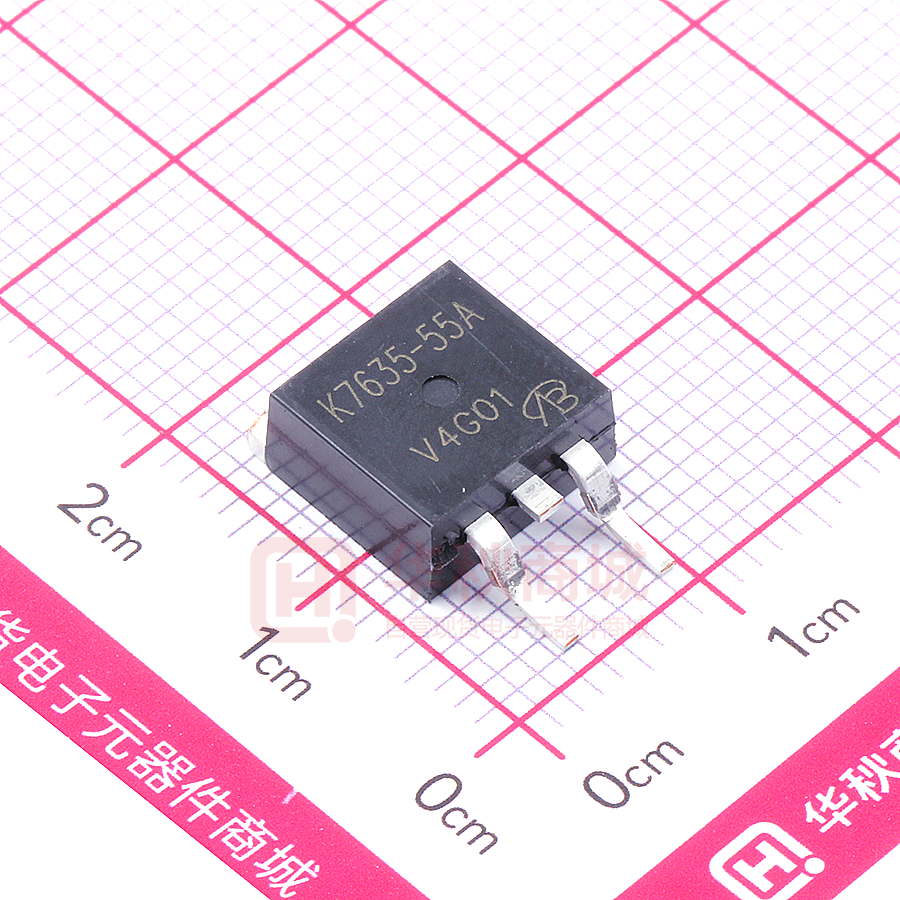

BUK7635-55A www.VBsemi.com N-Channel 60 V (D-S) MOSFET FEATURES PRODUCT SUMMARY VDS (V) 60 RDS(on) () a, e ID (A) 0.023 at VGS = 10 V 50 0.027 at V GS = 4.5 V 40 Qg (Max) 66 nC • Halogen-free According to IEC 61249-2-21 Definition • Surface Mount • Available in Tape and Reel • Dynamic dV/dt Rating • Logic-Level Gate Drive • Fast Switching • Compliant to RoHS Directive 2002/95/EC D D2PAK (TO-263) G G D S S N-Channel MOSFET ABSOLUTE MAXIMUM RATINGS (TC = 25 °C, unless otherwise noted) PARAMETER Drain-Source Voltage Gate-Source Voltage SYMBOL LIMIT VDS VGS 60 ± 10 50 36 200 1.0 0.025 400 150 3.7 4.5 - 55 to + 175 300d TC = 25 °C Continuous Drain Currentf VGS at 10 V ID TC = 100 °C Continuous Drain Current a Pulsed Drain Current IDM Linear Derating Factor Linear Derating Factor (PCB Mount)e Single Pulse Avalanche Energyb EAS TC = 25 °C Maximum Power Dissipation PD Maximum Power Dissipation (PCB Mount)e TA = 25 °C c dV/dt Peak Diode Recovery dV/dt Operating Junction and Storage Temperature Range TJ, Tstg for 10 s Soldering Recommendations (Peak Temperature)d Notes a. Repetitive rating; pulse width limited by maximum junction temperature (see fig. 11). b. VDD = 25 V, starting TJ = 25 °C, L = 179 μH, Rg = 25 , IAS = 51 A (see fig. 12). c. ISD  51 A, dI/dt  250 A/μs, VDD  VDS, TJ  175 °C. d. 1.6 mm from case. e. When mounted on 1" square PCB (FR-4 or G-10 material). f. Current limited by the package, (die current = 51 A). UNIT V A W/°C mJ W V/ns °C 服务热线:400-655-8788 1 BUK7635-55A www.VBsemi.com THERMAL RESISTANCE RATINGS SYMBOL TYP. MAX. Maximum Junction-to-Ambient PARAMETER RthJA - 62 Maximum Junction-to-Ambient (PCB Mount)a RthJA - 40 Maximum Junction-to-Case (Drain) RthJC - 1.0 UNIT °C/W Note a. When mounted on 1" square PCB (FR-4 or G-10 material). SPECIFICATIONS (TJ = 25 °C, unless otherwise noted) PARAMETER SYMBOL TEST CONDITIONS MIN. TYP. MAX. UNIT Static Drain-Source Breakdown Voltage VDS Temperature Coefficient Gate-Source Threshold Voltage VDS VGS = 0, ID = 250 μA 60 - - V VDS/TJ Reference to 25 °C, ID = 1 mA - 0.070 - V/°C VGS(th) VDS = VGS, ID = 250 μA 1.0 - 3.0 V Gate-Source Leakage IGSS VGS = ± 10 V - - ± 100 nA Zero Gate Voltage Drain Current IDSS VDS = 60 V, VGS = 0 V - - 25 VDS = 48 V, VGS = 0 V, TJ = 150 °C - - 250 Drain-Source On-State Resistance Forward Transconductance RDS(on) gfs VGS = 10 V I D = 21 A b - 23 - VGS = 4.5 V I D = 15 A b - 27 - 23 - - - 3000 - - 1000 - - 200 - - 60 - - 10 - VDS = 25 V, ID = 21A b μA  S Dynamic Input Capacitance Ciss Output Capacitance Coss Reverse Transfer Capacitance Crss Total Gate Charge Qg Gate-Source Charge Qgs VGS = 0 V, VDS = 25 V, f = 1.0 MHz, see fig. 5 VGS = 5.0 V ID = 51 A, VDS = 48 V, see fig. 6 and 13b Gate-Drain Charge Qgd - 40 - Turn-On Delay Time td(on) - 17 - - 230 - - 42 - - 110 - - 4.5 - - 7.5 - - - 50c - - 200 Rise Time Turn-Off Delay Time Fall Time Internal Drain Inductance Internal Source Inductance tr td(off) VDD = 30 V, ID = 51 A, Rg = 4.6 , RD = 0.56 , see fig. 10b tf LD LS Between lead, 6 mm (0.25") from package and center of die contact pF nC ns D nH G S Drain-Source Body Diode Characteristics Continuous Source-Drain Diode Current Pulsed Diode Forward Currenta Body Diode Voltage IS ISM VSD Body Diode Reverse Recovery Time trr Body Diode Reverse Recovery Charge Qrr Forward Turn-On Time ton MOSFET symbol showing the integral reverse p - n junction diode D A G TJ = 25 °C, IS = 51 A, VGS = 0 S Vb TJ = 25 °C, IF = 51 A, dI/dt = 100 A/μsb - - 2.5 V - 130 180 ns - 0.84 1.3 μC Intrinsic turn-on time is negligible (turn-on is dominated by LS and LD) Notes a. Repetitive rating; pulse width limited by maximum junction temperature (see fig. 11). b. Pulse width  300 μs; duty cycle  2 %. c. Current limited by the package, (Die Current = 51 A). 服务热线:400-655-8788 2 BUK7635-55A www.VBsemi.com TYPICAL CHARACTERISTICS (25 °C, unless otherwise noted) Fig. 1 - Typical Output Characteristics, TC = 25 °C Fig. 3 - Typical Transfer Characteristics Fig. 2 - Typical Output Characteristics, TC = 150 °C Fig. 4 - Normalized On-Resistance vs. Temperature 服务热线:400-655-8788 3 BUK7635-55A Fig. 5 - Typical Capacitance vs. Drain-to-Source Voltage Fig. 6 - Typical Gate Charge vs. Gate-to-Source Voltage www.VBsemi.com Fig. 7 - Typical Source-Drain Diode Forward Voltage Fig. 8 - Maximum Safe Operating Area 服务热线:400-655-8788 4 BUK7635-55A www.VBsemi.com RD VDS VGS D.U.T. Rg + - VDD 5V Pulse width ≤ 1 µs Duty factor ≤ 0.1 % Fig. 10a - Switching Time Test Circuit VDS 90 % 10 % VGS td(on) Fig. 9 - Maximum Drain Current vs. Case Temperature tr td(off) tf Fig. 10b - Switching Time Waveforms Fig. 11 - Maximum Effective Transient Thermal Impedance, Junction-to-Case 服务热线:400-655-8788 5 BUK7635-55A www.VBsemi.com L Vary tp to obtain required IAS VDS VDS tp VDD Rg D.U.T. + - I AS V DD VDS 5V 0.01 Ω tp Fig. 12a - Unclamped Inductive Test Circuit IAS Fig. 12b - Unclamped Inductive Waveforms Fig. 12c - Maximum Avalanche Energy vs. Drain Current Current regulator Same type as D.U.T. 50 kΩ QG 12 V 5V 0.2 µF 0.3 µF QGS QGD + D.U.T. VG - VDS VGS 3 mA Charge IG ID Current sampling resistors Fig. 13a - Basic Gate Charge Waveform Fig. 13b - Gate Charge Test Circuit 服务热线:400-655-8788 6 BUK7635-55A www.VBsemi.com Peak Diode Recovery dV/dt Test Circuit + D.U.T. Circuit layout considerations • Low stray inductance • Ground plane • Low leakage inductance current transformer + - - Rg • • • • + dV/dt controlled by Rg Driver same type as D.U.T. ISD controlled by duty factor “D” D.U.T. - device under test + - VDD Driver gate drive P.W. Period D= P.W. Period VGS = 10 Va D.U.T. lSD waveform Reverse recovery current Body diode forward current dI/dt D.U.T. VDS waveform Diode recovery dV/dt Re-applied voltage Inductor current VDD Body diode forward drop Ripple ≤ 5 % ISD Note a. VGS = 5 V for logic level devices Fig. 14 - For N-Channel 服务热线:400-655-8788 7 BUK7635-55A www.VBsemi.com RECOMMENDED MINIMUM PADS FOR D2PAK: 3-Lead 0.420 0.355 0.635 (16.129) (9.017) (10.668) 0.145 (3.683) 0.135 (3.429) 0.200 0.050 (5.080) (1.257) Recommended Minimum Pads Dimensions in Inches/(mm) 服务热线:400-655-8788 8 BUK7635-55A www.VBsemi.com Disclaimer All products due to improve reliability, function or design or for other reasons, product specifications and data are subject to change without notice. Taiwan VBsemi Electronics Co., Ltd., branches, agents, employees, and all persons acting on its or their representatives (collectively, the "Taiwan VBsemi"), assumes no responsibility for any errors, inaccuracies or incomplete data contained in the table or any other any disclosure of any information related to the product.(www.VBsemi.com) Taiwan VBsemi makes no guarantee, representation or warranty on the product for any particular purpose of any goods or continuous production. To the maximum extent permitted by applicable law on Taiwan VBsemi relinquished: (1) any application and all liability arising out of or use of any products; (2) any and all liability, including but not limited to special, consequential damages or incidental ; (3) any and all implied warranties, including a particular purpose, non-infringement and merchantability guarantee. Statement on certain types of applications are based on knowledge of the product is often used in a typical application of the general product VBsemi Taiwan demand that the Taiwan VBsemi of. Statement on whether the product is suitable for a particular application is non-binding. It is the customer's responsibility to verify specific product features in the products described in the specification is appropriate for use in a particular application. Parameter data sheets and technical specifications can be provided may vary depending on the application and performance over time. All operating parameters, including typical parameters must be made by customer's technical experts validated for each customer application. Product specifications do not expand or modify Taiwan VBsemi purchasing terms and conditions, including but not limited to warranty herein. Unless expressly stated in writing, Taiwan VBsemi products are not intended for use in medical, life saving, or life sustaining applications or any other application. Wherein VBsemi product failure could lead to personal injury or death, use or sale of products used in Taiwan VBsemi such applications using client did not express their own risk. Contact your authorized Taiwan VBsemi people who are related to product design applications and other terms and conditions in writing. The information provided in this document and the company's products without a license, express or implied, by estoppel or otherwise, to any intellectual property rights granted to the VBsemi act or document. Product names and trademarks referred to herein are trademarks of their respective representatives will be all. Material Category Policy Taiwan VBsemi Electronics Co., Ltd., hereby certify that all of the products are determined to be oHS compliant and meets the definition of restrictions under Directive of the European Parliament 2011/65 / EU, 2011 Nian. 6. 8 Ri Yue restrict the use of certain hazardous substances in electrical and electronic equipment (EEE) - modification, unless otherwise specified as inconsistent.(www.VBsemi.com) Please note that some documents may still refer to Taiwan VBsemi RoHS Directive 2002/95 / EC. We confirm that all products identified as consistent with the Directive 2002/95 / EC European Directive 2011/65 /. Taiwan VBsemi Electronics Co., Ltd. hereby certify that all of its products comply identified as halogen-free halogen-free standards required by the JEDEC JS709A. Please note that some Taiwanese VBsemi documents still refer to the definition of IEC 61249-2-21, and we are sure that all products conform to confirm compliance with IEC 61249-2-21 standard level JS709A.
