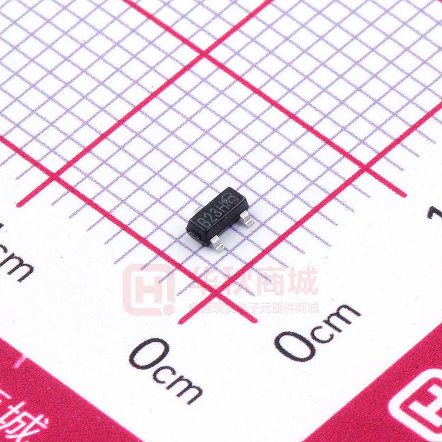

    MOSFETs P-沟道 30V 5.6A SOT-23
SM2307PSAC-TRG-VB 数据手册
SM2307PSAC-TRG-VB www.VBsemi.com SM2307PSAC-TRG-VB Datasheet P-Channel 30 V (D-S) MOSFET FEATURES PRODUCT SUMMARY VDS (V) - 30 RDS(on) () Typ. ID (A)a 0.046 at VGS = - 10 V - 5.6 0.049 at VGS = - 6 V -5 0.054 at VGS = - 4.5 V -4.5 • Trench Power MOSFET • 100 % Rg Tested Qg (Typ.) 11.4 nC APPLICATIONS • For Mobile Computing - Load Switch - Notebook Adaptor Switch - DC/DC Converter S (SOT-23) TO-236 G G 1 3 S D 2 D Top View P-Channel MOSFET ABSOLUTE MAXIMUM RATINGS (TA = 25 °C, unless otherwise noted) Parameter Symbol Limit Drain-Source Voltage VDS - 30 Gate-Source Voltage VGS ± 20 TC = 70 °C - 5.1 ID TA = 25 °C - 5.4b,c - 4.3b,c TA = 70 °C Pulsed Drain Current (t = 100 µs) Continous Source-Drain Diode Current Maximum Power Dissipation IDM TC = 25 °C - 2.1 - 1b,c TC = 25 °C 2.5 TC = 70 °C 1.6 PD TA = 25 °C A - 18 IS TA = 25 °C W 1.25b,c 0.8b,c TA = 70 °C Operating Junction and Storage Temperature Range V - 5.6 TC = 25 °C Continuous Drain Current (TJ = 150 °C) Unit TJ, Tstg °C - 55 to 150 THERMAL RESISTANCE RATINGS Symbol Typical Maximum t5s RthJA 75 100 Steady State RthJF 40 50 Parameter b,d Maximum Junction-to-Ambient Maximum Junction-to-Foot (Drain) Unit °C/W Notes: a. Based on TC = 25 °C. b. Surface mounted on 1" x 1" FR4 board. c. t = 5 s. d. Maximum under steady state conditions is 166 °C/W. 服务热线:400-655-8788 1 SM2307PSAC-TRG-VB www.VBsemi.com SPECIFICATIONS (TJ = 25 °C, unless otherwise noted) Parameter Symbol Test Conditions Min. VDS VGS = 0 V, ID = - 250 µA - 30 Typ. Max. Unit Static Drain-Source Breakdown Voltage VDS Temperature Coefficient VDS/TJ V - 19 ID = - 250 µA mV/°C VGS(th) Temperature Coefficient VGS(th)/TJ Gate-Source Threshold Voltage VGS(th) VDS = VGS , ID = - 250 µA - 2.0 V IGSS VDS = 0 V, VGS = ± 20 V ± 100 nA VDS = - 30 V, VGS = 0 V -1 VDS = - 30 V, VGS = 0 V, TJ = 55 °C -5 Gate-Source Leakage Zero Gate Voltage Drain Current IDSS On-State Drain Currenta ID(on) Drain-Source On-State Resistancea Forward Transconductancea RDS(on) gfs VDS - 5 V, VGS = - 10 V 4 - 0.5 µA A - 2.5 VGS =- 10 V, ID = - 4.4 A 0.046 VGS =- 6 V, ID = - 4 A 0.049 VGS =- 4.5 V, ID = - 3.6 A 0.054 VDS = - 15 V, ID = - 3.4 A 18  S Dynamicb Input Capacitance Ciss Output Capacitance Coss Reverse Transfer Capacitance Crss Total Gate Charge Qg Gate-Source Charge Qgs Gate-Drain Charge Qgd Gate Resistance Rg Turn-On Delay Time Rise Time Turn-Off Delay Time Fall Time Turn-On Delay Time Rise Time Turn-Off Delay Time Fall Time 1295 VDS = - 15 V, VGS = 0 V, f = 1 MHz pF 130 VDS = - 15 V, VGS = - 10 V, ID = - 5.4 A 24 36 11.4 17 3.4 VDS = - 15 V, VGS = - 4.5 V, ID = - 5.4 A VDD = - 15 V, RL = 3.5  ID  - 4.3 A, VGEN = - 10 V, Rg = 1  1.5 7.7 15.4 13 20 4 8 38 57 tf 6 12 td(on) 28 42 td(off) tr td(off) nC 3.8 f = 1 MHz td(on) tr 150 VDD = - 15 V, RL = 3.5  ID  - 4.3 A, VGEN = - 4.5 V, Rg = 1  tf 16 24 30 45 10 20  ns Drain-Source Body Diode Characteristics Continuous Source-Drain Diode Current IS Pulse Diode Forward Current (t = 100 µs) ISM Body Diode Voltage VSD TC = 25 °C - 2.1 - 80 IS = - 4.3 A, VGS 0 V - 0.8 - 1.2 A V Body Diode Reverse Recovery Time trr 15 23 ns Body Diode Reverse Recovery Charge Qrr 7 14 nC Reverse Recovery Fall Time ta Reverse Recovery Rise Time tb IF = - 4.3 A, dI/dt = 100 A/µs, TJ = 25 °C 8 7 ns Notes: a. Pulse test; pulse width  300 µs, duty cycle  2 %. b. Guaranteed by design, not subject to production testing. Stresses beyond those listed under “Absolute Maximum Ratings” may cause permanent damage to the device. These are stress ratings only, and functional operation of the device at these or any other conditions beyond those indicated in the operational sections of the specifications is not implied. Exposure to absolute maximum rating conditions for extended periods may affect device reliability. 服务热线:400-655-8788 2 SM2307PSAC-TRG-VB www.VBsemi.com TYPICAL CHARACTERISTICS (25 °C, unless otherwise noted) 2 50 VGS = 10 V thru 5 V 40 ID - Drain Current (A) ID - Drain Current (A) 1.5 VGS = 4.5 V 30 VGS = 4 V 20 1 TC = 25 °C 0.5 10 TC = 125 °C VGS = 3 V TC = - 55 °C 0 0 0.5 1 1.5 0 2 0 0.6 VDS - Drain-to-Source Voltage (V) Output Characteristics 2.4 3 Transfer Characteristics 1800 0.08 0.06 VGS = 4.5 V 1350 VGS = 6 V C - Capacitance (pF) RDS(on) - On-Resistance (Ω) 1.8 1.2 VGS - Gate-to-Source Voltage (V) VGS = 10 V 0.04 Ciss 900 450 0.02 Coss Crss 0 0 0 10 20 30 40 0 50 18 24 VDS - Drain-to-Source Voltage (V) On-Resistance vs. Drain Current Capacitance 30 1.5 10 ID = 5.4 A ID = 5.4 A VDS = 8 V RDS(on) - On-Resistance (Normalized) VGS - Gate-to-Source Voltage (V) 12 6 ID - Drain Current (A) 8 VDS = 15 V 6 4 VDS = 24 V 2 0 0 10 5 15 20 25 VGS = 10 V, 6 V 1.3 VGS = 4.5 V 1.1 0.9 0.7 - 50 - 25 0 25 50 75 100 125 150 Qg - Total Gate Charge (nC) TJ - Junction Temperature (°C) Gate Charge On-Resistance vs. Junction Temperature 服务热线:400-655-8788 3 SM2307PSAC-TRG-VB www.VBsemi.com TYPICAL CHARACTERISTICS (25 °C, unless otherwise noted) 100 0.080 RDS(on) - On-Resistance (Ω) IS - Source Current (A) ID = 5.4 A 10 TJ = 150 °C TJ = 25 °C 1 0.1 0.060 TJ = 125 °C 0.040 TJ = 25 °C 0.020 0.000 0.0 0.3 0.6 0.9 1.2 2 4 6 8 10 VSD - Source-to-Drain Voltage (V) VGS - Gate-to-Source Voltage (V) Source-Drain Diode Forward Voltage On-Resistance vs. Gate-to-Source Voltage 10 2 ID = 250 μA 8 Power (W) VGS(th) (V) 1.75 1.5 6 4 1.25 2 1 - 50 - 25 0 25 50 75 100 125 150 TA = 25 °C 0 0.01 0.1 1 10 100 1000 TJ - Temperature (°C) Time (s) Threshold Voltage Single Pulse Power (Junction-to-Ambient) 10 5 Limited by RDS(on)* ID - Drain Current (A) 100 μs 1 ms 1 10 ms 100 ms 0.1 10s, 1 s DC 0.01 TA = 25 °C Single Pulse BVDSS Limited 0.001 0.1 1 10 100 VDS - Drain-to-Source Voltage (V) * VGS > minimum VGS at which RDS(on) is specified Safe Operating Area, Junction-to-Ambient 服务热线:400-655-8788 4 SM2307PSAC-TRG-VB www.VBsemi.com TYPICAL CHARACTERISTICS (25 °C, unless otherwise noted) 5.8 ID - Drain Current (A) 4.6 3.4 2.2 0 0 50 25 75 100 125 150 TC - Case Temperature (°C) Current Derating* 1.0 3.1 2.48 1.86 Power (W) Power (W) 0.8 1.24 0.5 0.3 0.62 0.0 0 0 25 50 75 100 TC - Case Temperature (°C) Power, Junction-to-Foot 125 150 0 25 50 75 100 125 150 TA - Ambient Temperature (°C) Power, Junction-to-Ambient * The power dissipation PD is based on TJ(max.) = 150 °C, using junction-to-case thermal resistance, and is more useful in settling the upper dissipation limit for cases where additional heatsinking is used. It is used to determine the current rating, when this rating falls below the package limit. 服务热线:400-655-8788 5 SM2307PSAC-TRG-VB www.VBsemi.com TYPICAL CHARACTERISTICS (25 °C, unless otherwise noted) 1 Normalized Effective Transient Thermal Impedance Duty Cycle = 0.5 0.2 0.1 Notes: 0.1 PDM 0.05 t1 0.02 t2 1. Duty Cycle, D = t1 t2 2. Per Unit Base = RthJA = 166 °C/W 3. TJM - TA = PDMZthJA(t) 4. Surface Mounted Single Pulse 0.01 10 -4 10 -3 10 -2 10 -1 1 100 10 1000 Square Wave Pulse Duration (s) Normalized Thermal Transient Impedance, Junction-to-Ambient 1 Normalized Effective Transient Thermal Impedance Duty Cycle = 0.5 0.2 0.1 0.1 0.05 0.02 Single Pulse 0.01 10 -4 10 -3 10 -2 10 -1 1 10 Square Wave Pulse Duration (s) Normalized Thermal Transient Impedance, Junction-to-Foot 服务热线:400-655-8788 6 SM2307PSAC-TRG-VB www.VBsemi.com SOT-23 (TO-236): 3-LEAD b 3 E1 1 E 2 e S e1 D 0.10 mm C 0.004" A2 A C q Gauge Plane Seating Plane Seating Plane C A1 Dim 0.25 mm L L1 MILLIMETERS INCHES Min Max Min Max A 0.89 1.12 0.035 0.044 A1 0.01 0.10 0.0004 0.004 A2 0.88 1.02 0.0346 0.040 b 0.35 0.50 0.014 0.020 c 0.085 0.18 0.003 0.007 D 2.80 3.04 0.110 0.120 E 2.10 2.64 0.083 0.104 E1 1.20 1.40 0.047 e e1 L 1.90 BSC 0.40 L1 q 0.0748 Ref 0.60 0.016 0.64 Ref S 0.024 0.025 Ref 0.50 Ref 3° 0.055 0.0374 Ref 0.95 BSC 0.020 Ref 8° 3° 8° ECN: S-03946-Rev. K, 09-Jul-01 DWG: 5479 服务热线:400-655-8788 7 SM2307PSAC-TRG-VB www.VBsemi.com 0.049 (1.245) 0.029 0.022 (0.559) (0.724) 0.037 (0.950) (2.692) 0.106 RECOMMENDED MINIMUM PADS FOR SOT-23 0.053 (1.341) 0.097 (2.459) Recommended Minimum Pads Dimensions in Inches/(mm) 服务热线:400-655-8788 8 SM2307PSAC-TRG-VB www.VBsemi.com Disclaimer All products due to improve reliability, function or design or for other reasons, product specifications and data are subject to change without notice. Taiwan VBsemi Electronics Co., Ltd., branches, agents, employees, and all persons acting on its or their representatives (collectively, the "Taiwan VBsemi"), assumes no responsibility for any errors, inaccuracies or incomplete data contained in the table or any other any disclosure of any information related to the product.(www.VBsemi.com) Taiwan VBsemi makes no guarantee, representation or warranty on the product for any particular purpose of any goods or continuous production. To the maximum extent permitted by applicable law on Taiwan VBsemi relinquished: (1) any application and all liability arising out of or use of any products; (2) any and all liability, including but not limited to special, consequential damages or incidental ; (3) any and all implied warranties, including a particular purpose, non-infringement and merchantability guarantee. Statement on certain types of applications are based on knowledge of the product is often used in a typical application of the general product VBsemi Taiwan demand that the Taiwan VBsemi of. Statement on whether the product is suitable for a particular application is non-binding. It is the customer's responsibility to verify specific product features in the products described in the specification is appropriate for use in a particular application. Parameter data sheets and technical specifications can be provided may vary depending on the application and performance over time. All operating parameters, including typical parameters must be made by customer's technical experts validated for each customer application. Product specifications do not expand or modify Taiwan VBsemi purchasing terms and conditions, including but not limited to warranty herein. Unless expressly stated in writing, Taiwan VBsemi products are not intended for use in medical, life saving, or life sustaining applications or any other application. Wherein VBsemi product failure could lead to personal injury or death, use or sale of products used in Taiwan VBsemi such applications using client did not express their own risk. Contact your authorized Taiwan VBsemi people who are related to product design applications and other terms and conditions in writing. The information provided in this document and the company's products without a license, express or implied, by estoppel or otherwise, to any intellectual property rights granted to the VBsemi act or document. Product names and trademarks referred to herein are trademarks of their respective representatives will be all. Material Category Policy Taiwan VBsemi Electronics Co., Ltd., hereby certify that all of the products are determined to be RoHS compliant and meets the definition of restrictions under Directive of the European Parliament 2011/65 / EU, 2011 Nian. 6. 8 Ri Yue restrict the use of certain hazardous substances in electrical and electronic equipment (EEE) - modification, unless otherwise specified as inconsistent.(www.VBsemi.com) Please note that some documents may still refer to Taiwan VBsemi RoHS Directive 2002/95 / EC. We confirm that all products identified as consistent with the Directive 2002/95 / EC European Directive 2011/65 /. Taiwan VBsemi Electronics Co., Ltd. hereby certify that all of its products comply identified as halogen-free halogen-free standards required by the JEDEC JS709A. Please note that some Taiwanese VBsemi documents still refer to the definition of IEC 61249-2-21, and we are sure that all products conform to confirm compliance with IEC 61249-2-21 standard level JS709A.
