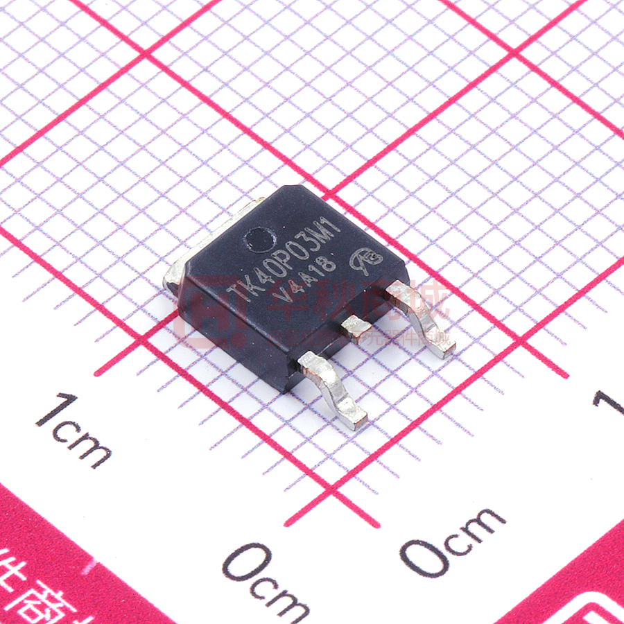

    MOSFETs N-沟道 30V 80A TO-252(DPAK)
TK40P03M1-VB 数据手册
TK40P03M1-VB www.VBsemi.com TK40P03M1-VB Datasheet N-Channel 30-V (D-S) MOSFET FEATURES PRODUCT SUMMARY VDS (V) 30 RDS(on) () ID (A)a, e 0.005 at VGS = 10 V 80 0.006 at VGS = 4.5 V 68 Qg (Typ) 31 nC D • Trench Power MOSFET • 100 % Rg and UIS Tested • Compliant to RoHS Directive 2011/65/EU APPLICATIONS • OR-ing • Server • DC/DC TO-252 G G D S Top View S N-Channel MOSFET ABSOLUTE MAXIMUM RATINGS (TA = 25 °C, unless otherwise noted) Parameter Symbol Limit Drain-Source Voltage VDS 30 Gate-Source Voltage VGS ± 20 Continuous Drain Current (TJ = 175 °C) TC = 25 °C 80 TC = 70 °C 60 TA = 25 °C ID Single Pulse Avalanche Energy Continuous Source-Drain Diode Current L = 0.1 mH TC = 25 °C TA = 25 °C IAS 39 EAS 94.8 TC = 70 °C TA = 25 °C IS A 3.13b, c 205a 135 PD W 3.75b, c 2.63b, c TA = 70 °C TJ, Tstg Operating Junction and Storage Temperature Range mJ 90a, e TC = 25 °C Maximum Power Dissipation A 22b, c 250 IDM Avalanche Current Pulse V 25.8b, c TA = 70 °C Pulsed Drain Current Unit °C - 55 to 175 THERMAL RESISTANCE RATINGS Parameter Maximum Junction-to-Ambient Maximum Junction-to-Case Symbol b, d Typ. Max. t  10 sec RthJA 32 40 Steady State RthJC 0.5 0.6 Unit °C/W Notes: a. Based on TC = 25 °C. b. Surface mounted on 1" x 1" FR4 board. c. t = 10 sec. d. Maximum under steady state conditions is 90 °C/W. e. Calculated based on maximum junction temperature. Package limitation current is 90 A. 服务热线:400-655-8788 1 TK40P03M1-VB www.VBsemi.com SPECIFICATIONS (TJ = 25 °C, unless otherwise noted) Parameter Symbol Test Conditions Min. VDS VGS = 0 V, ID = 250 µA 30 Typ. Max. Unit Static Drain-Source Breakdown Voltage VDS Temperature Coefficient VDS/TJ VGS(th) Temperature Coefficient VGS(th)/TJ Gate-Source Threshold Voltage ID = 250 µA VGS(th) VDS = VGS, ID = 250 µA Gate-Source Leakage IGSS VDS = 0 V, VGS = ± 20 V Zero Gate Voltage Drain Current IDSS On-State Drain Currenta ID(on) Drain-Source On-State Resistancea Forward Transconductancea RDS(on) gfs V 35 mV/°C - 7.5 1.0 2.5 V ± 100 nA VDS = 30 V, VGS = 0 V 1 VDS = 30 V, VGS = 0 V, TJ = 55 °C 10 VDS 5 V, VGS = 10 V 90 µA A VGS = 10 V, ID = 38.8 A 0.005 VGS = 4.5 V, ID = 37 A 0.006 VDS = 15 V, ID = 38.8 A 160  S Dynamicb Input Capacitance Ciss Output Capacitance Coss Reverse Transfer Capacitance Crss Total Gate Charge Qg Gate-Source Charge Qgs Gate-Drain Charge Qgd Gate Resistance Rg Turn-On Delay Time Rise Time Turn-Off Delay Time Fall Time Turn-On Delay Time Rise Time Turn-Off Delay Time Fall Time 2201 VDS = 15 V, VGS = 0 V, f = 1 MHz td(off) pF 270 VDS = 15 V, VGS = 10 V, ID = 38.8 A 61 107 31.5 50 VDS = 15 V, VGS = 4.5 V, ID = 28.8 A 10 f = 1 MHz 1.4 18 27 VDD = 15 V, RL = 0.625  ID  24 A, VGEN = 10 V, Rg = 1  11 17 2.1 70 105 tf 10 15 td(on) 55 83 180 270 55 83 12 18 tr td(off) nC 6 td(on) tr 525 VDD = 15 V, RL = 0.67  ID  22.5 A, VGEN = 4.5 V, Rg = 1  tf  ns Drain-Source Body Diode Characteristics Continuous Source-Drain Diode Current IS Pulse Diode Forward Currenta ISM Body Diode Voltage VSD 120 TC = 25 °C 120 IS = 22 A 0.8 1.2 A V Body Diode Reverse Recovery Time trr 52 78 ns Body Diode Reverse Recovery Charge Qrr 70.2 105 nC Reverse Recovery Fall Time ta Reverse Recovery Rise Time tb IF = 20 A, di/dt = 100 A/µs, TJ = 25 °C 27 25 ns Notes: a. Pulse test; pulse width  300 µs, duty cycle  2 %. b. Guaranteed by design, not subject to production testing. Stresses beyond those listed under “Absolute Maximum Ratings” may cause permanent damage to the device. These are stress ratings only, and functional operation of the device at these or any other conditions beyond those indicated in the operational sections of the specifications is not implied. Exposure to absolute maximum rating conditions for extended periods may affect device reliability. 服务热线:400-655-8788 2 TK40P03M1-VB www.VBsemi.com TYPICAL CHARACTERISTICS (25 °C, unless otherwise noted) 3.0 90 VGS = 10 V thru 4 V 2.4 I D - Drain Current (A) I D - Drain Current (A) 75 60 45 30 1.8 1.2 TC = 25 °C 0.6 15 VGS = 2 V 0 0.0 TC = 125 °C VGS = 3 V TC = - 55 °C 0.0 1.5 2.0 0.5 1.0 VDS - Drain-to-Source Voltage (V) 0 2.5 1 2 3 4 VGS - Gate-to-Source Voltage (V) Output Characteristics Transfer Characteristics 0.0120 600 TC = 25 °C 0.0100 R DS(on) – On-Resistance (Ω) G fs - Transconductance (S) 500 TC = 125 °C 400 300 TC = - 55 °C 200 100 0.0080 0.0060 VGS = 10 V 0.0040 0.0020 0.000 0 0 10 20 30 40 50 60 70 80 90 ID - Drain Current (A) 0 30 45 60 ID - Drain Current (A) Transconductance RDS(on) vs. Drain Current 2500 15 75 90 10 ID = 38.8 A V GS - Gate-to-Source Voltage (V) Ciss 2000 C - Capacitance (pF) VGS = 4.5V 1500 1000 Coss 500 Crss 0 0 VDS = 15 V 8 VDS = 24 V 6 4 2 0 6 12 18 24 VDS - Drain-to-Source Voltage (V) Capacitance 30 0 30 150 90 120 60 Qg - Total Gate Charge (nC) 180 Gate Charge 服务热线:400-655-8788 3 TK40P03M1-VB www.VBsemi.com TYPICAL CHARACTERISTICS (25 °C, unless otherwise noted) 100 VGS = 10 V, ID= 38.8 A VGS = 4.5 V, ID = 27 A 1.0 10 I S - Source Current (A) R DS(on) - On-Resistance (Normalized) 1.2 0.8 0.6 0.4 1 T J = 150 °C T J = 25 °C 0.1 0.01 0.2 - 50 0.001 0 - 25 25 50 75 100 125 150 0 175 0.2 0.4 0.6 0.8 1 VSD - Source-to-Drain Voltage (V) TJ - Junction Temperature (°C) On-Resistance vs. Junction Temperature Forward Diode Voltage vs. Temperature 2.8 0.005 0.004 2.4 TA = 125 °C V GS(th) Variance (V) RDS(on) -On-Resistance (Ω) ID = 38.8 A 0.003 TA = 25 °C 0.002 ID = 250 µA 2.0 1.6 1.2 0.001 0.000 0 2 4 6 8 10 0.8 - 50 - 25 0 25 50 75 100 VGS - Gate-to-Source Voltage (V) TJ - Temperature (°C) RDS(on) vs. VGS vs. Temperature Threshold Voltage 125 150 175 1000 *Limited by rDS (on) I D - Drain Current (A) 100 10 10 ms 100 ms 1 1s 10 s dc 0.1 0.01 TA = 25 °C Single Pulse 0.001 0.1 *VGS 1 10 100 VDS - Drain-to-Source Voltage (V) minimum VGS at which rDS(on) is specified Safe Operating Area, Junction-to-Ambient 服务热线:400-655-8788 4 TK40P03M1-VB www.VBsemi.com 300 300 250 250 Power Dissipation (W) ID - Drain Current (A) TYPICAL CHARACTERISTICS (25 °C, unless otherwise noted) 200 150 Package Limited 100 50 200 150 100 50 0 0 0 25 50 75 100 125 150 175 0 25 50 75 100 125 TC - Case Temperature (°C) TC - Case Temperature (°C) Current Derating* Power Derating 150 175 *The power dissipation PD is based on TJ(max) = 175 °C, using junction-to-case thermal resistance, and is more useful in settling the upper dissipation limit for cases where additional heatsinking is used. It is used to determine the current rating, when this rating falls below the package limit. 2 Normalized Effective Transient Thermal Impedance 1 Duty Cycle = 0.5 0.2 0.1 0.1 0.05 0.02 Single Pulse 0.01 10- 4 10- 3 10- 2 10- 1 1 10 Square Wave Pulse Duration (sec) Normalized Thermal Transient Impedance, Junction-to-Case 服务热线:400-655-8788 5 TK40P03M1-VB www.VBsemi.com TO-252AA CASE OUTLINE E C2 L3 H D b2 D1 e1 E1 L gage plane height (0.5 mm) e L5 L4 b C A1 INCHES MILLIMETERS A b3 DIM. MIN. MAX. MIN. MAX. A 2.18 2.38 0.086 0.094 A1 - 0.127 - 0.005 b 0.64 0.88 0.025 0.035 b2 0.76 1.14 0.030 0.045 b3 4.95 5.46 0.195 0.215 C 0.46 0.61 0.018 0.024 C2 0.46 0.89 0.018 0.035 D 5.97 6.22 0.235 0.245 D1 5.21 - 0.205 0.265 E 6.35 6.73 0.250 E1 4.32 - 0.170 - H 9.40 10.41 0.370 0.410 e 2.28 BSC 0.090 BSC e1 4.56 BSC 0.180 BSC L 1.40 1.78 0.055 0.070 L3 0.89 1.27 0.035 0.050 L4 - 1.02 - 0.040 L5 1.14 1.52 0.045 0.060 ECN: X12-0247-Rev. M, 24-Dec-12 DWG: 5347 Note • Dimension L3 is for reference only. 6 服务热线:400-655-8788 TK40P03M1-VB www.VBsemi.com RECOMMENDED MINIMUM PADS FOR DPAK (TO-252) 0.224 (6.180) 0.087 (2.202) 0.090 (2.286) 0.420 (10.668) 0.243 (5.690) 0.180 0.055 (4.572) (1.397) Recommended Minimum Pads Dimensions in Inches/(mm) 服务热线:400-655-8788 7 TK40P03M1-VB www.VBsemi.com Disclaimer All products due to improve reliability, function or design or for other reasons, product specifications and data are subject to change without notice. Taiwan VBsemi Electronics Co., Ltd., branches, agents, employees, and all persons acting on its or their representatives (collectively, the "Taiwan VBsemi"), assumes no responsibility for any errors, inaccuracies or incomplete data contained in the table or any other any disclosure of any information related to the product.(www.VBsemi.com) Taiwan VBsemi makes no guarantee, representation or warranty on the product for any particular purpose of any goods or continuous production. To the maximum extent permitted by applicable law on Taiwan VBsemi relinquished: (1) any application and all liability arising out of or use of any products; (2) any and all liability, including but not limited to special, consequential damages or incidental ; (3) any and all implied warranties, including a particular purpose, non-infringement and merchantability guarantee. Statement on certain types of applications are based on knowledge of the product is often used in a typical application of the general product VBsemi Taiwan demand that the Taiwan VBsemi of. Statement on whether the product is suitable for a particular application is non-binding. It is the customer's responsibility to verify specific product features in the products described in the specification is appropriate for use in a particular application. Parameter data sheets and technical specifications can be provided may vary depending on the application and performance over time. All operating parameters, including typical parameters must be made by customer's technical experts validated for each customer application. Product specifications do not expand or modify Taiwan VBsemi purchasing terms and conditions, including but not limited to warranty herein. Unless expressly stated in writing, Taiwan VBsemi products are not intended for use in medical, life saving, or life sustaining applications or any other application. Wherein VBsemi product failure could lead to personal injury or death, use or sale of products used in Taiwan VBsemi such applications using client did not express their own risk. Contact your authorized Taiwan VBsemi people who are related to product design applications and other terms and conditions in writing. The information provided in this document and the company's products without a license, express or implied, by estoppel or otherwise, to any intellectual property rights granted to the VBsemi act or document. Product names and trademarks referred to herein are trademarks of their respective representatives will be all. Material Category Policy Taiwan VBsemi Electronics Co., Ltd., hereby certify that all of the products are determined to be RoHS compliant and meets the definition of restrictions under Directive of the European Parliament 2011/65 / EU, 2011 Nian. 6. 8 Ri Yue restrict the use of certain hazardous substances in electrical and electronic equipment (EEE) - modification, unless otherwise specified as inconsistent.(www.VBsemi.com) Please note that some documents may still refer to Taiwan VBsemi RoHS Directive 2002/95 / EC. We confirm that all products identified as consistent with the Directive 2002/95 / EC European Directive 2011/65 /. Taiwan VBsemi Electronics Co., Ltd. hereby certify that all of its products comply identified as halogen-free halogen-free standards required by the JEDEC JS709A. Please note that some Taiwanese VBsemi documents still refer to the definition of IEC 61249-2-21, and we are sure that all products conform to confirm compliance with IEC 61249-2-21 standard level JS709A.
