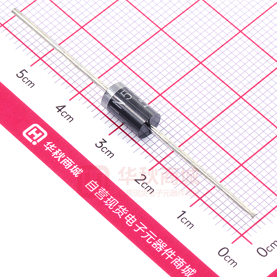

1N5361B
1N5361B
    SUNMATE(森美特)
    DO-27(DO-201AA)
    齐纳/稳压二极管 DO-27 独立式 稳压值:27V
1N5361B 数据手册
1N5338B - 1N5388B AXIAL LEADED SILICON ZENER DIODES VOLTAGE RANGE: 5.1 - 200V POWER: 5.0Wa t t s Features ! Complete Voltage Range 5.1 to 200 Volts ! High peak reverse power dissipation ! High reliability B A ! Low leakage current A Mechanical Data ! ! ! ! ! ! C D Case: DO-201AD, Molded Plastic Terminals: Plated Leads Solderable per MIL-STD-202, Method 208 Polarity: Cathode Band Weight: 1.2 grams (approx.) Mounting Position: Any Marking: Type Number DO-201AD Dim Min Max A 25.40 ¾ B 7.20 9.50 C 1.20 1.30 D 4.80 5.30 All Dimensions in mm Maximum Ratings and Electrical Characteristics Rating @ TA = 25°C unless otherwise specified Symbol Value Unit DC Power Dissipation at T L = 75°C PD 5.0 W Maximum Forward Voltage at IF = 1 A VF 1.2 RθJA 45 K/W Junction Temperature Range TJ - 65 to + 200 °C Storage Temperature Range Ts - 65 to + 200 °C Maximum Thermal Resistance Junction to Ambient Air Note : (1) T L = Lead temperature at 3/8 " (9.5mm) from body Fig. 2 TYPICAL THERMAL RESISTANCE Fig. 1 POWER TEMPERATURE DERATING CURVE 50 JUNCTION-TO-LEAD THERMAL RESISTANCE (C°/W) PD, MAXIMUM DISSIPATION (WATTS) 5 4 3 L = 3/8" (9.5mm) 2 1 0 0 25 50 75 100 125 150 TL, LEAD TEMPERATURE (°C) 175 200 40 30 20 10 0 0 0.2 0.4 0.6 0.8 1.0 LEAD LENGTH TO HEATSINK(INCH) 1 of 2 www.sunmate.tw Nominal Zener Maximum Zener Voltage TYPE 1N5338 B 1N5339B 1N5340B 1N5341B 1N5342B 1N5343B 1N5344B 1N5345B 1N5346B 1N5345B 1N5348B 1N5349 B 1N5350B 1N5351B 1N5352B 1N5353B 1N5354B 1N5355B 1N5356B 1N5357 B 1N5358B 1N5359 B 1N5360B 1N5361B 1N5362B 1N5363B 1N5364B 1N5365B 1N5366B 1N5367 B 1N5368B 1N5369 B 1N5370B 1N537 1B 1N5372B 1N537 3B 1N5374B 1N537 5B 1N5376B 1N537 7 B 1N5378B 1N537 9 B 1N5380B 1N538 1B 1N5382B 1N538 3B 1N5384B 1N538 5B 1N5386B 1N538 7 B 1N538 8 B Impedance Maximum Reverse Maximum DC Leakage Current Zener Current VZ @ IZT IZT ZZT @ IZT ZZK @ IZK IZK (V) (mA) (Ω) (Ω) (mA) (μA) (V) (mA) 5.1 5.6 6.0 6.2 6.8 7.5 8.2 8.7 9.1 10 11 12 13 14 15 16 17 18 19 20 22 24 25 27 28 30 33 36 39 43 47 51 56 60 62 68 75 82 87 91 100 110 120 130 140 150 160 170 180 190 200 240 220 200 200 175 175 150 150 150 125 125 100 100 100 75 75 70 65 65 65 50 50 50 50 50 40 40 30 30 30 25 25 20 20 20 20 20 15 15 15 12 12 10 10 8.0 8.0 8.0 8.0 5.0 5.0 5.0 1.5 1.0 1.0 1.0 1.0 1.5 1.5 2.0 2.0 2.0 2.5 2.5 2.5 2.5 2.5 2.5 2.5 2.5 3.0 3.0 3.5 3.5 4.0 5.0 6.0 8.0 10 11 14 20 25 27 35 40 42 44 45 65 75 75 90 125 170 190 230 330 350 380 430 450 480 400 400 300 200 200 200 200 200 150 125 125 125 100 75 75 75 75 75 75 75 75 100 110 120 130 140 150 160 170 190 210 230 280 350 400 500 620 720 760 760 800 1000 1150 1250 1500 1500 1650 1750 1750 1850 1850 1.0 1.0 1.0 1.0 1.0 1.0 1.0 1.0 1.0 1.0 1.0 1.0 1.0 1.0 1.0 1.0 1.0 1.0 1.0 1.0 1.0 1.0 1.0 1.0 1.0 1.0 1.0 1.0 1.0 1.0 1.0 1.0 1.0 1.0 1.0 1.0 1.0 1.0 1.0 1.0 1.0 1.0 1.0 1.0 1.0 1.0 1.0 1.0 1.0 1.0 1.0 1.0 1.0 1.0 1.0 10 10 10 10 7.5 5.0 5.0 2.0 1.0 1.0 1.0 1.0 0.5 0.5 0.5 0.5 0.5 0.5 0.5 0.5 0.5 0.5 0.5 0.5 0.5 0.5 0.5 0.5 0.5 0.5 0.5 0.5 0.5 0.5 0.5 0.5 0.5 0.5 0.5 0.5 0.5 0.5 0.5 0.5 0.5 0.5 0.5 1.0 2.0 3.0 3.0 5.2 5.7 6.2 6.6 6.9 7.6 8.4 9.1 9.9 10.6 11.5 12.2 12.9 13.7 14.4 15.2 16.7 18.2 19.0 20.6 21.2 22.8 25.1 27.4 29.7 32.7 35.8 38.8 42.6 45.5 47.1 51.7 56.0 62.2 66.0 69.2 76.0 83.6 91.2 98.8 106 114 122 129 137 144 152 930 856 790 765 700 630 580 545 520 475 430 395 365 340 315 295 280 265 250 237 216 198 190 176 170 158 144 132 122 110 100 93.0 86.0 79.0 76.0 70.0 63.0 58.0 54.5 52.5 47.5 43.0 39.5 36.6 34.0 31.6 29.4 28.0 26.4 25.0 23.6 2 of 2 IR @ V R IZM www.sunmate.tw
