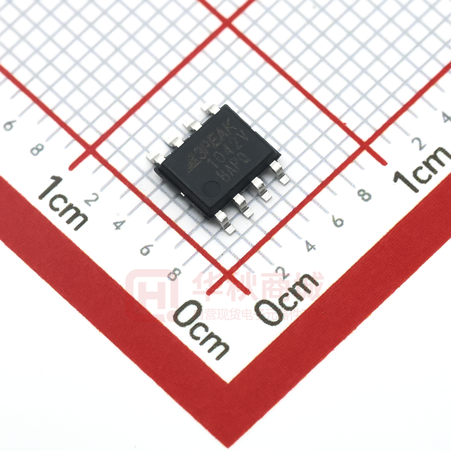

TPT1042, TPT1042V Fault Protected High-speed CAN FD Transceiver with Standby Mode Features Applications Ÿ Meet the ISO 11898-2:2016 and SAE J2284-1 to SAE J2284-5 Physical Layer Standards Ÿ Support CAN FD and Data Rates up to 5 Mbps Ÿ Short propagation delay times and fast loop times Ÿ 5 V power supply, I/O voltage range supports 3V to 5.5V MCU interface Ÿ Very low current standby mode with bus wake-up capability Ÿ Ideal passive behavior to CAN bus when unpowered Ÿ Common-Mode Input Voltage: ±30 V Ÿ Protection feature: Ÿ All Devices Supporting Highly Loaded CAN Networks Ÿ Automotive and Transportation Ÿ Field Industrial Automation, Sensor and Drive Systems Ÿ Building, Security Control Systems − IEC 61000-4-2 ESD proteciton up to ±15kV − Bus Fault protection: ±70V − VCC and VIO(V variants only) undervoltage protection − TXD dominant time-out function and Busdominant time-out function − Thermal shutdown protection Ÿ Available in SOP8 package and leadless DFN3X3 package Ÿ Qualified for Automotive Applications with AECQ100 Reliability Test Description The TPT1042 is a CAN transceiver that meets the ISO11898 high-speed CAN (Controller Area Network) physical layer standard. The device is designed in CAN FD networks up to 5 Mbps and enhances timing margin and higher data rates in long and highly loaded networks. As the design, the device features cross-wire, overvoltage and loss of ground protection from −70 V to +70 V, overtemperature shutdown, and a −30 V to +30 V common-mode input Voltage range. The TPT1042V has a secondary power supply input for I/O level shifting the input pin thresholds and RXD output level. This family has low current standby mode with CAN BUS waked up capability. Additionally, all devices include many protection features to enhance the device and network robustness. The TPT1042 and TPT1042V are available in SOP-8 and DFN3X3-8L packages and is characterized from −40°C to +125°C. Functional Block Diagram www.3peakic.com.cn 1 / 18 Rev.Pre.9 TPT1042, TPT1042V Fault Protected High-speed CAN FD Transceiver with Standby Mode Package Outline Dimensions SO1R(SOP-8) www.3peakic.com.cn 16 / 18 Rev.Pre.9 TPT1042, TPT1042V Fault Protected High-speed CAN FD Transceiver with Standby Mode DF6R (DFN3X3-8L) www.3peakic.com.cn 17 / 18 Rev.Pre.9 TPT1042, TPT1042V Fault Protected High-speed CAN FD Transceiver with Standby Mode Order Information Operating Temperature Range Package Marking Information MSL Transport Media, Quantity Eco Plan TPT1042V-SO1R-S (1) −40 to 125°C SOP8 T42VQ MSL1 Tape and Reel, 4000 Green (1) Order Number TPT1042V-DF6R-S −40 to 125°C DFN3x3-8 T42VQ MSL1 Tape and Reel, 4000 Green (1) −40 to 125°C SOP-8 1042Q MSL1 Tape and Reel, 4000 Green TPT1042-DF6R-S (1) −40 to 125°C DFN3x3-8 1042Q MSL1 Tape and Reel, 4000 Green TPT1042V-SO1R (1) −40 to 125°C SOP8 T42VQ MSL1 Tape and Reel, 4000 Green TPT1042V-DF6R (1) TPT1042-SO1R-S −40 to 125°C DFN3x3-8 T42VQ MSL1 Tape and Reel, 4000 Green TPT1042-SO1R (1) −40 to 125°C SOP-8 1042Q MSL1 Tape and Reel, 4000 Green TPT1042-DF6R (1) −40 to 125°C DFN3x3-8 1042Q MSL1 Tape and Reel, 4000 Green (1) Future product, contact 3PEAK factory for more information and sample (2) Green: 3PEAK defines "Green" to mean RoHS compatible and free of halogen substances. (3) MSL will be updated depending on the qualification report. 3PEAK and the 3PEAK logo are registered trademarks of 3PEAK INCORPORATED. All other trademarks are the property of their respective owners. www.3peakic.com.cn 18 / 18 Rev.Pre.9
TPT1042V-SO1R-S
物料型号: - TPT1042 - TPT1042V
器件简介: - 这些器件是符合ISO11898高速CAN物理层标准的CAN收发器,设计用于CAN FD网络,支持高达5Mbps的数据速率。 - 设备具有交叉线、过电压和地线丢失保护,保护电压范围从-70V到+70V,过温关闭,以及-30V到+30V的共模输入电压范围。 - TPT1042V具有次级电源输入,用于输入引脚阈值和RXD输出电平的I/O电平转换。 - 这些器件在待机模式下电流非常低,并且具有CAN总线唤醒功能。
引脚分配: - VCC:电源引脚 - TXD:CAN总线发送引脚 - VIO:I/O电压引脚 - STB:待机模式引脚 - RXD:CAN总线接收引脚 - GND:地引脚
参数特性: - 支持5V电源,I/O电压范围支持3V到5.5V - 具有非常低的电流待机模式,具有总线唤醒功能 - 符合汽车应用的AECQ100可靠性测试
功能详解: - 理想被动行为:当未供电时,对CAN总线表现为理想被动 - 共模输入电压:±30V - 保护特性:包括IEC 61000-4-2 ESD保护(高达±15kV)、总线故障保护(±70V)、VCC和VIO(仅V变体)欠压保护、TXD占优势时间超时功能和总线占优势时间超时功能、热关闭保护
应用信息: - 适用于汽车和交通、工业自动化、传感器和驱动系统、建筑和安全控制系统等高度加载的CAN网络
封装信息: - TPT1042和TPT1042V提供SOP-8和DFN3X3-8L封装 - 工作温度范围为-40°C至+125°C
订购信息: - 提供了不同封装和工作温度范围的订购编号、标记信息、MSL等级、运输介质和数量、环保计划等信息。
