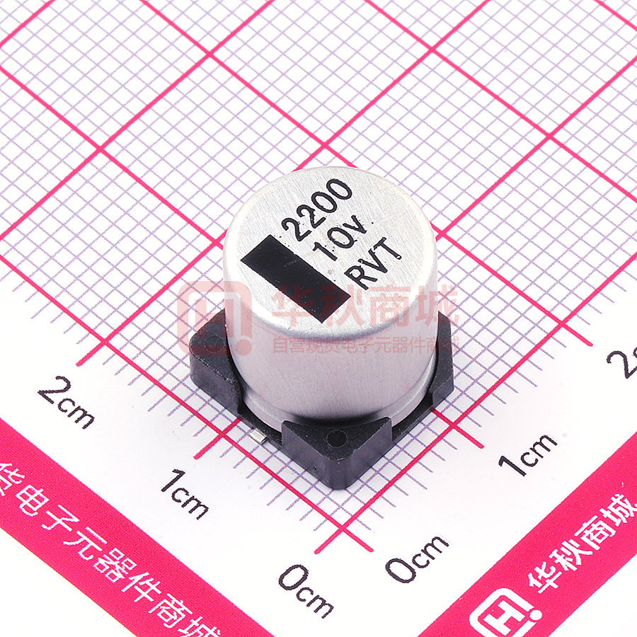

    SMD,D12.5xL13.5mm
    贴片铝电解电容 SMD,D12.5xL13.5mm 2200μF ±20% 10V 2000Hrs@105℃ 450mA@120Hz
RVT1A222M1213 数据手册
NO. 171110 日期 Date: 2017 年 11 月 10 日 客戶 MESSRS 承認書 SPECIFICATIONS FOR APPROVAL 制品名 PRODUCT NAME: 系列 SERIES: 貼片型鋁電解電容器 V-chip Aluminum Electrolytic Capacitors RVT Series, 105℃, ±20%, Standard RVT1A222M1213 規格 2200UF/10V 12.5*13.5 DESCRIPTION 客戶承認欄 APPROVAL COLUMN 發行確認欄 APPROVED BY 審核 CHECKED BY 確認 APPROVED BY 林涛 张琴 1 东莞市容强电子科技有限公司 RVT 系列鋁電解電容器 Aluminum Electrolytic Capacitors RVT SERIES 1.範圍 Scope 適用“RVT 系列”立式片式鋁電解電容器 This specification covers “RVT Series” V-chip aluminum electrolytic capacitors. 2.參考標准 Reference Standard 日本工業標准 JIS C-5141、JIS C-5102 Japanese industrial Standard JIS C-5141 characteristics W and JIS C-5102 except as specified in this specification. 3.環境保護標准 Environmental Protection Standard 遵照歐盟指令 2002/95/EC. Comply with the EU directive 2002/95/EC. 4.使用溫度範圍 Operating Temperature Range -55C ~ +105C 5.電壓範圍 Voltage Range 4 ~ 100V 6.容量範圍 Capacitance Range 0.1~ 1500F 7.容量偏差範圍 Capacitance Tolerance 20% at 120Hz, 20C 8.漏電流 Leakage Current 2 分鐘後讀數 I ≤ 0.01 CV or 3 (A) whichever is greater (after 2 minutes) 9.Tan  測試頻率:120Hz,溫度:20℃ Measurement frequency: 120Hz, Temperature: 20C Rated Voltage (V) Tan  (max.) 4 0.50 6.3 0.30 10 0.24 16 0.20 25 0.18 35 0.14 50 0.14 63 0.12 100 0.12 10.低溫特性 2 測試頻率:120Hz Measurement frequency: 120Hz Rated Voltage (V) Impedance Ratio Z-25C /Z+20C ZT/Z20 (max.) Z-40C /Z+20C 4 7 15 6.3 4 8 10 3 6 RVT 系列鋁電解電容器 Aluminum Electrolytic Capacitors 16 2 4 RVT 25 2 4 35 2 3 50 2 3 63 2 3 100 2 3 SERIES 11.耐久性 105℃施加額定電壓 2000 小時後,電容器應滿足以下要求 After 2000 hours application of rated voltage at 105C, capacitors meet the characteristics requirements listed. 容量變化率 Capacitance Change 損耗角正切值 Tan  漏電流 Leakage Current ±30%初始值內 Within 30% of initial value ≤200%初始規定值 200% or less of initial specified value ≤初始規定值 Initial specified value or less 12.高溫儲存 105℃放置 1000 小時後,滿足以下要求 After storage for 1000H at 105℃±5℃ Capacitance Change Tan  Leakage Current Within 30% of initial value 200% or less of initial specified value 300% of less of Initial specified value. 13.耐焊接熱 Resistance to Soldering Heat 經過回流焊後(參見第 6 頁)在溫室中恢複後,電容器滿足以下要求 After reflow soldering according to Reflow Soldering Condition (see page 5) and restored at room temperature, they meet the characteristics listed. 容量變化率 Capacitance Change 損耗角正切值 Tan  漏電流 Leakage Current ≤±10%初始值 Within 10% of initial value ≤初始規定值 Initial specified value or less ≤初始規定值 Initial specified value or less 14.標識 Marking 電容器標識內容如下: Capacitors shall be legibly marked with the following: 1)產品系列 Manufacture’s mark 2)額定電壓和額定電容 Rated voltage and nominal capacitance 3 3)負極標識 Negative polarit RVT 系列鋁電解電容器 Aluminum Electrolytic Capacitors RVT SERIES 15.圖樣 Drawing (Unit: mm) (4~6.3) Positive C±0.2 0.3max. L A±0.2 E B±0.2 D±0.5 A±0.2 0.5Max. Plastic platefom Negative +0.2 -0.1 0.5~0.8 *L0.3 (Applicable to 6.3 x 7.7) (8, 10) Positive Plastic platform A0.2 E D±0.5 B±0.2 A0.2 0.5Max. C±0.2 0.3max. Negative L0.5 0.8 ~ 1.1 16.尺寸 Dimensions (Unit: mm) DL A B C E L 45.4 1.8 4.3 4.3 1.0 5.4 55.4 2.1 5.3 5.3 1.3 5.4 6.35.4 2.4 6.6 6.6 1.8 5.4 6.37.7 2.4 6.6 6.6 1.8 7.7 86.5 2.9 8.3 8.3 3.1 6.5 810.5 2.9 8.3 8.3 3.1 10.5 1010.5 12.5*13.5 3.2 4.4 10.3 13.0 10.3 13.0 4.2 5.2 10.5 13.4 17.編帶說明 符合標准 JIS C0806 Applicable standard JIS C0806 (RVT、RVS、RVE、RVW、RVK、RVH、RVNseries) 盒帶 17.1.圖樣 Drawing 1 (for 4 ~ 10) 2.0±0.1 1.5 +0.1~-0 0.4 1.75±0.1 P±0.1 A±0.2 B±0.2 F±0.1 W±0.3 4.0±0.1 4 T2±0.2 RVT 系列鋁電解電容器 Aluminum Electrolytic Capacitors RVT SERIES 尺寸 Dimension Series DL W RVT 45.4 55.4 12.0 P 6.35.4 12.0 8.0 16.0 12.0 12.0 6.37.7 86.5 810.5 1010.5 12.5*13.5 16.0 16.0 24.0 24.0 32.0 12.0 12.0 16.0 16.0 23.0 F 5.5 5.5 7.5 7.5 7.5 11.5 11.5 13.9 A 4.7 6.0 7.0 7.0 8.7 8.7 10.7 14.2 B 4.7 6.0 7.0 7.0 8.7 8.7 10.7 16.0 8.3 7.0 11.0 11.0 14.4 T2 5.8 5.8 5.8 17.2.卷盤 Reel Package quantity 包裝數量 3 45.5 卷裝數量 Qty./Reel 2000 pcs. 盒裝數量 Qty./Bag 20000 pcs. 5, 6.35.4 1000 pcs. 10000 pcs. 6.37.7 1000 pcs. 10000pcs. DL 130.5  382 Max. 50 Min. 23 2.0 86.5 1000 pcs. 10000 pcs. 810.5 500 pcs. 5000 pcs. 1010.5 500 pcs. 5000 pcs. 12.5*13.5 200pcs 1000pcs A D A 4 14 5 14 6.3 18 8*6.5 18 8*10.5 26 10*10.5 26 12.5*13.5. 32 18. 無鉛回流焊接 Lead-free Reflow Soldering Condition A. 回流焊條件推薦 Recommended Conditions for Reflow Soldering (1)應采用紅外線及熱風回流焊接,不宜采用汽相加熱回流焊接; A thermal condition system such as infrared radiation (IR) or hot blast should be adopted, and vapor heat transfer systems (VPS) are not recommended. (2)推薦回流焊只進行一次,回流焊次數如果需要二次,必須相隔 30 分鐘以上; Reflow soldering should be performed one time. If the capacitor has to be reflowed twice, 30 minutes must be layout between each time. (3)無鉛回流焊,請符合下述條件: For lead-free type reflow soldering, please observe proper conditions below: a)從 150℃至 200℃的預熱時間在 180 秒鐘以內; The time of preheating from 150°C to 200°C shall be within maximum 180 seconds; b)電容器頂部溫度超過 217℃的焊接時間不超過 tL 秒; The time of soldering temperature at 217°C measured on capacitors' top shall not exceed tL (second); c)電容器頂部尖峰溫度不超過 Tp℃,在 5℃範圍內的實際尖峰溫度時間不超過 tp 秒 The peak temperature on capacitors' top shall not exceed Tp(°C), and the time within 5 RVT 系列鋁電解電容器 Aluminum Electrolytic Capacitors RVT SERIES 5°C of actual peak temperature shall not exceed tp (second). B.回流焊曲線圖 Classification Reflow Profile *1. Average ramp-up rate is 3℃/second max. *2. Ramp-down rate is 6℃/second max. *3 .Time from 25℃ to peak temperature is 8 minutes max. C. 尖峰溫度允許範圍 Size Thickness (mm) Tp(°C) tL (second) tp (second) 4~6.3 2.5 250±0 80 20 8 2.5 240±0 80 10 1010.5L 2.5 235±0 60 10 12.5*13.5 2.5 235±0 50 10 D.表面安裝推薦尺寸 Recommended Land Size (Unit: mm) Y a Y X Size 4 5 6.3 8 10 12.5*13.5 X 1.6 1.6 1.6 2.5 2.5 2.8 Y 2.6 3.0 3.5 3.5 4.0 5.3 a 1.0 1.4 2.1 3.0 4.0 5.0 19.引線原材料 Name TPCS Material Fe Cu Sn Percentage 71.35% 20% 8.65% 6 RVT 系列鋁電解電容器 Aluminum Electrolytic Capacitors RVT SERIES 20.電容器代碼標志 Series (RVT) Voltage (35V) Capacitance (47F) Capacitance Tolerance (20%) Case Diameter (6.3*7.7mm) 1 2 3 4 Series 5 Voltage (WV) 6 7 8 Capacitance (F) 9 1V 470 M 11 - Cap. Tol. (%) 範例: Example: RVT 10 12 13 Case Size 0607 外殼尺寸 Case Size (6.3*7.7mm) 電容量允許偏差 Capacitance Tolerance (20%) 電容量 Capacitance (47F) 電壓 Voltage (35V) 系列 Series (RVT) 额定电压 R.W.Voltage(V) 4 6.3 10 16 25 35 50 63 100 代 号 Code 0G 0J 1A 1C 1E 1V 1H 1J 2A 21. 結構 Construction 電解紙 Electrolytic paper 鋁殼 鋁箔 陽極和陰極 Aluminum foil (Anode & cathode foil) Electrolyte Aluminum case 電解液 Rubber seal Base plate Lead wire 7 RVT 系列鋁電解電容器 Aluminum Electrolytic Capacitors RVT SERIES 22.額定紋波電流的頻率導數 Frequency Coefficient of Allowable Ripple Current Frequency 50Hz 120Hz 300Hz 1kHz 10kHz~ Coefficient 0.70 1.00 1.17 1.36 1.50 23. 最大允許紋波電流 Dimensions & Maximum Permissible Ripple Current Item 1 RVT-P/N RVT1A222M1213 Capacitance (F) Working Voltage (V) Case Size (DL) Allowable ripple current (mA rms) at 105C, 120Hz 2200UF 10V 12.5*13.5 320 8 4.标称电容量、额定电压、额纹波波电流与外形尺寸参应表 6.3(0J) 电压(V) 壳号 μF 10(1A) Ripple Current mA side mm 16(1C) Ripple Current mA side mm 25(1E) side mm Ripple Current mA 4*5.4 4*5.4 12 13 15 21 30 33 side mm Ripple Current mA 4*5.4 4*5.4 4*5.4 4*5.4 5*5.4 5*5.4 6.3*5.4 6.3×7.7 8×6.2 12 13 14 15 26 30 49 91 105 1 2.2 3.3 4.7 10 22 33 47 4*5.4 26 4*5.4 34 4*5.4 4*5.4 5*5.4 5*5.4 100 5*5.4 40 5*5.4 40 6.3*5.4 63 8×10.2 8×6.2 (6.3×7.7) 150 125 (105) 8×10.2 10×10.2 175 199 220 6.3×7.7 105 6.3×7.7 8×6.2 8×10.2 6.3×7.7 105 120 210 162 1000 10×10.2 (8×10.2) 300 (230) 1500 10×10.2 315 330 470 2200 6.3×7.7 8×6.2 105 120 8×10.2 196 8×10.2 195 10×10.2 (8×10.2) 240 (220) 8×10.2 210 10×10.2 (8×10.2) 295 (230) 10×10.2 280 10×10.2 315 10×10.2 12.5×13.5 700 12.5*13.5 326 340 Nominal capacitance,rated voltage,rated ripple current and case size table 35(1V) 电压(V) 50(1H) 100(2A) 1 4*5.4 Ripple Current mA 8 2.2 4*5.4 12 4*5.4 12 5*5.4 14 壳号 μF side mm Ripple Current mA 63(1J) side mm 4*5.4 Ripple Current mA 7.2 4*5.4 Ripple Current mA 7.2 side mm side mm 3.3 4*5.4 14 4*5.4 14 5*5.4 14 6.3*5.4 22 4.7 4*5.4 15 4*5.4 14 6.3*5.4 22 6.3*5.4 23 8×10.2 (6.3×7.7) 77 (35) 10 4*5.4 15 5*5.4 16 6.3×5.4 26 22 5*5.4 33 6.3×5.4 43 8×10.2 (6.3×7.7) 98 (53) (8×10.2) (90) 33 6.3*5.4 45 6.3×7.7 60 8×10.2 112 10×10.2 133 6.3×5.4 54 (6.3×7.7) 10×10.2 (8×10.2) 10*10.2 (63) 170 (140) 178 (8×10.2) (119) 10×10.2 140 10×10.2 196 47 6.3×7.7 (8×10.2) 8×10.2 10×10.2 (8×10.2) 84 (136) 155 220 (190) 10×10.2 470 680 100 150 220 330 10×10.2 230 245 12.5*13.5 490 10×10.2 280 12.5*13.5 550 12.5*13.5 320 9 RVT 系列鋁電解電容器 Aluminum Electrolytic Capacitors RVT SERIES 25. 片式鋁電解電容器一般使用注意事項 Application guideline for V-CHIP aluminum electolytic capacitors A)電路設計 Circuit Design 1) 充分考慮電容器使用和安裝條件在容仕產品目錄的規定範圍內 Please make sure the environmental and mounting conditions to which the capacitor will be exposed are within the conditions specified in RJ’s catalogue. 2) 工作溫度和施加的紋波電流應在容仕產品目錄的規定範圍內 Operating temperature and applied ripple shall be within RJ specification. 3) 在設計電路時,應選擇符合壽命要求的產品 Appropriate capacitors which comply with the life requirement of the products should be selected when designing the circuit. 4) 鋁電解電容器是有極性的,不應加反向電壓或交流電壓。對可能出現反向電壓的電路,應選擇雙極性電 容器。注意:即使雙極性電容器,也不能直接用於純交流電路 Aluminum electrolytic capacitors are polar. Make sure that no reverse voltage or AC voltage is applied to the capacitors. Please use bi-polar capacitors for a circuit that can possibly see reversed polarity. Note: Even bi-polar capacitors cannot be used for AC voltage application. 5)對需要快速和頻繁充放電的電路,不應使用鋁電解電容器,而應選擇特別設計的具有長壽命的電容器 Do not use aluminum electrolytic capacitors in a circuit that requires rapid and very frequent charge / discharge. In this type of circuit, it is necessary to use a special design capacitor with extended life characteristics. 6)不應使用過載電壓 Do not apply excess voltage. 1 直流電壓與紋波電壓疊加後的峰值電壓不應超過額定工作電壓 Please pay attention to that the peak voltage, which is DC voltage overlapped by ripple current, will not exceed the rated voltage. 10 若 2 個以上電容器串聯,應確保施加電壓低於額定值,而且要並聯一個平衡電阻,以使每個電容器所 加電壓相等。 In the case where more than 2 aluminum electrolytic capacitors are used in series, please make sure that applied voltage will be lower than rated voltage and the voltage will be applied to each capacitor equally by using a balancing resistor in parallel with the capacitor 7)電容器不能應用於下述環境條件下: Aluminum electrolytic capacitors shall not be used under the following environmental conditions: ①(a) 電容器被暴露於水(包括濃縮液)、鹽水或油中。 Capacitors will be exposed to water (including condensation), brine or oil. 2 (b) 周圍環境中有氫化硫、亞硫酸、亞硝酸、氯氣、溴氣、溴化甲烷、氨氣等有毒氣體。 Ambient conditions that include toxic gases such as hydrogen sulfide, sulfurous acid, nitrous acid, chlorine, bromine, methyl bromide, ammonium, etc. RVT 系列鋁電解電容器 Aluminum Electrolytic Capacitors RVT SERIES (c) 周圍環境中有臭氧、紫外線及輻射。 Ambient conditions that expose the capacitor to ozone, ultraviolet ray and radiation. 2 嚴重的振動及機械沖擊超過容仕產品目錄的規定範圍。 Severe vibration and physical shock conditions that exceed RJ specification. 振動的測試條件如下 Vibration test condition: 振動頻率範圍 : 10-55-10Hz vibration frequency range : 10~55~10Hz 掃描頻率 : 10-55-10Hz/分鐘 sweep rate : 10~55~10Hz/minute 掃描方式 : 對數 sweep method : logarithmic 振幅或加速度 :1.5mm (最大加速度為 10G) amplitude or acceleration : 1.5mm (max. acceleration is 10G) 振動方向 : X、Y、Z 方向 direction of vibration : X, Y, Z direction 測試時間 : testing time 每個方向 2 小時 : 2 hours per each direction 沖擊一般不適用。 Shock is not applicable normally. 如有特殊要求,請與我們銷售部門聯系。 If a particular condition is required, please contact our sales office. 8) 電解液主要化學溶劑及電解紙為易燃物,且電解液導電。當電解液與 PC 板接觸時,可能會腐蝕 PC 板上 的線路,或造成短路,以致產生煙或著火。因此在電容器封口下端不應有任何線路。 The main chemical solution of the electrolyte and the separator paper used in the capacitors are combustible. The electrolyte is conductive. When it comes in contact with the PC board, there is a possibility of pattern corrosion or short circuit between the circuit pattern, which could result in smoking or catching fire. Do not locate any circuit pattern beneath the capacitor end seal. 9) 設計線路板時應確保發熱元器件不靠近鋁電解電容器或 PC 板的另一面,避免其正好在電容器的下面。 Do not design a circuit board that the heat generating components are placed near the aluminum electrolytic capacitor or on the reverse side of PC board, if that just under the capacitor. 11 10) 設計線路板時應考慮到電容器的電性能可能隨溫度和頻率的變化而變化。 Electrical characteristics may vary depending on changes in temperature and frequency. Please consider this variation when you design circuits. 11) 當 2 個以上電容器並聯時,應考慮到通過這些電容器的電流平衡。 When you install more than 2 capacitors in parallel, please consider the balance of current flowing into the capacitors. 12) 在雙面線路板上安裝電容器時,電容器的安裝位置應避開多餘的基板孔和過孔。 While mounting capacitors on double-side PC board, the capacitors should be away from those unnecessary base plate holes and connection holes. B)安裝 Mounting 1) 一旦電容器經過安裝及加載,不要再試圖用於其他線路板或其他用途。 Once a capacitor has been assembled in the set and power applied, do not attempt to re-use the capacitor in other circuits or application. 2) 貯存超過 2 年的電容器,其漏電流可能增大。若漏電流增大,請使用 1KΩ電阻做充電處理。 RVT 系列鋁電解電容器 Aluminum Electrolytic Capacitors RVT SERIES Leakage current of the capacitors that have been stored for more than 2 years may increase. When leakage current has increased, please perform a voltage treatment using a 1kΩ resistor. 3) 在將電容器安裝在 PC 板之前,請確認其規格和極性。 Please confirm specifications and polarity before installing capacitors on the PC board. 4) 不要將電容器掉在地上,或不要使用掉在地上的電容器。 Do not drop capacitors on the floor, nor use a capacitor that was dropped. 5) 安裝時請不要損傷電容器。 Do not deform the capacitor during installation. 6) 請注意貼片機的吸頭、產品檢測夾具或對中裝置對電容器的機械沖擊。 Please pay attention to the mechanical shock to the capacitor by suction nozzle of the automatic insertion machine or automatic mounter, or by product checker, or by centering mechanism. 7) 回流焊 Reflow soldering 1 請遵守容仕產品目錄中的回流焊條件。 Please follow “Reflow Soldering Conditions” in RJ’s catalogue. 當使用紅外線加熱時,請注意加熱程度,因為紅外線吸收率會隨著電容器顏色和大小的不同而改變。 When an infrared heater is used, please pay attention to the extent of heating since the absorption rate of infrared will vary due to difference in the color and size of the capacitor. 8) 將電容器焊接在 PC 板後,不要傾斜或扭動電容器。 Do not tilt lay down or twist the capacitor body after the capacitor are soldered to the PC board. 2 9) 不要抓住焊接後的電容器搬動 PC 板。 Do not carry the PC board by grasping the soldered capacitor. 10)不要讓任何物品接觸焊接後的電容器。如果 PC 板堆放儲存,請確保 PC 板或其他零部件不觸到電容器。 Please do not allow anything to touch the capacitor after soldering. If PC boards are stored in stack, please make sure the PC board or other components away from the capacitor. 11)焊接後的電容器不應受到任何已焊接 PC 板或其他元器件熱輻射的影響。 The capacitors shall not be effected by any radiated heat from the soldered PC board or other components after soldering. 12)清洗: Cleaning ①不能用鹵化清洗劑清洗電容器。如必須使用鹵化清洗劑,請與我們銷售部門聯系。 Do not clean capacitors with halogenated cleaning agent. However, if it is necessary to clean with halogenated cleaning agent, please contact our sales office. 12 ②推薦清洗方法: Recommended cleaning method 使用範圍:任何類型及規格 Applicable : Any type, any ratings 清洗方法:浸泡、超聲波或其他方法的總清洗時間應在 2 分鐘內。清洗劑溫度應在 40℃以下。清洗後, 應將電容器與 PC 板一起用熱風吹至少 10 分鐘。熱風溫度應低於電容器工作溫度。水洗後若不充分吹 幹,可能導致外觀不良,如座板發脹等。 Cleaning conditions : Total cleaning time shall be within 2 minutes by immersion, ultrasonic or other methods. Temperature of the cleaning agents shall be 40℃ or below. After cleaning, capacitors should be dried by using hot air for the minimum 10 minutes along with the PC board mounted. Hot air temperature should be within the maximum operating temperature of the capacitor. Insufficient dryness after water rinse may cause appearance problems, such as bottom-plate bulge and etc. RVT 系列鋁電解電容器 Aluminum Electrolytic Capacitors 3 RVT SERIES 避免使用破壞臭氧層的清洗劑以保護環境。 Avoid using ozone destructive substances as cleaning agents for protecting global environment. C)安裝後 In the Equipment 1)不要直接用手接觸電容器正負極。 Do not directly touch terminal by hand. 2)不要在正負極之間用導體連接,也不要在電容器及其附近濺撒導電液體,如酸堿溶液等。 Do not link positive terminal and negative terminal by conductor, nor spill conductible liquid such as alkaline or acidic solution on or near the capacitor. 3)在使用環境中應避免濺上水或油,避免陽光直射、紫外線照射、輻射、有毒氣體、振動或機械沖擊。 Please make sure that the ambient conditions where the set is installed are free from spilling water or oil, direct sunlight, ultraviolet rays, radiation, poisonous gases, vibration or mechanical shock. D) 維護和檢驗 Maintenance and Inspection 請定期檢測安裝在工業設備上的電容器。檢測項目如下: Please periodically inspect the aluminum capacitors that are installed in industrial equipment. The following items should be checked: 外觀:明顯缺陷,如防爆閥打開、電解液泄露等。 Appearance: remarkable abnormality such as pressure relief vent opening, electrolyte leaking, etc. 電性能:電容量、損耗角正切、漏電流等,具體數據參見容仕產品目錄和相關產品規格書。 Electrical characteristics: capacitance, dielectric loss tangent, leakage current and etc., which are specified in RJ’s catalogue or alternate product specification. E)緊急情況 13 In an Emergency 1)若看見因防爆閥動作而產生的煙氣,請關閉主開關或拔開離合器。 If you see smoke due to operation of safety vent, please turn off the main switch or pull out the plug from the outlet. 2)若吸入氣體或咽下電解液,應立即用水清洗口腔和喉嚨。 If you breathe the gas or ingest the electrolyte, please wash out your mouth and throat with water immediately. 3)若皮膚沾上電解液,請用肥皂和水清洗幹淨。 If your skin is exposed to the electrolyte, please wash it away using soap and water. F) 儲存 Storage 1) 不要將電容器儲存在溫度和濕度高的地方。 儲存環境應為溫度:5℃-35℃,相對濕度:
