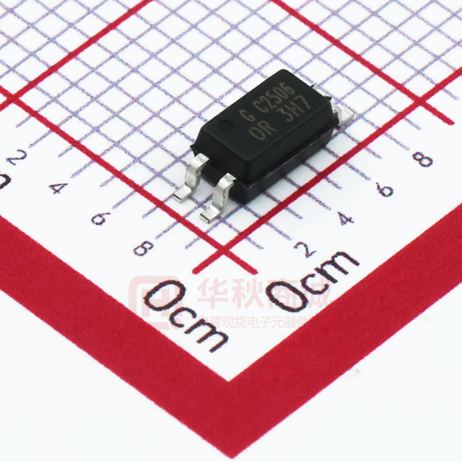

OR-3H7C-TP-G 数据手册
深圳市奥伦德科技股份有限公司 Shenzhen Orient Technology Co ., Ltd ORPC-3H7 Specification Sheet P/N: Photocoupler Customer: Mfg P/N: OR-3H7 Date: SHENZHEN ORIENT TECHNOLOGY CO.,LTD. Block A 3rd Floor No.4 Building,Tian’an Cyber Park,Huangge Rd,LongGang Dist,Shenzhen,GD TEL:0755-29681816 FAX:0755-29681200 www.orient-opto.com Copyright© 2018 Orient Tech Corporation.All rights Reserved 1 A0 深圳市奥伦德科技股份有限公司 Shenzhen Orient Technology Co ., Ltd ORPC-3H7 1、特点(Features) 1.电流转换比(CTR : MIN. 50% at IF = 5mA, VCE = 5V, Ta=25 ℃ ) 2.绝缘电压:(VISO=3,750Vrms) 3.高集电极发射极电压( VCEO = 80V ) 4.温度范围:-55 ℃ to 110 ℃ 5.无铅,符合 RoHS 标准 2、说明(Instructions) 描述该 ORPC-3H7 系列器件包含一个红外发光二极管,光电晶体管探测器。 它们封装在一个 4 引脚 SOP 里面,不含卤素和 Sb2O3. 3、应用范围 (Application Range) (1).需要高密度安装的混合 PCB 基板 (2).可编程控制器 (3).系统器具、测量仪器 4、最大绝对额定值(常温 T=25℃) Max Absolute rated Value (Normal Temperature=25℃) 符号 Symbol 额定值 Rated Value 单位 Unit 正向电流(Forward Current) IF 50 mA 峰值正向电流 (Peak forward current(t=10us) 逆向电压 (Reverse Voltage) IFM 1 A VR 6 V P 70 mW VCEO 80 VECO 7 IC 50 mA PC 150 mW 总功率消耗 (Total Power Dissipation ) Ptot 200 mW *1 绝缘电压 (Insulation Voltage) Viso 3750 Vrms 额定脉冲绝缘电压 (Rated Impulse Insulation Voltag) VIORM 630 V 工作温度 (Working Temperature) Topr -30 to + 110 存贮温度 (Deposit Temperature) Tstg -55 to + 125 *2 焊锡温度 (Soldering Temperature) Tsol 260 参数 Parameter 输入 Input 功率耗损 (Power Dissipation) 集极与射极电压 (Collector and emitter Voltage) 射极与集极电压 输出 Output (Emitter and collector Voltage) 集极电流 (Collector Current) 功率耗损 (Power Dissipation) *1 .工作 AC 为 1 分钟,R.H. = 40 ~ 60% 隔离电压采用以下方法测量。 V ℃ 1. AC For 1 Minute, R.H. = 40 ~ 60% Isolation voltage shall be measured using the following method. (1)主侧阳极与阴极之间、收集器与发射器之间的短二次侧。(1) Short between anode and cathode on the primary side and between collector and emitter on thesecondary side (2)零交叉电路应使用隔离电压测试仪。(2) The isolation voltage tester with zero-cross circuit shall be used. (3)应用电压波形为正弦波。(3) The waveform of applied voltage shall be a sine wave. *2. 锡焊时间为 10 秒 soldering time is 10 seconds Copyright© 2018 Orient Tech Corporation.All rights Reserved 2 A0 深圳市奥伦德科技股份有限公司 Shenzhen Orient Technology Co ., Ltd ORPC-3H7 5、光电特性(常温 T=25℃) (Opto-electronic Characteristics) 参数 Parameter Symbol VF IF=10mA 1.0 --- 1.3 V IR VR=5V --- --- 10 μA Ct V=0, f=1KHz --- 30 250 pF --- --- 100 nA 80 --- --- V 7 --- --- V 100 --- 600 % 5 --- 30 mA --- --- 0.4 V --- Ω 正向电压 (Forward Current) 输入 逆向电流 (Input) (Reverse Voltage) 结电容 (Terminal Capacitance) 集极至射极电流 (Collector Dark Currentt) 输出 (Output) 集极与射极衰减电压 ( Collector-Emitter Breakdown Voltage) ICEO BVCEO 射极与集极衰减电压 (Emitter-Collector Breakdown Voltage) *1 电流转换比 (Current Transfer Ratio) BVECO CTR 集极电流 IC (Collector Current ) 集极与射极饱和电压 传输特性 (Transforming Characteristics) (Collector-Emitter Saturation Voltage) 绝缘阻抗 (Insulation Impedance) VCE(sat) Riso 浮动电容 (Floating Capacitance) 上升时间 (Response Time) VCE=20V, IF=0mA IC=0.1mA IF=0mA IE=10uA IF=0mA IF=5mA VCE=5V IF=8mA IC= 2.4mA DC500V 40~60%R.H. 5×1010 1×1011 Cf V=0, f=1MHz --- 0.6 1 pF tr VCE=5V, IC=2mA --- 2 12 μs --- 3 12 μs RL=100Ω 下降时间 tf (Descend Time)  最小 典型值 最大 单位 Min Typ.* Max Unit 条件 Condition 符号 f=100Hz 电流转换比 Current Conversion Ratio = IC / IF × 100% Copyright© 2018 Orient Tech Corporation.All rights Reserved 3 A0 深圳市奥伦德科技股份有限公司 Shenzhen Orient Technology Co ., Ltd ORPC-3H7 6、电流转换比的等级分类 (Rank table of current transfer ratio CTR) MODEL NO. ORPC-3H7 CTR Rank Min. Max. A 100 160 B 130 260 C 200 400 D 300 600 No mark 50 600 Unit 测试条件(Condition) % IF=5mA, VCE=5V, Ta=25℃ 7、命名规则(Naming Rule) 注: (1).“●”表示无卤素标志。 (2).等级代码 CTR 档位 (3).第一位年份代码,例如:2018=18,如此类推。 第二位周数代码从“01”到“53” (4).型号代码 “3H7” (5).OR 制造商名称 ORIENT Copyright© 2018 Orient Tech Corporation.All rights Reserved 4 A0 深圳市奥伦德科技股份有限公司 Shenzhen Orient Technology Co ., Ltd ORPC-3H7 8、外形尺寸 (Outer Dimension) 9、推荐的焊盘尺寸 (Recommended Foot Print Patterns (Mount Pad)) 九、单位:mm Copyright© 2018 Orient Tech Corporation.All rights Reserved 5 A0 深圳市奥伦德科技股份有限公司 Shenzhen Orient Technology Co ., Ltd ORPC-3H7 10、编带尺寸 (Taping Dimensions) (1).OR-3H7-TP (2).OR-3H7-TP1 类型 符号 尺寸:毫米(英寸) 带宽 W 12±0.3 (0.47) 孔距 P0 4±0.1 (0.15) F 5.5±0.1 (0.217) P2 2±0.1 (0.079) P1 8±0.1 (0.315) 孔距 间隔 封装类型 数量(个) Copyright© 2018 Orient Tech Corporation.All rights Reserved ORPC-3H7 3000 6 A0 深圳市奥伦德科技股份有限公司 Shenzhen Orient Technology Co ., Ltd ORPC-3H7 11、焊接温度曲线 (Temperature Profile Of Soldering) (1).红外回流焊(jedec-std-020c 兼容)(IR Reflow soldering (JEDEC-STD-020C compliant)) 注意:一次焊接回流建议在温度和时间配置文件如下所示的条件下。不要焊接超过三次。 配置项 条件 预热(Preheat) -最低温度(TSmin ) 150˚C -最高温度(TSmax ) 200˚C -时间(最小到最大(TS) 90±30 sec 焊接区(Soldering zone) -温度(TL) 217˚C -时间(tL) 60~100 sec 峰值温度(Peak Temperature) 260˚C 爬升率(Ramp-up rate) 3˚C / sec max. 斜坡下降率(3˚C / sec max.) 3~6˚C / sec Copyright© 2018 Orient Tech Corporation.All rights Reserved 7 A0 深圳市奥伦德科技股份有限公司 Shenzhen Orient Technology Co ., Ltd (2).波峰焊接(jedec22a111 兼容)(Wave ORPC-3H7 soldering (JEDEC22A111 compliant)) 建议在温度条件下一次性焊接。 温度(Temperature) 260+0/-5˚C 时间(Time) 10 sec 预热温度(Preheat temperature) 25 to 140˚C 预热时间(Preheat time) 30 to 80 sec (3).电烙铁手工焊接(Hand soldering by soldering iron) 允许单铅焊接在每一个过程中,建议一次性焊接。 温度(Temperature) 380+0/-5˚C 时间(Time) 3 sec max Copyright© 2018 Orient Tech Corporation.All rights Reserved 8 A0 深圳市奥伦德科技股份有限公司 Shenzhen Orient Technology Co ., Ltd ORPC-3H7 12、特性曲线 (Characteristics Curve) Copyright© 2018 Orient Tech Corporation.All rights Reserved 9 A0 深圳市奥伦德科技股份有限公司 Shenzhen Orient Technology Co ., Ltd Copyright© 2018 Orient Tech Corporation.All rights Reserved 10 ORPC-3H7 A0 深圳市奥伦德科技股份有限公司 Shenzhen Orient Technology Co ., Ltd Copyright© 2018 Orient Tech Corporation.All rights Reserved 11 ORPC-3H7 A0
