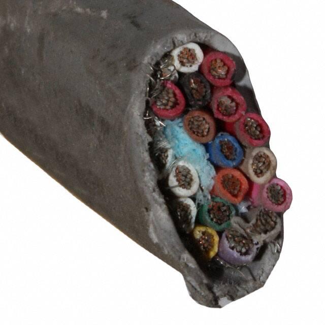

Alpha Wire | 711 Lidgerwood Avenue, Elizabeth, NJ 07207 Tel: 1-800-52 ALPHA (25742), Web: www.alphawire.com Customer Specification PART NO. 5180/20C Construction Diameters (In) 1) Component 1 20 X 1 COND a) Conductor 16 (19/.0117) AWG TC 0.059 b) Insulation 0.016" Wall, Nom. PVC 0.091 (1) Color Code Alpha Wire Color Code D Cond Color Cond Color Cond Color 1 BLACK 8 YELLOW 15 RED/BLACK 2 RED 9 VIOLET 16 WHITE/BLACK 3 WHITE 10 SLATE 17 WHITE/RED 4 GREEN 11 PINK 18 WHITE/GREEN 5 ORANGE 12 TAN 19 WHITE/YELLOW 6 BLUE 13 RED/GREEN 20 WHITE/BLUE 7 BROWN 14 RED/YELLOW 2) Cable Assembly 20 Components Cabled a) Twists: 2.2 Twists/foot (min) b) Core Wrap Nonwoven Polyester Tape, 25% Overlap, Min. 3) Shield: A/P/A Tape, 25% Overlap, Min. a) Drain Wire 16 (19/.0117) AWG TC b) Braid TC,70% Coverage, Min. 4) Jacket 0.053" Wall, Nom.,PVC a) Color(s) Slate, Black, Yellow, Orange, Blue, Green, Red, Sand Beige, White b) Ripcord 1 End 810 Denier Nylon c) Print ALPHA WIRE-* P/N 5180/20C 20C 16 AWG XTRAGUARD(R) 1 SHIELDED (UL) TYPE CM 105C OR AWM 2464 VW-1 --- LLXXXXXX CSA 105C TYPE CMG FT4 CE ROHS (SEQ FOOTAGE) * = Factory Code [Note: Product may have c(UL) or CSA markings depending upon plant of manufacture.] Applicable Specifications 0.617 (0.640 Max.) 1) UL a) Component 1 AWM/STYLE 1569 105°C / 300 VRMS b) Overall AWM/STYLE 2464 80°C / 300 VRMS CM 105°C VW-1 2) CSA International CMG 105°C FT4 3) CE: EU Low Voltage Directive 2006/95/EC Environmental 1) CE: EU Directive 2011/65/EU(RoHS2): This product complies with European Directive 2011/65/EU (RoHS Directive) of the European Parliament and of the Council of 8 June 2011. No Exemptions are required for RoHS Compliance on this item. Consult Alpha Wire's web site for RoHS C of C. 2) REACH Regulation (EC 1907/2006): This product does not contain Substances of Very High Concern (SVHC) listed on the European Union's REACH candidate list in excess of 0.1% mass of the item. For up-to-date information, please see Alpha's REACH SVHC Declaration. 3) California Proposition 65: The outer surface materials used in the manufacture of this part meet the requirements of California Proposition 65. Properties Physical & Mechanical Properties 1) Temperature Range -30 to 105°C 2) Bend Radius 10X Cable Diameter 3) Pull Tension 438 Lbs, Maximum 4) Sunlight Resistance Yes Electrical Properties (For Engineering purposes only) 1) Voltage Rating 300 VRMS 2) Capacitance 57 pf/ft @1 kHz, Nominal Conductor to Conductor 3) Ground Capacitance 103 pf/ft @1 kHz, Nominal 4) Inductance 0.17 µH/ft, Nominal 5) Conductor DCR 4.4 Ω/1000ft @20°C, Nominal 6) OA Shield DCR 1.47 Ω/1000ft @20°C, Nominal Other Packaging Flange x Traverse x Barrel (inches) a) 1000 FT 30 x 14 x 12 Continuous length b) 500 FT 24 x 14 x 12 Continuous length c) 100 FT 16 x 11 x 8 Continuous length d) Bulk(Made-to-order) [Spool dimensions may vary slightly] www.alphawire.com Alpha Wire | 711 Lidgerwood Avenue, Elizabeth, NJ 07207 Tel: 1-800-52 ALPHA (25742) Although Alpha Wire (“Alpha”) makes every reasonable effort to ensure their accuracy at the time of publication, information and specifications described herein are subject to errors or omissions and to changes without notice, and the listing of such information and specifications does not ensure product availability. Alpha provides the information and specifications herein on an “AS IS” basis, with no representations or warranties, whether express, statutory or implied. In no event will Alpha be liable for any damages (including consequential, indirect, incidental, special, punitive, or exemplary) whatsoever, even if Alpha had been advised of the possibility of such damages, whether in an action under contract, negligence or any other theory, arising out of or in connection with the use, or inability to use, the information or specifications described herein. ALPHA WIRE - CONFIDENTIAL AND PROPRIETARY Notice to persons receiving this document and/or technical information. This document is confidential and is the exclusive property of ALPHA WIRE, and is merely on loan and subject to recall by ALPHA WIRE at any time.  By taking possession of this document, the recipient acknowledges and agrees that this document cannot be used in any manner adverse to the interests of ALPHA WIRE, and that no portion of this document may be copied or otherwise reproduced without the prior written consent of ALPHA WIRE.  In the case of conflicting contractual provisions, this notice shall govern the status of this document.  ©2013 ALPHA WIRE - all rights reserved. EU/China ROHS CERTIFICATE OF COMPLIANCE To Whom It May Concern: Alpha Wire Part Number: 5180/20C 5180/20C , RoHS-Compliant Commencing With 8/1/2005 Production This document certifies that the Alpha part number cited above is manufactured in accordance with Directive 2011/65/EU of the European Parliament, better known as the RoHS Directive, with regards to restrictions of the use of certain hazardous substances used in the manufacture of electrical and electronic equipment. The reader is referred to this Directive for the specific definitions and extents of this Directive. No Exemptions are required for RoHS Compliance on this item. It should be noted that this product does not fall within the scope of Directive 2011/65/EU, but this Certificate is offered for cases where this product will be used within EEE that does fit within the Directive's scope.  Additionally, Alpha certifies that the listed part number is in compliance with China RoHS “Marking for Control of Pollution by Electronic Information Products” standard SJ/T 113642006. Substance Maximum Control Value Lead 0.1% by weight (1000 ppm) Mercury 0.1% by weight (1000 ppm) Cadmium 0.01% by weight (100 ppm) Hexavalent Chromium 0.1% by weight (1000 ppm ) Polybrominated Biphenyls (PBB) 0.1% by weight (1000 ppm) Polybrominated Diphenyl Ethers (PBDE) , Including Deca-BDE 0.1% by weight (1000 ppm) The information provided in this document and disclosure is correct to the best of Alpha Wire's knowledge, information and belief at the date of its release. The information provided is designed only as a general guide for the safe handling, storage, and any other operation of the product itself or the one that it will become part of. The intent of this document is not to be considered a warranty or quality specification. Regulatory information is for guidance purposes only. Product users are responsible for determining the applicability of legislation and regulations based on their individual usage of the product. Authorized Signatory for the Alpha Wire Company: Dave Watson, Director of Engineering & QA 4/23/2013
