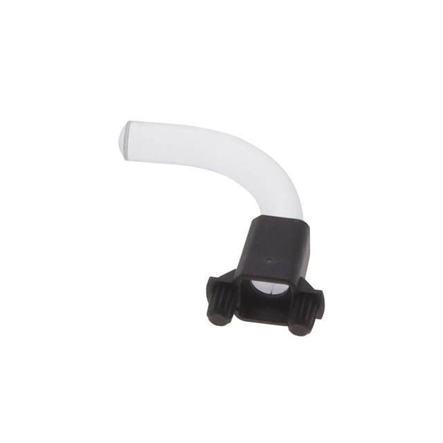

    光导管 单路 透明 刚性 板式安装,压接式,直角
LPR4-0800-0700DP 数据手册
LPR & LPV Rigid Light Pipe New Product Announcement This product features an innovative black adapter design that surrounds the LED and channels the light directly to the lens, eliminating light bleed at the source. Light bleed from the LED can cause false readings and muted or blended colors if other LEDs are present. Light bleed can also weaken the light intensity making it less visible at its destination point. This series is available in two configurations to accommodate most application requirements and they are available in a range of sizes and lens styles. LPV Series This vertical rigid light pipe is an innovative solution that provides zero light bleed at the LED. • Zero light Bleed at the Source • High Vibration Environments • Easy Installation • Lens Diameters: 2mm, 3mm, 4mm • Lens Styles: Flat, Dome • Height Ranges: 0.800” – 1.250” • Industry Use: Datacom, Energy & Utility, Audio/Video, Security, Healthcare LPR Series This right angle rigid light pipe is an innovative solution that provides zero light bleed at the LED. • Zero light Bleed at the Source •High Vibration Environments • Easy Installation • Lens Diameters: 3mm, 4mm, 5mm • Lens Styles: Flat, Dome • Height Ranges: 0.800” – 1.250” • Length Ranges: 0.700” – 3.000” • Industry Use: Datacom, Energy & Utility, Audio/Video, Security, Healthcare For application assistance, product specs or to request a sample visit bivar.com or email us at sales@bivar.com. 4 Thomas | Irvine, CA 92618 | 800.767.3652 www.bivar.com

1. 物料型号:文档中没有明确列出具体的物料型号,但提到了两个系列:LPR和LPV。
2. 器件简介:LPR系列是直角刚性光导管,LPV系列是垂直刚性光导管。两者都是创新的解决方案,能够在LED光源处实现零光漏。
3. 引脚分配:文档中没有提供引脚分配的具体信息。
4. 参数特性: - 适配器宽度:0.24英寸(6.0毫米) - 从PCB到适配器顶部的高度:0.46英寸(11.7毫米) - 适配器材料:黑色聚碳酸酯94V-0,尼龙66 - 光源直径:2mm, 3mm, 4mm(LPV系列)和3mm, 4mm, 5mm(LPR系列) - 透镜样式:平面(Flat)和圆顶(Dome) - 高度范围:0.800英寸至1.250英寸 - 长度范围:0.700英寸至3.000英寸(仅限LPR系列)
5. 功能详解:这些光导管设计用于高振动环境,易于安装,并且通过黑色适配器实现零光漏,从而提高光的可见度和准确性。
6. 应用信息:适用于数据通信、能源与公用事业、音视频、安全和医疗等行业。
