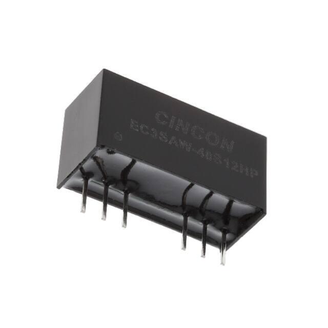

EC3SAWH SERIES 3 WATT 4:1 INPUT ISOLATED DC-DC CONVERTER Features  Efficiency Up to 84.5%  Regulated Outputs  Positive Remote On/Off  3000Vdc I/O Isolation  Continuous Short Circuit Protection  Input Under Voltage Protection  Safety Meets IEC/EN/UL 62368-1  Shock & Vibration MIL-STD-810F Compliant MODEL INPUT OUTPUT NUMBER VOLTAGE VOLTAGE OUTPUT CURRENT INPUT CURRENT % EFF. MIN. MAX. NO LOAD FULL LOAD CAPACITOR LOAD MAX. EC3SAW-24S33HP 9-36 VDC 3.3 VDC 0 mA 700 mA 6 mA 123 mA 78 1800uF EC3SAW-24S05HP 9-36 VDC 5 VDC 0 mA 600 mA 4 mA 154 mA 81 1000uF EC3SAW-24S12HP 9-36 VDC 12 VDC 0 mA 250 mA 14 mA 151 mA 83 220uF EC3SAW-24S15HP 9-36 VDC 15 VDC 0 mA 200 mA 15 mA 152 mA 82.5 120uF EC3SAW-24D05HP 9-36 VDC ±5 VDC 0 mA ±300 mA 8 mA 155 mA 80.5 470uF EC3SAW-24D12HP 9-36 VDC ±12 VDC 0 mA ±125 mA 25 mA 150 mA 83.5 100uF EC3SAW-24D15HP 9-36 VDC ±15 VDC 0 mA ±100 mA 28 mA 152 mA 82 47uF EC3SAW-48S33HP 18-74 VDC 3.3 VDC 0 mA 700 mA 3 mA 61 mA 79 1800uF EC3SAW-48S05HP 18-74 VDC 5 VDC 0 mA 600 mA 3 mA 76 mA 82 1000uF EC3SAW-48S12HP 18-74 VDC 12 VDC 0 mA 250 mA 7 mA 74 mA 84.5 220uF EC3SAW-48S15HP 18-74 VDC 15 VDC 0 mA 200 mA 12 mA 74 mA 84 120uF EC3SAW-48D05HP 18-74 VDC ±5 VDC 0 mA ±300 mA 5 mA 76 mA 82 470uF EC3SAW-48D12HP 18-74 VDC ±12 VDC 0 mA ±125 mA 12 mA 74 mA 84 100uF EC3SAW-48D15HP 18-74 VDC ±15 VDC 0 mA ±100 mA 13 mA 75 mA 83 47uF NOTE: 1. Nominal Input Voltage 24 or 48VDC PART NUMBER Series EC3SAW Nominal Input Voltage II Number of Outputs O Nominal Output Voltage XX Isolation Voltage Remote On/Off Logic L Y 33: 3.3VDC EC3SAW 24: 24 VDC 48: 48 VDC 05: 5.0VDC S: Single D: Dual 12: 12VDC H: 3000Vdc P: Positive 15: 15VDC Part Number Example: EC3SAW-24S12HP: 3W, 4:1 9-36Vdc Input, Single 12Vdc Output, 3000VDC Isolation, Positive Logic www.cincon.com 1 REVISION: V10 EC3SAWH Series TECHNICAL SPECIFICATIONS (All specifications are typical at nominal input, full load at 25℃ unless otherwise noted.) ABSOLUTE MAXIMUM RATINGS PARAMETER Input Voltage Input Surge Voltage Operating Ambient Temperature Maximum Case Temperature NOTES and CONDITIONS Continuous 100ms max. Device Min. 24Vin -0.3 36 48Vin -0.3 74 50 48Vin 100 24S(D)05HP With de-rating, above 71℃ Others Storage Temperature Max. 24Vin With de-rating, above 68℃ At the center part of case plate Typ. -40 All Units Vdc Vdc 85 ℃ 100 ℃ 125 ℃ Units All -55 Device Min. Typ. Max. 24Vin 9 24 36 48Vin 18 48 74 INPUT CHARACTERISTICS PARAMETER NOTES and CONDITIONS Operating Input Voltage Vdc Under Voltage Protection Turn-On Voltage Threshold Turn-Off Voltage Threshold Maximum Input Current No-Load Input Current 24Vin 7.5 48Vin 15.5 24Vin 6 48Vin 12 24Vin 427 Vin=18V, Full load 48Vin 213 mA mA See Model Number Table Input Filter Capacitive All Inrush Current (I2t) As per ETS300 132-2. Vin=Nominal, L=12uH, C=33uF, Load=Full load All Input Reflected Ripple Current Vdc Vin=9V, Full load. Vin=24, 48V, Io=0A 0.01 All Vdc A2s mA 30 OUTPUT CHARACTERISTICS PARAMETER NOTES and CONDITIONS Device Min. Voltage Set Point Accuracy Output Voltage Balance Typ. Max. Units Vin=24, 48V, Full load, Tc=25℃ All -1.5 +1.5 % Vin=24, 48V, Full load, Tc=25℃ Dual -1.0 +1.0 % Single Dual ±0.5 ±1.0 % Output Voltage Regulation Load Regulation Full load to 10% load Line Regulation Vin=High line to low line, full load Cross Regulation Asymmetrical load 25%/100% Temperature Coefficient Tc=-40℃ to 85℃ All ±0.5 % Dual ±5 % All ±0.03 %/℃ Output Voltage Ripple and Noise (5Hz to 20MHz bandwidth) Full load, Tc=25°C, With 0.1uF MLCC Peak-to-Peak across output and Y-cap 470pF Output Current Range Vin= 9 to 36V, 18 to 74V All 50 mV Over Current Protection All Foldback mode. Auto recovery Short Circuit Protection External Load Capacitance www.cincon.com All Full load (resistive) % 120 Continuous, Auto Recovery See Model Number Table 2 A See Model Number Table uF REVISION: V10 EC3SAWH Series EFFICIENCY PARAMETER NOTES and CONDITIONS 100% Load Vin=24V, 48V Device Min. Typ. Max. Units % See Model Number Table DYNAMIC CHARACTERISTICS PARAMETER NOTES and CONDITIONS Device Min. Typ. Max. Units Output Voltage Current Transient Error Band Recovery Time Turn-On Delay and Rise Time Turn-On Delay Time, From On/Off Control Turn-On Delay Time, From Input Output Voltage Rise Time 75% to 100% of Io_max step load change di/dt=0.1A/us (within 1% Vout nominal) Full load (Constant resistive load) All ±6 % All 500 us Von/off to 10%Vo_set, Remote on All 1 2 ms Vin_min to 10%Vo_set, Power up All 1 2 ms 10%Vo_set to 90%Vo_set All 1.5 3 ms Typ. Max. Units 3000 Vdc ISOLATION CHARACTERISTICS PARAMETER NOTES and CONDITIONS Device Isolation Voltage (100% factory Hi-Pot tested @2sec.) 1 minute; Input to output All Isolation Resistance Input to output All Isolation Capacitance Input to output All Min. MΩ 1000 pF 45 FEATURE CHARACTERISTICS PARAMETER NOTES and CONDITIONS Switching Frequency Pulse frequency modulation (PFM) Device Min. All 100 0 Typ. Max. Units KHz On/Off Control, Positive Remote On/Off logic, Refer to –Vin pin Logic Low (Module Off) Von/off at Ion/off=1.0mA All Logic High (Module On) Pin open=On, high impedance All Off Converter Input Current Shutdown input idle current All 1.2 V 1 mA Max. Units GENERAL SPECIFICATIONS PARAMETER NOTES and CONDITIONS MTBF Io=100% of Io_max; MIL-HDBK - 217F_Notice 1, GB, 25℃ Weight Device Min. Typ. Single 2.8 Dual All 2.1 M hours 4.8 grams Case Material Non-Conductive Black Plastic, UL 94V-0 Potting Material Shock/Vibration UL 94V-0 Base: Copper Plating: Matte Tin MIL-STD-810F Compliant Humidity 95% RH max. Non Condensing Altitude 2000m Operating Altitude, 12000m Transport Altitude Thermal Shock MIL-STD-810F EMI Meets EN55032 (with external filter) ESD Meets EN61000-4-2 Level 2: Air ±8kV, Contact ±4kV Perf. Criteria A Radiated immunity Meets EN61000-4-3 Meets EN61000-4-4 Perf. Criteria A Pin Material Class A Surge Meets EN61000-4-5 Level 2: 80~1000MHz, 3V/m Level 2: On power input port, ±0.5kV, external input TVS required Level 2: Line to line, ±0.5kV, external input TVS required Conducted immunity Meets EN61000-4-6 Level 2: 0.15~80MHz, 3V Perf. Criteria A Magnetic Field Immunity Meets EN61000-4-8 Level 2: 50 or 60Hz, 3A/m (rms) Perf. Criteria A Fast Transient Application Note Link Perf. Criteria A EC3SAWH Series App Notes Packaging Information Link www.cincon.com Perf. Criteria A Packaging Information 3 REVISION: V10 EC3SAWH Series CHARACTERISTIC CURVE Power Derating Curve Typical Derating curve for Natural Convection Output Power (%) 120% 100% 68 71 -40 80% 60% 40% Others 20% 24(S/D)05HP 100 0% -40 -20 0 20 40 60 80 100 Ambient Temperature (℃) Performance Data EC3SAW-24S33HP Eff Vs Io @25 Deg. C EC3SAW-24S33HP Pd Vs Po @25 Deg. C 1.2 Power Dissipation (W) 90% Efficincy (%) 80% 70% 60% 50% 9V 40% 12V 24V 30% 36V 20% 10% 1 0.8 0.6 9V 0.4 12V 0.2 24V 36V 0 20% 30% 40% 50% 60% 70% 80% 90% 100% 0% Current Load (%) Output Power (%) EC3SAW-24S05HP Eff Vs Io @25 Deg. C EC3SAW-24S05HP Pd Vs Po @25 Deg. C 1.2 Power Dissipation (W) 90% Efficincy (%) 80% 70% 60% 50% 9V 40% 12V 24V 30% 36V 20% 10% 10% 20% 30% 40% 50% 60% 70% 80% 90% 100% 1 0.8 0.6 9V 0.4 12V 0.2 24V 36V 0 20% 30% 40% 50% 60% 70% 80% 90% 100% Current Load (%) www.cincon.com 0% 10% 20% 30% 40% 50% 60% 70% 80% 90% 100% Output Power (%) 4 REVISION: V10 EC3SAWH EC3SAW-24S12HP Eff Vs Io @25 Deg. C EC3SAW-24S12HP Pd Vs Po @25 Deg. C 1.2 Power Dissipation (W) 90% Efficincy (%) 80% 70% 60% 50% 9V 40% 12V 24V 30% 36V 20% 10% 1 0.8 0.6 9V 0.4 12V 0.2 24V 36V 0 20% 30% 40% 50% 60% 70% 80% 90% 100% 0% Current Load (%) EC3SAW-24S15HP Pd Vs Po @25 Deg. C 1.2 Power Dissipation (W) 90% Efficincy (%) 80% 70% 60% 50% 9V 40% 12V 24V 30% 36V 1 0.8 0.6 9V 0.4 12V 0.2 24V 36V 0 20% 30% 40% 50% 60% 70% 80% 90% 100% 0% Current Load (%) EC3SAW-24D05HP Pd Vs Po @25 Deg. C 1.2 Power Dissipation (W) 90% Efficincy (%) 80% 70% 60% 50% 9V 40% 12V 24V 30% 36V 1 0.8 0.6 9V 0.4 12V 0.2 24V 36V 0 20% 30% 40% 50% 60% 70% 80% 90% 100% 0% Current Load (%) EC3SAW-24D12HP Pd Vs Po @25 Deg. C 1.2 Power Dissipation (W) 90% 80% Efficincy (%) 10% 20% 30% 40% 50% 60% 70% 80% 90% 100% Output Power (%) EC3SAW-24D12HP Eff Vs Io @25 Deg. C 70% 60% 50% 9V 40% 12V 24V 30% 36V 20% 10% 10% 20% 30% 40% 50% 60% 70% 80% 90% 100% Output Power (%) EC3SAW-24D05HP Eff Vs Io @25 Deg. C 20% 10% 10% 20% 30% 40% 50% 60% 70% 80% 90% 100% Output Power (%) EC3SAW-24S15HP Eff Vs Io @25 Deg. C 20% 10% Series 1 0.8 0.6 9V 0.4 12V 0.2 24V 36V 0 20% 30% 40% 50% 60% 70% 80% 90% 100% Current Load (%) www.cincon.com 0% 10% 20% 30% 40% 50% 60% 70% 80% 90% 100% Output Power (%) 5 REVISION: V10 EC3SAWH EC3SAW-24D15HP Eff Vs Io @25 Deg. C EC3SAW-24D15HP Pd Vs Po @25 Deg. C 1.2 Power Dissipation (W) 90% Efficincy (%) 80% 70% 60% 50% 9V 40% 12V 24V 30% 36V 20% 10% 1 0.8 0.6 9V 0.4 12V 0.2 24V 36V 0 20% 30% 40% 50% 60% 70% 80% 90% 100% 0% Current Load (%) EC3SAW-48S33HP Pd Vs Po @25 Deg. C 1.2 Power Dissipation (W) 90% Efficincy (%) 80% 70% 60% 50% 18V 40% 24V 48V 30% 75V 1 0.8 0.6 18V 0.4 24V 0.2 48V 75V 0 20% 30% 40% 50% 60% 70% 80% 90% 100% 0% Current Load (%) EC3SAW-48S05HP Pd Vs Po @25 Deg. C 1.2 Power Dissipation (W) 90% Efficincy (%) 80% 70% 60% 50% 18V 40% 24V 48V 30% 75V 1 0.8 0.6 18V 0.4 24V 0.2 48V 75V 0 20% 30% 40% 50% 60% 70% 80% 90% 100% 0% Current Load (%) EC3SAW-48S12HP Pd Vs Po @25 Deg. C 1.2 Power Dissipation (W) 90% 80% Efficincy (%) 10% 20% 30% 40% 50% 60% 70% 80% 90% 100% Output Power (%) EC3SAW-48S12HP Eff Vs Io @25 Deg. C 70% 60% 50% 18V 40% 24V 48V 30% 75V 20% 10% 10% 20% 30% 40% 50% 60% 70% 80% 90% 100% Output Power (%) EC3SAW-48S05HP Eff Vs Io @25 Deg. C 20% 10% 10% 20% 30% 40% 50% 60% 70% 80% 90% 100% Output Power (%) EC3SAW-48S33HP Eff Vs Io @25 Deg. C 20% 10% Series 1 0.8 0.6 18V 0.4 24V 0.2 48V 75V 0 20% 30% 40% 50% 60% 70% 80% 90% 100% Current Load (%) www.cincon.com 0% 10% 20% 30% 40% 50% 60% 70% 80% 90% 100% Output Power (%) 6 REVISION: V10 EC3SAWH EC3SAW-48S15HP Eff Vs Io @25 Deg. C EC3SAW-48S15HP Pd Vs Po @25 Deg. C 1.2 Power Dissipation (W) 90% Efficincy (%) 80% 70% 60% 50% 18V 40% 24V 48V 30% 75V 20% 10% 1 0.8 0.6 18V 0.4 24V 0.2 48V 75V 0 20% 30% 40% 50% 60% 70% 80% 90% 100% 0% Current Load (%) EC3SAW-48D05HP Pd Vs Po @25 Deg. C 1.2 Power Dissipation (W) 90% Efficincy (%) 80% 70% 60% 50% 18V 40% 24V 48V 30% 75V 1 0.8 0.6 18V 0.4 24V 0.2 48V 75V 0 20% 30% 40% 50% 60% 70% 80% 90% 100% 0% Current Load (%) EC3SAW-48D12HP Pd Vs Po @25 Deg. C 1.2 Power Dissipation (W) 90% Efficincy (%) 80% 70% 60% 50% 18V 40% 24V 48V 30% 75V 1 0.8 0.6 18V 0.4 24V 0.2 48V 75V 0 20% 30% 40% 50% 60% 70% 80% 90% 100% 0% Current Load (%) EC3SAW-48D15HP Pd Vs Po @25 Deg. C 1.2 Power Dissipation (W) 90% 80% Efficincy (%) 10% 20% 30% 40% 50% 60% 70% 80% 90% 100% Output Power (%) EC3SAW-48D15HP Eff Vs Io @25 Deg. C 70% 60% 50% 18V 40% 24V 48V 30% 75V 20% 10% 10% 20% 30% 40% 50% 60% 70% 80% 90% 100% Output Power (%) EC3SAW-48D12HP Eff Vs Io @25 Deg. C 20% 10% 10% 20% 30% 40% 50% 60% 70% 80% 90% 100% Output Power (%) EC3SAW-48D05HP Eff Vs Io @25 Deg. C 20% 10% Series 1 0.8 0.6 18V 0.4 24V 0.2 48V 75V 0 20% 30% 40% 50% 60% 70% 80% 90% 100% Current Load (%) www.cincon.com 0% 10% 20% 30% 40% 50% 60% 70% 80% 90% 100% Output Power (%) 7 REVISION: V10 EC3SAWH Series MECHANICAL SPECIFICATION 0.70 [17.8] 0.14[3.5] Bottom View 1 2 3 0.36[9.2] 0.01 [0.3] 0.10 [2.5] 0.44[11.1] 0.02 [0.5] 0.16 [4.1] 0.86 [21.8] 6 7 8 0.08 [2.0] PIN CONNECTION Single Dual Pin -V Input -V Input 1 2 +V Input +V Input 3 On/Off On/Off 6 +V Output +V Output Common 7 -V Output 8 NC -V Output All Dimensions In Inches(mm) Tolerances : Inches millimeters X.XX±0.02 X.X±0.5 Pin ±0.002 ±0.05 0.02 [0.5] 8 REVISION: V10
