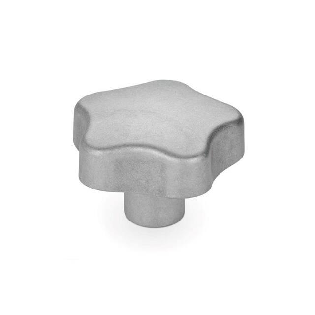

    ALUMINUM STAR KNOB
8MC50/CMT 数据手册
Star Knobs GN 5336 Aluminum, with Tapped or Plain Bore, or Blank Type Inch | Metric 3 Type A C D E Inch table 1 2 d1 d2 Blank type With plain blind bore, tol. H7 With tapped through bore With tapped blind bore Dimensions in: inches - millimeters Thread Type E d 4 −0.02 h1 −1 h2 ≈ t1 t2 min. 1.57 40 1/4 x 20 5/16 x 18 0.59 15 0.98 25 0.49 12.5 0.59 15 0.59 15 1.97 50 5/16 x 18 3/8 x 16 0.75 19 1.26 32 0.63 16 0.71 18 0.79 20 2.36 60 3/8 x 16 1/2 x 13 0.83 21 1.57 40 0.79 20 0.87 22 1.02 26 2.76 70 1/2 x 13 5/8 x 11 1.02 26 1.81 46 0.91 23 1.10 28 1.26 32 Metric table Dimensions in: millimeters - inches 1 2 d1 d2 d 3 H7 2 Thread Type E Type D / Type E Bore Type C Type A Type C / Type D / Type E 40 1.57 M 6 M 8 B 8 15 0.59 26 1.02 25 0.98 12.5 0.49 15 0.59 15 0.59 50 1.97 M 8 M 10 B 10 19 0.75 33 1.30 32 1.26 16 0.63 18 0.71 20 0.79 60 2.36 M 10 M 12 B 12 21 0.83 41 1.61 40 1.57 20 0.79 22 0.87 26 1.02 70 2.76 M 12 M 16 B 16 26 1.02 47 1.85 46 1.81 23 0.91 28 1.10 32 1.26 Specifi cation 4 • Aluminum - Matte, tumbled finish MT Flash mark not visible - Polished finish PL (only available in Type C, D, E in metric sizes) • RoHS compliant d 4 −0.5 h1 −1 h2 ≈ GN 5336 star knobs are forged; therefore, a close grain structure is maintained providing a high tensile strength and a smooth surface. Casting flash is eliminated through high quality production techniques. Original ELESA design, now produced in metal in agreement with ELESA S.p.A. How to order (Blank type) 1 3 4 How to order (Inch) • Special threads, bores, or threaded studs in matte finish only • Other modifications such as cross holes and set screw holes 1 2 3 4 GN 5336-40-1/4X20-E-MT How to order (Metric) 1 2 3 4 GN 5336-60-B12-C-PL www.jwwinco.com | phone: 1-800-877-8351 t2 Information GN 5336-50-A-MT On request t1 min. 1 Handle diameter d1 3 Type 4 Finish 1 Handle diameter d1 2 Thread d 2 3 Type 4 Finish 1 Handle diameter d1 2 Bore d 3 (Thread d 2 ) 3 Type 4 Finish 2.2 Tensioning, Clamping with Knobs | 41
