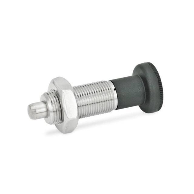

GN 613 Indexing Plungers Steel / Stainless Steel Non Lock-Out, with Fully Threaded Body Metric 2 Type A AK AN With plastic knob, without lock nut With plastic knob, with lock nut With stainless steel knob, without lock nut AKN With stainless steel knob, with lock nut G With threaded stem, without lock nut GK With threaded stem, with lock nut Metric table Dimensions in: millimeters - inches 1 d1 Pin  −0.02 −0.05 Bore H7 d2 Thread d3 d4 Thread l1  ≈ l2 l3 l4 l5 Spring load ≈ Steel Part number installation tool Stainless steel Initial End Initial End  5  0.20 M 10 x 1 21  0.83 M5 45  1.77  5  0.20 22  0.87  6  0.24  4.5  0.18  7N   1.57 lbf 17 N   3.82 lbf  6N   1.35 lbf 15 N   3.37 lbf GN 613.1-5  6  0.24 M 12 x 1.5 25  0.98 M6 54.5  2.15  6  0.24 26  1.02 10  0.39  8  0.31  9N   2.02 lbf 24 N   5.40 lbf  8N   1.80 lbf 21 N   4.72 lbf GN 613.1-6  8  0.31 M 16 x 1.5 31  1.22 M8 69  2.72  8  0.31 34  1.34 12  0.47 10  0.39 11 N   2.47 lbf 30 N   6.74 lbf  9N   2.02 lbf 26 N   5.85 lbf GN 613.1-8 10  0.39 M 20 x 1.5 31  1.22 M8 80  3.15 10  0.39 43  1.69 12  0.47 12  0.47 19 N   4.27 lbf 45 N 10.12 lbf 17 N   3.82 lbf 40 N   8.99 lbf GN 613.1-10 Specification 3 Information • Threaded body -- Steel, blackened finish — Plunger pin hardened -- Stainless steel NI European Standard No. 1.4305 (AISI 303) Plunger pin chemically nickel plated GN 613 indexing plungers are a low cost alternative with reduced dimensions. • Knob (Type A / AK) Plastic Technopolymer (Polyamide PA) -- Temperature resistant up to 230 °F (110 °C) -- Black, matte finish -- Not removable GN 613.1 installation tools, available as accessory, reduce the installation time and make it easier to counter hold the plunger during the assembly. The tool is inserted laterally between the knob and the threaded body and engages in the slot provided. • Knob (Type AN / AKN) Stainless steel European Standard No. 1.4305 (AISI 303) Not removable Accessory Type G and GK with threaded stem are for applications where a special knob or attachment is required, or for such cases where the spindle is linked directly to an operating mechanism. The indexing plungers completely made of stainless steel parts are a good choice for use in corrosion free environments. see also... • List of Indexing Plunger Types • Installation tools GN 613.1 (Part number, see table) • Lock nut DIN 439 B / ISO 8675 -- Steel, blackened finish -- Stainless steel (A2) How to order (Steel, with plastic knob) • RoHS compliant How to order (Stainless steel, with stainless steel knob) 1 2 GN 613-8-G 1 2 3 GN 613-5-AKN-NI 12 | 3.1 Indexing, Locking, Blocking with Pins and Ball-Shaped Elements 1 Pin diameter d1 2 Type 1 Pin diameter d1 2 Type 3 Material www.jwwinco.com | phone: 1-800-877-8351
