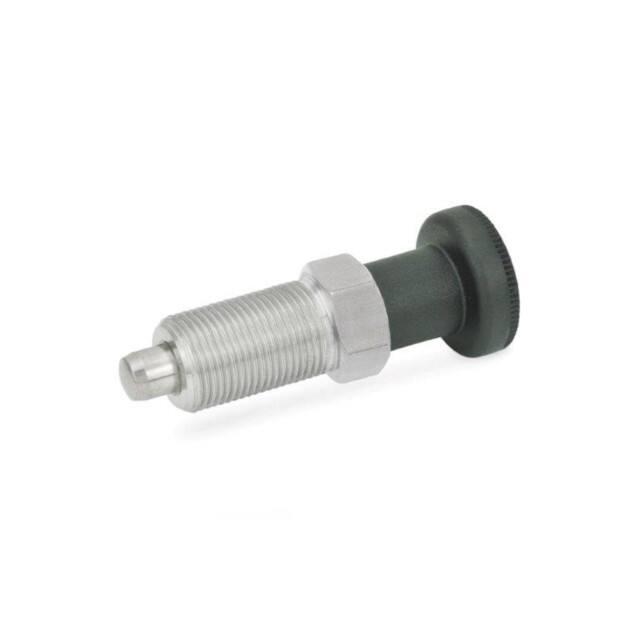

GN 617 Indexing Plungers Steel / Stainless Steel Non Lock-Out Inch | Metric 3 Type A With plastic knob, without lock nut AK With plastic knob, with lock nut AN With stainless steel knob, without lock nut AKN With stainless steel knob, with lock nut G With threaded stem, without lock nut GK With threaded stem, with lock nut Specification 4 • Threaded body Steel, blackened finish — Plunger pin hardened • Threaded body Stainless steel NI European Standard No. 1.4305 (AISI 303) Plunger pin chemically nickel plated • Knob (Type A / AK) Plastic Technopolymer (Polyamide PA) -- Temperature resistant up to 230 °F (110 °C) -- Black, matte finish -- Not removable Information GN 617 indexing plungers are standard components used for a wide range of indexing applications. Type G and GK with threaded stem are for applications where a special knob or attachment is required, or for such cases where the spindle is linked directly to an operating mechanism. The indexing plungers completely made of stainless steel parts are a good choice for use in corrosion free environments. see also... • List of Indexing Plunger Types • Mounting Blocks GN 412.1 • Locating Bushings GN 412.2 / GN 412.4 • Spacer Bushings GN 609.5 (to Limit the Thread Length) • Knob (Type AN / AKN) Stainless steel European Standard No. 1.4305 (AISI 303) Not removable • Inch size lock nut -- Steel, blackened finish ANSI/ASME B18.2.2 -- 18-8 Stainless steel (A2) • Metric size lock nut -- Steel, blackened finish DIN 439 B / ISO 8675 -- Stainless steel (A2) DIN 439 B / ISO 8675 • RoHS compliant How to order (Inch, steel, with plastic knob) 1 2 3 GN 617-5-3/8X24-A How to order (Inch, stainless steel, with plastic knob) 1 2 3 4 GN 617-6-1/2X13-AK-NI How to order (Metric, stainless steel, with stainless steel knob) 1 2 3 4 GN 617-8-M16X1.5-AKN-NI 2 | 3.1 Indexing, Locking, Blocking with Pins and Ball-Shaped Elements 1 Pin diameter d1 2 Thread d 2 3 Type 1 Pin diameter d1 2 Thread d 2 3 Type 4 Material 1 Pin diameter d1 2 Thread d 2 3 Type 4 Material www.jwwinco.com | phone: 1-800-877-8351 GN 617 Indexing Plungers continued Inch table 1 2 d1 d2 Pin −0.001 Thread −0.002 Bore +0.001 Dimensions in: inches - millimeters d3 d4 Thread e l1 ≈ l2 l3 l4 l5 min. l6 l7 A/F Spring load ≈ Steel Stainless steel Initial 5 6 8 .20 3/8 x 24 .83 M5 .54 13.8 1.77 45 5 .24 1/2 x 13 .98 25 M6 .64 16.2 2.15 54.5 6 .31 5/8 x 11 1.22 31 M8 .86 21.9 2.72 69 8 21 .20 17 .67 5 .24 .79 20 6 .31 1.02 26 8 .20 .24 .31 15 17 21 .59 .67 .83 6 10 12 .24 .18 4.5 .39 .47 8 10 .31 .39 12 14 19 End Initial End .47 1.57 lbf 7N 3.82 lbf 17 N 1.35 lbf 6N 3.37 lbf 15 N .55 2.02 lbf 9N 5.40 lbf 24 N 1.80 lbf 8N 4.72 lbf 21 N .75 2.47 lbf 11 N 6.74 lbf 30 N 2.02 lbf 9N 5.85 lbf 26 N Metric table 1 2 d1 d2 Pin −0.02 −0.05 Bore H7 5 6 8 10 .20 .24 .31 .39 Thread Dimensions in: millimeters - inches d3 d4 Thread e l1 ≈ l2 l3 l4 l5 min. l6 l7 A/F Spring load ≈ Steel Initial M 10 x 1 21 M5 13.8 .54 45 1.77 5 M 12 x 1.5 25 M6 16.2 .64 54.5 2.15 6 M 16 x 1.5 31 1.22 M8 21.9 .86 69 2.72 8 M 20 x 1.5 31 1.22 M8 25.4 1.00 80 3.15 10 .83 .98 www.jwwinco.com | phone: 1-800-877-8351 .20 .24 17 20 .67 .79 5 6 .31 26 1.02 8 .39 33 1.30 10 .20 .24 .31 .39 15 17 23 .59 .67 .91 30 1.18 6 10 12 12 .24 .39 .47 .47 4.5 .18 12 8 14 10 12 .31 .39 .47 19 22 Stainless steel End Initial End .47 7N 1.57 lbf 17 N 3.82 lbf 6N 1.35 lbf 15 N 3.37 lbf .55 9N 2.02 lbf 24 N 5.40 lbf 8N 1.80 lbf 21 N 4.72 lbf .75 11 N 2.47 lbf 30 N 6.74 lbf 9N 2.02 lbf 26 N 5.85 lbf .87 19 N 4.27 lbf 45 N 10.12 lbf 17 N 3.82 lbf 40 N 8.99 lbf 3.1 Indexing, Locking, Blocking with Pins and Ball-Shaped Elements | 3
