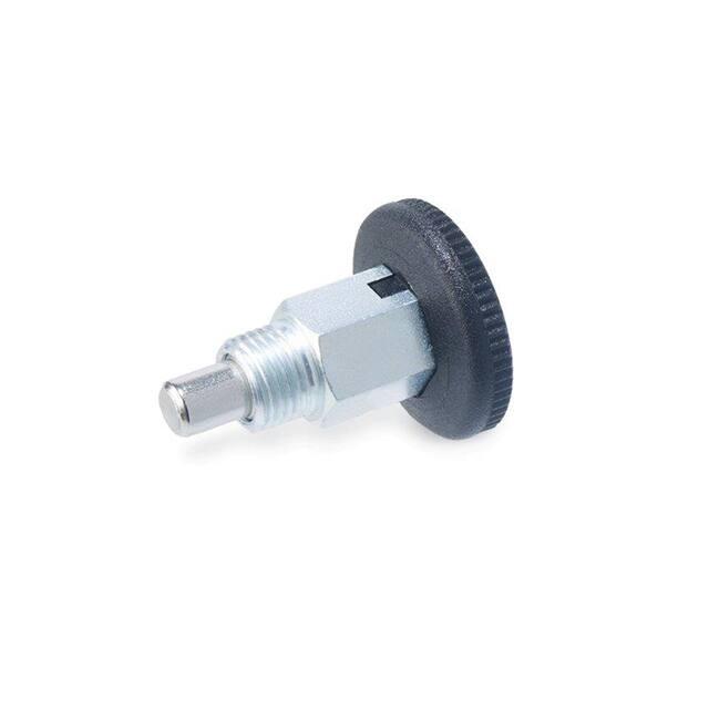

    STEEL MINI INDEXING PLUNGER
822.1-4-C-ST 数据手册
GN 822 GN 822.1 Mini Indexing Plungers Hidden Lock Mechanism Open Lock Mechanism Steel / Stainless Steel, Lock-Out and Non Lock-Out Metric 2 Type B Non lock-out C Lock-out Metric table Dimensions in: millimeters - inches 1 d1 0 Pin  −0.06 Bore  +0.05 +0.1 d2 Thread d3 d4 l2 l3 min. l4 A/F min. Spring load ≈ Initial End 4  .16 M   8 x 0.75 21   .83 15   .59 26.5  1.04 5  .20 5  .20 3.5  .14 10   .39 4.5 N 1.01 lbf 12 N   2.70 lbf 5  .20 M   8 x 0.75 21   .83 15   .59 26.5  1.04 5  .20 5  .20 3.5  .14 10   .39 4.5 N 1.01 lbf 12 N   2.70 lbf 6  .24 M 10 x 1 25   .98 18   .71 34  1.34 7  .28 7  .28 4.5  .18 12   .47 5N 1.12 lbf 18 N   4.05 lbf 7  .28 M 10 x 1 25   .98 18   .71 34  1.34 7  .28 7  .28 4.5  .18 12   .47 5N 1.12 lbf 18 N   4.05 lbf Specification 3 4 • Threaded body -- Steel Zinc plated, blue passivated finish ST -- Stainless steel NI European Standard No. 1.4305 (AISI 303) • Plunger pin Stainless steel European Standard No. 1.4305 (AISI 303) • Spring Stainless steel European Standard No. 1.4310 (AISI 301) • Knob Plastic Technopolymer (Polyamide PA) -- Temperature resistant up to 230 °F (110 °C) -- Black, matte finish — RT -- Red, RAL 3000, matte finish -- Not removable • RoHS compliant 2 l1 Information GN 822 mini indexing plungers feature small, compact dimensions. They are designed for installation in thin walled sheet metal applications. Plungers are inserted into position by holding them by the knurled knob. The wrench flats on the lock nut are exposed when the pin is retracted, so that the plunger can be easily tightened by means of an open-end wrench. Type C offers a lock-out position for applications that require the plunger pin to be retracted for an extended period of time. After retracting the indexing pin, turn the knob 30 degrees, release the knob and it will stay in the retracted position via a notch. In the rest position, the lock-out mechanism is completely concealed by the knob. GN 609.5 spacer bushings are to be ordered separately. How to order (Hidden lock mechanism, black knob) 1 2 3 GN 822-6-C-ST How to order (Open lock mechanism, red knob) 1 2 3 4 GN 822.1-4-B-NI-RT | 3.1 Indexing, Locking, Blocking with Pins and Ball-Shaped Elements 1 Pin diameter d1 2 Type 3 Material 1 Pin diameter d1 2 Type 3 Material 4 Color www.jwwinco.com | phone: 1-800-877-8351
