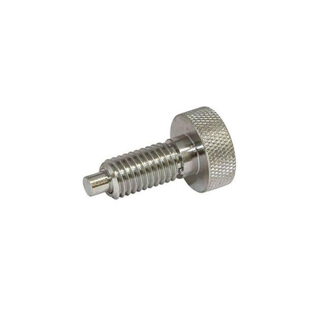

    STEEL KNURLED SPRING PLUNGER
1THR1 数据手册
HRSP HRSS Hand Retractable Spring Plungers Steel Stainless Steel Non Lock-Out, with Knurled Handle Inch 3 Type ST STP NI NIP Steel, without patch Steel, with patch Stainless steel, without patch Stainless steel, with patch Inch table Dimensions in: inches - millimeters 1 2 d1 d2 d3 l1 l2 l3 l4 Initial End  .104 2.6      10 x 32   .375  9.5     .400 10.2    .09 2.3    .250  6.4    .13 3.3  .50 lbf 2.22 N 3.00 lbf 13.34 N  .124 3.1     1/4 x 20   .500 12.7     .500 12.7    .13 3.3    .313  8.0    .19 4.8  1.00 lbf 4.45 N 4.00 lbf 17.79 N  .155 3.9   5/16 x 18   .625 15.9     .625 15.9    .19 4.8    .375  9.5    .25 6.4  1.00 lbf 4.45 N 6.00 lbf 26.68 N  .186 4.7     3/8 x 16   .750 19.1     .750 19.1    .22 5.6    .500 12.7    .31 7.9  1.00 lbf 4.45 N 8.00 lbf 35.58 N  .249 6.3     1/2 x 13  1.00  25.4     .875 22.2    .25 6.4    .625 15.9    .38 9.7  1.00 lbf 4.45 N 10.00 lbf 44.48 N Thread Spring load ≈ Specification Information • HRSP -- Threaded body Low carbon steel, zinc plated -- Plunger pin Case hardened steel, zinc plated -- Spring Steel HRSP and HRSS hand retractable spring plungers are intended for use in applications requiring a part to be located or indexed into a particular position and does not require the pin to remain retracted for long periods of time. see also... • List of Indexing Plunger Types • HRSS -- Threaded body Stainless steel European Standard No. 1.4305 (AISI 303) -- Plunger pin Stainless steel European Standard No. 1.4305 (AISI 303) -- Spring Stainless steel • RoHS compliant How to order (Steel) 1 2 3 HRSP-0.104-10X32-ST How to order (Stainless steel) 1 2 3 HRSS-0.249-1/2X13-NIP 2 | 3.1 Indexing, Locking, Blocking with Pins and Ball-Shaped Elements 1 Pin diameter d1 2 Thread d 2 3 Type 1 Pin diameter d1 2 Thread d 2 3 Type www.jwwinco.com | phone: 1-800-877-8351
