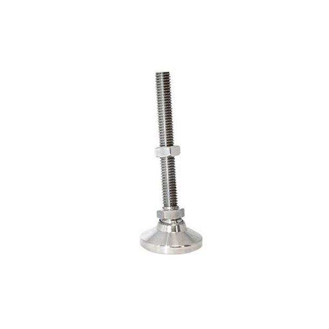

LPST “Level-It”™ Leveling Mounts Stainless Steel Threaded Stud Type Inch 4 Type D1 Stainless steel base D2 Solid Delrin ® plastic base D3 Molded Delrin ® plastic base Specification Information • Threaded stud with ball end Stainless steel European Standard No. 1.4305 (AISI 303) Machined from solid bar LPST “Level-It”™ leveling mounts swivel 10-15° to all sides of the centerline to adjust to uneven surfaces. They are typically used for leveling machine tools, electronic racks, benches, etc. The large diameter base design assures a solid support. • Type D1 Base Stainless steel European Standard No. 1.4305 (AISI 303) • Type D2 / D3 Base Delrin® plastic Temperature resistant up to 180 °F (82 °C) • Jam nut Materials and finishes are the same as the corresponding stud • RoHS compliant A coupling nut is not recommended to use for installation. Use nut on tapped hole of 1 - 1 1/2 times the thread diameter being used. To insure a proper leveling mount size, divide the machine weight by the number of mounts required. This will equal the pounds or load per mount. The jam nut is a standard part of the assembly. see also... • ”Level-It”™ Leveling Mounts LPST (Steel Threaded Stud Type) • ”Level-It”™ Leveling Mounts MLPST (Stainless Steel Threaded Stud Type, Metric Size) • ”Level-It”™ Leveling Mounts LPSO (Stainless Steel Tapped Socket Type) • ”NY-LEV®” Nylon Base Leveling Mounts WN 9000.1 (Nylon Base, Stainless Steel Threaded Stud Type) On request • Non-skid Elastomer pad • Molded Delrin® plastic base in additional sizes • For certain minimum quantities, modifications such as lag bolt holes and other versions of plating How to order 1 2 3 4 LPST-1.25-5/16X24-2.00-D1 2 | 3.4 Installing, Lifting, Damping with Leveling Feet, Lifting Gear and Rubber Elements 1 Base diameter d1 2 Thread d 2 3 Stud length l1 4 Type www.jwwinco.com | phone: 1-800-877-8351 LPST “Level-It”™ Leveling Mounts continued Inch table 1 2 3 d1 d2 l1 Thread Dimensions in: inches - millimeters l2 l3 A/F Max. load Stainless steel base Delrin ® plastic base 0.75 19.1 10 x 32 1.00 25.4 0.53 13.5 0.156 4.0 0.375 9.5 895 lbf 3981.15 N 150 lbf 667.23 N 0.75 19.1 10 x 32 2.00 50.8 0.53 13.5 0.156 4.0 0.375 9.5 895 lbf 3981.15 N 150 lbf 667.23 N 1.00 25.4 1/4 x 20 1.25 31.8 0.70 17.8 0.188 4.8 0.500 12.7 1388 lbf 6174.13 N 200 lbf 889.64 N 1.00 25.4 1/4 x 20 2.50 63.5 0.70 17.8 0.188 4.8 0.500 12.7 1388 lbf 6174.13 N 200 lbf 889.64 N 1.00 25.4 1/4 x 28 1.25 31.8 0.70 17.8 0.188 4.8 0.500 12.7 850 lbf 3780.98 N 125 lbf 556.02 N 1.25 31.8 5/16 x 18 2.00 50.8 0.88 22.4 0.218 5.5 0.625 15.9 2300 lbf 10230.90 N 250 lbf 1112.05 N 1.25 31.8 5/16 x 24 2.00 50.8 0.88 22.4 0.218 5.5 0.625 15.9 2150 lbf 9563.67 N 250 lbf 1112.05 N 1.25 31.8 3/8 x 16 2.00 50.8 0.88 22.4 0.218 5.5 0.625 15.9 3750 lbf 16680.83 N 300 lbf 1334.46 N 1.25 31.8 3/8 x 16 4.00 101.6 0.88 22.4 0.218 5.5 0.625 15.9 3750 lbf 16680.83 N 300 lbf 1334.46 N 1.25 31.8 3/8 x 24 2.00 50.8 0.88 22.4 0.218 5.5 0.625 15.9 3300 lbf 14679.13 N 250 lbf 1112.05 N 1.88 47.8 1/2 x 13 2.00 50.8 1.13 28.7 0.250 6.4 0.750 19.1 5000 lbf 22241.10 N 700 lbf 3113.75 N 1.88 47.8 1/2 x 13 4.00 101.6 1.13 28.7 0.250 6.4 0.750 19.1 5000 lbf 22241.10 N 700 lbf 3113.75 N 1.88 47.8 1/2 x 20 2.00 50.8 1.13 28.7 0.250 6.4 0.750 19.1 4000 lbf 17792.88 N 625 lbf 2780.13 N 2.50 63.5 5/8 x 11 2.00 50.8 1.25 31.8 0.250 6.4 0.875 22.2 6000 lbf 26689.32 N 1200 lbf 5337.86 N 2.50 63.5 5/8 x 11 4.00 101.6 1.25 31.8 0.250 6.4 0.875 22.2 6000 lbf 26689.32 N 1200 lbf 5337.86 N 2.50 63.5 5/8 x 18 2.00 50.8 1.25 31.8 0.250 6.4 0.875 22.2 5500 lbf 24465.21 N 1100 lbf 4893.04 N 3.00 76.2 3/4 x 10 2.00 50.8 1.50 38.1 0.312 7.9 1.062 27.0 7400 lbf 32916.84 N 1800 lbf 8006.79 N 3.00 76.2 3/4 x 10 4.00 101.6 1.50 38.1 0.312 7.9 1.062 27.0 7400 lbf 32916.84 N 1800 lbf 8006.79 N 3.00 76.2 3/4 x 16 2.00 50.8 1.50 38.1 0.312 7.9 1.062 27.0 6250 lbf 27801.38 N 1650 lbf 7339.56 N 4.00 101.6 7/8 x 9 4.00 101.6 1.88 47.8 0.380 9.7 1.375 34.9 15000 lbf 66723.32 N 1950 lbf 8674.03 N 4.00 101.6 7/8 x 14 4.00 101.6 1.88 47.8 0.380 9.7 1.375 34.9 13500 lbf 60050.99 N 1700 lbf 7561.97 N 4.00 101.6 1 x 8 3.50 88.9 1.88 47.8 0.380 9.7 1.375 34.9 25000 lbf 111205.54 N 2500 lbf 11120.55 N 4.00 101.6 1 x 8 4.25 108.0 1.88 47.8 0.380 9.7 1.375 34.9 25000 lbf 111205.54 N 2500 lbf 11120.55 N 4.00 101.6 1 x 8 6.00 152.4 1.88 47.8 0.380 9.7 1.375 34.9 25000 lbf 111205.54 N 2500 lbf 11120.55 N 4.00 101.6 1 x 12 3.50 88.9 1.88 47.8 0.380 9.7 1.375 34.9 18050 lbf 80290.40 N 2250 lbf 10008.49 N 6.00 152.4 1 1/4 x 7 4.00 101.6 2.75 69.9 0.562 14.3 1.875 47.6 43000 lbf 191273.53 N 3600 lbf 16013.59 N 6.00 152.4 1 1/4 x 7 6.00 152.4 2.75 69.9 0.562 14.3 1.875 47.6 43000 lbf 191273.53 N 3600 lbf 16013.59 N www.jwwinco.com | phone: 1-800-877-8351 3.4 Installing, Lifting, Damping with Leveling Feet, Lifting Gear and Rubber Elements | 3
