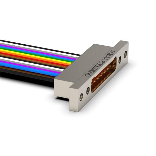

    CBL ASY NANO-D 31P BLU 457.2MM
A29600-031 数据手册
M A T E R I AL S & S P E C I F I C A T I O N S A 2 9 6 0 0 -0 3 1 PART NO. REV ECO DATE AP P F 96567 03-15 -1 0 T LM H O U S IN G : A L U M IN U M 6 0 6 1 -T 6 , N IC K E L P L A T E P E R A M S -C -2 6 0 7 4 INSULATOR: L IQ U ID C R Y S T A L P O L Y M E R (L C P ) PER ASTM D5138 CONTACTS: C O P P E R A L L O Y P E R M IL -D T L 32139, G O LD PLATED PER ASTM B 4 8 8 , (H A R D G O L D ) T Y P E II C O D E C , C L A S S 1 .2 7 WIRE: + .3 8 - .0 0 + 9 .7 4 5 7 .2 0 1 8 .0 0 A C T U A L S IZ E E X C L U D IN G W IR E L E N G T H 3 0 A W G (7 -3 8 ) PTFE, C O LO R C O D ED N EM A H P 3 TYP E E T, C O LO R C O D E D IA W M IL -S T D -6 8 1 , S Y S T E M 1 , U S I N G T E N S O L ID R E P E A T IN G C O L O R S .0 6 2 1 .5 7 C U R R E N T R AT IN G : 1 A M P M A X P E R M IL -D T L -3 2 1 3 9 CON TACT RE S IS TANCE : 7 1 M IL L IO H M M A X (7 1 m V D R O P M A X ) @ 1 .0 A M P S P E R M IL D T L -3 2 1 3 9 .6 5 0 1 6 .5 1 IN T E R N A L U S E O N L Y S H E E T 2 O F 2 IS A M F G L O A D IN G D IA G R A M .8 6 0 2 1 .8 4 PERFORMANCE: P R O D U C T F A M IL Y T E S T E D T O A N D PASSED THE PERFO RMANCE S P E C I F I C A T IO N S O F T A B L E V II I O F M IL - D T L -3 2 1 3 9 .4 3 8 1 1 .1 3 .1 1 0 2 .7 9 17 31 A .0 8 3 2 .1 0 .0 4 0 1 .0 2 SOCKET # CO L O R 1, 11, 21, 31 BLA C K 2, 12, 22 BROW N 3, 13, 23 RE D 4, 14, 24 ORANGE .5 4 5 1 3 .8 4 5, 15, 25 YELLOW 6, 16, 26 GRE E N .7 5 5 1 9 .1 8 7, 17, 27 BLUE VIOLET 9, 19, 29 GRAY 10, 20, 30 WHITE M N S O P S L DW 8, 18, 28 A 1 T H IR D A N G L E -T O L E R A N C E S U N L E S S O T H E R W IS E N O TE D D I M E N S IO N S IN IN C H E S 2 P L D E C 3 P L D E C 4 P L D E C ANG LES .0 1 .0 0 5 .0 0 0 5 1 16 .0 1 2 5 0 .3 2 T H I S D R A W IN G C O N T A I N S C O N F ID E N T I A L A N D P R O P R IE T A R Y IN F O R M A T IO N W H I C H IS T H E P R O P E R T Y O F O M N E T I C S C O N N E C T O R C O R P . T H I S D O C U M E N T M A Y N O T , IN W H O L E O R I N P A R T , B E D U P L IC A T E D , O R D IS C L O S E D F O R A N Y P U R P O S E , W IT H O U T W R I T T E N P E R M IS S IO N F R O M O M N E T I C S C O N N E C T O R C O R P . DF T M . A A S CHK 'D. AP P 'D. DATE 0 5 -1 4 -0 4 DATE DATE T I T LE : . 0 7 0 (T Y P ) 1 .7 8 4 X # 0 -8 0 U N F -2 B (31) SOCKET FEMALE Bi-Lobe® CONNECTOR .1 6 5 4 .1 9 .1 2 5 3 .1 8 .0 9 8 2 .4 9 .2 2 5 5 .7 2 S E C T IO N A - A OMNETICS A 2 9 6 0 0 - 0 3 1 CONNECTOR CORPORATION 7 2 6 0 C O M M E R C E C IR C L E E A S T M I N N E A P O L IS , M N 5 5 4 3 2 W W W .OMNETICS.COM CAG E CO DE DW G NO . 61873 SHEET 1 OF 2 REV S C A L E : 3 :1 F
