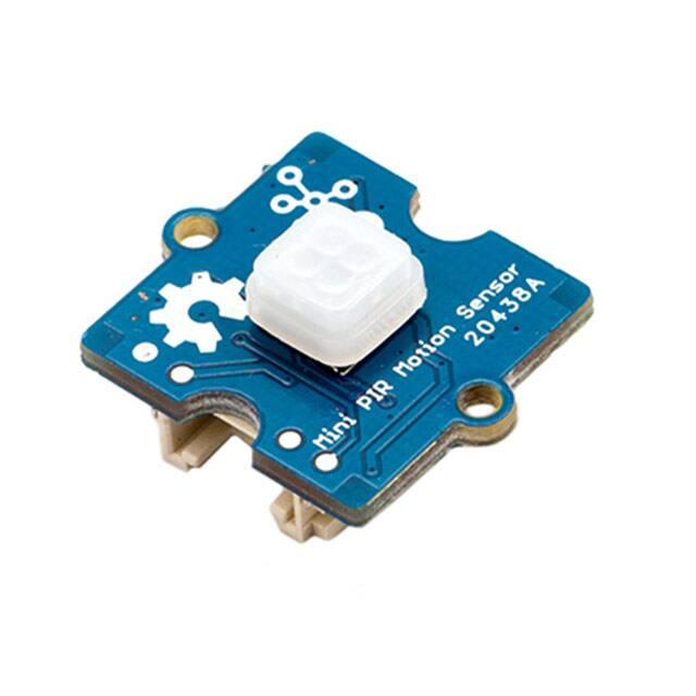

        Grove ‐ mini PIR motion sensor SKU 101020353        Description  PIR sensor is used for making motion detecting applications such as alarm burglar systems, visitor  presence monitoring, light switches and robots. The Grove – mini PIR motion sensor is a compact, low  power consumption and cost effective PIR sensor which is suitable for applications with relatively less  detection distance requirement.  The detection distance in the datasheet is up to 3m to 5m, however 2m is the best detection distance  that we recommend and 25Ԩ is the most suitable temperature.  The sensitivity of the sensor is adjustable, there is reserved pin out on the back of the board so that you  can solder a slide rheostat to adjust the sensitivity. If you think the sensitivity is not enough, here is a  trick, drag the plastic cap a little up will help enhance the sensitivity.   Note:  Please note that the orientation can influence the sensitivity, for more accurate detection, please place  the sensor as the picture below.    Features:   Low power consumption   Sensitivity adjustable   Grove interface   Technical Details   Dimensions  20mm x 20mm x 12mm  Weight  G.W 4g      Battery  Exclude  Sensor chip  S16‐L221D  Supply Voltage  2.7 – 3.3V  Working Current  12 – 20 μA  Sensitivity  120 – 530 μV  Max detecting range  2m(25Ԩ)    Part List    Grove ‐ mini PIR motion sensor                                                     https://www.seeedstudio.com/Grove‐‐‐mini‐PIR‐motion‐sensor‐p‐2930.html 9‐7‐17  1
