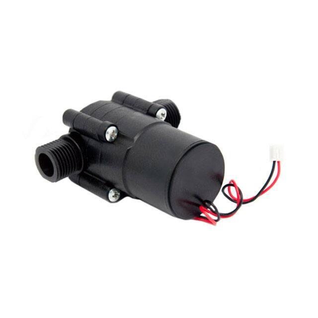

    MICRO HYDRO GENERATOR 3.6V
108100004 数据手册
  3.6V Micro hydro generator SKU 108100004 Micro hydro power is clean, renewable energy. Here is a G ½ micro hydro generator which can supply stably output voltage and output current with the help of one voltage stabilizing circuit and one rechargeable battery. We can install it at home to save household energy, like using spray shower to light LEDs etc. Pressure and Flow diagram Flow and Output voltage Diagram Note This module has added one voltage stabilizing circuit and one rechargeable battery, output voltage is stably 3.6v and output current is stably 300mA. Flow and Output voltage Diagram Specification Weight  165 g  Output voltage  3.6V  Battery Capacity  300mA  Maximum working pressure  1.75 MPa  Working pressure  0~1.75MPa  Working temperature  0~110°C  Maximum  30mins at 110 °C  Recommend flow rate range  1.5~20 l/min(Pressure 0.05‐0.2mpa)  Installation Method  direction of arrow  Material  nylon/glass fiber,Polyformaldehyde  Size of the input and output openings  0.8inch    Mechanic Dimensions Usage Hardware Installation Tech Support Please submit any technical issue into our forum or drop mail to techsupport@seeed.cc.                                       http://wiki.seeedstudio.com/3.6V_Micro_hydro_generator/2‐15‐19
