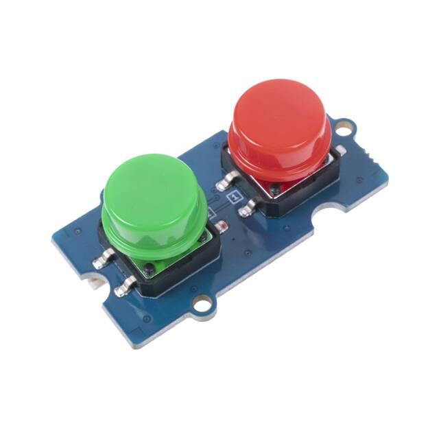

        Grove ‐ Dual Button SKU 111020103 Grove ‐ Dual Button includes 2 buttons, enables you to control two signal channels with one grove module. With 4 different color keycaps provided, you can freely adjust the color combination as needed. Key Features    Compact modular design and less wire connection with two buttons in one grove module Different color keycaps provided, freely adjust the color combination as needed. 3.3/5V voltage compatibility Description Grove - Dual Button includes 2 buttons, enables you to control two signal channels with one grove module. With 4 different color keycaps provided, you can freely adjust the color combination as needed. The button is simply driven by the GPIO Digital Pins. When the button is pressed, the Pins can reach a LOW signal from the button; on the other hand, when it is in the loosen state, Pins will always gain a HIGH signal until it is pressed. Specification Item Value Power 3.3V/5V Interface Grove interface Dimensions 20*40mm Part List    1 x Grove - Dual Button 4 x Keycaps 1 x Grove Cable ECCN/HTS HSCODE UPC   8536500000           https://www.seeedstudio.com/Grove‐Dual‐Button‐p‐4529.html/4‐9‐20
