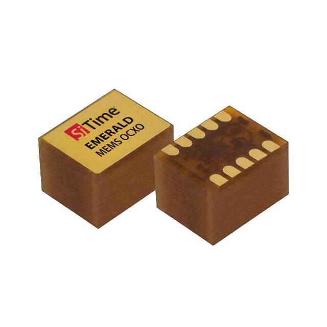

Emerald OCXOs for Precision Time Synchronization ±5 ppb stability, ±50 ppt/qC ΔF/ΔT Smallest package, 9 x 7 mm2 Unmatched ease-of-use SiTime’s Emerald Platform™ Stratum 3E OCXOs are designed to solve the long-standing problems of quartz OCXOs, which are sensitive to environmental conditions, require protective components, and are difficult to use. Emerald OCXOs provide the best dynamic performance (under airflow, thermal shock, vibration, shock, and EMI), programmability for the shortest lead time, and the smallest size. Also available in standard OCXO footprints, these devices can be used as drop-in replacements for quartz OCXOs while improving system performance and robustness. Benefits Features ƒ Enhance system robustness/performance in harsh environments ƒ Reduce design/manufacturing overhead by eliminating placement ƒ Exceptional dynamic stability under airflow, fast temp ramp ƒ ±5 to ±50 ppb over-temp stability constraints and shielding requirements ƒ ±50 ppt/°C frequency slope (ΔF/ΔT) ƒ Shrink system size with smallest OCXO package, fewer ƒ 2e-11 ADEV at 10 seconds averaging time, under airflow supporting components ƒ 0.1 ppb/g vibration, for outdoor pole mounted equipment ƒ Minimize time error in time synchronization applications Applications ƒ SONET/SDH Stratum 3E ƒ 4G/5G RRH, DU ƒ IEEE 1588 Boundary Clocks and Grandmasters ƒ Macro Base Stations ƒ ƒ ƒ ƒ ƒ Carrier Class Routers Optical Transport Digital Switching Test Instrumentation Synchronous Ethernet ƒ Resistant to microphonic and/or board bending effects ƒ ƒ ƒ ƒ ƒ ƒ ƒ On-chip regulators for power supply noise filtering ±0.25 ppb daily aging, ±500 ppb 20 year aging Excellent holdover through a wide range of conditions Programmable platform, any frequency from 1 to 220 MHz LVCMOS or clipped sinewave output No activity dips or micro jumps GR-1244 Stratum 3E compliant Contact SiTime for ±3 ppb or better stability options, 2 105°C operating temperature, and I C frequency tuning Four package options (actual size) Industry’s smallest 9.0 x 7.0 x 6.5H mm OCXO, plus 3 industry standard packages for drop-in replacement of quartz Emerald OCXOs for Precision Time Synchronization Device Type Device Frequency (MHz) SiT5711 1 to 60 Temp. Range (°C) Stability (ppb) Output Type Package Size (mm2) ±5 to ±8 [2] 9.0 x 7.0 Precision OCXO SiT5712 SiT5701 60 to 220 1 to 60 -20 to 70 -40 to 85 [1] ±5 to ±8 [2] ±15 to ±50 [2] LVCMOS, 14.0 x 9.0 Clipped Sine Wave 20.0 x 13.0 25.0 x 22.0 SiT5702 60 to 220 ±15 to ±50 [2] 1. Contact SiTime for 105°C products. 2. Contact SiTime for tighter stability options. 3. Contact SiTime for I2 C options. SiTime, a MEMS and analog semiconductor company, is the leader in frequency-control solutions. We combine innovative MEMS and programmable analog technologies with our systems expertise to break through the limitations of legacy quartz products and deliver the industry’s best timing solutions. Our configurable products provide the most stable timing that enables customers to differentiate their systems with higher performance, small size and better reliability. © 2018 SiTime Corp. The information contained herein is subject to change without notice. www.sitime.com Rev. 1.1 12/07/2018
