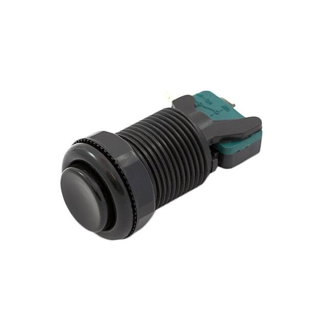

  Concave Button - Black COM -0 9339 RO HS  Description: This is a 35mm concave momentary push button similar to the ones you find on arcade games. Simple screw in design. Perfect for mashing. This button has a great tactile, ‘clicky’ feel. Features: • • • • • • Concave plunger design Durable nylon material Microswitch: max 3A @ 120 VAC Microswitch reliability tested to 10,000,000 cycles Includes 3 terminal microswitch Net weight: 25g Dimensions: • Cap diameter: 35mm • Overall height: 65mm • Mounting hole: 1 1/8th inch paddle bit (1.125" / 28mm) https://www.sparkfun.com/products/9339 5/25/2016
