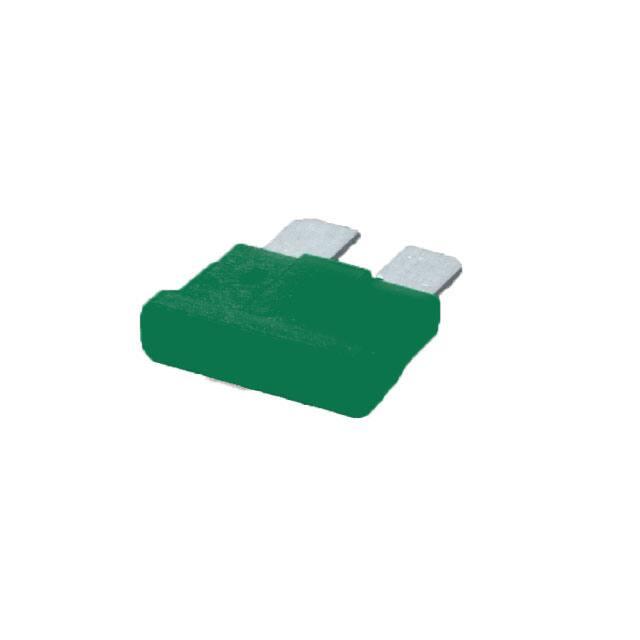

Type ANR-I Automotive Blade Fuse Standard – LED Indicating Specifications: · Voltage: 32VDC · Amperage: 3A, 4A, 5A, 7.5A, 10A, 12A, 15A, 20A, 25A, 30A, 35A, 40A · Body: PA 66 · Indicating LED when fuse is opened · Terminals: Zinc alloy · Designed to meet SAE and ISO 8820 Standards. (Except ANR-I-12A, a New Amperage) · Interrupt Rating – 1000A @ 32 VDC Time Characteristics: % of Rated Current Min Hold Time Max Hold Time 110% 135% 200% 100h ~ ~ ~ 1800s 5s www.optifuse.com Part Number ANR-I-3A ANR-I-4A ANR-I-5A ANR-I-7.5A ANR-I-10A ANR-I-12A ANR-I-15A ANR-I-20A ANR-I-25A ANR-I-30A ANR-I-35A ANR-I-40A (619) 593-5050 Amperage Body Color 3A 4A 5A 7.5A 10A 12A 15A 20A 25A 30A 35A 40A Violet Pink Tan Brown Red Light Red Blue Yellow Clear Green Blue Green Orange Time Current Curve Mechanical Dimensions: Inches [mm] Warning: -Operation beyond the specified maximum ratings or improper use may result in damage and possible electrical arcing and/or flame. -Avoid contact of device with chemical solvent. Prolonged contact will damage the device performance. Note: All specifications subject to change without notice. Rev B 06/2018 - Page: 1/1 Code H02-01H
