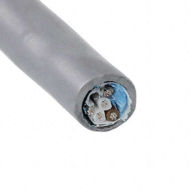

    4(2 对双绞线) 芯 多线对 线缆 石板色 24 AWG 箔 1000.0'(304.8m)
5492C SL001 数据手册
Alpha Wire | 1320 City Center Drive, Suite 100, Carmel, IN 46032 Tel: 1-800-52 ALPHA (25742), Web: www.alphawire.com Customer Specification PART NO. 5492C Construction Diameters (In) 1) Component 1 2 X 1 PAIR a) Conductor 24 (7/32) AWG Tinned Copper 0.024 b) Insulation 0.010" Wall, Nom. PVC, Semi Rigid 0.044 (1) Color Code Alpha Wire Color Code B Pair Color Pair Color 1 WHITE-BLACK 2 WHITE-BROWN Pair Color c) Pair 2/Cond Cabled Together (1) Twists: 9.6 Twists/foot (min) 2) Cable Assembly 2 Components Cabled a) Twists: 6.0 Twists/foot (min) b) Orientation: Components to be arranged from INSIDE LAYER to OUTSIDE LAYER c) Core Wrap Nonwoven Polyester Tape, 25% Overlap, Min. 3) Shield: Alum/Mylar Tape, 25% Overlap, Min. a) Foil Direction Foil Facing In b) Drain Wire 24 (7/32) AWG Tinned Copper 4) Jacket 0.032" Wall, Nom.,PVC a) Color(s) Slate, Black, Yellow, Orange, Blue, Green, Red, Sand Beige, White b) Ripcord 1 End 810 Denier Nylon c) Print ALPHA WIRE-* P/N 5492C 2PR 24 AWG XTRAGUARD(R) 1 SHIELDED (UL) TYPE CM 105C SUN RES OR AWM 2464 80C 300V OR AWM 2517 105C 300V VW-1 --- LLXXXXXX CSA 105C TYPE CMG FT4 CE ROHS OIL RESISTANT (SEQ FOOTAGE) * = Factory Code [Note: Product may have c(UL) or CSA markings depending upon plant of manufacture.] 0.216 (0.229 Max.) Applicable Specifications 1) UL a) Component 1 AWM/STYLE 10002 105°C / 300 VRMS b) Overall AWM/STYLE 2517 105°C / 300 VRMS SUN RES AWM/STYLE 2464 80°C / 300 VRMS CM 105°C VW-1 2) CSA International CMG 105°C FT4 3) IEC EN 60332-1 Flame Behavior EN 60332-2 Flame Behavior 4) Other Oil Resistant 5) CE: EU Low Voltage Directive 2014/35/EU Environmental 1) CE: EU Directive 2011/65/EU(RoHS2), EU Directive 2015/863/EU (RoHS3): This product complies with European Directive 2011/65/EU (RoHS Directive) of the European Parliament and of the Council of 8 June 2011 and the amending Directive 2015/863/EU of 4 June 2015 . No Exemptions are required for RoHS Compliance on this item. 2) REACH Regulation (EC 1907/2006): This product does not contain Substances of Very High Concern (SVHC) listed on the European Union's REACH candidate list in excess of 0.1% mass of the item. 3) California Proposition 65: This product may contain substances known to the State of California to cause Cancer or Reproductive Harm, but is exempt from labeling based on the Consent Judgement. See the Alpha Wire website for more information. Properties Physical & Mechanical Properties 1) Temperature Range -35 to 105°C 2) Bend Radius 10X Cable Diameter 3) Pull Tension 17.6 Lbs, Maximum 4) Sunlight Resistance Yes Electrical Properties (For Engineering purposes only) 1) Voltage Rating 300 VRMS 2) Mutual Capacitance 27 pF/ft @1 kHz, Nominal 3) Ground Capacitance 49 pF/ft @1 kHz, Nominal 4) Characteristic Impedance 65 Ω 5) Inductance 0.19 μH/ft, Nominal 6) Conductor DCR 26 Ω/1000ft @20°C, Nominal 7) OA Shield DCR 15.9 Ω/1000ft @20°C, Nominal Other Packaging Flange x Traverse x Barrel (inches) a) 1000 FT 12 x 10.5 x 5 Continuous length b) 500 FT 12 x 5.94 x 5 Continuous length c) 100 FT 6.5 x 4 x 2.5 Continuous length d) Bulk(Made-to-order) [Spool dimensions may vary slightly] Notes: a) Oil Resistant Jacket (7d @ 60C).   www.alphawire.com Alpha Wire | 1320 City Center Drive, Suite 100, Carmel, IN 46032 Tel: 1-800-52 ALPHA (25742) Although Alpha Wire (“Alpha”) makes every reasonable effort to ensure there accuracy at the time of publication, information and specifications described herein are subject to errors or omissions and to changes without notice, and the listing of such information and specifications does not ensure product availability. Alpha provides the information and specifications herein on an “AS IS” basis, with no representations or warranties, whether express, statutory or implied. In no event will Alpha be liable for any damages (including consequential, indirect, incidental, special, punitive, or exemplary) whatsoever, even if Alpha had been advised of the possibility of such damages, whether in an action under contract, negligence or any other theory, arising out of or in connection with the use, or inability to use, the information or specifications described herein. ALPHA WIRE - CONFIDENTIAL AND PROPRIETARYNotice to persons receiving this document and/or technical information. This document is confidential and is the exclusive property of ALPHA WIRE, and is merely on loan and subject to recall by ALPHA WIRE at any time. By taking possession of this document, the recipient acknowledges and agrees that this document cannot be used in any manner adverse to the interests of ALPHA WIRE, and that no portion of this document may be copied or otherwise reproduced without the prior written consent of ALPHA WIRE. In the case of conflicting contractual provisions, this notice shall govern the status of this document. ©2019 ALPHA WIRE - all rights reserved. EU/UK/China ROHS CERTIFICATE OF COMPLIANCE To Whom It May Concern: Alpha Wire Part Number: 5492C 5492C, RoHS-Compliant Commencing With 8/1/2005 Production  Note:  all colors and put-ups This document certifies that the Alpha part number cited above is manufactured in accordance with Directive 2011/65/EU of the European Parliament, better known as the RoHS Directive (commonly known as RoHS 2), with regards to restrictions of the use of certain hazardous substances used in the manufacture of electrical and electronic equipment. This certification extends to amending Directive 2015/863/EU which expanded the list of restricted substances to 10 items (commonly known as RoHS 3). This product also complies with UK - RoHS. The reader is referred to these Directives for the specific definitions and extents of the Directives. No Exemptions are required for RoHS Compliance on this item. Additionally, Alpha certifies that the listed part number is in compliance with China RoHS “Marking for Control of Pollution by Electronic Information Products” standard SJ/T 11364-2014. This product is also in compliance with China RoHS 2 per GB/T 26572-2011. Substance Maximum Control Value Lead 0.1% by weight (1000 ppm) Mercury 0.1% by weight (1000 ppm) Cadmium 0.01% by weight (100 ppm) Hexavalent Chromium 0.1% by weight (1000 ppm ) Polybrominated Biphenyls (PBB) 0.1% by weight (1000 ppm) Polybrominated Diphenyl Ethers (PBDE) , Including Deca-BDE 0.1% by weight (1000 ppm) Bis(2-ethylhexyl) phthalate (DEHP) 0.1% by weight (1000 ppm)  Butyl benzyl phthalate (BBP) 0.1% by weight (1000 ppm) Dibutyl phthalate (DBP)  0.1% by weight (1000 ppm)  Diisobutyl phthalate (DIBP) 0.1% by weight (1000 ppm)  The information provided in this document and disclosure is correct to the best of Alpha Wire's knowledge, information and belief at the date of its release. The information provided is designed only as a general guide for the safe handling, storage, and any other operation of the product itself or the one that it will become part of. The intent of this document is not to be considered a warranty or quality specification. Regulatory information is for guidance purposes only. Product users are responsible for determining the applicability of legislation and regulations based on their individual usage of the product. Authorized Signatory for the Alpha Wire: Dave Watson, Director of Engineering  Alpha Wire  2200 US Highway 27 South  Richmond, IN 47374 Tel: 1-908-925-8000 1/9/2024
