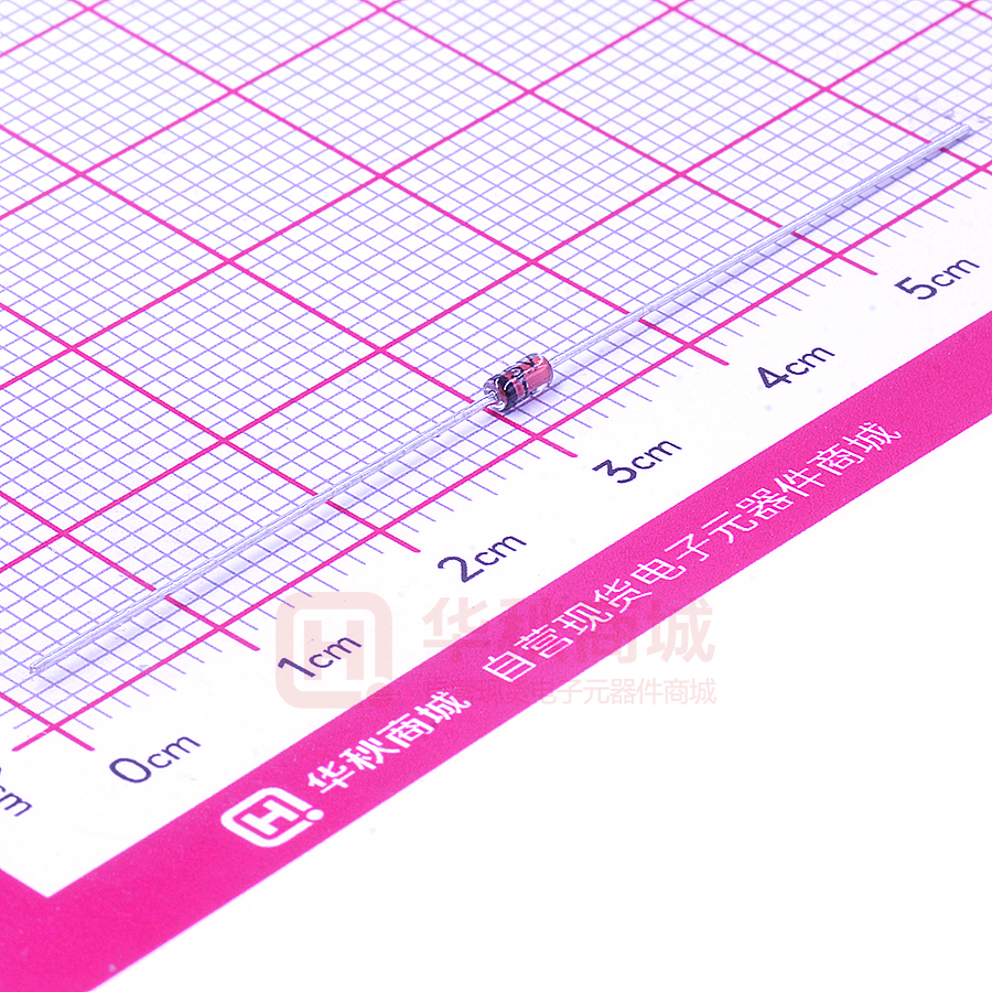

TC5V1TB 数据手册
® SE MI COND U CTO R 500 mW DO-35 Hermetically Sealed Glass Zener Voltage Regulators Absolute Maximum Ratings AXIAL LEAD DO35 TA = 25°C unless otherwise noted Parameter Power Dissipation Storage Temperature Range Operating Junction Temperature Value Units DEVICE MARKING DIAGRAM 500 mW -65 to +175 °C L xx x +175 °C L : Logo Device Code : TCxxx These ratings are limiting values above which the serviceability of the diode may be impaired. Specification Features: § § § § § § § § § Zener Voltage Range 2.0 to 75 Volts DO-35 Package (JEDEC) Through-Hole Device Type Mounting Cathode Hermetically Sealed Glass Anode Compression Bonded Construction All External Surfaces Are Corrosion Resistant And Leads Are Readily Solderable ELECTRICAL SYMBOL RoHS Compliant Solder Hot Dip Tin (Sn) Terminal Finish Cathode Indicated By Polarity Band Electrical Characteristics TA = 25°C unless otherwise noted Device Type VZ @ IZT (Volts) Nominal IZT (mA) ZZT @ IZT (Ω) Max IR @ VR (µA) Max VR (Volts) TC2V0 TC2V2 TC2V4 TC2V7 TC3V0 TC3V3 TC3V6 TC3V9 TC4V3 TC4V7 TC5V1 TC5V6 TC6V2 TC6V8 TC7V5 TC8V2 TC9V1 TC10V TC11V TC12V 2.0 2.2 2.4 2.7 3.0 3.3 3.6 3.9 4.3 4.7 5.1 5.6 6.2 6.8 7.5 8.2 9.1 10 11 12 5 5 5 5 5 5 5 5 5 5 5 5 5 5 5 5 5 5 5 5 100 100 100 110 120 120 100 100 100 80 80 60 60 20 20 20 25 30 30 30 120 120 120 100 50 20 10 5 5 5 5 5 5 2 0.5 0.5 0.5 0.2 0.2 0.2 0.5 0.7 1 1 1 1 1 1 1 1 1.5 2.5 3 3.5 4 5 6 7 8 9 Number: DB-035 Jun 2016 / F Page 1 TC2V0 through TC75V TAK CHEONG TAK CHEONG ® SE MI COND U CTO R Electrical Characteristics Device Type VZ @ IZT (Volts) Nominal TA = 25°C unless otherwise noted IZT (mA) TC13V 13 5 TC15V 15 5 TC16V 16 5 TC18V 18 5 TC20V 20 5 TC22V 22 5 TC24V 24 5 TC27V 27 2 TC30V 30 2 TC33V 33 2 TC36V 36 2 TC39V 39 2 TC43V 43 2 TC47V 47 2 TC51V 51 2 TC56V 56 2 TC62V 62 2 TC68V 68 2 TC75V 75 2 VF Forward Voltage = 1.2 V Maximum @ IF = 200 mA for all types ZZT @ IZT (Ω) Max IR @ VR (µA) Max VR (Volts) 35 40 40 45 45 30 35 45 55 65 75 85 90 90 110 110 201 230 240 0.2 0.2 0.2 0.2 0.2 0.2 0.2 0.2 0.2 0.2 0.2 0.2 0.2 0.2 0.2 0.2 0.2 0.2 0.2 10 11 12 13 15 17 19 21 23 25 27 30 33 36 39 43 47 51 56 Notes: 1. TOLERANCE AND VOLTAGE DESIGNATION The type numbers listed have zener voltage as shown and have a standard tolerance on the nominal zener voltage of ±5%. 2. SPECIALS AVAILABLE INCLUDE Nominal zener voltages between the voltages shown and tighter voltage, for detailed information on price, availability and delivery, contact you nearest Tak Cheong representative. 3. ZENER VOLTAGE (VZ) MEASUREMENT The zener voltage is measured under pulse conditions such that TJ is no more than 2℃ above TA. 4. ZENER IMPEDANCE (ZZ) DERIVATION Zener impedance is derived from the 60-cycle ac voltage, which results when an ac current having an RMS value equal to 10% of the dc zener current (IZT) is superimposed to IZT . Number: DB-035 Jun 2016 / F Page 2 TAK CHEONG ® SE MI COND U CTO R Typical Characteristics 1000 Total Capacitance [pF] PD-Power Passipation [mW] 600 500 400 300 200 f = 1MHz Ta = 25℃ VR = 0V 100 VR = 2V 100 VR = 30V 1 0 40 80 120 160 0 200 20 40 VZ - Reverse Voltage [V] Temperature [℃ ] Figure 1. Power Dissipation vs Ambient Temperature 60 80 Figure 2. Total Capacitance Valid provided leads at a distance of 0.8mm from case are kept at ambient temperature 1000 1000 Iz=1mA Ta = 25℃ Ta = 25℃ Iz=2mA 100 Forward Current [mA] Differential Zener Impedance [Ω] VR = 20V 10 0 Iz=5mA Iz=10mA 10 1 100 10 1 0.1 0.1 1 10 VZ - Reverse Voltage [V] 0 100 0.2 0.4 0.6 0.8 VF - Forw ard Voltage [m V] 1 1.2 Figure 4. Forward Current vs. Forward Voltage Figure 3. Differential Impedance vs. Zener Voltage 300 100 PD = 500mW Ta = 25℃ Reverse Current [mA] PD = 500mW Ta = 25℃ 250 Reverse Current [mA] VR = 5V 200 150 100 50 10 1 0.1 0.01 0 0 2 4 6 VZ - Reverse Voltage [V] 8 Figure 5. Reverse Current vs. Reverse Voltage 10 15 25 35 45 55 65 VZ - Reverse Voltage [V] 75 Figure 6. Reverse Current vs. Reverse Voltage Number: DB-035 Jun 2016 / F Page 3 TAK CHEONG ® SE MI COND U CTO R Package Outline Package Case Outline DO-35 DO-35 DIM Millimeters Inches Min Max Min Max A 0.46 0.55 0.018 0.022 B --- 5.08 --- 0.200 C 25.40 38.10 1.000 1.500 D 1.53 2.28 0.060 0.090 Notes: 1. 2. All dimensions are within JEDEC standard. DO35 polarity denoted by cathode band. Number: DB-035 Jun 2016 / F Page 4
