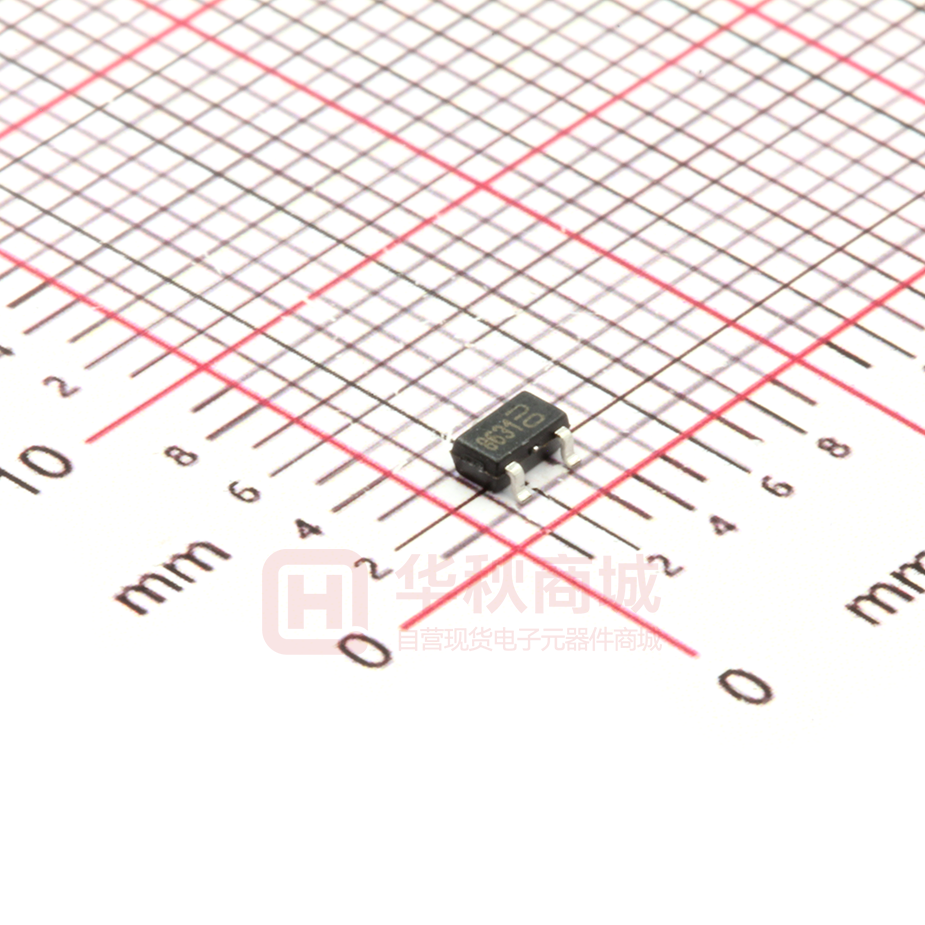

OUT
OUT
MT863XDT-1616
SOT-23-3L, tape & reel
(3000pcs/bag)
DFN1616, tape & reel
(3000pcs/bag)
OUT
OUT
MT863XAT
22
Flat TO-92, bulk packaging
(1000pcs/bag)
