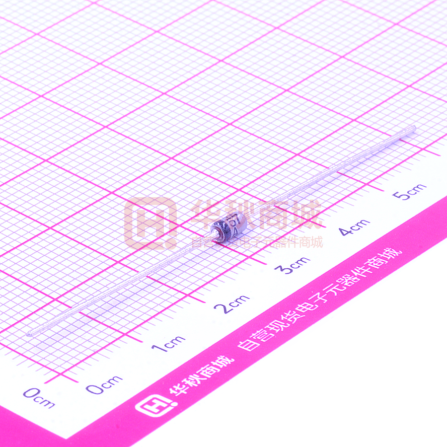

Former Licensed Product from ON Semiconductor a trademark of Semiconductor Components Industries,LLC TAK CHEONG 1 Watt DO-41 Hermetically Sealed Glass Zener Voltage Regulators Maximum Ratings Rating Symbol Value Units Maximum Steady State Power Dissipation PD 1 W 6.67 mW/℃ -65 to +200 °C @TL≤50℃, Lead Length = 3/8” Derate Above 50℃ Operating and Storage Temperature Range TJ, Tstg L 1N 47 xx A L 1N47xxA Specification Features: § § § § § § § § = Logo = Device Code Zener Voltage Range = 3.3V to 75V ESD Rating of Class 3 (>6 KV) per Human Body Model DO-41 Package (DO-204AL) Double Slug Type Construction Former Metallurgical Bonded Construction Oxide Passivated Die RoHS Compliant and Halogen Free Solder Hot Dip Tin (Sn) Lead Finish Cathode Anode Specification Features: Case : Double slug type, hermetically sealed glass Finish : All external surfaces are corrosion resistant and leads are readily solderable Polarity : Cathode indicated by polarity band Mounting: Any Number: DB-070 Jun.2016/ H Page 1 1N4728A through 1N4761A Series ® ® Former Licensed Product from ON Semiconductor a trademark of Semiconductor Components Industries,LLC TAK CHEONG ELECTRICAL CHARACTERISTICS (TA = 25℃ unless otherwise noted.) Zener Voltage (Note 2 & 3.) Device (Note 1.) Device Marking VZ (Volts) Zener Impedance (Note 4.) @IZT ZZT @IZT Leakage Current ZZK @IZK IR @ VR Min Nom Max (mA) (Ω) (Ω) (mA) (uA Max) (Volts) 1N4728A 1N4728A 3.135 3.3 3.465 76 10 400 1 100 1 1N4729A 1N4729A 3.420 3.6 3.780 69 10 400 1 100 1 1N4730A 1N4730A 3.705 3.9 4.095 64 9 400 1 50 1 1N4731A 1N4731A 4.085 4.3 4.515 58 9 400 1 10 1 1N4732A 1N4732A 4.465 4.7 4.935 53 8 500 1 10 1 1N4733A 1N4733A 4.845 5.1 5.355 49 7 550 1 10 1 1N4734A 1N4734A 5.320 5.6 5.880 45 5 600 1 10 2 1N4735A 1N4735A 5.890 6.2 6.510 41 2 700 1 10 3 1N4736A 1N4736A 6.460 6.8 7.140 37 3.5 700 1 10 4 1N4737A 1N4737A 7.125 7.5 7.875 34 4 700 0.5 10 5 1N4738A 1N4738A 7.790 8.2 8.610 31 4.5 700 0.5 10 6 1N4739A 1N4739A 8.645 9.1 9.555 28 5 700 0.5 10 7 1N4740A 1N4740A 9.500 10 10.50 25 7 700 0.25 10 7.6 1N4741A 1N4741A 10.45 11 11.55 23 8 700 0.25 5 8.4 1N4742A 1N4742A 11.40 12 12.60 21 9 700 0.25 5 9.1 1N4743A 1N4743A 12.35 13 13.65 19 10 700 0.25 5 9.9 1N4744A 1N4744A 14.25 15 15.75 17 14 700 0.25 5 11.4 1N4745A 1N4745A 15.20 16 16.80 15.5 16 700 0.25 5 12.2 1N4746A 1N4746A 17.10 18 18.90 14 20 750 0.25 5 13.7 1N4747A 1N4747A 19.00 20 21.00 12.5 22 750 0.25 5 15.2 1N4748A 1N4748A 20.90 22 23.10 11.5 23 750 0.25 5 16.7 1N4749A 1N4749A 22.80 24 25.20 10.5 25 750 0.25 5 18.2 1N4750A 1N4750A 25.65 27 28.35 9.5 35 750 0.25 5 20.6 1N4751A 1N4751A 28.50 30 31.50 8.5 40 1000 0.25 5 22.8 1N4752A 1N4752A 31.35 33 34.65 7.5 45 1000 0.25 5 25.1 1N4753A 1N4753A 34.20 36 37.80 7 50 1000 0.25 5 27.4 1N4754A 1N4754A 37.05 39 40.95 6.5 60 1000 0.25 5 29.7 1N4755A 1N4755A 40.85 43 45.15 6 70 1500 0.25 5 32.7 1N4756A 1N4756A 44.65 47 49.35 5.5 80 1500 0.25 5 35.8 1N4757A 1N4757A 48.45 51 53.55 5 95 1500 0.25 5 38.8 1N4758A 1N4758A 53.20 56 58.80 4.5 110 2000 0.25 5 42.6 1N4759A 1N4759A 58.90 62 65.10 4 125 2000 0.25 5 47.1 1N4760A 1N4760A 64.60 68 71.40 3.7 150 2000 0.25 5 51.7 1N4761A 1N4761A 71.25 75 78.75 3.3 175 2000 0.25 5 56.0 VF = 1.2V Max @IF = 200mA for 30V below types, VF = 2.0V Max @IF = 200mA for 30~56V types, and VF = 3.0V Max @IF = 200mA for 60V above types 1. TOLERANCE AND TYPE NUMBER DESIGNATION (VZ) The type numbers listed have a standard tolerance on the nominal zener voltage of ± 5%. 2. SPECIALS AVAILABLE INCLUDE Nominal zener voltages between the voltages shown and tighter voltage, for detailed information on price, availability and delivery, contact you nearest Tak Cheong representative. 3. ZENER VOLTAGE (VZ) MEASUREMENT The zener voltage (VZ) is tested under pulse condition. The measured VZ is guaranteed to be within specification with device junction in thermal equilibrium. Number: DB-070 Jun.2016/ H Page 2 ® Former Licensed Product from ON Semiconductor a trademark of Semiconductor Components Industries,LLC TAK CHEONG 4. ZENER IMPEDANCE (ZZ) DERIVATION The zener impedance is derived from the 60 cycle AC voltage, which results when an AC current having an RMS value equal to 10% of the DC zener current (IZT or IZK) is superimposed on IZT or IZK. Package Outline Case Outline DO-41 DIM Millimeters Inches Min Max Min Max A 0.68 0.81 0.027 0.032 B 3.70 4.25 0.146 0.167 C 25.40 --- 1.000 --- D 2.10 2.60 0.083 0.102 Number: DB-070 Jun.2016/ H Page 3
1N4757A
1. 物料型号:1N4728A 至 1N4761A Series 2. 器件简介:这是一系列1瓦特的DO-41封装的密封玻璃齐纳二极管电压调节器,具有轴向引线。 3. 引脚分配:文档中没有明确指出具体的引脚分配,但通常DO-41封装的二极管具有一个阳极和一个阴极,阳极通常没有标记,阴极带有极性带。 4. 参数特性: - 最大稳态功率耗散:1瓦特(在50°C和3/8英寸引脚长度下) - 操作和存储温度范围:-65°C 至 +200°C - ESD等级:符合人体模型的3级(>6千伏) - 封装类型:DO-41(DO-204AL),双滑块型构造 - 表面处理:所有外部表面耐腐蚀,引脚易于焊接 5. 功能详解:文档中提供了详细的电气特性表,包括齐纳电压范围、齐纳阻抗、漏电流等参数。 6. 应用信息:文档没有提供具体的应用信息,但齐纳二极管通常用于电压调节和过压保护。 7. 封装信息:DO-41封装,双滑块型构造,尺寸数据以毫米和英寸为单位提供。
