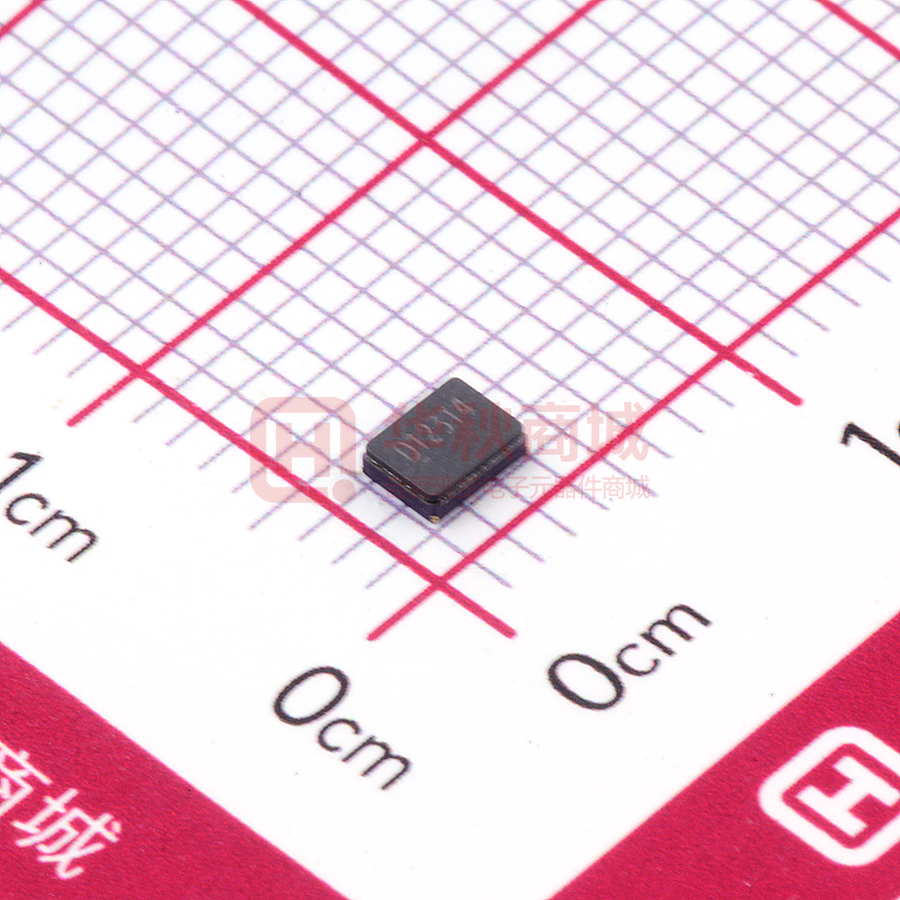

    无源晶振 12MHz ±20ppm 12pF 120Ω SMD3225_4P 表面贴装 -40℃~+125℃
7AD01200A2P 数据手册
Serial No.  2022-0664 2022/9/5 DATE: Huizhou Foryou General Electronics Co. Ltd. SPECIFICATION Product Name CRYSTAL RESONATOR Type DSX321G 12.000MHz Nominal Frequency Spec No. 7AD01200A2P If there is a change in this specifications, the specification number may be changed.  ! "   General Manufacturer of Quartz Devices 1389 Shinzaike, Hiraoka-cho, Kakogawa, Hyogo 675-0194 Japan Phone(81)79-425-3161 Fax.:(81)79-425-1134    C.ENG. ENG. 2022-0664 Serial No. 1. ELECTRICAL CHARACTERISTICS (This test shall be performed under the conditions of temp. at +25±3°C, Relative Humidity 60% max.) (1) NOMINAL FREQUENCY 12.000 MHz (2) OVERTONE ORDER Fundamental (3) LOAD CAPACITANCE(CL) (4) FREQUENCY TOLERANCE 12.0 pF ±20 ppm (at +25 ± 3 °C) 10 ± (5) DRIVE LEVEL 2 μW ( 200 μW max. ) 120 Ω max. (at Series) (6) SERIES RESISTANCE (7) OPERATING TEMPERATURE RANGE (8) FREQUENCY CHARACTERISTICS OVER TEMPERATURE -40 ~ +125 °C ±50 ppm / -40 ~ +125 °C (ref. to +25°C) 2.0 pF max. (9) SHUNT CAPACITANCE (10) INSULATION RESISTANCE (11) STORAGE TEMPERATURE RANGE 500 MΩ min. / DC 100 ± 15V -40 ~ +150 °C 2. CONSTRUCTION (1) DIMENSIONS AND MARKING Refer to 4. 3. OTHER SPECIFICATIONS (1) EMBOSS CARRIER TAPE AND REEL Refer to 5. (2) PACKING Refer to 6. (3) REFLOW CONDITIONS (REFERENCE) Refer to 7. (4) LAND PATTERN (REFERENCE) Refer to 8. (5) SUPPLEMENTARY NOTE Refer to 9. (6) RELIABILITY SPECIFICATION Refer to 10.~11. (7) OTHER HANDLING INSTRUCTIONS Refer to 12. ・ Compatible with AEC-Q200 TITLE DSX321G TYPE QUARTZ CRYSTAL SPECIFICATION REMARK SPEC. No. DATE 2022/09/05 7AD01200A2P DAISHINKU CORP. REV. PAGE 1 / 11 DM-Z0002:Style-010 Ver.1 Serial No. 2022-0664 4. DIMENSIONS AND MARKING (1 ) (2 ) (3 ) 0 .85±0 .15 2 .5±0 .1 3 .2±0 .1 (Internal connections) 2 .1 #3 #4 #2 #4 #3 #1 ,#3 Connected to quartz element #2 ,#4 GND connected or N.C. available 0 .7 1 .6 #1 #2 #1 0 .9 Unit : mm Tolerance : ±0.1 Figure-1 Logo(1) and Nominal Frequency (2) should be printed as follows by producing district Made in INDONESIA --> D Logo : , Frequency: 12 : Under Bar with D Nominal Frequency ( 2 ) = Mark two digits from upper decimal point 12.000 (ex. MHz ----> 12 ) Manufacturing lot No.( 3 ) Year : The last digit of the year week : We gave the sequence of week numbers 01(first week) for production date. there are starting from 1st of Jan. However, add '0' figure to the first week during the nine weeks. The week means are from Sunday to Saturday. (ex. 2022/9/5 ---> 237 ) Plating material of a terminal. : Ni Plating + Au Plating. A clearance between the soldering terminal portion and a print circuit board side should be less than 0.1mm. TITLE DSX321G TYPE QUARTZ CRYSTAL SPECIFICATION REMARK SPEC. No. DATE 2022/09/05 7AD01200A2P DAISHINKU CORP. REV. PAGE 2 / 11 DM-Z0002:Style-010 Ver.1 Serial No. 2022-0664 5. EMBOSS CARRIER TAPE AND REEL 3.5+/-0.05 (1)(2)(3) 0.25+/-0.05 1.75+/-0.1 1.55dia.+/-0.05 4.0+/-0.1 8.0+/-0.2 3.5+/-0.1 (1) DIMENSIONS OF EMBOSSED CARRIER TAPE 1.15 dia.+/-0.05 22.0+/-0.1 .0+/-0.05 4.0+/-0.1 1.0+/-0.1 2.8+/-0.1 User Direction of feed (Unit : mm) Figure-2 (2) DIMENSIONS OF TAPE REEL U F3 θ θ E F2 V B A C F1 W2 W1 Figure-3 TITLE DSX321G TYPE QUARTZ CRYSTAL SPECIFICATION REMARK SPEC. No. DATE 2022/09/05 7AD01200A2P DAISHINKU CORP. REV. PAGE 3 / 11 DM-Z0002:Style-010 Ver.1 Serial No. 2022-0664 (Unit:mm) Item Mark Dimensions Angle Diameter A Φ180 +0.0 / -3.0 Inside of Flange W1 9.0 ± 0.3 Outside of Flange W2 11.4 ± 1.0 Inside Diameter B Φ60 +1.0 / -0.0 F1 3.0 ± 0.2 F2 4.0 ± 0.2 F3 5.0 ± 0.2 Length V 11.9 +0.5 / -0.0 Angle θ 120° C Φ13 ± 0.2 Width E 2.0 ± 0.5 Length U 10.5 ± 0.4 Angle θ 120° Flange Width Center Core Slit Center Core Spindle Diameter Key Seats (3) MATERIAL OF THE REEL Polystyrene+Carbon(Black) Reel Polystyrene(White) (4) STORAGE CONDITION   Temperature : +40°C max. Relative Humidity : 80% max. (It is a guaranteed term because it obtains an excellent soldering: 6months) (5) STANDARD PACKING QUANTITY 3,000pcs/reel (6) MATERIAL OF THE TAPE Tape Material Carrier tape Polystyrene+Carbon Cover tape Polyester TITLE DSX321G TYPE QUARTZ CRYSTAL SPECIFICATION REMARK SPEC. No. DATE 2022/09/05 7AD01200A2P DAISHINKU CORP. REV. PAGE 4 / 11 DM-Z0002:Style-010 Ver.1 Serial No. 2022-0664 (7) LABEL CONTENTS Type Our specification No. Your Part No. Lot No. TYPE SPEC NO. PARTS NO. LOT NO. Nominal Frequency Quantity FREQ Q'TY Control No. Producting Country CTL NO. MADE IN Stick a label on the each reel. (8) TAPING DIMENSION Cover-tape Leader Carrier-tape Cover-tape Terminal Carrier-tape The length of cover-tape in the leader is more than 400mm including empty embossed area. After all products were packaged, must remain more than twenty pieces or 400mm empty area, which should be sealed by cover-tape. The tip of cover-tape shall be fixed temporary by paper tape and roll around the core of reel one round. The empty embossed area which are sealed by cover-tape must remain more than 40mm. Terminal Leader Components Empty Components Unreeling direction Empty Components Cover-tape Carrier-tape Figure-4 (9) JOINT OF TAPE The carrier-tape and cover-tape should not be jointed. (10) RELEASE STRENGTH OF COVER TAPE It has to between 0.1~0.7N under following condition. Pulling direction 165~180° Speed 300mm/min Otherwise unless specified. 165~180° Pulling direction Figure-5 Other standards shall be based on JIS C 0806 -1990. TITLE DSX321G TYPE QUARTZ CRYSTAL SPECIFICATION REMARK SPEC. No. DATE 2022/09/05 7AD01200A2P DAISHINKU CORP. REV. PAGE 5 / 11 DM-Z0002:Style-010 Ver.1 Serial No. 2022-0664 6. PACKING (1) STORAGE METHOD Label contents TYPE SPEC NO. LOT NO. FREQ. Q'TY CTL NO. Label Figure-6 (2) BOX SIZE From lot size packingsize shall be changed. In the upper and lower part and the opening in box it shall be protected products using aircushion sheets. TITLE DSX321G TYPE QUARTZ CRYSTAL SPECIFICATION REMARK SPEC. No. DATE 2022/09/05 7AD01200A2P DAISHINKU CORP. REV. PAGE 6 / 11 DM-Z0002:Style-010 Ver.1 Serial No. 2022-0664 7. REFLOW CONDITIONS (REFERENCE) During the solder reflow process, please complete within following temperature, period. Reflow soldering shall be allowed only 3times. 260℃ Peak 30s (℃) 260 220 200 150 150~200℃ 60~120s 217℃ 60~150s Time Figure-7 8. LAND PATTERN (REFERENCE) 1 .2 1 .7 1 .4 2 .2 Unit : mm Figure-8 TITLE DSX321G TYPE QUARTZ CRYSTAL SPECIFICATION REMARK SPEC. No. DATE 2022/09/05 7AD01200A2P DAISHINKU CORP. REV. PAGE 7 / 11 DM-Z0002:Style-010 Ver.1 Serial No. 2022-0664 9. SUPPLEMENTARY NOTE (1) MOISTURE SENSITIVITY LEVEL(MSL) LEVEL=1 (No dry pack required) Refer to IPC/JEDEC J-STD-033C (2) QUARTZ CRYSTAL WEIGHT about 0.02g TITLE DSX321G TYPE QUARTZ CRYSTAL SPECIFICATION REMARK SPEC. No. DATE 2022/09/05 7AD01200A2P DAISHINKU CORP. REV. PAGE 8 / 11 DM-Z0002:Style-010 Ver.1 Serial No. 10. RELIABILITY SPECIFICATION TEST No. Stress 1 Preconditioning 2 7 Sealing Tightness (Helium Leak Test) High Temperature Exposure(Storage) Temperature Cycling Biased Humidity 8 Operational Life 9 External Visual 12 13 Resistance to Solvents Mechanical Shock 14 Vibration 15 Resistance to Soldering Heat Solderability 3 4 18 21 Board Flex 22 Terminal Strength 2022-0664 Compatible with AEC-Q200 Reference - Additional Requirements Reflow 3times perform the attached Reflow conditions to reference. Requirement - IEC 60068-2-17 Helium Leak Detector Less than 2.0×10-9 Pa・m3/s MIL-STD-202 Method 108 JESD22 Method JA-104 MIL-STD-202 Method 103 MIL-STD-202 Method 108 MIL-STD-883 Method 2009 MIL-STD-202 Method 215 MIL-STD-202 Method 213 MIL-STD-202 Method 204 +125°C 1000h Parts shall conform specification 11.A -40+125°C 1000cycles Parts shall conform specification 11.A +85°C 85%RH biased 1000h Parts shall conform specification 11.C +125°C biased 1000h Parts shall conform specification 11.C Construction, marking and workmanship Also aqueous wash Without abnormal visual MIL-STD-202 Method 210 J-STD-002 Method B SMD a) J-STD-002 Method B SMD b) J-STD-002 Method D SMD c) AEC-Q200 Method 005 AEC-Q200 Method 006 No marking off 980m/s2 6ms 6directions 3cycles(18shocks) 10~2,000Hz 49m/s2 20min 12cycles +260±5°C 10±1s +155°C dry heat 4h Sn-3Ag-0.5Cu no-clean RMA +235°C 5s Steam conditioning:+100°C 8h no-clean RMA Sn-Pb +215°C 5s Steam conditioning:+100°C 8h Sn-3Ag-0.5Cu no-clean RMA +260°C 30s 2mm 60s A force of 17.7N for 60s Parts shall conform specification 11.A Parts shall conform specification 11.A Parts shall conform specification 11.A New solder shall be cover 95% min. New solder shall be cover 95% min. Leaching/dewetting shall be no more than 5% Parts shall conform specification 11.A Parts shall conform specification 11.A * The test No. 3, 4, 7, 8 are implemented after preconditioning. TEST No. Stress 23 ESD (Human Body Model) Reference - Additional Requirements Vs = ±1500V max. C1=100pF, R2=1.5kΩ Number of times : 1times Requirement Parts shall conform specification 11.A 11. SPECIFICATION Frequency Variation and Equivalent Resistance shall be within Table below after the reliability test. Spec. A B C D Frequency Variation ±10ppm ±20ppm ±10ppm ±20ppm Equivalent Resistance ±25% or ±10.0Ω (Use larger specification) ±25% or ±10.0Ω (Use larger specification) - TITLE DSX321G TYPE QUARTZ CRYSTAL SPECIFICATION REMARK SPEC. No. DATE 2022/09/05 7AD01200A2P DAISHINKU CORP. REV. PAGE 9 / 11 DM-Z0002:Style-010 Ver.1 Serial No. 2022-0664 12. DSX321G TYPE QUARTZ CRYSTAL HANDLING INSTRUCTIONS (1) SOLDERING Please perform the attached Reflow conditions to reference within 3times. (2) MOUNT Crystal products are designed to be compatible with automatic mounting. Be sure to have a mounting test in advance by using the actual mounting machine and check that the characteristics of the products are not damaged by the automatic mounting. In the process where the board is warped, such as board separation process, be careful that the warping does not influence the characteristics and soldering of crystal products. Since mounting by Ultrasonic welding and processing have a possibility of an excessive vibration spreading inside a crystal resonator and becoming the cause of characteristic deterioration and not oscillating, it does not recommend. Underfilling Material for DSX321G Types, KDS considers underfilling material such as heat-cured resin would not affect the characteristics of the DSX321G crystal mounted, however, we recommend the crystal be tested and checked in such a case prior to use so that there are the possibility that the crystal may have a lid off or a crack in the ceramic base. (3) WASHING About use of the washing liquid of a basin system, an alcoholic system, and a chlorofluorocarbon-replacing material system, it is checking that it is satisfactory. However please consult in advance about other washing liquid. Although the check about ultrasonic washing is performed, since it is an examination with a crystal resonator simple substance, the check by the use state is recommended again. (4) THE CAUTIONS ON USE The piece of crystal it is processed very smaller than the conventional thing inside DSX321G series crystal unit may be damaged, if excessive excitation electric power is applied. Please use it below with the value specified on a catalog and specifications. Please refrain from forming patterns between crystal land pattern's since there is a possibility to cause crack in base. If the temperature is higher than +280°C, there is a possibility for the sealing glass to remelt. Avoid using the product at temperature higher than specified. (5) HANDLING OF A PRODUCT DSX321G series has sufficient intensity to fall and vibration. However when too much shock is added according to a certain cause, the use after a characteristic check is recommended. (6) STORAGE Since the soldering nature of a terminal may be degraded, please avoid storage in high temperature and a humid place. Please keep it in the place which direct rays do not hit and dew condensation does not generate. TITLE DSX321G TYPE QUARTZ CRYSTAL SPECIFICATION REMARK SPEC. No. DATE 2022/09/05 7AD01200A2P DAISHINKU CORP. REV. PAGE 10 / 11 DM-Z0002:Style-010 Ver.1 2022-0664 REVISION RECORD Rev. No Date Reason - 2022/09/05 - Contents The first edition. Approved Y.Miura - 11 / 11 - Checked Drawn S.Yamagata M.Nagaishi DM-Z0002:Style-008 Ver.1 Prepared for: Huizhou Foryou General Electronics Co. Ltd. No.R22NH35801 Reliability Test Data Product : Crystal Resonator Type : DSX321G 12.000MHz (Test Data on 10.000MHz substituted for 12.000MHz.) RoHS Compliant Part JEITA Phase 3A ( PT. KDS INDONESIA ) Date: Sep. 7, 2022 Daishinku Corp. Quality Assurance Dept. Hideki Watanabe / Manager Performance Test Procedures and Results No. Stress Preconditioning - Reference Additional Requirements Requirement Result Page J-STD-020 Reflow 3times - n=308 - 260deg.C Peak 30sec. (deg.C) 260 220 217d.C 60-150sec. 200 150 150-200d.C 60-120sec. Time 2 7 Sealing Tightness (Helium Leak Test) High Temperature Exposure(Storage) Temperature Cycling Biased Humidity 8 Operational Life 9 External Visual 3 4 12 Resistance to Solvents 13 Mechanical Shock 14 Vibration 15 Resistance to Soldering Heat 18 Solderability 21 Board Flex 22 Terminal Strength IEC 60068-2-17 Helium Leak Detector MIL-STD-202 Method 108 JESD22 Method JA-104 MIL-STD-202 Method 103 MIL-STD-202 Method 108 MIL-STD-883 Method 2009 MIL-STD-202 Method 215 MIL-STD-202 Method 213 MIL-STD-202 Method 204 MIL-STD-202 Method 210 J-STD-002 Method B SMD a) J-STD-002 Method B SMD b) J-STD-002 Method D SMD c) AEC-Q200 Method 005 AEC-Q200 Method 006 +125deg.C 1000 hrs Parts shall conform Specification A -40+125deg.C 1000 cycles Parts shall conform Specification A +85deg.C 85%RH biased 1000hrs Parts shall conform Specification C +125deg.C biased 1000hrs Parts shall conform Specification C Construction , marking and workmanship Also aqueous wash Without abnormal visual No marking off 980m/s2 6msec 3times(18 shocks) Parts shall conform Specification A 10-2,000Hz 49m/s2 20minutes 12cycles 260±5deg.C 10±1sec Parts shall conform Specification A 155 deg.C dry heat 4 hours Sn-3Ag-0.5Cu no-clean RMA 235 deg.C 5sec Steam conditioning: 100 deg.C 8 hours Sn-Pb no-clean RMA 215 deg.C 5sec Steam conditioning: 100 deg.C 8 hours Sn-3Ag-0.5Cu no-clean RMA 260 deg.C 30sec 2mm 60sec. A force of 17.7N 60sec all Passed r/n=0/77 Passed r/n=0/77 Passed r/n=0/77 Passed r/n=0/77 Passed r/n=0/77 Passed r/n=0/5 Passed r/n=0/30 Passed r/n=0/30 Passed r/n=0/30 Passed r/n=0/15 Passed 2.0×10-9 [Pa m3/s] Parts shall conform Specification A New solder shall be cover 95%min. New solder shall be cover 95%min. Leaching/dewetting shall be no more than 5%. Parts shall conform Specification A Parts shall conform Specification A 1 1 1 1 2 2 2 - r/n=0/15 Passed - r/n=0/15 Passed - r/n=0/30 3 Passed r/n=0/30 3 Passed Based on AEC-Q200 * The test No.3, 4, 7 and 8 are implemented after preconditioning. No. Stress Reference 23 ESD Human Body Model Specification A) Specification B) Specification C) Specification D) Additional Requirements V=+/-1500V (C1=100pF,R2=1.5kohms) Number of times : 1times Requirement Parts shall conform Specification B Result r/n=0/15 Passed Freq.variation : delta F/F=+/- 10 ppm Max , ESR variation : delta ESR=+/- 25 % Max or +/- 10 ohm Max Freq.variation : delta F/F=+/- 20 ppm Max , ESR variation : delta ESR=+/- 25 % Max or +/- 10 ohm Max Freq.variation : delta F/F=+/- 10 ppm Max Freq.variation : delta F/F=+/- 20 ppm Max KDS JAPAN QA Page 3 DSX321G 10.000MHz (PT.KDS INDONESIA) 3.High Temperature Exposure (Storage) SPEC : delta ESR = +/- 25% MAX. 10 25 8 6 20 4 2 10 15 delta ESR(%) delta F/F(ppm) SPEC : deltaF/F= +/- 10ppm MAX. 0 -2 -4 -6 5 0 -5 -10 -15 -8 -10 -20 -25 1 10 100 (h) 1000 X-bar 3S MAX. MIN. 1 10 100 1000h -1.66 0.38 -1.5 -1.9 (h) 1000 X-bar 3S MAX. MIN. 1000h -0.54 0.20 -0.4 -0.6 4.Temperature Cycling 10 8 6 4 2 0 -2 -4 -6 -8 -10 SPEC : delta ESR = +/- 25% MAX. 25 20 15 10 5 0 -5 -10 -15 -20 -25 delta ESR(%) delta F/F(ppm) SPEC : deltaF/F= +/- 10ppm MAX. 1 10 100 (C)1000 X-bar 3S MAX. MIN. 1 10 100 1000C -1.38 0.62 -1.0 -1.8 7.Biased Humidity (C) 1000 X-bar 3S MAX. MIN. 1000C -1.43 2.09 -0.1 -2.7 8.Operational Life SPEC : deltaF/F= +/- 10ppm MAX. delta F/F(ppm) 10 8 6 4 2 0 -2 -4 -6 -8 -10 delta F/F(ppm) 10 8 6 4 2 0 -2 -4 -6 -8 -10 SPEC : deltaF/F= +/- 10ppm MAX. 1 10 100 (h) 1000 X-bar 3S MAX. MIN. 1000h -1.32 0.46 -1.0 -1.6 -1- 1 10 100 (h) 1000 X-bar 3S MAX. MIN. 1000h -1.69 0.41 -1.5 -1.9 KDS JAPAN QA DSX321G 10.000MHz (PT.KDS INDONESIA) 13.Mechanical Shock SPEC : deltaF/F= +/- 10ppm MAX. delta ESR (%) delta F/F(ppm) 10 8 6 4 2 0 -2 -4 -6 -8 -10 SPEC : delta ESR = +/- 25% MAX. 0 25 20 15 10 5 0 -5 -10 -15 -20 -25 AFTER TEST 0 AFTER TEST AFTER TEST X-bar -0.28 3S 1.89 MAX. 0.5 MIN. -1.5 AFTER TEST X-bar 0.31 3S 2.97 MAX. 1.9 MIN. -1.5 SPEC : deltaF/F= +/- 10ppm MAX. SPEC : delta ESR = +/- 25% MAX. 10 8 6 4 2 0 -2 -4 -6 -8 -10 delta ESR (%) delta F/F(ppm) 14.Vibration 0 25 20 15 10 5 0 -5 -10 -15 -20 -25 AFTER TEST 0 AFTER TEST AFTER TEST X-bar -0.28 3S 1.34 MAX. 0.5 MIN. -0.9 AFTER TEST X-bar 0.33 3S 1.78 MAX. 1.2 MIN. -0.9 SPEC : deltaF/F= +/- 10ppm MAX. SPEC : delta ESR = +/- 25% MAX. 10 8 6 4 2 0 -2 -4 -6 -8 -10 delta ESR (%) delta F/F(ppm) 15.Resistance to Soldering Heat 0 AFTER TEST AFTER TEST X-bar 1.15 3S 1.31 MAX. 2.0 MIN. 0.5 -2- 25 20 15 10 5 0 -5 -10 -15 -20 -25 0 AFTER TEST AFTER TEST X-bar 0.86 3S 2.93 MAX. 2.2 MIN. -1.0 KDS JAPAN QA DSX321G 10.000MHz (PT.KDS INDONESIA) 21.Board Flex SPEC : deltaF/F= +/- 10ppm MAX. SPEC : delta ESR = +/- 25% MAX. 25 20 15 6 4 delta ESR(%) delta F/F(ppm) 10 8 2 0 -2 -4 -6 -8 10 5 0 -5 -10 -15 -20 -25 -10 0 AFTER TEST 0 AFTER TEST AFTER TEST X-bar 0.04 3S 0.97 MAX. 0.6 MIN. -0.5 AFTER TEST X-bar 0.12 3S 1.68 MAX. 1.0 MIN. -0.7 SPEC : deltaF/F= +/- 10ppm MAX. SPEC : delta ESR = +/- 25% MAX. 10 8 6 4 2 0 -2 -4 -6 -8 -10 delta ESR(%) delta F/F(ppm) 22.Terminal Strength 0 25 20 15 10 5 0 -5 -10 -15 -20 -25 AFTER TEST 0 AFTER TEST AFTER TEST X-bar 0.00 3S 1.09 MAX. 0.6 MIN. -0.5 AFTER TEST X-bar 0.26 3S 1.56 MAX. 0.9 MIN. -0.6 SPEC : deltaF/F= +/- 10ppm MAX. SPEC : delta ESR = +/- 25% MAX. 23.ESD(Human Body Model) 8 6 4 2 0 -2 -4 delta ESR(%) delta F/F(ppm) 10 -6 -8 -10 0 AFTER TEST AFTER TEST X-bar -0.01 3S 0.61 MAX. 0.3 MIN. -0.3 -3- 25 20 15 10 5 0 -5 -10 -15 -20 -25 0 AFTER TEST AFTER TEST X-bar 0.32 3S 1.72 MAX. 1.0 MIN. -0.7 KDS JAPAN QA
