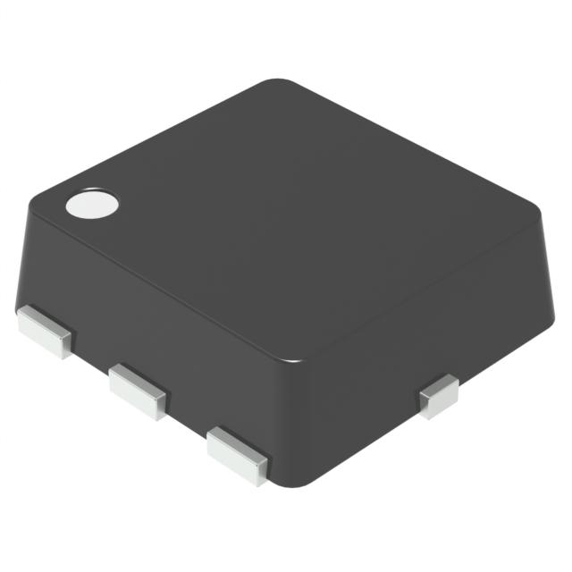

    HSNT-6-B_1.2X1.14MM-EP
    IC REG LINEAR 1.7V 200MA HSNT6-B
S-1315C17-A6T2U3 数据手册
S-1315 Series 5.5 V INPUT, 200 mA, OUTPUT CAPACITOR-LESS VOLTAGE REGULATOR www.ablic.com Rev.1.5_00 © ABLIC Inc., 2011-2022 The S-1315 Series, developed by using the CMOS technology, is a positive voltage regulator IC of 200 mA output current which has low dropout voltage, high-accuracy output voltage and low current consumption. The S-1315 Series enables high density mounting due to output capacitor-less. The current consumption is extremely low as 7 μA typ., and even without an output capacitor, it realizes high-speed response. It also has high-accuracy output voltage of ±1.0%.  Features • Output voltage: • Input voltage: • Output voltage accuracy: • Dropout voltage: • Current consumption: • Output current: • Input and output capacitors: • Ripple rejection: • Built-in overcurrent protection circuit: • Built-in ON / OFF circuit: • Operation temperature range: • Lead-free (Sn 100%), halogen-free 1.0 V to 4.2 V, selectable in 0.05 V step 1.4 V to 5.5 V ±1.0% (1.0 V to 1.45 V output product: ±15 mV) 224 mV typ. (3.0 V output product, IOUT = 200 mA) During operation: 7 μA typ., 13 μA max. During power-off: 0.1 μA typ., 1.0 μA max. Possible to output 200 mA (VIN ≥ VOUT(S) + 1.0 V)*1 A ceramic capacitor of 0.1 μF or more can be used for the input capacitor. Output capacitor is unnecessary, or a ceramic capacitor of 10 μF or less can be used. 65 dB typ. (1.0 V output product, f = 1.0 kHz) 60 dB typ. (2.8 V output product, f = 1.0 kHz) Limits overcurrent of output transistor. Ensures long battery life. Discharge shunt function "available" / "unavailable" is selectable. Pull-down function "available" / "unavailable" is selectable. Ta = −40°C to +85°C *1. Attention should be paid to the power dissipation of the package when the output current is large.  Applications • Constant-voltage power supply for battery-powered device • Constant-voltage power supply for communication device • Constant-voltage power supply for mobile phone • Constant-voltage power supply for module  Packages • SOT-23-5 • HSNT-6 (1212) 1 5.5 V INPUT, 200 mA, OUTPUT CAPACITOR-LESS VOLTAGE REGULATOR S-1315 Series Rev.1.5_00  Block Diagrams 1. S-1315 Series A type *1 VIN VOUT Overcurrent protection circuit ON / OFF ON / OFF circuit Function ON / OFF logic Discharge shunt function Constant current source pull-down Status Active "H" Available Available + − Reference voltage circuit *1 VSS *1. Parasitic diode Figure 1 2. S-1315 Series B type *1 VIN VOUT Overcurrent protection circuit ON / OFF ON / OFF circuit + − Reference voltage circuit *1 VSS *1. Parasitic diode Figure 2 2 Function ON / OFF logic Discharge shunt function Constant current source pull-down Status Active "H" Available Unavailable Rev.1.5_00 5.5 V INPUT, 200 mA, OUTPUT CAPACITOR-LESS VOLTAGE REGULATOR S-1315 Series 3. S-1315 Series C type *1 VIN VOUT Overcurrent protection circuit ON / OFF ON / OFF circuit Function ON / OFF logic Discharge shunt function Constant current source pull-down Status Active "H" Unavailable Available + − Reference voltage circuit VSS *1. Parasitic diode Figure 3 4. S-1315 Series D type *1 VIN VOUT Overcurrent protection circuit ON / OFF ON / OFF circuit Function ON / OFF logic Discharge shunt function Constant current source pull-down Status Active "H" Unavailable Unavailable + − Reference voltage circuit VSS *1. Parasitic diode Figure 4 3 5.5 V INPUT, 200 mA, OUTPUT CAPACITOR-LESS VOLTAGE REGULATOR S-1315 Series Rev.1.5_00  Product Name Structure Users can select the product type, output voltage, and package type for the S-1315 Series. Refer to "1. Product name" regarding the contents of product name, "2. Function list of product types" regarding the product type, "3. Packages" regarding the package drawings, "4. Product name lists" regarding details of the product name. 1. Product name S-1315 x xx - xxxx U 3 Environmental code U: Lead-free (Sn 100%), halogen-free Package abbreviation and IC packing specifications M5T1: SOT-23-5, Tape A6T2: HSNT-6 (1212), Tape *1 Output voltage*2 10 to 42 (e.g., when the output voltage is 1.0 V, it is expressed as 10.) Product type*3 A to D *1. *2. *3. Refer to the tape drawing. If you request the product which has 0.05 V step, contact our sales representatives. Refer to "2. Function list of product types". 2. Function list of product types Product Type A B C D ON / OFF Logic Active "H" Active "H" Active "H" Active "H" Table 1 Discharge Shunt Function Available Available Unavailable Unavailable Constant Current Source Pull-down Available Unavailable Available Unavailable 3. Packages Package Name SOT-23-5 HSNT-6 (1212) 4 Table 2 Package Drawing Codes Dimension Tape MP005-A-P-SD PM006-A-P-SD MP005-A-C-SD PM006-A-C-SD Reel MP005-A-R-SD PM006-A-R-SD Land − PM006-A-L-SD Rev.1.5_00 5.5 V INPUT, 200 mA, OUTPUT CAPACITOR-LESS VOLTAGE REGULATOR S-1315 Series 4. Product name lists 4. 1 S-1315 Series A type ON / OFF logic: Discharge shunt function: Active "H" Available Constant current source pull-down: Available Table 3 Output Voltage 1.2 V ± 15 mV 1.8 V ± 1.0% 2.5 V ± 1.0% 3.3 V ± 1.0% SOT-23-5 S-1315A12-M5T1U3 S-1315A18-M5T1U3 S-1315A25-M5T1U3 S-1315A33-M5T1U3 HSNT-6 (1212) S-1315A12-A6T2U3 S-1315A18-A6T2U3 S-1315A25-A6T2U3 S-1315A33-A6T2U3 Remark Please contact our sales representatives for products other than the above. 4. 2 S-1315 Series B type ON / OFF logic: Discharge shunt function: Output Voltage 1.2 V ± 15 mV 1.8 V ± 1.0% 2.5 V ± 1.0% 3.3 V ± 1.0% Active "H" Available Constant current source pull-down: Unavailable Table 4 SOT-23-5 S-1315B12-M5T1U3 S-1315B18-M5T1U3 S-1315B25-M5T1U3 S-1315B33-M5T1U3 HSNT-6 (1212) S-1315B12-A6T2U3 S-1315B18-A6T2U3 S-1315B25-A6T2U3 S-1315B33-A6T2U3 Remark Please contact our sales representatives for products other than the above. 4. 3 S-1315 Series C type ON / OFF logic: Discharge shunt function: Output Voltage 1.2 V ± 15 mV 1.8 V ± 1.0% 2.5 V ± 1.0% 3.3 V ± 1.0% Active "H" Unavailable Constant current source pull-down: Available Table 5 SOT-23-5 S-1315C12-M5T1U3 S-1315C18-M5T1U3 S-1315C25-M5T1U3 S-1315C33-M5T1U3 HSNT-6 (1212) S-1315C12-A6T2U3 S-1315C18-A6T2U3 S-1315C25-A6T2U3 S-1315C33-A6T2U3 Remark Please contact our sales representatives for products other than the above. 4. 4 S-1315 Series D type ON / OFF logic: Discharge shunt function: Output Voltage 1.2 V ± 15 mV 1.8 V ± 1.0% 2.5 V ± 1.0% 3.3 V ± 1.0% Active "H" Unavailable Constant current source pull-down: Unavailable Table 6 SOT-23-5 S-1315D12-M5T1U3 S-1315D18-M5T1U3 S-1315D25-M5T1U3 S-1315D33-M5T1U3 HSNT-6 (1212) S-1315D12-A6T2U3 S-1315D18-A6T2U3 S-1315D25-A6T2U3 S-1315D33-A6T2U3 Remark Please contact our sales representatives for products other than the above. 5 5.5 V INPUT, 200 mA, OUTPUT CAPACITOR-LESS VOLTAGE REGULATOR S-1315 Series Rev.1.5_00  Pin Configurations 1. SOT-23-5 Table 7 Top view 5 4 1 2 3 Pin No. 1 2 3 4 5 Symbol VIN VSS ON / OFF NC*1 VOUT Description Input voltage pin GND pin ON / OFF pin No connection Output voltage pin Figure 5 *1. The NC pin is electrically open. The NC pin can be connected to the VIN pin or the VSS pin. 2. HSNT-6 (1212) Table 8 Top view 1 2 3 6 5 4 Bottom view 6 5 4 1 2 3 Pin No. 1 2 3 4 5 6 Symbol VOUT VSS NC*2 ON / OFF NC*2 VIN Description Output voltage pin GND pin No connection ON / OFF pin No connection Input voltage pin *1 Figure 6 *1. Connect the heat sink of backside at shadowed area to the board, and set electric potential GND. However, do not use it as the function of electrode. *2. The NC pin is electrically open. The NC pin can be connected to the VIN pin or the VSS pin. 6 Rev.1.5_00 5.5 V INPUT, 200 mA, OUTPUT CAPACITOR-LESS VOLTAGE REGULATOR S-1315 Series  Absolute Maximum Ratings Table 9 (Ta = +25°C unless otherwise specified) Item Symbol VIN VON / OFF VOUT IOUT Input voltage Output voltage Output current SOT-23-5 PD HSNT-6 (1212) Operation ambient temperature Topr Storage temperature Tstg *1. When mounted on board [Mounted board] (1) Board size: 114.3 mm × 76.2 mm × t1.6 mm (2) Name: JEDEC STANDARD51-7 Power dissipation Unit V V V mA mW mW °C °C The absolute maximum ratings are rated values exceeding which the product could suffer physical damage. These values must therefore not be exceeded under any conditions. 1200 Power Dissipation (PD) [mW] Caution Absolute Maximum Rating VSS − 0.3 to VSS + 6.0 VSS − 0.3 to VIN + 0.3 VSS − 0.3 to VIN + 0.3 260 600*1 480*1 −40 to +85 −40 to +125 1000 800 600 400 200 0 Figure 7 HSNT-6 (1212) SOT-23-5 0 150 100 50 Ambient Temperature (Ta) [°C] Power Dissipation of Package (When Mounted on Board) 7 5.5 V INPUT, 200 mA, OUTPUT CAPACITOR-LESS VOLTAGE REGULATOR S-1315 Series Rev.1.5_00 Power Dissipation of HSNT-6 (1212) (Reference) Power dissipation of package differs depending on the mounting conditions. Consider the power dissipation characteristics under the following conditions as reference. [Mounted board] (1) Board size: (2) Board material: (3) Wiring ratio: (4) Test conditions: (5) Land pattern: 40 mm × 40 mm × t0.8 mm Glass epoxy resin (four layers) 50% When mounted on board (wind speed: 0 m/s) Refer to the recommended land pattern (drawing code: PM006-A-L-SD) Power Dissipation (PD) [mW] 1200 1000 800 600 400 200 0 Figure 8 Condition HSNT-6 (1212) (When mounted on board) 8 0 150 100 50 Ambient Temperature (Ta) [°C] Power Dissipation of Package (When Mounted on Board) Table 10 Power Dissipation (Reference) Thermal Resistance Value (θj−a) 1000 mW 100°C/W Rev.1.5_00 5.5 V INPUT, 200 mA, OUTPUT CAPACITOR-LESS VOLTAGE REGULATOR S-1315 Series  Electrical Characteristics Table 11 Item Output voltage*1 Output current*2 Dropout voltage*3 Line regulation Symbol VOUT(E) IOUT Vdrop ΔVOUT1 ΔVIN • VOUT Condition VIN = VOUT(S) + 1.0 V, IOUT = 30 mA 1.0 V ≤ VOUT(S) < 1.5 V 1.5 V ≤ VOUT(S) ≤ 4.2 V VIN ≥ VOUT(S) + 1.0 V IOUT = 200 mA 1.0 V ≤ VOUT(S) < 1.1 V 1.1 V ≤ VOUT(S) < 1.2 V 1.2 V ≤ VOUT(S) < 1.5 V 1.5 V ≤ VOUT(S) < 2.0 V 2.0 V ≤ VOUT(S) < 2.6 V 2.6 V ≤ VOUT(S) ≤ 4.2 V (Ta = +25°C unless otherwise specified) Test Min. Typ. Max. Unit Circuit VOUT(S) VOUT(S) VOUT(S) V 1 − 0.015 + 0.015 VOUT(S) VOUT(S) VOUT(S) V 1 × 0.99 × 1.01 − − 200*5 mA 3 − 0.629 0.844 V 1 − 0.554 0.744 V 1 − 0.485 0.665 V 1 − 0.371 0.486 V 1 − 0.272 0.344 V 1 − 0.224 0.280 V 1 VOUT(S) + 0.5 V ≤ VIN ≤ 5.5 V, IOUT = 30 mA − 0.05 0.2 %/V 1 VIN = VOUT(S) + 1.0 V, 1 mA ≤ IOUT ≤ 200 mA − 25 50 mV 1 Load regulation ΔVOUT2 Output voltage temperature coefficient*4 ΔTa • VOUT VIN = VOUT(S) + 1.0 V, IOUT = 30 mA −40°C ≤ Ta ≤ +85°C − ±100 − ppm/°C 1 ISS1 VIN = VOUT(S) + 1.0 V, ON / OFF pin = ON, no load − 7.0 13 μA 2 ΔVOUT Current consumption during operation Current consumption during power-off Input voltage ISS2 VIN = VOUT(S) + 1.0 V, ON / OFF pin = OFF, no load − 0.1 1.0 μA 2 VIN 1.4 − 5.5 V − ON / OFF pin input voltage "H" VSH 1.0 − − V 4 ON / OFF pin input voltage "L" VSL − VIN = VOUT(S) + 1.0 V, RL = 1.0 kΩ determined by VOUT output level VIN = VOUT(S) + 1.0 V, RL = 1.0 kΩ determined by VOUT output level A / C type (with constant current source pull-down) VIN = 5.5 V, VON / OFF = 5.5 V B / D type (without constant current source pull-down) − − 0.30 V 4 − 0.1 − μA 4 −0.1 − 0.1 μA 4 −0.1 − 0.1 μA 4 − 65 − dB 5 − 60 − dB 5 − 55 − dB 5 − 50 − mA 3 − 30 − Ω 3 ON / OFF pin input current "H" ON / OFF pin input current "L" Ripple rejection Short-circuit current Discharge shunt resistance during power-off ISH ISL RR Ishort RLOW VIN = 5.5 V, VON / OFF = 0 V VIN = VOUT(S) + 1.0 1.0 V ≤ VOUT(S) ≤ 1.2 V V, 1.2 V < VOUT(S) ≤ 2.8 V f = 1.0 kHz, ΔVrip = 0.2 Vrms, 2.8 V < VOUT(S) ≤ 4.2 V IOUT = 30 mA VIN = VOUT(S) + 1.0 V, ON / OFF pin = ON, VOUT = 0 V A / B type VIN = 5.5 V, (with discharge shunt function) VOUT = 0.1 V 9 5.5 V INPUT, 200 mA, OUTPUT CAPACITOR-LESS VOLTAGE REGULATOR S-1315 Series Rev.1.5_00 *1. VOUT(S): Set output voltage VOUT(E): Actual output voltage Output voltage when fixing IOUT (= 30 mA) and inputting VOUT(S) + 1.0 V *2. The output current at which the output voltage becomes 95% of VOUT(E) after gradually increasing the output current. *3. Vdrop = VIN1 − (VOUT3 × 0.98) VOUT3 is the output voltage when VIN = VOUT(S) + 1.0 V and IOUT = 200 mA. VIN1 is the input voltage at which the output voltage becomes 98% of VOUT3 after gradually decreasing the input voltage. *4. A change in the temperature of the output voltage [mV/°C] is calculated using the following equation. ΔVOUT ΔVOUT [mV/°C]*1 = VOUT(S) [V]*2 × ΔTa•VOUT [ppm/°C]*3 ÷ 1000 ΔTa *1. Change in temperature of output voltage *2. Set output voltage *3. Output voltage temperature coefficient *5. The output current can be at least this value. Due to restrictions on the package power dissipation, this value may not be satisfied. Attention should be paid to the power dissipation of the package when the output current is large. This specification is guaranteed by design. 10 Rev.1.5_00 5.5 V INPUT, 200 mA, OUTPUT CAPACITOR-LESS VOLTAGE REGULATOR S-1315 Series  Test Circuits VIN + VOUT ON / OFF VSS V A + Set to ON Figure 9 Test Circuit 1 + A VIN VOUT ON / OFF VSS Set to VIN or GND Figure 10 Test Circuit 2 VIN VOUT ON / OFF A V + VSS Set to VIN or GND Figure 11 Test Circuit 3 VIN + A VOUT ON / OFF V + VSS RL Figure 12 Test Circuit 4 VIN VOUT ON / OFF V VSS + RL Set to ON Figure 13 Test Circuit 5 11 5.5 V INPUT, 200 mA, OUTPUT CAPACITOR-LESS VOLTAGE REGULATOR S-1315 Series Rev.1.5_00  Standard Circuit Input Output VOUT VIN CIN *1 ON / OFF VSS Single GND CL *2 GND *1. CIN is a capacitor for stabilizing the input. *2. An output capacitor (CL) is unnecessary. However, if it is used, select an output capacitor which is 10 μF or less. Figure 14 Caution The above connection diagram and constants will not guarantee successful operation. Perform thorough evaluation using the actual application to set the constants.  Condition of Application Input capacitor (CIN): Output capacitor (CL): 0.1 μF or more Unnecessary, or an output capacitor which is 10 μF or less. Caution Generally a series regulator may cause oscillation, depending on the selection of external parts. Confirm that no oscillation occurs in the application for which the above capacitors are used.  Selection of Input and Output Capacitors (CIN, CL) The S-1315 Series does not require an output capacitor between the VOUT pin and the VSS pin for phase compensation. Operation is stabilized even without an output capacitor over the entire temperature range. If the capacitor is used, the operation is stabilized with a ceramic capacitor which is CL ≤ 10 μF in the same way. Moreover, when using an OS capacitor, a tantalum capacitor, or an aluminum electrolytic capacitor, the capacitance must be 10 μF or less. The value of the output overshoot or undershoot transient response varies depending on the value of the output capacitor. The required capacitance of the input capacitor differs depending on the application. The recommended capacitance for an application is CIN ≥ 0.1 μF; however, when selecting the output capacitor, perform sufficient evaluation, including evaluation of temperature characteristics, on the actual device. 12 Rev.1.5_00 5.5 V INPUT, 200 mA, OUTPUT CAPACITOR-LESS VOLTAGE REGULATOR S-1315 Series  Explanation of Terms 1. Low dropout voltage regulator This voltage regulator has the low dropout voltage due to its built-in low on-resistance transistor. 2. Output voltage (VOUT) The accuracy of the output voltage is ensured at ±1.0% or ±15 mV*1 under the specified conditions of fixed input voltage*2, fixed output current, and fixed temperature. *1. *2. When VOUT < 1.5 V: ±15 mV, when VOUT ≥ 1.5 V: ±1.0% Differs depending on the product. Caution If the above conditions change, the output voltage value may vary and exceed the accuracy range of the output voltage. Refer to " Electrical Characteristics" and " Characteristics (Typical Data)" for details. ΔVOUT1  3. Line regulation  ΔVIN•VOUT  Indicates the dependency of the output voltage on the input voltage. That is, the values show how much the output voltage changes due to a change in the input voltage with the output current remaining unchanged. 4. Load regulation (ΔVOUT2) Indicates the dependency of the output voltage on the output current. That is, the values show how much the output voltage changes due to a change in the output current with the input voltage remaining unchanged. 5. Dropout voltage (Vdrop) Indicates the difference between input voltage (VIN1) and the output voltage when; decreasing input voltage (VIN) gradually until the output voltage has dropped out to the value of 98% of output voltage (VOUT3), which is at VIN = VOUT(S) + 1.0 V. Vdrop = VIN1 − (VOUT3 × 0.98) 13 5.5 V INPUT, 200 mA, OUTPUT CAPACITOR-LESS VOLTAGE REGULATOR S-1315 Series Rev.1.5_00 ΔVOUT  6. Output voltage temperature coefficient  ΔTa•VOUT  The shaded area in Figure 15 is the range where VOUT varies in the operation temperature range when the output voltage temperature coefficient is ±100 ppm/°C. Example of VOUT = 1.0 V typ. product VOUT [V] +0.10 mV/°C VOUT(E)*1 −0.10 mV/°C −40 *1. +25 +85 Ta [°C] VOUT(E) is the value of the output voltage measured at Ta = +25°C. Figure 15 A change in the temperature of the output voltage [mV/°C] is calculated using the following equation. ΔVOUT ΔVOUT [mV/°C]*1 = VOUT(S) [V]*2 × ΔTa•VOUT [ppm/°C]*3 ÷ 1000 ΔTa *1. Change in temperature of output voltage *2. Set output voltage *3. Output voltage temperature coefficient 14 Rev.1.5_00 5.5 V INPUT, 200 mA, OUTPUT CAPACITOR-LESS VOLTAGE REGULATOR S-1315 Series  Operation 1. Basic operation Figure 16 shows the block diagram of the S-1315 Series. The error amplifier compares the reference voltage (Vref) with feedback voltage (Vfb), which is the output voltage resistance-divided by feedback resistors (Rs and Rf). It supplies the gate voltage necessary to maintain the constant output voltage which is not influenced by the input voltage and temperature change, to the output transistor. VIN *1 Current supply Error amplifier Vref VOUT − Rf + Vfb Reference voltage circuit Rs VSS *1. Parasitic diode Figure 16 2. Output transistor In the S-1315 Series, a low on-resistance P-channel MOS FET is used as the output transistor. Be sure that VOUT does not exceed VIN + 0.3 V to prevent the voltage regulator from being damaged due to reverse current flowing from the VOUT pin through a parasitic diode to the VIN pin, when the potential of VOUT became higher than VIN. 15 5.5 V INPUT, 200 mA, OUTPUT CAPACITOR-LESS VOLTAGE REGULATOR S-1315 Series Rev.1.5_00 3. ON / OFF pin This pin starts and stops the regulator. When the ON / OFF pin is set to OFF level, the entire internal circuit stops operating, and the built-in P-channel MOS FET output transistor between the VIN pin and the VOUT pin is turned off, reducing current consumption significantly. Note that the current consumption increases when a voltage of 0.25 V to 1.0 V is applied to the ON / OFF pin. The ON / OFF pin is configured as shown in Figure 17 and Figure 18. 3. 1 S-1315 Series A / C type The ON / OFF pin is internally pulled down to the VSS pin in the floating status, so the VOUT pin is set to the VSS level. For the ON / OFF pin current, refer to the A / C type of ON / OFF pin input current "H" in " Electrical Characteristics". 3. 2 S-1315 Series B / D type The ON / OFF pin is internally not pulled up or pulled down, so do not use this pin in the floating status. When not using the ON / OFF pin, connect the pin to the VIN pin. Product Type A/B/C/D A/B/C/D ON / OFF Pin "H": ON "L": OFF Table 12 Internal Circuit VOUT Pin Voltage Operate Set value Stop VSS level Current Consumption ISS1*1 ISS2 *1. Note that the IC's current consumption increases as much as current flows into the constant current when the ON / OFF pin is connected to the VIN pin and the S-1315 Series A / C type is operating (refer to Figure 17). VIN ON / OFF ON / OFF VSS Figure 17 S-1315 Series A / C type 16 VIN VSS Figure 18 S-1315 Series B / D type Rev.1.5_00 5.5 V INPUT, 200 mA, OUTPUT CAPACITOR-LESS VOLTAGE REGULATOR S-1315 Series 4. Discharge shunt function (S-1315 Series A / B type) The S-1315 Series A / B type has a built-in discharge shunt circuit to discharge the output capacitance. The output capacitance is discharged as follows so that the VOUT pin reaches the VSS level. (1) The ON / OFF pin is set to OFF level. (2) The output transistor is turned off. (3) The discharge shunt circuit is turned on. (4) The output capacitor discharges. Since the S-1315 Series C / D type does not have a discharge shunt circuit, the VOUT pin is set to the VSS level through several MΩ internal divided resistors between the VOUT pin and the VSS pin. The S-1315 Series A / B type allows the VOUT pin to reach the VSS level rapidly due to the discharge shunt circuit. S-1315 Series Output transistor: OFF *1 VOUT VIN Discharge shunt circuit : ON *1 ON / OFF ON / OFF circuit Output capacitor (CL) ON / OFF Pin : OFF Current flow GND VSS *1. Parasitic diode Figure 19 5. Constant current source pull-down (S-1315 Series A / C type) The ON / OFF pin is internally pulled down to the VSS pin in the floating status, so the VOUT pin is set to the VSS level. Note that the IC's current consumption increases as much as current flows into the constant current of 0.1 μA typ. when the ON / OFF pin is connected to the VIN pin. 17 5.5 V INPUT, 200 mA, OUTPUT CAPACITOR-LESS VOLTAGE REGULATOR S-1315 Series Rev.1.5_00 6. Overcurrent protection circuit The S-1315 Series includes an overcurrent protection circuit having the characteristics shown in "1. Output voltage vs. Output current (When load current increases) (Ta = +25°C)" in " Characteristics (Typical Data)", in order to protect the output transistor against an excessive output current and short circuiting between the VOUT pin and the VSS pin. The current (Ishort) when the output pin is short-circuited is internally set at approx. 50 mA typ., and the normal value is restored for the output voltage, if releasing a short circuit once. Caution This overcurrent protection circuit does not work as for thermal protection. If this IC long keeps short circuiting inside, pay attention to the conditions of input voltage and load current so that, under the usage conditions including short circuit, the loss of the IC will not exceed power dissipation of the package. 18 Rev.1.5_00 5.5 V INPUT, 200 mA, OUTPUT CAPACITOR-LESS VOLTAGE REGULATOR S-1315 Series  Precautions • Wiring patterns for the VIN pin, the VOUT pin and GND should be designed so that the impedance is low. When mounting an output capacitor between the VOUT pin and the VSS pin (CL) and the capacitor for stabilizing the input between the VIN pin and the VSS pin (CIN), the distance from the capacitors to these pins should be as short as possible. • Note that generally the output voltage may increase when a series regulator is used at low load current (0.1 mA or less). • Note that generally the output voltage may increase due to the leakage current from an output driver when a series regulator is used at high temperature. • Note that the output voltage may increase due to the leakage current from an output driver even if the ON / OFF pin is at OFF level when a series regulator is used at high temperature. • Generally a series regulator may cause oscillation, depending on the selection of external parts. The following conditions are recommended for the S-1315 Series. However, be sure to perform sufficient evaluation under the actual usage conditions for selection, including evaluation of temperature characteristics. Refer to "5. Example of equivalent series resistance vs. Output current characteristics (Ta = +25°C)" in " Reference Data" for the equivalent series resistance (RESR) of the output capacitor. Input capacitor (CIN): Output capacitor (CL): 0.1 μF or more Unnecessary or an output capacitor which is 10 μF or less. • The voltage regulator may oscillate when the impedance of the power supply is high and the input capacitance is small or an input capacitor is not connected. • If the output capacitance is small, power supply's fluctuation and the characteristics of load fluctuation become worse. Sufficiently evaluate the output voltage's fluctuation with the actual device. • Overshoot may occur in the output voltage momentarily if the voltage is rapidly raised at power-on or when the power supply fluctuates. Sufficiently evaluate the output voltage at power-on with the actual device. • Output voltage noise may increase when the output current is low. • The application conditions for the input voltage, the output voltage, and the load current should not exceed the package power dissipation. • Do not apply an electrostatic discharge to this IC that exceeds the performance ratings of the built-in electrostatic protection circuit. • In determining the output current, attention should be paid to the output current value specified in Table 11 in " Electrical Characteristics" and footnote *5 of the table. • ABLIC Inc. claims no responsibility for any disputes arising out of or in connection with any infringement by products including this IC of patents owned by a third party. 19 5.5 V INPUT, 200 mA, OUTPUT CAPACITOR-LESS VOLTAGE REGULATOR S-1315 Series Rev.1.5_00  Characteristics (Typical Data) 1. Output voltage vs. Output current (When load current increases) (Ta = +25°C) 1. 1 VOUT = 1.0 V 1.2 0.8 0.6 VOUT [V] VOUT [V] 1.0 VIN = 1.4 V 3.0 V 2.0 V 1.8 V 0.4 0.2 0 0 100 200 300 IOUT [mA] 400 1. 2 VOUT = 2.8 V 3.5 3.0 2.5 2.0 VIN = 5.5 V 1.5 1.0 0.5 0 0 100 200 300 IOUT [mA] 500 3.3 V 3.8 V 4.8 V 400 500 VOUT [V] 1. 3 VOUT = 4.2 V 5.0 4.5 4.0 3.5 3.0 2.5 2.0 1.5 1.0 0.5 0 Remark VIN = 5.5 V 5.2 V 4.7 V 0 100 200 300 IOUT [mA] 400 In determining the output current, attention should be paid to the following. 1. The minimum output current value and footnote *5 in Table 11 in " Electrical Characteristics" 2. The package power dissipation 500 2. Output voltage vs. Input voltage (Ta = +25°C) 2. 2 VOUT = 2.8 V 1.2 3.0 1.0 2.5 0.8 IOUT = 1 mA IOUT = 30 mA IOUT = 50 mA IOUT = 100 mA 0.6 0.4 0.2 VOUT [V] VOUT [V] 2. 1 VOUT = 1.0 V 1.0 0 0 1.0 2.0 3.0 4.0 VIN [V] 5.0 6.0 2. 3 VOUT = 4.2 V VOUT [V] IOUT = 1 mA IOUT = 30 mA IOUT = 50 mA IOUT = 100 mA 1.5 0.5 0 4.5 4.0 3.5 3.0 2.5 2.0 1.5 1.0 0.5 0 IOUT = 1 mA IOUT = 30 mA IOUT = 50 mA IOUT = 100 mA 0 20 2.0 1.0 2.0 3.0 4.0 VIN [V] 5.0 6.0 0 1.0 2.0 3.0 4.0 VIN [V] 5.0 6.0 Rev.1.5_00 5.5 V INPUT, 200 mA, OUTPUT CAPACITOR-LESS VOLTAGE REGULATOR S-1315 Series 3. Dropout voltage vs. Output current Ta = +85°C Ta = +25°C Ta = −40°C 100 150 IOUT [mA] 3. 2 VOUT = 2.8 V 0.35 0.30 Ta = +85°C 0.25 Ta = +25°C 0.20 Ta = −40°C 0.15 0.10 0.05 0 0 50 100 150 IOUT [mA] Vdrop [V] Vdrop [V] 3. 1 VOUT = 1.0 V 0.8 0.7 0.6 0.5 0.4 0.3 0.2 0.1 0 0 50 200 250 200 250 200 250 3. 3 VOUT = 4.2 V 0.30 Vdrop [V] 0.25 Ta = +85°C Ta = +25°C Ta = −40°C 0.20 0.15 0.10 0.05 0 0 50 100 150 IOUT [mA] Vdrop [V] 4. Dropout voltage vs. Set output voltage 0.7 0.6 0.5 0.4 0.3 0.2 0.1 0 IOUT = 200 mA 100 mA 50 mA 30 mA 1 mA 1.0 1.5 2.0 2.5 3.0 3.5 VOUT(S) [V] 4.0 4.5 21 5.5 V INPUT, 200 mA, OUTPUT CAPACITOR-LESS VOLTAGE REGULATOR S-1315 Series Rev.1.5_00 5. Output voltage vs. Ambient temperature 1.20 1.15 1.10 1.05 1.00 0.95 0.90 0.85 0.80 5. 2 VOUT = 2.8 V VOUT [V] VOUT [V] 5. 1 VOUT = 1.0 V −40 −25 0 25 Ta [°C] 50 75 85 0 25 Ta [°C] 50 75 85 3.00 2.95 2.90 2.85 2.80 2.75 2.70 2.65 2.60 2.55 2.50 −40 −25 0 25 Ta [°C] 75 85 50 VOUT [V] 5. 3 VOUT = 4.2 V 4.40 4.35 4.30 4.25 4.20 4.15 4.10 4.05 4.00 −40 −25 6. Current consumption vs. Input voltage 6. 1 VOUT = 1.0 V 6. 2 VOUT = 2.8 V Ta = +25°C 10 20 ISS1 [μA] ISS1 [μA] 8 6 4 2 10 0 0 1 2 3 VIN [V] 4 5 6 6. 3 VOUT = 4.2 V ISS1 [μA] 15 5 0 Ta = +25°C 50 45 40 35 30 25 20 15 10 5 0 0 22 Ta = +25°C 25 1 2 3 VIN [V] 4 5 6 0 1 2 3 VIN [V] 4 5 6 Rev.1.5_00 5.5 V INPUT, 200 mA, OUTPUT CAPACITOR-LESS VOLTAGE REGULATOR S-1315 Series 7. Current consumption vs. Ambient temperature 9 8 7 6 5 4 3 2 1 0 7. 2 VOUT = 2.8 V ISS1 [μA] ISS1 [μA] 7. 1 VOUT = 1.0 V −40 −25 0 25 Ta [°C] 50 75 85 0 25 Ta [°C] 50 75 85 9 8 7 6 5 4 3 2 1 0 −40 −25 0 25 Ta [°C] 50 75 85 ISS1 [μA] 7. 3 VOUT = 4.2 V 9 8 7 6 5 4 3 2 1 0 −40 −25 8. Ripple rejection (Ta = +25°C) 8. 2 VOUT = 2.8 V 8. 1 VOUT = 1.0 V 100 IOUT = 30 mA 80 60 IOUT = 1 mA IOUT = 150 mA IOUT = 50 mA 40 20 0 10 100 1k 10k 100k Frequency [Hz] VIN = 3.8 V, CL = 0.1 μF Ripple Rejection [dB] Ripple Rejection [dB] VIN = 2.0 V, CL = 0.1 μF 1M 100 IOUT = 150 mA 80 60 40 IOUT = 1 mA IOUT = 30 mA IOUT = 50 mA 20 0 10 100 1k 10k 100k Frequency [Hz] 1M 8. 3 VOUT = 4.2 V Ripple Rejection [dB] VIN = 5.2 V, CL = 0.1 μF 100 IOUT = 150 mA 80 60 40 IOUT = 1 mA IOUT = 30 mA IOUT = 50 mA 20 0 10 100 1k 10k 100k Frequency [Hz] 1M 23 5.5 V INPUT, 200 mA, OUTPUT CAPACITOR-LESS VOLTAGE REGULATOR S-1315 Series Rev.1.5_00 9. Ripple rejection vs. Output capacitance (Ta = +25°C) 9. 1 VOUT = 1.0 V 9. 2 VOUT = 2.8 V 100 80 60 CL = 0 μF 40 CL = 0.1 μF 20 CL = 1 μF 0 10 100 1k 10k 100k Frequency [Hz] 1M 9. 3 VOUT = 4.2 V Ripple Rejection [dB] VIN = 5.2 V, IOUT = 30 mA 100 80 60 CL = 0 μF 40 CL = 0.1 μF 20 CL = 1 μF 0 10 24 100 1k 10k 100k Frequency [Hz] VIN = 3.8 V, IOUT = 30 mA Ripple Rejection [dB] Ripple Rejection [dB] VIN = 2.0 V, IOUT = 30 mA 1M 100 80 60 CL = 0 μF 40 CL = 0.1 μF 20 CL = 1 μF 0 10 100 1k 10k 100k Frequency [Hz] 1M Rev.1.5_00 5.5 V INPUT, 200 mA, OUTPUT CAPACITOR-LESS VOLTAGE REGULATOR S-1315 Series  Reference Data 1. Transient response characteristics when input (Ta = +25°C) 1. 1 VOUT = 1.0 V VIN = 2.0 V ↔ 3.0 V, CL = 0 μF, IOUT = 30 mA, tr = tf = 5.0 μs 4 1.20 1.15 2 1.10 1 1.05 1.00 3 VOUT 0 3 VIN 2 1 1.05 1.00 VOUT 0 0.95 −1 0.95 −1 0.90 −2 0.90 −2 −40 −20 0 20 40 60 80 100 120 140 t [μs] −40 −20 0 20 40 60 80 100 120 140 t [μs] VIN [V] 1.10 VIN VIN [V] VOUT [V] VOUT [V] 1.15 VIN = 2.0 V ↔ 3.0 V, CL = 0.1 μF, IOUT = 30 mA, tr = tf = 5.0 μs 4 1.20 1. 2 VOUT = 2.8 V VIN = 3.8 V ↔ 4.8 V, CL = 0 μF, IOUT = 30 mA, tr = tf = 5.0 μs 6 3.00 3 2.85 2.80 VOUT 2 2.90 4 3 2.85 2.80 2.75 1 2.75 2.70 0 2.70 −40 −20 0 VIN 20 40 60 80 100 120 140 t [μs] VOUT 2 VIN [V] 4 5 2.95 VOUT [V] 2.90 5 VIN VIN [V] VOUT [V] 2.95 VIN = 3.8 V ↔ 4.8 V, CL = 0.1 μF, IOUT = 30 mA, tr = tf = 5.0 μs 6 3.00 1 0 −40 −20 0 20 40 60 80 100 120 140 t [μs] 1. 3 VOUT = 4.2 V VIN = 4.5 V ↔ 5.5 V, CL = 0 μF, IOUT = 30 mA, tr = tf = 5.0 μs 6 4.40 4.25 4.20 −40 −20 0 4 4.30 3 VOUT 2 4.15 4.10 4.35 20 40 60 80 100 120 140 t [μs] 4.25 4.20 1 4.15 0 4.10 5 VIN 4 3 VOUT 2 VIN [V] 4.30 5 VIN [V] VIN VOUT [V] VOUT [V] 4.35 VIN = 4.5 V ↔ 5.5 V, CL = 0.1 μF, IOUT = 30 mA, tr = tf = 5.0 μs 6 4.40 1 0 −40 −20 0 20 40 60 80 100 120 140 t [μs] 25 5.5 V INPUT, 200 mA, OUTPUT CAPACITOR-LESS VOLTAGE REGULATOR S-1315 Series Rev.1.5_00 2. Transient response characteristics of load (Ta = +25°C) 2. 1 VOUT = 1.0 V CL = 0 μF CL = 0.1 μF VOUT CL = 1 μF −40 −20 0 20 40 60 80 100 120 140 t [μs] 100 50 0 −50 −100 −150 −200 −250 −300 1.6 1.5 1.4 1.3 1.2 1.1 1.0 0.9 0.8 IOUT CL = 0 μF VOUT CL = 0.1 μF CL = 1 μF −20 −10 0 10 20 30 40 50 60 70 t [μs] 150 100 50 0 −50 −100 −150 −200 −250 IOUT [mA] IOUT IOUT [mA] 1.6 1.5 1.4 1.3 1.2 1.1 1.0 0.9 0.8 VIN = 2.0 V, CIN = 0.1 μF, IOUT = 50 mA ↔ 100 mA, tr = tf = 0.5 μs VOUT [V] VOUT [V] VIN = 2.0 V, CIN = 0.1 μF, IOUT = 5.0 mA ↔ 50 mA, tr = tf = 2.0 μs 2. 2 VOUT = 2.8 V CL = 0 μF CL = 0.1 μF VOUT CL = 1 μF −40 −20 0 20 40 60 80 100 120 140 t [μs] 3.4 3.3 3.2 3.1 3.0 2.9 2.8 2.7 2.6 IOUT CL = 0 μF VOUT CL = 0.1 μF CL = 1 μF −20 −10 0 10 20 30 40 50 60 70 t [μs] 150 100 50 0 −50 −100 −150 −200 −250 IOUT [mA] IOUT 100 50 0 −50 −100 −150 −200 −250 −300 IOUT [mA] 3.4 3.3 3.2 3.1 3.0 2.9 2.8 2.7 2.6 VIN = 3.8 V, CIN = 0.1 μF, IOUT = 50 mA ↔ 100 mA, tr = tf = 0.5 μs VOUT [V] VOUT [V] VIN = 3.8 V, CIN = 0.1 μF, IOUT = 5.0 mA ↔ 50 mA, tr = tf = 2.0 μs 2. 3 VOUT = 4.2 V 26 CL = 0 μF VOUT CL = 0.1 μF CL = 1 μF −40 −20 0 20 40 60 80 100 120 140 t [μs] 4.8 4.7 4.6 4.5 4.4 4.3 4.2 4.1 4.0 IOUT CL = 0 μF VOUT CL = 0.1 μF CL = 1 μF −20 −10 0 10 20 30 40 50 60 70 t [μs] 150 100 50 0 −50 −100 −150 −200 −250 IOUT [mA] IOUT 100 50 0 −50 −100 −150 −200 −250 −300 IOUT [mA] 4.8 4.7 4.6 4.5 4.4 4.3 4.2 4.1 4.0 VIN = 5.2 V, CIN = 0.1 μF, IOUT = 50 mA ↔ 100 mA, tr = tf = 0.5 μs VOUT [V] VOUT [V] VIN = 5.2 V, CIN = 0.1 μF, IOUT = 5.0 mA ↔ 50 mA, tr = tf = 2.0 μs Rev.1.5_00 5.5 V INPUT, 200 mA, OUTPUT CAPACITOR-LESS VOLTAGE REGULATOR S-1315 Series 3. Transient response characteristics of ON / OFF pin (when rising) (Ta = +25°C) 3. 1 VOUT = 1.0 V 1.0 0.5 IOUT = 30 mA IOUT = 200 mA 0 −0.5 VOUT −100 0 100 200 300 400 500 600 700 800 t [μs] 1 0 −1 1.5 IOUT = 1 mA 1.0 0.5 −2 0 −3 −0.5 VOUT IOUT = 30 mA IOUT = 200 mA −100 0 100 200 300 400 500 600 700 800 t [μs] VON / OFF [V] IOUT = 1 mA VOUT [V] 1.5 VIN = 2.0 V, CIN = 0.1 μF, CL = 1.0 μF, VON / OFF = 0 V → 2.0 V 2.5 3 VON / OFF 2.0 2 VON / OFF [V] VOUT [V] VIN = 2.0 V, CIN = 0.1 μF, CL = 0 μF, VON / OFF = 0 V → 2.0 V 2.5 3 VON / OFF 2.0 2 1 0 −1 −2 −3 VIN = 3.8 V, CIN = 0.1 μF, CL = 1.0 μF, VON / OFF = 0 V → 3.8 V 6.3 5 4 5.6 VON / OFF 3 4.9 2 4.2 IOUT = 1 mA 1 3.5 VOUT 0 2.8 −1 2.1 −2 1.4 IOUT = 30 mA −3 0.7 IOUT = 200 mA −4 0 −0.7 −5 −100 0 100 200 300 400 500 600 700 800 t [μs] VON / OFF [V] VOUT [V] VIN = 3.8 V, CIN = 0.1 μF, CL = 0 μF, VON / OFF = 0 V → 3.8 V 6.3 5 4 5.6 VON / OFF 3 4.9 2 4.2 IOUT = 1 mA 1 3.5 VOUT 0 2.8 −1 2.1 −2 1.4 IOUT = 30 mA −3 0.7 IOUT = 200 mA −4 0 −0.7 −5 −100 0 100 200 300 400 500 600 700 800 t [μs] VON / OFF [V] VOUT [V] 3. 2 VOUT = 2.8 V VON / OFF [V] VIN = 5.2 V, CIN = 0.1 μF, CL = 1.0 μF, VON / OFF = 0 V → 5.2 V 6.3 6 5 5.6 V ON / OFF 4 4.9 3 4.2 2 3.5 VOUT 1 2.8 0 2.1 IOUT = 1 mA −1 1.4 IOUT = 30 mA −2 0.7 IOUT = 200 mA −3 0 −0.7 −4 −100 0 100 200 300 400 500 600 700 800 t [μs] VOUT [V] VIN = 5.2 V, CIN = 0.1 μF, CL = 0 μF, VON / OFF = 0 V → 5.2 V 6.3 6 5 5.6 VON / OFF 4 4.9 3 4.2 2 VOUT 3.5 1 2.8 0 2.1 IOUT = 1 mA −1 1.4 IOUT = 30 mA −2 0.7 IOUT = 200 mA −3 0 −0.7 −4 −100 0 100 200 300 400 500 600 700 800 t [μs] VON / OFF [V] VOUT [V] 3. 3 VOUT = 4.2 V 27 5.5 V INPUT, 200 mA, OUTPUT CAPACITOR-LESS VOLTAGE REGULATOR S-1315 Series Rev.1.5_00 4. Transient response characteristics of ON / OFF pin (when falling) (Ta = +25°C) VIN = 2.0 V, CIN = 0.1 μF, CL = 1.0 μF, VON / OFF = 2.0 V → 0 V 3.0 3 2.5 2 2.0 1 VON / OFF 1.5 0 IOUT = 1 mA 1.0 −1 IOUT = 30 mA 0.5 −2 IOUT = 200 mA 0 −3 VOUT −0.5 −4 −20 0 20 40 60 80 100 120 140 160 180 t [μs] VON / OFF [V] VOUT [V] VIN = 2.0 V, CIN = 0.1 μF, CL = 0 μF, VON / OFF = 2.0 V → 0 V 3.0 3 2.5 2 2.0 1 VON / OFF 1.5 0 IOUT = 1 mA 1.0 −1 IOUT = 30 mA 0.5 −2 IOUT = 200 mA 0 −3 VOUT −0.5 −4 −10 0 10 20 30 40 50 60 70 80 t [μs] VON / OFF [V] VOUT [V] 4. 1 VOUT = 1.0 V VIN = 3.8 V, CIN = 0.1 μF, CL = 1.0 μF, VON / OFF = 3.8 V → 0 V 6.3 4 5.6 3 4.9 2 4.2 1 VON / OFF 3.5 0 IOUT = 1 mA −1 2.8 IOUT = 30 mA −2 2.1 −3 1.4 IOUT = 200 mA −4 0.7 VOUT −5 0 −0.7 −6 −20 0 20 40 60 80 100 120 140 160 180 t [μs] VON / OFF [V] VOUT [V] VIN = 3.8 V, CIN = 0.1 μF, CL = 0 μF, VON / OFF = 3.8 V → 0 V 6.3 4 5.6 3 4.9 2 4.2 1 VON / OFF 3.5 0 IOUT = 1 mA −1 2.8 −2 2.1 IOUT = 30 mA −3 1.4 IOUT = 200 mA −4 0.7 VOUT −5 0 −0.7 −6 −10 0 10 20 30 40 50 60 70 80 t [μs] VON / OFF [V] VOUT [V] 4. 2 VOUT = 2.8 V VIN = 5.2 V, CIN = 0.1 μF, CL = 1.0 μF, VON / OFF = 5.2 V → 0 V 8 6 7 4 6 2 VON / OFF 5 0 IOUT = 1 mA 4 −2 IOUT = 30 mA 3 −4 2 −6 IOUT = 200 mA 1 −8 VOUT 0 −10 −1 −12 −20 0 20 40 60 80 100 120 140 160 180 t [μs] VON / OFF [V] VOUT [V] VIN = 5.2 V, CIN = 0.1 μF, CL = 0 μF, VON / OFF = 5.2 V → 0 V 8 6 7 4 6 2 VON / OFF 5 0 IOUT = 1 mA 4 −2 3 −4 IOUT = 30 mA 2 −6 IOUT = 200 mA 1 −8 VOUT 0 −10 −1 −12 −10 0 10 20 30 40 50 60 70 80 t [μs] VON / OFF [V] VOUT [V] 4. 3 VOUT = 4.2 V 5. Example of equivalent series resistance vs. Output current characteristics (Ta = +25°C) CIN = CL = 0.1 μF 100 RESR [Ω] VIN VOUT CIN Stable ON / OFF 0 0.01 S-1315 Series VSS 200 CL *1 RESR IOUT [mA] *1. CL: Murata Manufacturing Co.,Ltd. GRM31CR72E104KW03L (0.1 μF) Figure 20 28 Figure 21 Rev.1.5_00 5.5 V INPUT, 200 mA, OUTPUT CAPACITOR-LESS VOLTAGE REGULATOR S-1315 Series  Marking Specifications 1. SOT-23-5 Top view 5 4 (1) to (3): (4): Product code (Refer to Product name vs. Product code) Lot number (1) (2) (3) (4) 1 2 3 Product name vs. Product code 1. 1 S-1315 Series A type Product Name S-1315A12-M5T1U3 S-1315A18-M5T1U3 S-1315A25-M5T1U3 S-1315A33-M5T1U3 1. 2 S-1315 Series B type Product Code (1) (2) (3) W J C W J I W J Q W J Z 1. 3 S-1315 Series C type Product Name S-1315C12-M5T1U3 S-1315C18-M5T1U3 S-1315C25-M5T1U3 S-1315C33-M5T1U3 Product Name S-1315B12-M5T1U3 S-1315B18-M5T1U3 S-1315B25-M5T1U3 S-1315B33-M5T1U3 Product Code (1) (2) (3) W K C W K I W K Q W K Z 1. 4 S-1315 Series D type Product Code (1) (2) (3) W L C W L I W L Q W L Z Product Name S-1315D12-M5T1U3 S-1315D18-M5T1U3 S-1315D25-M5T1U3 S-1315D33-M5T1U3 (1) W W W W Product Code (2) (3) M C M I M Q M Z 29 5.5 V INPUT, 200 mA, OUTPUT CAPACITOR-LESS VOLTAGE REGULATOR S-1315 Series Rev.1.5_00 2. HSNT-6 (1212) Top view 6 5 (1) to (3): (4), (5): 4 Product code (Refer to Product name vs. Product code) Lot number (1) (2) (3) (4) (5) 1 2 3 Product name vs. Product code 2. 1 S-1315 Series A type Product Name S-1315A12-A6T2U3 S-1315A18-A6T2U3 S-1315A25-A6T2U3 S-1315A33-A6T2U3 2. 2 S-1315 Series B type (1) W W W W Product Code (2) (3) J J J J C I Q Z 2. 3 S-1315 Series C type Product Name S-1315C12-A6T2U3 S-1315C18-A6T2U3 S-1315C25-A6T2U3 S-1315C33-A6T2U3 30 Product Name S-1315B12-A6T2U3 S-1315B18-A6T2U3 S-1315B25-A6T2U3 S-1315B33-A6T2U3 (1) W W W W Product Code (2) (3) K K K K C I Q Z 2. 4 S-1315 Series D type (1) W W W W Product Code (2) (3) L C L I L Q L Z Product Name S-1315D12-A6T2U3 S-1315D18-A6T2U3 S-1315D25-A6T2U3 S-1315D33-A6T2U3 (1) W W W W Product Code (2) (3) M C M I M Q M Z 2.9±0.2 1.9±0.2 4 5 1 2 0.16 3 +0.1 -0.06 0.95±0.1 0.4±0.1 No. MP005-A-P-SD-1.3 TITLE SOT235-A-PKG Dimensions No. MP005-A-P-SD-1.3 ANGLE UNIT mm ABLIC Inc. 4.0±0.1(10 pitches:40.0±0.2) ø1.5 ø1.0 +0.1 -0 +0.2 -0 2.0±0.05 0.25±0.1 4.0±0.1 1.4±0.2 3.2±0.2 3 2 1 4 5 Feed direction No. MP005-A-C-SD-2.1 TITLE SOT235-A-Carrier Tape No. MP005-A-C-SD-2.1 ANGLE UNIT mm ABLIC Inc. +1.0 - 0.0 9.0 11.4±1.0 Enlarged drawing in the central part ø13±0.2 (60°) (60°) No. MP005-A-R-SD-2.0 TITLE SOT235-A-Reel No. MP005-A-R-SD-2.0 ANGLE QTY. UNIT mm ABLIC Inc. 3,000 0.40 1.00±0.05 0.38±0.02 0.40 4 6 3 1 0.08 +0.05 -0.02 1.20±0.04 The heat sink of back side has different electric potential depending on the product. Confirm specifications of each product. Do not use it as the function of electrode. 0.20±0.05 No. PM006-A-P-SD-1.1 TITLE HSNT-6-B-PKG Dimensions No. PM006-A-P-SD-1.1 ANGLE UNIT mm ABLIC Inc. 2.0±0.05 +0.1 ø1.5 -0 ø0.5 +0.1 -0 4.0±0.1 0.25±0.05 0.50±0.05 4.0±0.1 1.32±0.05 3 1 4 6 Feed direction No. PM006-A-C-SD-2.0 TITLE HSNT-6-B-C a r r i e r Tape No. PM006-A-C-SD-2.0 ANGLE UNIT mm ABLIC Inc. 9.0 +1.0 - 0.0 11.4±1.0 Enlarged drawing in the central part ø13±0.2 (60°) (60°) No. PM006-A-R-SD-2.0 TITLE HSNT-6-B-Reel No. PM006-A-R-SD-2.0 ANGLE UNIT QTY. mm ABLIC Inc. 5,000 1.04min. Land Pattern 0.24min. 1.02 0.40±0.02 0.40±0.02 (1.22) Caution It is recommended to solder the heat sink to a board in order to ensure the heat radiation. PKG Metal Mask Pattern Aperture ratio Aperture ratio Caution Mask aperture ratio of the lead mounting part is 100%. Mask aperture ratio of the heat sink mounting part is 40%. Mask thickness: t0.10mm to 0.12 mm 100% 40% t0.10mm ~ 0.12 mm TITLE HSNT-6-B -Land Recommendation PM006-A-L-SD-2.0 No. ANGLE No. PM006-A-L-SD-2.0 UNIT mm ABLIC Inc. Disclaimers (Handling Precautions) 1. All the information described herein (product data, specifications, figures, tables, programs, algorithms and application circuit examples, etc.) is current as of publishing date of this document and is subject to change without notice. 2. The circuit examples and the usages described herein are for reference only, and do not guarantee the success of any specific mass-production design. ABLIC Inc. is not liable for any losses, damages, claims or demands caused by the reasons other than the products described herein (hereinafter "the products") or infringement of third-party intellectual property right and any other right due to the use of the information described herein. 3. ABLIC Inc. is not liable for any losses, damages, claims or demands caused by the incorrect information described herein. 4. Be careful to use the products within their ranges described herein. Pay special attention for use to the absolute maximum ratings, operation voltage range and electrical characteristics, etc. ABLIC Inc. is not liable for any losses, damages, claims or demands caused by failures and / or accidents, etc. due to the use of the products outside their specified ranges. 5. Before using the products, confirm their applications, and the laws and regulations of the region or country where they are used and verify suitability, safety and other factors for the intended use. 6. When exporting the products, comply with the Foreign Exchange and Foreign Trade Act and all other export-related laws, and follow the required procedures. 7. The products are strictly prohibited from using, providing or exporting for the purposes of the development of weapons of mass destruction or military use. ABLIC Inc. is not liable for any losses, damages, claims or demands caused by any provision or export to the person or entity who intends to develop, manufacture, use or store nuclear, biological or chemical weapons or missiles, or use any other military purposes. 8. The products are not designed to be used as part of any device or equipment that may affect the human body, human life, or assets (such as medical equipment, disaster prevention systems, security systems, combustion control systems, infrastructure control systems, vehicle equipment, traffic systems, in-vehicle equipment, aviation equipment, aerospace equipment, and nuclear-related equipment), excluding when specified for in-vehicle use or other uses by ABLIC, Inc. Do not apply the products to the above listed devices and equipments. ABLIC Inc. is not liable for any losses, damages, claims or demands caused by unauthorized or unspecified use of the products. 9. In general, semiconductor products may fail or malfunction with some probability. The user of the products should therefore take responsibility to give thorough consideration to safety design including redundancy, fire spread prevention measures, and malfunction prevention to prevent accidents causing injury or death, fires and social damage, etc. that may ensue from the products' failure or malfunction. The entire system in which the products are used must be sufficiently evaluated and judged whether the products are allowed to apply for the system on customer's own responsibility. 10. The products are not designed to be radiation-proof. The necessary radiation measures should be taken in the product design by the customer depending on the intended use. 11. The products do not affect human health under normal use. However, they contain chemical substances and heavy metals and should therefore not be put in the mouth. The fracture surfaces of wafers and chips may be sharp. Be careful when handling these with the bare hands to prevent injuries, etc. 12. When disposing of the products, comply with the laws and ordinances of the country or region where they are used. 13. The information described herein contains copyright information and know-how of ABLIC Inc. The information described herein does not convey any license under any intellectual property rights or any other rights belonging to ABLIC Inc. or a third party. Reproduction or copying of the information from this document or any part of this document described herein for the purpose of disclosing it to a third-party is strictly prohibited without the express permission of ABLIC Inc. 14. For more details on the information described herein or any other questions, please contact ABLIC Inc.'s sales representative. 15. This Disclaimers have been delivered in a text using the Japanese language, which text, despite any translations into the English language and the Chinese language, shall be controlling. 2.4-2019.07 www.ablic.com
