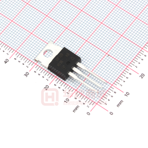

IRF520, SiHF520 Vishay Siliconix Power MOSFET PRODUCT SUMMARY VDS (V) RDS(on) (Ω) Qg (Max.) (nC) Qgs (nC) Qgd (nC) Configuration VGS = 10 V 16 4.4 7.7 Single D FEATURES 100 0.27 • • • • • • • Dynamic dV/dt Rating Repetitive Avalanche Rated 175 °C Operating Temperature Fast Switching Ease of Paralleling Simple Drive Requirements Lead (Pb)-free Available Available RoHS* COMPLIANT TO-220 DESCRIPTION Third generation Power MOSFETs from Vishay provide the designer with the best combination of fast switching, ruggedized device design, low on-resistance and cost-effectiveness. The TO-220 package is universally preferred for all commercial-industrial applications at power dissipation levels to approximately 50 W. The low thermal resistance and low package cost of the TO-220 contribute to its wide acceptance throughout the industry. G S G D S N-Channel MOSFET ORDERING INFORMATION Package Lead (Pb)-free SnPb TO-220 IRF520PbF SiHF520-E3 IRF520 SiHF520 ABSOLUTE MAXIMUM RATINGS TC = 25 °C, unless otherwise noted PARAMETER Drain-Source Voltage Gate-Source Voltage Continuous Drain Current Pulsed Drain Currenta Linear Derating Factor Single Pulse Avalanche Energyb EAS IAR EAR TC = 25 °C PD dV/dt TJ, Tstg for 10 s 6-32 or M3 screw Repetitive Avalanche Currenta Repetitive Avalanche Energya Maximum Power Dissipation Peak Diode Recovery dV/dtc Operating Junction and Storage Temperature Range Soldering Recommendations (Peak Temperature) Mounting Torque VGS at 10 V TC = 25 °C TC = 100 °C SYMBOL VDS VGS ID IDM LIMIT 100 ± 20 9.2 6.5 37 0.40 200 9.2 6.0 60 5.5 - 55 to + 175 300d 10 1.1 W/°C mJ A mJ W V/ns °C lbf · in N·m A UNIT V Notes a. Repetitive rating; pulse width limited by maximum junction temperature (see fig. 11). b. VDD = 25 V, starting TJ = 25 °C, L = 3.5 mH, RG = 25 Ω, IAS = 9.2 A (see fig. 12). c. ISD ≤ 9.2 A, dI/dt ≤ 110 A/µs, VDD ≤ VDS, TJ ≤ 175 °C. d. 1.6 mm from case. * Pb containing terminations are not RoHS compliant, exemptions may apply Document Number: 91017 S-81240-Rev. A, 16-Jun-08 www.vishay.com 1 IRF520, SiHF520 Vishay Siliconix THERMAL RESISTANCE RATINGS PARAMETER Maximum Junction-to-Ambient Case-to-Sink, Flat, Greased Surface Maximum Junction-to-Case (Drain) SYMBOL RthJA RthCS RthJC TYP. 0.50 MAX. 62 2.5 °C/W UNIT SPECIFICATIONS TJ = 25 °C, unless otherwise noted PARAMETER Static Drain-Source Breakdown Voltage VDS Temperature Coefficient Gate-Source Threshold Voltage Gate-Source Leakage Zero Gate Voltage Drain Current Drain-Source On-State Resistance Forward Transconductance Dynamic Input Capacitance Output Capacitance Reverse Transfer Capacitance Total Gate Charge Gate-Source Charge Gate-Drain Charge Turn-On Delay Time Rise Time Turn-Off Delay Time Fall Time Internal Drain Inductance Internal Source Inductance Drain-Source Body Diode Characteristics Continuous Source-Drain Diode Current Pulsed Diode Forward Currenta Body Diode Voltage Body Diode Reverse Recovery Time Body Diode Reverse Recovery Charge Forward Turn-On Time IS ISM VSD trr Qrr ton MOSFET symbol showing the integral reverse p - n junction diode D SYMBOL TEST CONDITIONS MIN. TYP. MAX. UNIT VDS ΔVDS/TJ VGS(th) IGSS IDSS RDS(on) gfs VGS = 0 V, ID = 250 µA Reference to 25 °C, ID = 1 mA VDS = VGS, ID = 250 µA VGS = ± 20 V VDS = 100 V, VGS = 0 V VDS = 80 V, VGS = 0 V, TJ = 150 °C VGS = 10 V ID = 5.5 Ab VDS = 50 V, ID = 5.5 Ab VGS = 0 V, VDS = 25 V, f = 1.0 MHz, see fig. 5 ID = 9.2 A, VDS = 80 V, see fig. 6 and 13b 100 2.0 2.7 0.13 - 4.0 ± 100 25 250 0.27 - V V/°C V nA µA Ω S Ciss Coss Crss Qg Qgs Qgd td(on) tr td(off) tf LD LS VGS = 10 V - 360 150 34 8.8 30 19 20 4.5 7.5 16 4.4 7.7 nH ns nC pF VDD = 50 V, ID = 9.2 A, RG = 18 Ω, RD = 5.2 Ω, see fig. 10b Between lead, 6 mm (0.25") from package and center of die contact D - G S - 110 0.53 9.2 A 37 1.8 260 1.3 V ns µC G S TJ = 25 °C, IS = 9.2 A, VGS = 0 Vb TJ = 25 °C, IF = 9.2 A, dI/dt = 100 A/µsb Intrinsic turn-on time is negligible (turn-on is dominated by LS and LD) Notes a. Repetitive rating; pulse width limited by maximum junction temperature (see fig. 11). b. Pulse width ≤ 300 µs; duty cycle ≤ 2 %. www.vishay.com 2 Document Number: 91017 S-81240-Rev. A, 16-Jun-08 IRF520, SiHF520 Vishay Siliconix TYPICAL CHARACTERISTICS 25 °C, unless otherwise noted ID, Drain Current (A) ID, Drain Current (A) 101 VGS 15 V 10 V 8.0 V 7.0 V 6.0 V 5.5 V 5.0 V Bottom 4.5 V Top 101 25 °C 175 °C 4.5 V 100 100 20 µs Pulse Width VDS = 50 V 4 5 6 7 8 9 10 20 µs Pulse Width TC = 25 °C 10-1 91017_01 100 101 91017_03 VDS, Drain-to-Source Voltage (V) VGS, Gate-to-Source Voltage (V) Fig. 3 - Typical Transfer Characteristics Fig. 1 - Typical Output Characteristics, TC = 25 °C RDS(on), Drain-to-Source On Resistance (Normalized) ID, Drain Current (A) 101 VGS 15 V 10 V 8.0 V 7.0 V 6.0 V 5.5 V 5.0 V Bottom 4.5 V Top 3.0 2.5 2.0 1.5 1.0 0.5 0.0 - 60 - 40 - 20 0 ID = 9.2 A VGS = 10 V 4.5 V 100 20 µs Pulse Width TC = 175 °C 10-1 91017_02 100 101 20 40 60 80 100 120 140 160 180 VDS, Drain-to-Source Voltage (V) 91017_04 TJ, Junction Temperature (°C) Fig. 2 - Typical Output Characteristics, TC = 175 °C Fig. 4 - Normalized On-Resistance vs. Temperature Document Number: 91017 S-81240-Rev. A, 16-Jun-08 www.vishay.com 3 IRF520, SiHF520 Vishay Siliconix 750 600 450 Ciss ISD, Reverse Drain Current (A) Capacitance (pF) VGS = 0 V, f = 1 MHz Ciss = Cgs + Cgd, Cds Shorted Crss = Cgd Coss = Cds + Cgd 101 175 °C 25 °C 100 300 Coss 150 Crss 0 100 101 10-1 0.5 91017_07 VGS = 0 V 0.6 0.7 0.8 0.9 1.0 1.1 1.2 91017_05 VDS, Drain-to-Source Voltage (V) VSD, Source-to-Drain Voltage (V) Fig. 5 - Typical Capacitance vs. Drain-to-Source Voltage Fig. 7 - Typical Source-Drain Diode Forward Voltage 20 VGS, Gate-to-Source Voltage (V) ID = 9.2 A VDS = 80 V 103 5 2 Operation in this area limited by RDS(on) 16 VDS = 20 V ID, Drain Current (A) VDS = 50 V 12 102 5 2 10 µs 100 µs 1 ms 10 ms TC = 25 °C TJ = 175 °C Single Pulse 2 5 10 5 2 8 1 5 4 For test circuit see figure 13 2 0 0 91017_06 4 8 12 16 20 91017_08 0.1 0.1 1 2 5 10 2 5 102 2 5 103 QG, Total Gate Charge (nC) VDS, Drain-to-Source Voltage (V) Fig. 6 - Typical Gate Charge vs. Gate-to-Source Voltage Fig. 8 - Maximum Safe Operating Area www.vishay.com 4 Document Number: 91017 S-81240-Rev. A, 16-Jun-08 IRF520, SiHF520 Vishay Siliconix RD VDS 10 RG VGS D.U.T. + - VDD ID, Drain Current (A) 8 6 10 V Pulse width ≤ 1 µs Duty factor ≤ 0.1 % 4 Fig. 10a - Switching Time Test Circuit 2 VDS 0 25 91017_09 90 % 50 75 100 125 150 175 TC, Case Temperature (°C) 10 % VGS td(on) tr td(off) tf Fig. 9 - Maximum Drain Current vs. Case Temperature Fig. 10b - Switching Time Waveforms 10 Thermal Response (ZthJC) 1 0 - 0.5 0.2 0.1 0.05 PDM t1 Single Pulse (Thermal Response) t2 Notes: 1. Duty Factor, D = t1/t2 2. Peak Tj = PDM x ZthJC + TC 10-2 0.1 1 10 0.1 0.02 0.01 10-2 10-5 91017_11 10-4 10-3 t1, Rectangular Pulse Duration (s) Fig. 11 - Maximum Effective Transient Thermal Impedance, Junction-to-Case L Vary tp to obtain required IAS RG VDS VDS tp VDD D.U.T IAS + - V DD A VDS 10 V tp 0.01 Ω IAS Fig. 12b - Unclamped Inductive Waveforms Fig. 12a - Unclamped Inductive Test Circuit Document Number: 91017 S-81240-Rev. A, 16-Jun-08 www.vishay.com 5 IRF520, SiHF520 Vishay Siliconix 600 EAS, Single Pulse Energy (mJ) 500 400 300 200 100 VDD = 25 V 0 25 50 75 100 ID 3.8 A 6.5 A Bottom 9.2 A Top 125 150 175 91017_12c Starting TJ, Junction Temperature (°C) Fig. 12c - Maximum Avalanche Energy vs. Drain Current Current regulator Same type as D.U.T. 50 kΩ 12 V 10 V QGS QG 0.2 µF 0.3 µF QGD D.U.T. + - VDS VG VGS 3 mA Charge IG ID Current sampling resistors Fig. 13a - Basic Gate Charge Waveform Fig. 13b - Gate Charge Test Circuit www.vishay.com 6 Document Number: 91017 S-81240-Rev. A, 16-Jun-08 IRF520, SiHF520 Vishay Siliconix Peak Diode Recovery dV/dt Test Circuit D.U.T. + Circuit layout considerations • Low stray inductance • Ground plane • Low leakage inductance current transformer + + - RG • • • • dV/dt controlled by RG Driver same type as D.U.T. ISD controlled by duty factor "D" D.U.T. - device under test + VDD Driver gate drive P.W. Period D= P.W. Period VGS = 10 V* D.U.T. ISD waveform Reverse recovery current Body diode forward current dI/dt D.U.T. VDS waveform Diode recovery dV/dt VDD Re-applied voltage Inductor current Body diode forward drop Ripple ≤ 5 % ISD * VGS = 5 V for logic level devices Fig. 14 - For N-Channel Vishay Siliconix maintains worldwide manufacturing capability. Products may be manufactured at one of several qualified locations. Reliability data for Silicon Technology and Package Reliability represent a composite of all qualified locations. For related documents such as package/tape drawings, part marking, and reliability data, see http://www.vishay.com/ppg?91017. Document Number: 91017 S-81240-Rev. A, 16-Jun-08 www.vishay.com 7 Legal Disclaimer Notice Vishay Disclaimer All product specifications and data are subject to change without notice. Vishay Intertechnology, Inc., its affiliates, agents, and employees, and all persons acting on its or their behalf (collectively, “Vishay”), disclaim any and all liability for any errors, inaccuracies or incompleteness contained herein or in any other disclosure relating to any product. Vishay disclaims any and all liability arising out of the use or application of any product described herein or of any information provided herein to the maximum extent permitted by law. The product specifications do not expand or otherwise modify Vishay’s terms and conditions of purchase, including but not limited to the warranty expressed therein, which apply to these products. No license, express or implied, by estoppel or otherwise, to any intellectual property rights is granted by this document or by any conduct of Vishay. The products shown herein are not designed for use in medical, life-saving, or life-sustaining applications unless otherwise expressly indicated. Customers using or selling Vishay products not expressly indicated for use in such applications do so entirely at their own risk and agree to fully indemnify Vishay for any damages arising or resulting from such use or sale. Please contact authorized Vishay personnel to obtain written terms and conditions regarding products designed for such applications. Product names and markings noted herein may be trademarks of their respective owners. Document Number: 91000 Revision: 18-Jul-08 www.vishay.com 1
