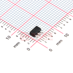

    AP7217D - 1.2V 600mA CMOS LDO - Diodes Incorporated
AP7217D 数据手册
AP7217D 1.2V 600mA CMOS LDO Features • • • • • • • • • • • Low Current Consumption: Typ. 40μA Output Voltage: 1.2V Guaranteed 600mA Output Current Dropout Voltage 850mV at 600mA Output Current Input Voltage Range: 2.5V to 5.5V Current Limit Protection Thermal shutdown Protection Stability with Low ESR Capacitors Low Temperature Coefficient SOT89-3L: Available in “Green” Molding Compound (No Br, Sb) Lead Free Finish/ RoHS Compliant (Note 1) General Description The AP7217D low-dropout linear regulator operates from 2.5V to 5.5V supply and delivers a guaranteed 600mA continuous load current. The space-saving SOT89-3L package is suitable for “pocket” and hand-held application. Applications • • • • CD and MP3 Players Cellular and PCS Phones Digital Still Camera Hand-Held Computers Ordering Information AP 7217D - 12 Y G - 13 Output voltage 12 : 1.2V Package Y : SOT89-3L Green G : Green Packing 13 : Tape & Reel Device AP7217D-12YG-13 Notes: Package Code Y Packaging (Note 2) SOT89-3L 13” Tape and Reel Quantity Part Number Suffix 2500/Tape & Reel -13 1. EU Directive 2002/95/EC (RoHS). All applicable RoHS exemptions applied. Please visit our website at http://www.diodes.com/products/lead_free.html. 2. Pad layout as shown on Diodes Inc. suggested pad layout document AP02001, which can be found on our website at http://www.diodes.com/datasheets/ap02001.pdf. AP7217D Rev. 2 1 of 9 www.diodes.com FEBRUARY 2009 © Diodes Incorporated AP7217D 1.2V 600mA CMOS LDO Pin Assignments (1) SOT89-3L ( Top View ) 3 2 1 Tab is VIN VOUT VIN GND Pin Descriptions Pin Name GND VIN VOUT Pin No. 1 2 3 Function Ground Supply Voltage Voltage Output Block Diagram AP7217D Rev. 2 2 of 9 www.diodes.com FEBRUARY 2009 © Diodes Incorporated AP7217D 1.2V 600mA CMOS LDO Absolute Maximum Ratings Symbol ESD HBM ESD MM VIN PD TMJ Notes: Parameter Human Body Model ESD Protection Machine Model ESD Protection Input Voltage Power Dissipation @ TA=25 ºC (Note 3) Maximum Junction Temperature SOT89-3L Rating 3 450 +6 578 150 Unit KV V V mW ºC 3. Maximum PD is under minimum recommended pad layout condition. Recommended Operating Conditions Symbol VIN IOUT TA TJ Parameter Input Voltage Output Current Operating Ambient Temperature Operating Junction Temperature Min 2.5 0 -40 -40 Max 5.5 600 85 125 Unit V mA ºC ºC AP7217D Rev. 2 3 of 9 www.diodes.com FEBRUARY 2009 © Diodes Incorporated AP7217D 1.2V 600mA CMOS LDO Electrical Characteristics (TA = 25°C, CIN = 1µF, COUT = 1µF, VIN=5V, unless otherwise noted) Symbol Parameter Test Conditions IQ Quiescent Current IO = 0mA VOUT Output Voltage Accuracy VOUT Temperature Coefficient Dropout Voltage Maximum Output Current Current Limit Short Circuit Current Line Regulation Load Regulation (Note 4) Power Supply Rejection Thermal Shutdown Temperature Thermal Shutdown Hysteresis θJA θJC Notes: Min 1.176 600 - Typ. 40 1.2 ±100 850 850 200 0.2 15 30 55 150 30 173 51 Max 60 1.224 1300 35 55 - Unit μA V ppm / oC mV mA mA mA %/V mV mV dB ºC ºC ºC/W ºC/W IO = 30mA -40°C to 85°C, IOUT = 30mA IOUT = 600mA, VOUT = 1.2V VDROPOUT IOUT ILIMIT ISHORT ΔVLINE ΔVLOAD PSRR 2.5V ≤ VIN ≤ 5.5V; IOUT = 30mA 1mA ≤ IOUT ≤ 300mA 1mA ≤ IOUT ≤ 600mA VIN = 4.3V+0.5Vp-pAC, F = 1KHz IOUT = 50mA - Thermal Resistance SOT89-3L (Note 5) Junction-to-Ambient Thermal Resistance SOT89-3L (Note 5) Junction-to-Case 4. Regulation is measured at constant junction temperature by low duty cycle pulse testing. 5. Test condition for SOT89-3L: Devices mounted on FR-4 substrate, single sided PC board, 2oz copper, with minimum recommended pad layout, no air flow. Typical Application AP7217D Rev. 2 4 of 9 www.diodes.com FEBRUARY 2009 © Diodes Incorporated AP7217D 1.2V 600mA CMOS LDO Typical Performance Characteristics Dropout Voltage vs. Output Current 1000 900 900 Current Limit vs. Input Voltage Dropout Voltage (mV) 700 600 500 400 300 200 100 Current Limit (mA) 800 880 860 840 820 800 780 0 100 200 300 400 500 550 600 2.5 3 3.3 4 5 5.5 Output Current (mA) Input Voltage (V) Quiescent Current vs. Input Voltage 30 29 Quiescent Current vs. Temperature 30 29 Quiescent Current (uA) Quiescent Current (uA) 28 27 26 25 24 23 22 21 20 2.5 3 3.3 4 5 5.5 28 27 26 25 24 23 22 21 20 -40 0 25 85 100 125 Input Voltage (V) Temperature (°C) AP7217D Rev. 2 5 of 9 www.diodes.com FEBRUARY 2009 © Diodes Incorporated AP7217D 1.2V 600mA CMOS LDO Typical Performance Characteristics (Continued) Short Circuit Current vs. Input Voltage 220 Load Transient Response Short Circuit Current (mA) 215 210 205 200 195 190 185 2.5 3 3.3 4 5 5.3 5.5 Input Voltage (V) AP7217D Rev. 2 6 of 9 www.diodes.com FEBRUARY 2009 © Diodes Incorporated AP7217D 1.2V 600mA CMOS LDO Application Information Input Capacitor A 1μF ceramic capacitor is recommended to connect between IN and GND pins to decouple input power supply glitch and noise. The amount of the capacitance may be increased without limit. A lower ESR (Equivalent Series Resistance) capacitor allows the use of less capacitance, while higher ESR type requires more capacitance. This input capacitor must be located as close as possible to the device to assure input stability and less noise. For PCB layout, a wide copper trace is required for both IN and GND. Output Capacitor The output capacitor is required to stabilize and help the transient response of the LDO. The AP7217D is designed to have excellent transient response for most applications with a small amount of output capacitance. The AP7217D is stable with any small ceramic output capacitors of 1.0μF or higher value, and the temperature coefficients of X7R or X5R type. Additional capacitance helps to reduce undershoot and overshoot during transient. For PCB layout, the output capacitor must be placed as close as possible to OUT and GND pins, and keep the leads as short as possible. The maximum power dissipation depends on the thermal resistance of IC package, PCB layout, the rate of surroundings airflow and temperature difference between junctions to ambient. The maximum power dissipation can be calculated by following formula: PD(MAX) = ( TJ(MAX) - TA ) / θJA Where TJ(MAX) is the maximum operation junction temperature 125°C, TA is the ambient temperature and the θJA is the junction to ambient thermal resistance. VIN IIN IN CIN GND OUT IOUT VOUT AP7217D COUT Iq ESR Current Limit Protection When output current at OUT pin is higher than current limit threshold, the current limit protection will be triggered and clamp the output current to approximately 850mA to prevent over-current and to protect the regulator from damage due to overheating. Short circuit protection When VOUT pin is shorted to GND or VOUT voltage is less than 200mV, short circuit protection will be triggered and clamp the output current to approximately 200mA. Thermal Considerations Thermal Shutdown Protection limits power dissipation in AP7217D. When the operation junction temperature exceeds 150°C, the Over Temperature Protection circuit starts the thermal shutdown function and turns the pass element off. The pass element turn on again after the junction temperature cools by 30°C. For continuous operation, do not exceed recommend maximum operation junction temperature 125°C. The power dissipation definition in device is: PD = (VIN − VOUT) x IOUT + VIN x IQ AP7217D Rev. 2 7 of 9 www.diodes.com FEBRUARY 2009 © Diodes Incorporated AP7217D 1.2V 600mA CMOS LDO Marking Information (1) SOT89-3L ( Top View ) XX YWX 1 2 3 XX : N4 : AP7217D-12 Y : Year : 0~9 W : Week : A~Z : 1~26 week; a~z : 27~52 week; z represents 52 and 53 week X : Internal code A~Z : Green Package Information (1) Package Type: SOT89-3L (All Dimensions in mm) 1.40/1.75 Typ 1.60 1.7 2.35/2.60 Typ 2.48 3.94/4.25 0.4 1.9 1.3 1.45/1.55 Typ 1.50 2.90/3.10 Typ 3.00 80 (2x) 4.40/4.60 Typ 4.50 1.40/1.60 Typ 1.50 0.80/ 1.20 1.5 0.9 Land Pattern Recommendation (Unit: mm) 50 (2x) 0.36/0.48 0.41/0.53 0.36/0.48 Typ 0.42 Typ 0.47 Typ 0.42 0.35/0.43 Typ 0.39 AP7217D Rev. 2 8 of 9 www.diodes.com 2.7 FEBRUARY 2009 © Diodes Incorporated AP7217D 1.2V 600mA CMOS LDO IMPORTANT NOTICE Diodes Incorporated and its subsidiaries reserve the right to make modifications, enhancements, improvements, corrections or other changes without further notice to any product herein. Diodes Incorporated does not assume any liability arising out of the application or use of any product described herein; neither does it convey any license under its patent rights, nor the rights of others. The user of products in such applications shall assume all risks of such use and will agree to hold Diodes Incorporated and all the companies whose products are represented on our website, harmless against all damages. LIFE SUPPORT Diodes Incorporated products are not authorized for use as critical components in life support devices or systems without the expressed written approval of the President of Diodes Incorporated. AP7217D Rev. 2 9 of 9 www.diodes.com FEBRUARY 2009 © Diodes Incorporated
