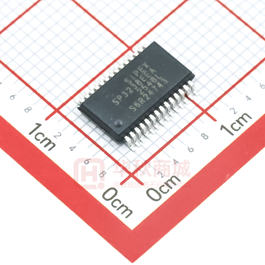

SP3238EEA-L/TR
SP3238EEA-L/TR
    SIPEX(迈凌)
    SSOP28_208MIL
    智能+3.0V至+5.5V RS-232收发器
SP3238EEA-L/TR 数据手册
SP3238E Intelligent +3.0V to +5.5V RS-232 Transceiver FEATURES ■ Meets true EIA/TIA-232-F Standards from a +3.0V to +5.5V power supply ■ Interoperable with EIA/TIA-232 and adheres to EIA/TIA-562 down to a +2.7V power source ■ AUTO ON-LINE® circuitry automatically wakes up from a 1µA shutdown ■ Minimum 250Kbps data rate under load ■ Regulated Charge Pump Yields Stable RS-232 Outputs Regardless of VCC Variations ■ Enhanced ESD Specifications: +15kV Human Body Model +15kV IEC61000-4-2 Air Discharge +8kV IEC61000-4-2 Contact Discharge C2+ 1 28 C1+ GND 2 27 V+ C2- 3 26 VCC V- 4 T1OUT 5 T2OUT 6 T3 OUT 7 25 SP3238E C1- 24 T1 IN 23 T2 IN 22 T3 IN R1IN 8 21 R1OUT R 2IN 9 20 R2OUT T4OUT 10 19 T4IN R3 IN 11 T5 OUT 12 18 17 R3 OUT T5 IN ONLINE 13 16 R1OUT 15 STATUS SHUTDOWN 14 Now Available in Lead Free Packaging DESCRIPTION The SP3238E device is an RS-232 transceiver solution intended for portable or hand-held applications such as notebook and palmtop computers. The SP3238E uses an internal high-efficiency, charge-pump power supply that requires only 0.1µF capacitors in 3.3V operation. This charge pump and Exar's driver architecture allow the SP3238E device to deliver compliant RS-232 performance from a single power supply ranging from +3.0V to +5.5V. The SP3238E is a 5-driver / 3-receiver device that is ideal for laptop / notebook computer and PDA applications. The SP3238E includes one complementary receiver that remains alert to monitor an external device's Ring Indicate signal while the device is shutdown. The AUTO ON-LINE® feature allows the device to automatically "wake-up" during a shutdown state when an RS-232 cable is connected and a connected peripheral is turned on. Otherwise, the device automatically shuts itself down drawing less than 1µA. Device Power Supplies RS-232 Drivers RS-232 Receivers External Components Auto On-Line Circuitry SELECTION TABLE TTL 3-State # of Pins SP3220E +3.0V to +5.5V 1 1 4 Capacitors No Yes 16 SP3223E +3.0V to +5.5V 2 2 4 Capacitors Yes Yes 20 SP3243E +3.0V to +5.5V 3 5 4 Capacitors Yes Yes 28 SP3238E +3.0V to +5.5V 5 3 4 Capacitors Yes Yes 28 SP3238E_101_012920 1 ABSOLUTE MAXIMUM RATINGS Power Dissipation per package These are stress ratings only and functional operation of the device at these ratings or any other above those indicated in the operation sections of the specifications below is not implied. Exposure to absolute maximum rating conditions for extended periods of time may affect reliability and cause permanent damage to the device. 28-pin SSOP (derate 11.2mW/oC above +70oC)..........900mW 28-pin TSSOP (derate 13.2mW/oC above +70oC)......1100mW VCC.......................................................-0.3V to +6.0V V+ (NOTE 1).......................................-0.3V to +7.0V V- (NOTE 1)........................................+0.3V to -7.0V V+ + |V-| (NOTE 1)...........................................+13V ICC (DC VCC or GND current).........................+100mA Input Voltages TxIN, ONLINE, SHUTDOWN, ....-0.3V to Vcc + 0.3V RxIN...................................................................+25V Output Voltages TxOUT.............................................................+13.2V RxOUT, STATUS.......................-0.3V to (VCC +0.3V) Short-Circuit Duration TxOUT....................................................Continuous Storage Temperature......................-65°C to +150°C NOTE 1: V+ and V- can have maximum magnitudes of 7V, but their absolute difference cannot exceed 13V. ELECTRICAL CHARACTERISTICS VCC = +3.0V to +5.5V, C1 - C4 = 0.1µF (tested at 3.3V +/-5%), C1 - C4 = 0.22µF (tested at 3.3V +/-10%), C1 = 0.047µF and C2 - C4 = 0.33µF (tested at 5.0V +/-10%), TAMB = TMIN to TMAX, unless otherwise noted. Typical values are at TA = 25oC PARAMETER MIN. TYP. MAX. UNITS CONDITIONS Supply Current, AUTO ONLINE® 1.0 10 µA All RxIN open, ONLINE = GND, SHUTDOWN = VCC, TxIN = GND or VCC Supply Current, Shutdown 1.0 10 µA SHUTDOWN = GND, TxIN = Vcc or GND Supply Current AUTO ON-LINE® Disabled 0.3 1.0 mA 0.8 V V DC CHARACTERISTICS ONLINE = SHUTDOWN = Vcc, no load, TxIN = GND or VCC LOGIC INPUTS AND RECEIVER OUTPUTS Input Logic Threshold LOW HIGH 2.4 VCC = +3.3V or +5.0V, TxIN ONLINE, SHUTDOWN Input Leakage Current +0.01 +1.0 µA TxIN, ONLINE, SHUTDOWN, TAMB = +25oC Output Leakage Current +0.05 +10 µA Receivers disabled 0.4 Output Voltage LOW Output Voltage HIGH V IOUT = 1.6mA VCC -0.6 VCC -0.1 V IOUT = -1.0mA +5.0 +5.4 V All driver outputs loaded with 3KΩ to GND DRIVER OUTPUTS Output Voltage Swing SP3238E_101_012920 2 ELECTRICAL CHARACTERISTICS VCC = +3.0V to +5.5V, C1 - C4 = 0.1µF (tested at 3.3V +/-5%), C1 - C4 = 0.22µF (tested at 3.3V +/-10%), C1 = 0.047µF and C2 - C4 = 0.33µF (tested at 5.0V +/-10%), TAMB = TMIN to TMAX, unless otherwise noted. Typical values are at TA = 25oC PARAMETER MIN. TYP. MAX. UNITS CONDITIONS DRIVER OUTPUTS (continued) Output Resistance 300 Output Short-Circuit Current Ω +35 +60 mA 25 V VCC = V+ = V- = 0V, VOUT=+2V VOUT = 0V RECEIVER INPUTS Input Voltage Range -25 Input Threshold LOW 0.6 1.2 V Vcc = 3.3V Input Threshold LOW 0.8 1.5 V Vcc = 5.0V Input Threshold HIGH 1.5 2.4 V Vcc = 3.3V Input Threshold HIGH 1.8 2.4 V Vcc = 5.0V 7 kΩ Input Hysteresis Input Resistance 0.5 3 5 V AUTO ON-LINE® CIRCUITRY CHARACTERISTICS (ONLINE = GND, SHUTDOWN = VCC) STATUS Output Voltage LOW STATUS Output Voltage HIGH 0.4 VCC -0.6 V IOUT = 1.6mA V IOUT = -1.0mA Receiver Threshold to Drivers Enabled (tONLINE) 200 µs Figure 10 Receiver Positive or Negative Threshold to STATUS HIGH (tSTSH) 0.5 µs Figure 10 Receiver Positive or Negative Threshold to STATUS LOW (tSTSL) 20 µs Figure 10 TIMING CHARACTERISTICS Maximum Data Rate 250 kbps RL = 3KΩ, CL = 1000pF, one driver switching Receiver Propagation Delay tPHL tPLH 0.15 0.15 µs Receiver input to Receiver output, CL = 150pF Receiver Output Enable Time 200 ns Normal operation Receiver Output Disable Time 200 ns Normal operation Driver Skew 100 ns | tPHL - tPLH |, TAMB = 25°C Receiver Skew 50 Transition-Region Slew Rate ns 30 V/µs | tPHL - tPLH | Vcc = 3.3V, RL = 3kΩ, TAMB = 25°C, measurements taken from -3.0V to +3.0V or +3.0V to -3.0V SP3238E_101_012920 3 TYPICAL PERFORMANCE CHARACTERISTICS Unless otherwise noted, the following performance characteristics apply for VCC = +3.3V, 250kbps data rate, all drivers loaded with 3kΩ, 0.1µF charge pump capacitors, and TAMB = +25°C. 25 20 V /u S 6 V o lt 4 2 15 POS. SR NE G S R 10 VOH 0 -2 0 1000 2000 3000 4000 5 VOL 5000 0 -4 0 -6 1000 2000 3000 4000 5000 pF pF Figure 2. Slew Rate VS. Load Capacitance Figure 1. Transmitter Output Voltage VS. Load Capacitance 60 50 mA 40 250K bps 30 120K bps 20K bps 20 10 0 0 1000 2000 3000 4000 5000 pF Figure 3. Supply Current VS. Load Capacitance when Transmitting Data SP3238E_101_012920 4 NAME FUNCTION C2+ Positive terminal of the symmetrical charge-pump capacitor C2. PIN NUMBER 1 GND Ground. 2 C2- Negative terminal of the symmetrical charge-pump capacitor C2. 3 V- Regulated -5.5V output generated by the charge pump. 4 T1OUT RS-232 Driver Output. 5 T2OUT RS-232 Driver Output. 6 T3OUT RS-232 Driver Output. 7 R1IN RS-232 receiver input. 8 R2IN RS-232 receiver input. 9 T4OUT RS-232 Driver Output. 10 R3IN RS-232 receiver input. 11 T5OUT RS-232 Driver Output. 12 ONLINE Apply logic HIGH to override AUTO ON-LINE® circuitry keeping drivers active (SHUTDOWN must also be logic HIGH, refer to Table 2). 13 SHUTDOWN Apply logic LOW to shut down drivers and charge pump. This overrides all AUTO ON-LINE® circuitry and ONLINE (Refer to table 2). 14 STATUS TTL/CMOS Output indicating if a RS-232 signal is present on any receiver input. 15 R1OUT Non-Inverting receiver - 1 output, active in shutdown. 16 T5IN TTL/CMOS driver input. 17 R3OUT TTL/CMOS receiver output. 18 T4IN TTL/CMOS driver input. 19 R2OUT TTL/CMOS receiver output. 20 R1OUT TTL/CMOS receiver output. 21 T3IN TTL/CMOS driver input. 22 T2IN TTL/CMOS driver input. 23 T1IN TTL/CMOS driver input. 24 C1- Negative terminal of the symmetrical charge-pump capacitor C1. 25 Vcc +3.0V to +5.5V supply voltage. 26 V+ Regulated +5.5V output generated by the charge pump. 27 C1+ Positive terminal of the symmetrical charge-pump capacitor C1. 28 Table 1. Device Pin Description SP3238E_101_012920 5 28 C1+ C2+ 1 GND 2 27 V+ C2- 3 26 VCC 25 C1- V- 4 T1OUT 5 SP3238E 24 T1 IN 23 T2 IN T2OUT 6 T3 OUT 7 22 T3 IN R1IN 8 21 R1OUT R 2IN 9 20 R2OUT T4OUT 10 19 T4IN R3 IN 11 T5 OUT 12 17 R3 OUT T5 IN ONLINE 13 16 R1OUT 18 15 STATUS SHUTDOWN 14 Figure 4. SP3238E Pinout Configuration C5 C1 C2 + + + 28 C1+ 0.1µF V+ 27 C3 25 C11 C2+ 0.1µF TTL/CMOS INPUTS VCC 26 VCC 0.1µF SP3238E V- + 0.1µF 4 C4 3 C224 T1IN T1OUT 5 23 T2IN T2OUT 6 22 T3IN T3OUT 7 19 T4IN T4OUT 10 17 T5IN T5OUT 12 R1IN 8 R2IN 9 R3IN 11 + 0.1µF RS-232 OUTPUTS 16 R1OUT 21 R1OUT TTL/CMOS OUTPUTS 5kΩ 20 R2OUT 5kΩ 18 R3OUT VCC 14 13 To µP Supervisor Circuit RS-232 INPUTS 5kΩ SHUTDOWN ONLINE 15 STATUS GND 2 Figure 5. SP3238E Typical Operating Circuit SP3238E_101_012920 6 DESCRIPTION In many portable or hand-held applications, an RS-232 cable can be disconnected or a connected peripheral can be turned off. Under these conditions, the internal charge pump and the drivers will be shut down. Otherwise, the system automatically comes online. This feature allows design engineers to address power saving concerns without major design changes. The SP3238E device meets the EIA/TIA-232 and ITU-T V.28/V.24 communication protocols and can be implemented in battery-powered, portable, or hand-held applications such as notebook or palmtop computers. The SP3238E devices feature Exar's proprietary and patented (U.S.‑‑ 5,306,954) on-board charge pump circuitry that generates ±5.5V RS-232 voltage levels from a single +3.0V to +5.5V power supply. The SP3238E devices can guarantee a data rate of 250kbps fully loaded. THEORY OF OPERATION The SP3238E device is made up of four basic circuit blocks: 1. Drivers 2. Receivers 3. The Exar proprietary charge pump, and 4. AUTO ON-LINE® circuitry. The SP3238E is a 5-driver/3-receiver device, ideal for portable or hand-held applications. The SP3238E includes one complementary always-active receiver that can monitor an external device (such as a modem) in shutdown. This aids in protecting the UART or serial controller IC by preventing forward biasing of the protection diodes where VCC may be disconnected. Drivers The drivers are inverting level transmitters that convert TTL or CMOS logic levels to 5.0V EIA/ TIA-232 levels with an inverted sense relative to the input logic levels. Typically, the RS-232 output voltage swing is +5.4V with no load and +5V minimum fully loaded. The driver outputs are protected against infinite short-circuits to ground without degradation in reliability. These drivers comply with the EIA-TIA-232-F and all previous RS-232 versions. The SP3238E device is an ideal choice for power sensitive designs. The SP3238E device features AUTO ON-LINE® circuitry which reduces the power supply drain to a 1µA supply current. The drivers can guarantee a data rate of 250kbps fully loaded with 3kΩ in parallel with 1000pF, ensuring compatibility with PC-to-PC communication software. All unused drivers inputs should be connected to GND or VCC. VCC C5 C1 C2 + + + 0.1µF VCC 28 C1+ 0.1µF 0.1µF V+ 27 C3 25 C11 C2+ RxD UART or Serial µC 26 SP3238E + 0.1µF V- 4 C4 3 C224 T1IN T1OUT 5 CTS 23 T2IN T2OUT 6 DSR 22 T3IN T3OUT 7 DCD 19 T4IN T4OUT 10 RI 17 T5IN T5OUT 12 + 0.1µF The slew rate of the driver output is internally limited to a maximum of 30V/µs in order to meet the EIA standards (EIA RS-232D 2.1.7, Paragraph 5). The transition of the loaded output from HIGH to LOW also meets the monotonicity requirements of the standard. RS-232 OUTPUTS 16 R1OUT TxD 21 R1OUT RTS 20 R2OUT DTR 18 R3OUT VCC 14 13 15 R1IN 8 5kΩ 5kΩ R2IN 9 RS-232 INPUTS Figure 7 shows a loopback test circuit used to test the RS-232 drivers. Figure 8 shows the test results of the loopback circuit with all five drivers active at 120kbps with typical RS-232 loads in parallel with 1000pF capacitors. Figure 9 shows the test results where one driver was active at 250kbps and all five drivers loaded with an RS-232 receiver in parallel with a 1000pF capacitor. A solid RS-232 data transmission rate of 120kbps provides compatibility with many designs in personal computer peripherals and LAN applications. R3IN 11 5kΩ SHUTDOWN ONLINE STATUS GND 2 RESET µP Supervisor IC VIN Figure 6. Interface Circuitry Controlled by Microprocessor Supervisory Circuit SP3238E_101_012920 7 VCC C5 C1 C2 + + + 0.1µF V+ C1C2+ 0.1µF SP3238E C4 + 0.1µF + 0.1µF The SP3238E includes an additional non-inverting receiver with an output R1OUT. R1OUT is an extra output that remains active and monitors activity while the other receiver outputs are forced into high impedance. This allows a Ring Indicator (RI) signal from a peripheral to be monitored without forward biasing the TTL/CMOS inputs of the other devices connected to the receiver outputs. TxOUT RxOUT LOGIC OUTPUTS C3 V- C2TxIN LOGIC INPUTS The receivers convert +5.0V EIA/TIA-232 levels to TTL or CMOS logic output levels. Receivers are High-Z when the AUTO ON-LINE® circuitry is enabled or when in shutdown. VCC C1+ 0.1µF Receivers RxIN 1000pF 5kΩ VCC ONLINE SHUTDOWN GND Since receiver input is usually from a transmission line where long cable lengths and system interference can degrade the signal, the inputs have a typical hysteresis margin of 300mV. This ensures that the receiver is virtually immune to noisy transmission lines. Should an input be left unconnected, an internal 5kΩ pulldown resistor to ground will commit the output of the receiver to a HIGH state. Figure 7. Loopback Test Circuit for RS-232 Driver Data Transmission Rates Charge Pump The charge pump is an Exar–patented design (U.S. 5,306,954) and uses a unique approach compared to older less–efficient designs. The charge pump still requires four external capacitors, but uses a four–phase voltage shifting technique to attain symmetrical 5.5V power supplies. The internal power supply consists of a regulated dual charge pump that provides output voltages 5.5V regardless of the input voltage (VCC) over the +3.0V to +5.5V range. This is important to maintain compliant RS-232 levels regardless of power supply fluctuations. Figure 8. Loopback Test results at 120kbps (All Drivers Fully Loaded) Figure 9. Loopback Test results at 250Kbps (All Drivers Fully Loaded) SP3238E_101_012920 8 The charge pump operates in a discontinuous mode using an internal oscillator. If the output voltages are less than a magnitude of 5.5V, the charge pump is enabled. If the output voltages exceed a magnitude of 5.5V, the charge pump is disabled. This oscillator controls the four phases of the voltage shifting. A description of each phase follows. Phase 4 — VDD transfer — The fourth phase of the clock connects the negative terminal of C2 to GND, and transfers this positive generated voltage across C2 to C4, the VDD storage capacitor. This voltage is regulated to +5.5V. At this voltage, the internal oscillator is disabled. Simultaneous with the transfer of the voltage to C4, the positive side of capacitor C1 is switched to VCC and the negative side is connected to GND, allowing the charge pump cycle to begin again. The charge pump cycle will continue as long as the operational conditions for the internal oscillator are present. Phase 1 — VSS charge storage — During this phase of the clock cycle, the positive side of capacitors C1 and C2 are initially charged to VCC. Cl+ is then switched to GND and the charge in C1– is transferred to C2–. Since C2+ is connected to VCC, the voltage potential across capacitor C2 is now 2 times VCC. Since both V+ and V– are separately generated from VCC, in a no–load condition V+ and V– will be symmetrical. Older charge pump approaches that generate V– from V+ will show a decrease in the magnitude of V– compared to V+ due to the inherent inefficiencies in the design. Phase 2 — VSS transfer — Phase two of the clock connects the negative terminal of C2 to the VSS storage capacitor and the positive terminal of C2 to GND. This transfers a negative generated voltage to C3. This generated voltage is regulated to a minimum voltage of -5.5V. Simultaneous with the transfer of the voltage to C3, the positive side of capacitor C1 is switched to VCC and the negative side is connected to GND. Phase 3 — VDD charge storage — The third phase of the clock is identical to the first phase — the charge transferred in C1 produces –VCC in the negative terminal of C1, which is applied to the negative side of capacitor C2. Since C2+ is at VCC, the voltage potential across C2 is 2 times VCC. The clock rate for the charge pump typically operates at 500kHz. The external capacitors can be as low as 0.1µF with a 16V breakdown voltage rating. Figure 10. Charge Pump Waveform SP3238E_101_012920 9 VCC = +5V C4 +5V C1 + + C2 – –5V – + – VDD Storage Capacitor – + VSS Storage Capacitor C3 –5V Figure 11. Charge Pump — Phase 1 VCC = +5V C4 + C1 C2 – + – + – – + VDD Storage Capacitor VSS Storage Capacitor C3 -5.5V Figure 12. Charge Pump — Phase 2 VCC = +5V C4 +5V C1 + – C2 –5V + – + – VDD Storage Capacitor – + VSS Storage Capacitor C3 –5V Figure 13. Charge Pump — Phase 3 VCC = +5V +5.5V C1 + – C2 C4 + – + – – + VDD Storage Capacitor VSS Storage Capacitor C3 Figure 14. Charge Pump — Phase 4 SP3238E_101_012920 10 VCC C5 C1 + + 28 0.1µF C2 0.1µF C1+ 25 C11 + 26 VCC 0.1µF 3 C2+ SP3238E V+ 27 C3 V- C2- C4 R1IN 8 R2IN 9 R3IN 11 24 T1IN T1OUT 5 23 T2IN T2OUT 6 22 T3IN T3OUT 7 19 T4IN T4OUT 10 17 T5IN T5OUT 12 5kΩ 20 R2OUT 5kΩ 18 R3OUT 0.1µF 4 16 R1OUT 21 R1OUT + + 0.1µF 5kΩ VCC 14 13 To µP Supervisor Circuit DB-9 Connector SHUTDOWN ONLINE 15 STATUS 6 7 8 9 GND 2 DB-9 Connector Pins: 1. Received Line Signal Detector 2. Received Data 3. Transmitted Data 4. Data Terminal Ready 5. Signal Ground (Common) 6. 7. 8. 9. 1 2 3 4 5 DCE Ready Request to Send Clear to Send Ring Indicator Figure 15. Circuit for the connectivity of the SP3238E with a DB-9 connector SP3238E_101_012920 11 AUTO ONLINE CIRCUITRY The SP3238E device has a patent pending AUTO ON-LINE® circuitry on board that saves power in applications such as laptop computers, palmtop (PDA) computers and other portable systems. the RS-232 cable is disconnected or the RS-232 drivers of the connected peripheral are turned off. The AUTO ON-LINE® mode can be disabled by the SHUTDOWN pin. If this pin is a logic LOW, the AUTO ON-LINE® function will not operate regardless of the logic state of the ONLINE pin. Table 3 summarizes the logic of the AUTO ONLINE® operating modes. The SP3238E device incorporates an AUTO ON-LINE® circuit that automatically enables itself when the external transmitters are enabled and the cable is connected. Conversely, the AUTO ON-LINE® circuit also disables most of the internal circuitry when the device is not being used and goes into a standby mode where the device typically draws 1µA. This function is externally controlled by the ONLINE pin. When this pin is tied to a logic LOW, the AUTO ON-LINE® function is active. Once active, the device is enabled until there is no activity on the receiver inputs. The receiver input typically sees at least +3V, which are generated from the transmitters at the other end of the cable with a +5V minimum. When the external transmitters are disabled or the cable is disconnected, the receiver inputs will be pulled down by their internal 5kΩ resistors to ground. When this occurs over a period of time, the internal transmitters will be disabled and the device goes into a shutdown or standby mode. When ONLINE is HIGH, the AUTO ON-LINE® mode is disabled. The STATUS pin outputs a logic LOW signal if the device is shutdown. This pin goes to a logic HIGH when the external transmitters are enabled and the cable is connected. When the SP3238E device is shutdown, the charge pumps are turned off. V+ charge pump output decays to VCC, the V- output decays to GND. The decay time will depend on the size of capacitors used for the charge pump. Once in shutdown, the time required to exit the shut down state and have valid V+ and V- levels is typically 200ms. For easy programming, the STATUS can be used to indicate DTR or a Ring Indicator signal. Tying ONLINE and SHUTDOWN together will bypass the AUTO ON-LINE® circuitry so this connection acts like a shutdown input pin The AUTO ON-LINE® circuit has two stages: 1) Inactive Detection 2) Accumulated Delay The first stage, shown in Figure 17, detects an inactive input. A logic HIGH is asserted on RXINACT if the cable is disconnected or the external transmitters are disabled. Otherwise, RXINACT will be at a logic LOW. This circuit is duplicated for each of the other receivers. The second stage of the AUTO ON-LINE® circuitry, shown in Figure 18, processes all the receiver's RXINACT signals with an accumulated delay that disables the device to a 1µA supply current. The STATUS pin goes to a logic LOW when the cable is disconnected, the external transmitters are disabled, or the SHUTDOWN pin is invoked. The typical accumulated delay is around 20µs. When the SP3238E drivers or internal charge pump are disabled, the supply current is reduced to 1µA. This can commonly occur in handheld or portable applications where SP3238E_101_012920 12 S H U T RECEIVER +2.7V 0V RS-232 INPUT VOLTAGES -2.7V D O W N VCC STATUS 0V tSTSL tSTSH tONLINE DRIVER RS-232 OUTPUT VOLTAGES +5V 0V -5V Figure 16. AUTO ON-LINE® Timing Waveforms Inactive Detection Block RS-232 Receiver Block RXIN RXINACT RXOUT Figure 17. Stage I of AUTO ON-LINE® Circuitry Delay Stage Delay Stage Delay Stage Delay Stage Delay Stage STATUS R1INACT R2INACT R4INACT R3INACT R5INACT SHUTDOWN Figure 18. Stage II of AUTO ON-LINE® Circuitry SP3238E_101_012920 13 SHUTDOWN INPUT ONL INE INPUT RS-232 SIGNA L A T RECEIVER INPUT STA TUS OUTPUT TXOUT RXOUT R1OUT TRA NSCEIVER STA TUS HIGH - YES HIGH Active Active Active Normal Operation HIGH HIGH NO LOW Active Active Active Normal Operation HIGH LO W NO (>100µs) LO W High-Z Active Active Shutdown (A u t o -On l i n e) LOW - YES HIGH High-Z High-Z Active Shutdown LOW - NO LOW High-Z High-Z Active Shutdown Table 2. AUTO ON-LINE® Logic SP3238E_101_012920 14 ESD TOLERANCE most of the ESD current when the ESD source is applied to the connector pins. The test circuit for IEC61000-4-2 is shown on Figure 20. There are two methods within IEC61000-4-2, the Air Discharge method and the Contact Discharge method. The SP3238E device incorporates ruggedized ESD cells on all driver output and receiver input pins. The ESD structure is improved over our previous family for more rugged applications and environments sensitive to electro-static discharges and associated transients. The improved ESD tolerance is at least +15kV without damage nor latch-up. With the Air Discharge Method, an ESD voltage is applied to the equipment under test (EUT) through air. This simulates an electrically charged person ready to connect a cable onto the rear of the system only to find an unpleasant zap just before the person touches the back panel. The high energy potential on the person discharges through an arcing path to the rear panel of the system before he or she even touches the system. This energy, whether discharged directly or through air, is predominantly a function of the discharge current rather than the discharge voltage. Variables with an air discharge such as approach speed of the object carrying the ESD potential to the system and humidity will tend to change the discharge current. For example, the rise time of the discharge current varies with the approach speed. There are different methods of ESD testing applied: a) MIL-STD-883, Method 3015.7 b) IEC61000-4-2 Air-Discharge c) IEC61000-4-2 Direct Contact The Human Body Model has been the generally accepted ESD testing method for semi-conductors. This method is also specified in MIL-STD-883, Method 3015.7 for ESD testing. The premise of this ESD test is to simulate the human body’s potential to store electro-static energy and discharge it to an integrated circuit. The simulation is performed by using a test model as shown in Figure 19. This method will test the IC’s capability to withstand an ESD transient during normal handling such as in manufacturing areas where the IC's tend to be handled frequently. The Contact Discharge Method applies the ESD current directly to the EUT. This method was devised to reduce the unpredictability of the ESD arc. The discharge current rise time is constant since the energy is directly transferred without the air-gap arc. In situations such as hand held systems, the ESD charge can be directly discharged to the equipment from a person already holding the equipment. The current is transferred on to the keypad or the serial port of the equipment directly and then travels through the PCB and finally to the IC. The IEC-61000-4-2, formerly IEC801-2, is generally used for testing ESD on equipment and systems. For system manufacturers, they must guarantee a certain amount of ESD protection since the system itself is exposed to the outside environment and human presence. The premise with IEC61000-4-2 is that the system is required to withstand an amount of static electricity when ESD is applied to points and surfaces of the equipment that are accessible to personnel during normal usage. The transceiver IC receives RS RC SW1 DC Power Source SW2 CS Device Under Test Figure 19. ESD Test Circuit for Human Body Model SP3238E_101_012920 15 Contact-Discharge Model RS RC RV SW1 SW2 Device Under Test CS DC Power Source R S and RV add up to 330Ω for IEC61000-4-2. Figure 20. ESD Test Circuit for IEC61000-4-2 I→ The circuit models in Figures 19 and 20 represent the typical ESD testing circuit used for all three methods. The CS is initially charged with the DC power supply when the first switch (SW1) is on. Now that the capacitor is charged, the second switch (SW2) is on while SW1 switches off. The voltage stored in the capacitor is then applied through RS, the current limiting resistor, onto the device under test (DUT). In ESD tests, the SW2 switch is pulsed so that the device under test receives a duration of voltage. 30A 15A 0A For the Human Body Model, the current limiting resistor (RS) and the source capacitor (CS) are 1.5kΩ an 100pF, respectively. For IEC-61000-4-2, the current limiting resistor (RS) and the source capacitor (CS) are 330Ω an 150pF, respectively. t = 0ns t→ t = 30ns Figure 21. ESD Test Waveform for IEC61000-4-2 The higher CS value and lower RS value in the IEC61000-4-2 model are more stringent than the Human Body Model. The larger storage capacitor injects a higher voltage to the test point when SW2 is switched on. The lower current limiting resistor increases the current charge onto the test point. DEVICE PIN TESTED Driver Outputs Receiver Inputs HUMAN BODY MODEL Air Discharge +15kV +15kV +15kV +15kV IEC61000-4-2 Direct Contact Level +8kV +8kV 4 4 Table 3. Transceiver ESD Tolerance Levels SP3238E_101_012920 16 ▲ ▲ PACKAGE: 28 PIN SSOP e SP3238E_101_012920 17 PACKAGE: 28 PIN TSSOP SP3238E_101_012920 18 ORDERING INFORMATION(1) Part Number Temp. Range Package Packaging Method Lead-Free(2) SP3238ECA-L/TR 0°C to +70°C 28 Pin SSOP Tape and Reel Yes SP3238EEA-L/TR -40°C to +85°C 28 Pin SSOP Tape and Reel Yes SP3238EEY-L -40°C to +85°C 28 Pin TSSOP Tube Yes SP3238EEY-L/TR -40°C to +85°C 28 Pin TSSOP Tape and Reel Yes NOTES: 1. Refer to www.maxlinear.com/SP3238E for most up to date Ordering Information. 2. Visit www.maxlinear.com for additional information on Environmental Rating. SP3238E_101_012920 19 REVISION HISTORY DATE REVISION DESCRIPTION 03/04/05 -- Legacy Sipex Datasheet 02/01/11 1.0.0 Convert to Exar Format, Update ordering information and change ESD specification to IEC61000-4-2 01/29/20 1.0.1 Update to MaxLinear logo. Update ordering information. MaxLinear, Inc. 5966 La Place Court, Suite 100 Carlsbad, CA 92008 760.692.0711 p. 760.444.8598 f. www.maxlinear.com The content of this document is furnished for informational use only, is subject to change without notice, and should not be construed as a commitment by MaxLinear, Inc. MaxLinear, Inc. assumes no responsibility or liability for any errors or inaccuracies that may appear in the informational content contained in this guide. Complying with all applicable copyright laws is the responsibility of the user. Without limiting the rights under copyright, no part of this document may be reproduced into, stored in, or introduced into a retrieval system, or transmitted in any form or by any means (electronic, mechanical, photocopying, recording, or otherwise), or for any purpose, without the express written permission of MaxLinear, Inc. Maxlinear, Inc. does not recommend the use of any of its products in life support applications where the failure or malfunction of the product can reasonably be expected to cause failure of the life support system or to significantly affect its safety or effectiveness. Products are not authorized for use in such applications unless MaxLinear, Inc. receives, in writing, assurances to its satisfaction that: (a) the risk of injury or damage has been minimized; (b) the user assumes all such risks; (c) potential liability of MaxLinear, Inc. is adequately protected under the circumstances. MaxLinear, Inc. may have patents, patent applications, trademarks, copyrights, or other intellectual property rights covering subject matter in this document. Except as expressly provided in any written license agreement from MaxLinear, Inc., the furnishing of this document does not give you any license to these patents, trademarks, copyrights, or other intellectual property. MaxLinear, the MaxLinear logo, and any MaxLinear trademarks, MxL, Full-Spectrum Capture, FSC, G.now, AirPHY and the MaxLinear logo are all on the products sold, are all trademarks of MaxLinear, Inc. or one of MaxLinear’s subsidiaries in the U.S.A. and other countries. All rights reserved. Other company trademarks and product names appearing herein are the property of their respective owners. © 2011 - 2020 MaxLinear, Inc. All rights reserved. SP3238E_101_012920 20
