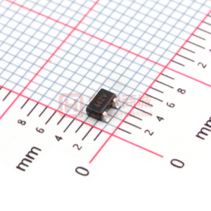

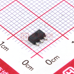

■MARKING RULE
●SOT-23 & SOT-89 ① Represents product series MARK 6
③④
3
① ②
PRODUCT SERIES XC6206Pxxxxx
1
SOT-23 (TOP VIEW)
2
② Represents three pins regulator MARK VOLTAGE: VOLTAGE: 0.1 ~ 3.0V 3.1 ~ 6.0V 5 6
③ Represents output voltage MARK OUTPUT VOLTAGE (V) 0 1 2 3 4 5 6 7 8 9 A B C D E 1.2 1.3 1.4 1.5 3.1 3.2 3.3 3.4 3.5 3.6 3.7 3.8 3.9 4.0 4.1 4.2 4.3 4.4 4.5 ② ④
MARK F H K L M N P R S T U V X Y Z
OUTPUT VOLTAGE (V) 1.6 1.7 1.8 1.9 2.0 2.1 2.2 2.3 2.4 2.5 2.6 2.7 2.8 2.9 3.0 4.6 4.7 4.8 4.9 5.0 -
①
1
2
SOT-89 (TOP VIEW)
③
3
④ Represents production lot number 0 to 9, A to Z, reversed character of 0 to 9 and A to Z repeated. (G, I, J, O, Q, W excepted) ●USP-6B ①② Represents product series MARK ① ② 0 ③ Represents three pins regulator MARK P 6 PRODUCT SERIES XC6206PxxxDx
