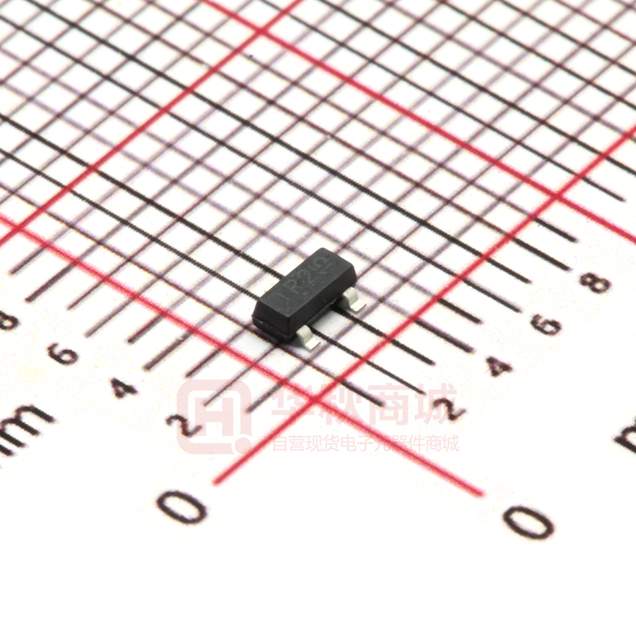

    MOS管 P-Channel VDS=-20V VGS=±10V ID=-3A SOT23
NTR4502P 数据手册
NTR4502P P-Channel Enhancement Mode MOSFET Feature -20V/-3A, RDS(ON) = 120mΩ(MAX) @VGS = -4.5V. RDS(ON) = 150mΩ(MAX) @VGS = -2.5V. Super High dense cell design for extremely low RDS(ON) Reliable and Rugged SOT-23 for Surface Mount Package SOT-23 Applications ● Power Management Portable Equipment and Battery Powered Systems. AbsoluteMaximum Ratings Drain-Source Voltage Gate-Source Voltage Drain Current-Continuous Parameter Electrical Characteristics Parameter Off Characteristics Drain to Source Breakdown Voltage TA=25℃Unless Otherwise noted Symbol VDS VGS ID TA=25℃Unless Otherwise noted Symbol Test Conditions BVDSS Limit Units -20 ±10 -3 V V A Min Typ. Max Units VGS=0V, ID=-250μA -20 - - V Zero-Gate Voltage Drain Current IDSS VDS=-20V, VGS=0V - - -1 μA Gate Body Leakage Current, Forward Gate Body Leakage Current, Reverse IGSSF IGSSR VGS=10V, VDS=0V VGS=-10V, VDS=0V - - 100 -100 nA nA VGS(th) VGS= VDS, ID=-250µA -0.4 - -1.0 V RDS(ON) VGS =-4.5V, ID =-3.0A VGS =-2.5V, ID =-2.0A - --- 120 150 mΩ mΩ -1.2 V On Characteristics Gate Threshold Voltage Static Drain-source On-Resistance Drain-Source Diode Characteristics and Maximum Ratings Drain-Source Diode Forward Voltage REV.08 VSD VGS =0V, IS=-1.25A 1 of 4 NTR4502P Typical Characteristics 12 VGS=3,3.5,4V,4.5V 14 10 12 10 8 VGS=2.5V 8 6 Tj=150℃ 6 4 4 Tj=25℃ 2 2 VGS=2.0V 0 0 0 1 2 3 4 5 0 1 -VDS,Drain-Source Voltage(V) 2 3 4 -VGS,Gate-to-Source Voltage (V) Figure 1.Output Characteristics Figure 2.Transfer Characteristics 1.3 23.2 ID=250uA 23 1.2 22.8 1.1 22.6 1 22.4 0.9 22.2 0.8 22 0 50 100 0 150 REV.08 100 Tj,Junction Temperature(℃) Tj,Junction Temperature(℃) Figure 3.Breakdown Voltage Variation with Temperature 50 Figure 4.Gate Threshold Variation with Temperature 2 of 4 150 NTR4502P Typical Characteristics 0.125 0.35 -3.0V/-2.0A 0.3 0.12 0.25 VGS=-2.5V 0.115 0.2 0.11 0.15 VGS=-4.5V 0.1 0.105 0.05 0.1 0 50 100 Tj,Junction 0 150 0 Temperature(℃) Figure 5.On-Resistance Variation with Temperature 5 10 15 -ID-Drain Current(A) 20 Figure 6.On-Resistance vs. Drain Current 0.3 100 ID=-3A 0.25 0.2 10 Tj=150℃ ID=-2A 0.15 Tj=25℃ 1 0.1 0.05 0 1 2 3 - VGS,Gate-to-Source 4 5 Voltage (V) 1 2 -VSD,Body Figure 7 . On-Resistance vs. Gate-to-Source Voltage Voltage REV.08 0.1 3 Diode 4 Forward 5 Voltage(V) Figure 8 . Source-Drain Diode Forward 3 of 4 NTR4502P Package Outline Dimensions (UNIT: mm) SOT-23 REV.08 4 of 4
