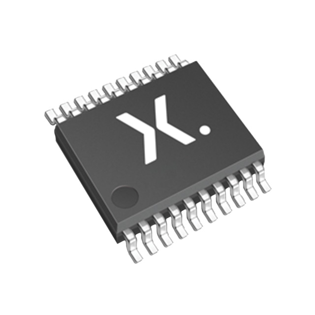

74HC374PW,118
74HC374PW,118
    NEXPERIA(安世)
    TSSOP20_6.6X4.5MM
    IC FF D-TYPE SNGL 8BIT 20TSSOP
74HC374PW,118 数据手册
74HC374; 74HCT374 Octal D-type flip-flop; positive edge-trigger; 3-state Rev. 5 — 7 September 2021 Product data sheet 1. General description The 74HC374; 74HCT374 is an octal positive-edge triggered D-type flip-flop with 3-state outputs. The device features a clock (CP) and output enable (OE) inputs. The flip-flops will store the state of their individual D-inputs that meet the set-up and hold time requirements on the LOW-to-HIGH clock (CP) transition. A HIGH on OE causes the outputs to assume a high-impedance OFF-state. Operation of the OE input does not affect the state of the flip-flops. Inputs also include clamp diodes, this enables the use of current limiting resistors to interface inputs to voltages in excess of VCC. 2. Features and benefits • • • • • • • • • • • • • Wide supply voltage range from 2.0 to 6.0 V CMOS low power dissipation High noise immunity Input levels: • For 74HC374: CMOS level • For 74HCT374: TTL level Octal bus interface Non-inverting 3-state outputs 8-bit positive, edge-triggered register Common 3-state output enable input Independent register and 3-state buffer operation Complies with JEDEC standards • JESD8C (2.7 V to 3.6 V) • JESD7A (2.0 V to 6.0 V) Latch-up performance exceeds 100 mA per JESD 78 Class II Level B ESD protection: • HBM JESD22-A114F exceeds 2000 V • MM JESD22-A115-A exceeds 200 V Specified from -40 °C to +85 °C and -40 °C to +125 °C 3. Ordering information Table 1. Ordering information Type number Package 74HC374D Temperature range Name Description Version −40 °C to +125 °C SO20 plastic small outline package; 20 leads; body width 7.5 mm SOT163-1 −40 °C to +125 °C TSSOP20 plastic thin shrink small outline package; 20 leads; body width 4.4 mm SOT360-1 74HCT374D 74HC374PW 74HCT374PW 74HC374; 74HCT374 Nexperia Octal D-type flip-flop; positive edge-trigger; 3-state 4. Functional diagram 1 EN 11 11 3 4 7 8 13 14 17 18 3 CP D0 Q0 D1 Q1 D2 Q2 D3 Q3 D4 Q4 D5 Q5 D6 Q6 D7 Q7 OE 1 Fig. 1. 2 5 D0 Q0 2 4 D1 Q1 5 7 D2 Q2 6 5 8 D3 Q3 9 13 D4 14 D5 17 D6 Q6 16 18 D7 Q7 19 6 7 6 9 8 9 12 13 12 14 15 17 16 11 CP 18 19 1 OE 15 16 19 mna891 D0 3 2 1D 4 Fig. 2. D1 Q Q Q Q D5 D CP FF3 Q4 12 Q5 15 Functional diagram D4 D CP FF2 Fig. 3. D3 D CP FF1 3-STATE OUTPUTS mna892 IEC logic symbol D2 D CP FF1 to FF8 mna196 Logic symbol D C1 Q D CP FF4 D6 Q D CP FF5 D7 Q D CP FF6 Q CP FF7 FF8 CP OE Q0 Q1 Q2 Q3 Q4 Q5 Q6 Q7 mna893 Fig. 4. Logic diagram 74HC_HCT374 Product data sheet All information provided in this document is subject to legal disclaimers. Rev. 5 — 7 September 2021 © Nexperia B.V. 2021. All rights reserved 2 / 15 74HC374; 74HCT374 Nexperia Octal D-type flip-flop; positive edge-trigger; 3-state 5. Pinning information 5.1. Pinning 74HC374 74HCT374 74HC374 74HCT374 OE 1 20 VCC OE 1 20 VCC Q0 2 19 Q7 Q0 2 19 Q7 D0 3 18 D7 D0 3 18 D7 D1 4 17 D6 D1 4 17 D6 Q1 5 16 Q6 Q1 5 16 Q6 Q2 6 15 Q5 Q2 6 15 Q5 D2 7 14 D5 D2 7 14 D5 D3 8 13 D4 D3 8 13 D4 Q3 9 12 Q4 Q3 9 12 Q4 GND 10 11 CP GND 10 11 CP aaa-028158 Fig. 5. aaa-028159 Pin configuration SOT163-1 (SO20) Fig. 6. Pin configuration SOT360-1 (TSSOP20) 5.2. Pin description Table 2. Pin description Symbol Pin Description D0, D1, D2, D3, D4, D5, D6, D7 3, 4, 7, 8, 13, 14, 17, 18 data inputs Q0, Q1, Q2, Q3, Q4, Q5, Q6, Q7 2, 5, 6, 9, 12, 15, 16, 19 data outputs OE 1 output enable input (active LOW) CP 11 clock pulse input (active rising edge) GND 10 ground (0 V) VCC 20 supply voltage 6. Functional description Table 3. Function table H = HIGH voltage level; h = HIGH voltage level one set-up time prior to the LOW-to-HIGH clock transition; L = LOW voltage level; l = LOW voltage level one set-up time prior to the LOW-to-HIGH clock transition; Z = high-impedance OFF-state; ↑ = LOW-to-HIGH clock transition. Operating mode Load and read register Load register and disable outputs 74HC_HCT374 Product data sheet Input Output OE CP Dn Internal flip-flops L ↑ l L L L ↑ h H H H ↑ l L Z H ↑ h H Z All information provided in this document is subject to legal disclaimers. Rev. 5 — 7 September 2021 Qn © Nexperia B.V. 2021. All rights reserved 3 / 15 74HC374; 74HCT374 Nexperia Octal D-type flip-flop; positive edge-trigger; 3-state 7. Limiting values Table 4. Limiting values In accordance with the Absolute Maximum Rating System (IEC 60134). Voltages are referenced to GND (ground = 0 V). Symbol Parameter Conditions Min Max Unit -0.5 +7 V VCC supply voltage IIK input clamping current VI < -0.5 V or VI > VCC + 0.5 V - ±20 mA IOK output clamping current VO < -0.5 V or VO > VCC + 0.5 V - ±20 mA IO output current -0.5 V < VO < VCC + 0.5 V - ±35 mA ICC supply current - 70 mA IGND ground current -70 - mA Tstg storage temperature -65 +150 °C Ptot total power dissipation - 500 mW [1] [1] For SOT163-1 (SO20) package: Ptot derates linearly with 12.3 mW/K above 109 °C. For SOT360-1 (TSSOP20) package: Ptot derates linearly with 10.0 mW/K above 100 °C. 8. Recommended operating conditions Table 5. Recommended operating conditions Symbol Parameter Conditions VCC supply voltage VI input voltage VO output voltage Δt/ΔV input transition rise and fall rate Tamb ambient temperature 74HC_HCT374 Product data sheet 74HC374 74HCT374 Unit Min Typ Max Min Typ Max 2.0 5.0 6.0 4.5 5.0 5.5 V 0 - VCC 0 - VCC V V 0 - VCC 0 - VCC VCC = 2.0 V - - 625 - - - ns/V VCC = 4.5 V - 1.67 139 - 1.67 139 ns/V VCC = 6.0 V - - 83 - - - ns/V -40 +25 +125 -40 +25 +125 All information provided in this document is subject to legal disclaimers. Rev. 5 — 7 September 2021 © °C Nexperia B.V. 2021. All rights reserved 4 / 15 74HC374; 74HCT374 Nexperia Octal D-type flip-flop; positive edge-trigger; 3-state 9. Static characteristics Table 6. Static characteristics At recommended operating conditions; voltages are referenced to GND (ground = 0 V). Symbol Parameter Conditions Tamb (°C) 25 Unit -40 to +85 -40 to +125 Min Typ Max Min Max Min Max VCC = 2.0 V 1.5 1.2 - 1.5 - 1.5 - V VCC = 4.5 V 3.15 2.4 - 3.15 - 3.15 - V VCC = 6.0 V 4.2 3.2 - 4.2 - 4.2 - V VCC = 2.0 V - 0.8 0.5 - 0.5 - 0.5 V VCC = 4.5 V - 2.1 1.35 - 1.35 - 1.35 V VCC = 6.0 V - 2.8 1.8 - 1.8 - 1.8 V IO = -20 μA; VCC = 2.0 V 1.9 2.0 - 1.9 - 1.9 - V IO = -20 μA; VCC = 4.5 V 4.4 4.5 - 4.4 - 4.4 - V 74HC374 VIH VIL VOH VOL HIGH-level input voltage LOW-level input voltage HIGH-level output voltage LOW-level output voltage VI = VIH or VIL IO = -20 μA; VCC = 6.0 V 5.9 6.0 - 5.9 - 5.9 - V IO = -6.0 mA; VCC = 4.5 V 3.98 4.32 - 3.84 - 3.7 - V IO = -7.8 mA; VCC = 6.0 V 5.48 5.81 - 5.34 - 5.2 - V IO = 20 μA; VCC = 2.0 V - 0 0.1 - 0.1 - 0.1 V IO = 20 μA; VCC = 4.5 V - 0 0.1 - 0.1 - 0.1 V IO = 20 μA; VCC = 6.0 V - 0 0.1 - 0.1 - 0.1 V IO = 6.0 mA; VCC = 4.5 V - 0.15 0.26 - 0.33 - 0.4 V IO = 7.8 mA; VCC = 6.0 V - 0.16 0.26 - 0.33 - 0.4 V VI = VIH or VIL II input leakage current VI = VCC or GND; VCC = 6.0 V - - ±0.1 - ±1.0 - ±1.0 μA IOZ OFF-state output current VI = VIH or VIL; VCC = 6.0 V; VO = VCC or GND - - ±0.5 - ±5.0 - ±10 μA ICC supply current VI = VCC or GND; IO = 0 A; VCC = 6.0 V - - 8.0 - 80 - 160 μA CI input capacitance - 3.5 - - - - - pF 74HC_HCT374 Product data sheet All information provided in this document is subject to legal disclaimers. Rev. 5 — 7 September 2021 © Nexperia B.V. 2021. All rights reserved 5 / 15 74HC374; 74HCT374 Nexperia Octal D-type flip-flop; positive edge-trigger; 3-state Symbol Parameter Conditions Tamb (°C) 25 Unit -40 to +85 -40 to +125 Min Typ Max Min Max Min Max 74HCT374 VIH HIGH-level input voltage VCC = 4.5 V to 5.5 V 2.0 1.6 - 2.0 - 2.0 - V VIL LOW-level input voltage VCC = 4.5 V to 5.5 V - 1.2 0.8 - 0.8 - 0.8 V VOH HIGH-level output voltage VI = VIH or VIL; VCC = 4.5 V IO = -20 μA 4.4 4.5 - 4.4 - 4.4 - V IO = -6 mA 3.98 4.32 - 3.84 - 3.7 - V VOL LOW-level output voltage VI = VIH or VIL; VCC = 4.5 V IO = 20 μA - 0 0.1 - 0.1 - 0.1 V IO = 6.0 mA - 0.16 0.26 - 0.33 - 0.4 V II input leakage current VI = VCC or GND; VCC = 5.5 V - - ±0.1 - ±1.0 - ±1.0 μA IOZ OFF-state output current VI = VIH or VIL; VCC = 5.5 V; VO = VCC or GND - - ±0.5 - ±5.0 - ±10 μA ICC supply current VI = VCC or GND; VCC = 5.5 V; IO = 0 A - - 8.0 - 80 - 160 μA ΔICC additional supply current per input pin; VI = VCC - 2.1 V; other inputs at VCC or GND; VCC = 4.5 V to 5.5 V; IO = 0 A OE input - 125 450 - 563 - 613 μA CP input - 90 324 - 405 - 441 μA Dn inputs - 35 126 - 158 - 172 μA - 3.5 - - - - - pF CI input capacitance 74HC_HCT374 Product data sheet All information provided in this document is subject to legal disclaimers. Rev. 5 — 7 September 2021 © Nexperia B.V. 2021. All rights reserved 6 / 15 74HC374; 74HCT374 Nexperia Octal D-type flip-flop; positive edge-trigger; 3-state 10. Dynamic characteristics Table 7. Dynamic characteristics Voltages are referenced to GND (ground = 0 V); for test circuit see Fig. 9. Symbol Parameter Conditions Tamb (°C) 25 Unit -40 to +85 -40 to +125 Min Typ Max Min Max Min Max VCC = 2.0 V - 50 165 - 205 - 250 ns VCC = 4.5 V - 18 33 - 41 - 50 ns VCC = 5.0 V; CL = 15 pF - 15 - - - - - ns - 14 28 - 35 - 43 ns VCC = 2.0 V - 41 150 - 190 - 225 ns VCC = 4.5 V - 15 30 - 38 - 45 ns VCC = 6.0 V - 12 26 - 33 - 38 ns VCC = 2.0 V - 50 150 - 190 - 225 ns VCC = 4.5 V - 18 30 - 38 - 45 ns VCC = 6.0 V - 14 26 - 33 - 38 ns VCC = 2.0 V - 14 60 - 75 - 90 ns VCC = 4.5 V - 5 12 - 15 - 18 ns VCC = 6.0 V - 4 10 - 13 - 15 ns VCC = 2.0 V 80 19 - 100 - 120 - ns VCC = 4.5 V 16 7 - 20 - 24 - ns VCC = 6.0 V 14 6 - 17 - 20 - ns VCC = 2.0 V 60 14 - 75 - 90 - ns VCC = 4.5 V 12 5 - 15 - 18 - ns VCC = 6.0 V 10 4 - 13 - 15 - ns VCC = 2.0 V 5 -6 - 5 - 5 - ns VCC = 4.5 V 5 -2 - 5 - 5 - ns VCC = 6.0 V 5 -2 - 5 - 5 - ns VCC = 2.0 V 6.0 23 - 4.8 - 4.0 - MHz VCC = 4.5 V 30 70 - 24 - 20 - MHz - 77 - - - - - MHz 35 83 - 28 - 24 - MHz - 17 - - - pF 74HC374 tpd propagation delay CP to Qn; see Fig. 7 [1] VCC = 6.0 V ten tdis tt tW tsu th fmax enable time disable time OE to Qn; see Fig. 8 [2] OE to Qn; see Fig. 8 [3] transition time Qn; see Fig. 7 pulse width set-up time hold time maximum frequency [4] CP; HIGH or LOW; see Fig. 7 Dn to CP; see Fig. 7 Dn to CP; see Fig. 7 CP; see Fig. 7 VCC = 5 V; CL= 15 pF VCC = 6.0 V CPD power dissipation capacitance 74HC_HCT374 Product data sheet per flip-flop; VI = GND to VCC [5] All information provided in this document is subject to legal disclaimers. Rev. 5 — 7 September 2021 © Nexperia B.V. 2021. All rights reserved 7 / 15 74HC374; 74HCT374 Nexperia Octal D-type flip-flop; positive edge-trigger; 3-state Symbol Parameter Conditions Tamb (°C) 25 Unit -40 to +85 -40 to +125 Min Typ Max Min Max Min Max VCC = 4.5 V - 16 32 - 40 - 48 ns VCC = 5.0 V; CL = 15 pF - 13 - - - - - ns 74HCT374 tpd propagation delay CP to Qn; see Fig. 7 [1] ten enable time OE to Qn; VCC = 4.5 V; see Fig. 8 [2] - 16 30 - 38 - 45 ns tdis disable time OE to Qn; VCC = 4.5 V; see Fig. 8 [3] - 18 28 - 35 - 42 ns tt transition time Qn; VCC = 4.5 V; see Fig. 7 [4] - 5 12 - 15 - 18 ns tW pulse width CP; HIGH or LOW; VCC = 4.5 V; see Fig. 7 19 11 - 24 - 29 - ns tsu set-up time Dn to CP; VCC = 4.5 V; see Fig. 7 12 7 - 15 - 18 - ns th hold time Dn to CP; VCC = 4.5 V; see Fig. 7 5 -3 - 5 - 5 - ns fmax maximum frequency CP; VCC = 4.5 V; see Fig. 7 26 44 - 21 - 17 - MHz - 48 - - - - - MHz power dissipation capacitance per flip-flop; VI = GND to VCC - 1.5 V - 17 - - - pF CPD [1] [2] [3] [4] [5] CP; VCC = 5 V; CL= 15 pF [5] tpd is the same as tPHL and tPLH. ten is the same as tPZH and tPZL. tdis is the same as tPHZ and tPLZ. tt is the same as tTHL and tTLH. CPD is used to determine the dynamic power dissipation (PD in μW): 2 2 PD = CPD × VCC × fi × N + ∑ (CL × VCC × fo) where: fi = input frequency in MHz; fo = output frequency in MHz; CL = output load capacitance in pF; VCC = supply voltage in V; N = number of inputs switching; 2 ∑ (CL × VCC × fo) = sum of outputs. 74HC_HCT374 Product data sheet All information provided in this document is subject to legal disclaimers. Rev. 5 — 7 September 2021 © Nexperia B.V. 2021. All rights reserved 8 / 15 74HC374; 74HCT374 Nexperia Octal D-type flip-flop; positive edge-trigger; 3-state 10.1. Waveforms and test circuit VI VM Dn input GND th th tsu 1/fmax VI CP input tsu VM GND tW tPHL VOH tPLH 90 % 90 % VM Qn output 10 % VOL 10 % tTHL tTLH aaa-028160 Measurement points are given in Table 8. The shaded areas indicate when the input is permitted to change for predictable output performance. VOL and VOH are typical voltage output levels that occur with the output load. Fig. 7. Clock input (CP) to output (Qn) propagation delay, clock pulse width, data (Dn) to clock (CP) set-up and hold times, output transition times (Qn) and maximum clock frequency VI OE input VM GND tPLZ output LOW-to-OFF OFF-to-LOW tPZL VCC VM VX VOL tPHZ VOH output HIGH-to-OFF OFF-to-HIGH tPZH VY VM GND outputs enabled outputs enabled outputs disabled mna644 Measurement points are given in Table 8. VOL and VOH are typical voltage output levels that occur with the output load. Fig. 8. 3-state enable and disable times Table 8. Measurement points Type Input Output VI VM VM VX VY 74HC374 GND to VCC 0.5 x VCC 0.5 x VCC 0.1 x VCC 0.9 x VCC 74HCT374 GND to 3 V 1.3 V 1.3 V 0.1 x VCC 0.9 x VCC 74HC_HCT374 Product data sheet All information provided in this document is subject to legal disclaimers. Rev. 5 — 7 September 2021 © Nexperia B.V. 2021. All rights reserved 9 / 15 74HC374; 74HCT374 Nexperia Octal D-type flip-flop; positive edge-trigger; 3-state VI negative pulse tW 90 % VM 0V VI positive pulse 0V VM 10 % tf tr tr tf 90 % VM VM 10 % tW VCC G VI DUT VCC VO RT RL S1 open CL 001aad983 Test data is given in Table 9. Definitions: RT = Termination resistance should be equal to output impedance Zo of the pulse generator CL = Load capacitance including jig and probe capacitance RL = Load resistance. S1 = Test selection switch Fig. 9. Test circuit for measuring switching times Table 9. Test data Type Input VI Load tr, tf S1 position CL RL tPHL, tPLH tPZH, tPHZ tPZL, tPLZ 74HC374 GND to VCC 6 ns 15 pF, 50 pF 1 kΩ open GND VCC 74HCT374 GND to 3 V 15 pF, 50 pF 1 kΩ open GND VCC 74HC_HCT374 Product data sheet 6 ns All information provided in this document is subject to legal disclaimers. Rev. 5 — 7 September 2021 © Nexperia B.V. 2021. All rights reserved 10 / 15 74HC374; 74HCT374 Nexperia Octal D-type flip-flop; positive edge-trigger; 3-state 11. Package outline SO20: plastic small outline package; 20 leads; body width 7.5 mm SOT163-1 D E A X c y HE v M A Z 20 11 Q A2 A (A 3 ) A1 pin 1 index θ Lp L 1 10 e bp detail X w M 0 5 10 mm scale DIMENSIONS (inch dimensions are derived from the original mm dimensions) UNIT A max. A1 A2 A3 bp c D (1) E (1) e HE L Lp Q v w y mm 2.65 0.3 0.1 2.45 2.25 0.25 0.49 0.36 0.32 0.23 13.0 12.6 7.6 7.4 1.27 10.65 10.00 1.4 1.1 0.4 1.1 1.0 0.25 0.25 0.1 0.9 0.4 inches 0.1 0.012 0.096 0.004 0.089 0.01 0.019 0.013 0.014 0.009 0.51 0.49 0.30 0.29 0.05 0.419 0.043 0.055 0.394 0.016 0.043 0.039 0.01 0.01 0.004 0.035 0.016 Z (1) θ o 8 o 0 Note 1. Plastic or metal protrusions of 0.15 mm (0.006 inch) maximum per side are not included. REFERENCES OUTLINE VERSION IEC JEDEC SOT163-1 075E04 MS-013 JEITA EUROPEAN PROJECTION ISSUE DATE 99-12-27 03-02-19 Fig. 10. Package outline SOT163-1 (SO20) 74HC_HCT374 Product data sheet All information provided in this document is subject to legal disclaimers. Rev. 5 — 7 September 2021 © Nexperia B.V. 2021. All rights reserved 11 / 15 74HC374; 74HCT374 Nexperia Octal D-type flip-flop; positive edge-trigger; 3-state TSSOP20: plastic thin shrink small outline package; 20 leads; body width 4.4 mm D SOT360-1 E A X c HE y v M A Z 11 20 Q A2 pin 1 index (A 3 ) A1 A θ Lp 1 L 10 detail X w M bp e 0 2.5 5 mm scale DIMENSIONS (mm are the original dimensions) UNIT A max. A1 A2 A3 bp c D (1) E (2) e HE L Lp Q v w y Z (1) θ mm 1.1 0.15 0.05 0.95 0.80 0.25 0.30 0.19 0.2 0.1 6.6 6.4 4.5 4.3 0.65 6.6 6.2 1 0.75 0.50 0.4 0.3 0.2 0.13 0.1 0.5 0.2 8o 0o Notes 1. Plastic or metal protrusions of 0.15 mm maximum per side are not included. 2. Plastic interlead protrusions of 0.25 mm maximum per side are not included. OUTLINE VERSION SOT360-1 REFERENCES IEC JEDEC JEITA EUROPEAN PROJECTION ISSUE DATE 99-12-27 03-02-19 MO-153 Fig. 11. Package outline SOT360-1 (TSSOP20) 74HC_HCT374 Product data sheet All information provided in this document is subject to legal disclaimers. Rev. 5 — 7 September 2021 © Nexperia B.V. 2021. All rights reserved 12 / 15 74HC374; 74HCT374 Nexperia Octal D-type flip-flop; positive edge-trigger; 3-state 12. Abbreviations Table 10. Abbreviations Acronym Description CMOS Complementary Metal-Oxide Semiconductor DUT Device Under Test ESD ElectroStatic Discharge HBM Human Body Model MM Machine Model TTL Transistor-Transistor Logic 13. Revision history Table 11. Revision history Document ID Release date Data sheet status Change notice Supersedes 74HC_HCT374 v.5 20210907 Product data sheet - 74HC_HCT374 v.4 Modifications: • 74HC_HCT374 v.4 20210302 Modifications: • • 74HC_HCT374 v.3 20180220 Modifications: • • 74HC_HCT374 v.2 74HC_HCT374 Product data sheet Types 74HC374 and 74HCT374 (SOT339-1/SSOP20) removed Product data sheet - 74HC_HCT374 v.3 Section 2 updated. Section 7: Derating values for Ptot total power dissipation updated. Product data sheet - 74HC_HCT374 v.2 The format of this data sheet has been redesigned to comply with the identity guidelines of Nexperia. Legal texts have been adapted to the new company name where appropriate. 19901201 Product specification - All information provided in this document is subject to legal disclaimers. Rev. 5 — 7 September 2021 - © Nexperia B.V. 2021. All rights reserved 13 / 15 74HC374; 74HCT374 Nexperia Octal D-type flip-flop; positive edge-trigger; 3-state 14. Legal information injury, death or severe property or environmental damage. Nexperia and its suppliers accept no liability for inclusion and/or use of Nexperia products in such equipment or applications and therefore such inclusion and/or use is at the customer’s own risk. Data sheet status Quick reference data — The Quick reference data is an extract of the product data given in the Limiting values and Characteristics sections of this document, and as such is not complete, exhaustive or legally binding. Document status [1][2] Product status [3] Definition Objective [short] data sheet Development This document contains data from the objective specification for product development. Preliminary [short] data sheet Qualification This document contains data from the preliminary specification. Product [short] data sheet Production This document contains the product specification. [1] [2] [3] Please consult the most recently issued document before initiating or completing a design. The term 'short data sheet' is explained in section "Definitions". The product status of device(s) described in this document may have changed since this document was published and may differ in case of multiple devices. The latest product status information is available on the internet at https://www.nexperia.com. Definitions Draft — The document is a draft version only. The content is still under internal review and subject to formal approval, which may result in modifications or additions. Nexperia does not give any representations or warranties as to the accuracy or completeness of information included herein and shall have no liability for the consequences of use of such information. Short data sheet — A short data sheet is an extract from a full data sheet with the same product type number(s) and title. A short data sheet is intended for quick reference only and should not be relied upon to contain detailed and full information. For detailed and full information see the relevant full data sheet, which is available on request via the local Nexperia sales office. In case of any inconsistency or conflict with the short data sheet, the full data sheet shall prevail. Product specification — The information and data provided in a Product data sheet shall define the specification of the product as agreed between Nexperia and its customer, unless Nexperia and customer have explicitly agreed otherwise in writing. In no event however, shall an agreement be valid in which the Nexperia product is deemed to offer functions and qualities beyond those described in the Product data sheet. Disclaimers Limited warranty and liability — Information in this document is believed to be accurate and reliable. However, Nexperia does not give any representations or warranties, expressed or implied, as to the accuracy or completeness of such information and shall have no liability for the consequences of use of such information. Nexperia takes no responsibility for the content in this document if provided by an information source outside of Nexperia. In no event shall Nexperia be liable for any indirect, incidental, punitive, special or consequential damages (including - without limitation - lost profits, lost savings, business interruption, costs related to the removal or replacement of any products or rework charges) whether or not such damages are based on tort (including negligence), warranty, breach of contract or any other legal theory. Notwithstanding any damages that customer might incur for any reason whatsoever, Nexperia’s aggregate and cumulative liability towards customer for the products described herein shall be limited in accordance with the Terms and conditions of commercial sale of Nexperia. Right to make changes — Nexperia reserves the right to make changes to information published in this document, including without limitation specifications and product descriptions, at any time and without notice. This document supersedes and replaces all information supplied prior to the publication hereof. Suitability for use — Nexperia products are not designed, authorized or warranted to be suitable for use in life support, life-critical or safety-critical systems or equipment, nor in applications where failure or malfunction of an Nexperia product can reasonably be expected to result in personal 74HC_HCT374 Product data sheet Applications — Applications that are described herein for any of these products are for illustrative purposes only. Nexperia makes no representation or warranty that such applications will be suitable for the specified use without further testing or modification. Customers are responsible for the design and operation of their applications and products using Nexperia products, and Nexperia accepts no liability for any assistance with applications or customer product design. It is customer’s sole responsibility to determine whether the Nexperia product is suitable and fit for the customer’s applications and products planned, as well as for the planned application and use of customer’s third party customer(s). Customers should provide appropriate design and operating safeguards to minimize the risks associated with their applications and products. Nexperia does not accept any liability related to any default, damage, costs or problem which is based on any weakness or default in the customer’s applications or products, or the application or use by customer’s third party customer(s). Customer is responsible for doing all necessary testing for the customer’s applications and products using Nexperia products in order to avoid a default of the applications and the products or of the application or use by customer’s third party customer(s). Nexperia does not accept any liability in this respect. Limiting values — Stress above one or more limiting values (as defined in the Absolute Maximum Ratings System of IEC 60134) will cause permanent damage to the device. Limiting values are stress ratings only and (proper) operation of the device at these or any other conditions above those given in the Recommended operating conditions section (if present) or the Characteristics sections of this document is not warranted. Constant or repeated exposure to limiting values will permanently and irreversibly affect the quality and reliability of the device. Terms and conditions of commercial sale — Nexperia products are sold subject to the general terms and conditions of commercial sale, as published at http://www.nexperia.com/profile/terms, unless otherwise agreed in a valid written individual agreement. In case an individual agreement is concluded only the terms and conditions of the respective agreement shall apply. Nexperia hereby expressly objects to applying the customer’s general terms and conditions with regard to the purchase of Nexperia products by customer. No offer to sell or license — Nothing in this document may be interpreted or construed as an offer to sell products that is open for acceptance or the grant, conveyance or implication of any license under any copyrights, patents or other industrial or intellectual property rights. Export control — This document as well as the item(s) described herein may be subject to export control regulations. Export might require a prior authorization from competent authorities. Non-automotive qualified products — Unless this data sheet expressly states that this specific Nexperia product is automotive qualified, the product is not suitable for automotive use. It is neither qualified nor tested in accordance with automotive testing or application requirements. Nexperia accepts no liability for inclusion and/or use of non-automotive qualified products in automotive equipment or applications. In the event that customer uses the product for design-in and use in automotive applications to automotive specifications and standards, customer (a) shall use the product without Nexperia’s warranty of the product for such automotive applications, use and specifications, and (b) whenever customer uses the product for automotive applications beyond Nexperia’s specifications such use shall be solely at customer’s own risk, and (c) customer fully indemnifies Nexperia for any liability, damages or failed product claims resulting from customer design and use of the product for automotive applications beyond Nexperia’s standard warranty and Nexperia’s product specifications. Translations — A non-English (translated) version of a document is for reference only. The English version shall prevail in case of any discrepancy between the translated and English versions. Trademarks Notice: All referenced brands, product names, service names and trademarks are the property of their respective owners. All information provided in this document is subject to legal disclaimers. Rev. 5 — 7 September 2021 © Nexperia B.V. 2021. All rights reserved 14 / 15 74HC374; 74HCT374 Nexperia Octal D-type flip-flop; positive edge-trigger; 3-state Contents 1. General description...................................................... 1 2. Features and benefits.................................................. 1 3. Ordering information....................................................1 4. Functional diagram.......................................................2 5. Pinning information......................................................3 5.1. Pinning.........................................................................3 5.2. Pin description............................................................. 3 6. Functional description................................................. 3 7. Limiting values............................................................. 4 8. Recommended operating conditions..........................4 9. Static characteristics....................................................5 10. Dynamic characteristics............................................ 7 10.1. Waveforms and test circuit........................................ 9 11. Package outline........................................................ 11 12. Abbreviations............................................................ 13 13. Revision history........................................................13 14. Legal information......................................................14 © Nexperia B.V. 2021. All rights reserved For more information, please visit: http://www.nexperia.com For sales office addresses, please send an email to: salesaddresses@nexperia.com Date of release: 7 September 2021 74HC_HCT374 Product data sheet All information provided in this document is subject to legal disclaimers. Rev. 5 — 7 September 2021 © Nexperia B.V. 2021. All rights reserved 15 / 15
