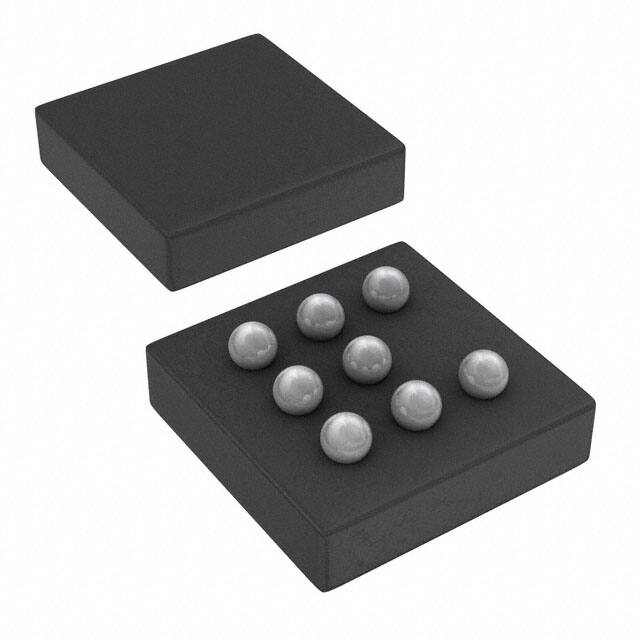

    DRV8601 具有 1.8V 输入逻辑阈值的 400mA 全差动电机驱动器
DRV8601ZQVR 数据手册
Product Folder Sample & Buy Support & Community Tools & Software Technical Documents DRV8601 SLOS629D – JULY 2010 – REVISED OCTOBER 2016 DRV8601 Haptic Driver for DC Motors (ERMs) and Linear Vibrators (LRAs) With Ultra-Fast Turnon 1 Features 3 Description • • The DRV8601 is a single-supply haptic driver that is optimized to drive a DC motor (also known as Eccentric Rotating Mass or ERM in haptics terminology) or a linear vibrator (also known as Linear Resonant Actuator or LRA in haptics terminology) using a single-ended PWM input signal. With a fast turn-on time of 100 µs, the DRV8601 is an excellent haptic driver for use in mobile phones and other portable electronic devices. 1 • • • • • • • High Current Output: 400 mA Wide Supply Voltage Range (2.5 V to 5.5 V) for Direct Battery Operation Low Quiescent Current: 1.7 mA (Typical) Fast Startup Time: 100 µs Low Shutdown Current: 10 nA Output Short-Circuit Protection Thermal Protection Enable Pin is 1.8-V Compatible Available in a 3-mm x 3-mm VQFN Package (DRB) and 2-mm x 2-mm MicroStar Junior™ PBGA Package (ZQV) The DRV8601 drives up to 400 mA from a 3.3-V supply. Near rail-to-rail output swing under load ensures sufficient voltage drive for most DC motors. Differential output drive allows the polarity of the voltage across the output to be reversed quickly, thereby enabling motor speed control in both clockwise and counter-clockwise directions, allowing quick motor stopping. A wide input voltage range allows precise speed control of both DC motors and linear vibrators. 2 Applications • • • • • Mobile Phones Tablets Portable Gaming Consoles Portable Navigation Devices Appliance Consoles With a typical quiescent current of 1.7 mA and a shutdown current of 10 nA, the DRV8601 is ideal for portable applications. The DRV8601 has thermal and output short-circuit protection to prevent the device from being damaged during fault conditions. Device Information(1) PART NUMBER DRV8601 PACKAGE BODY SIZE (NOM) DRB (8) 3.00 mm × 3.00 mm ZQV (8) 2.00 mm × 2.00 mm (1) For all available packages, see the orderable addendum at the end of the datasheet. spacer Block Diagram Application Processor OUTC IN1 REFOUT PWM2 IN2 OUT+ GPIO EN VDD M LRA or ERM 2.5 V ± 5.5 V C(VDD) GND DRV8601 Copyright © 2016, Texas Instruments Incorporated 1 An IMPORTANT NOTICE at the end of this data sheet addresses availability, warranty, changes, use in safety-critical applications, intellectual property matters and other important disclaimers. PRODUCTION DATA. DRV8601 SLOS629D – JULY 2010 – REVISED OCTOBER 2016 www.ti.com Table of Contents 1 2 3 4 5 6 7 Features .................................................................. Applications ........................................................... Description ............................................................. Revision History..................................................... Pin Configuration and Functions ......................... Specifications......................................................... 1 1 1 2 3 4 6.1 6.2 6.3 6.4 6.5 6.6 6.7 4 4 4 4 5 5 5 Absolute Maximum Ratings ...................................... ESD Ratings ............................................................ Recommended Operating Conditions....................... Thermal Information ................................................. Electrical Characteristics........................................... Operating Characteristics.......................................... Typical Characteristics .............................................. Detailed Description .............................................. 8 7.1 Overview ................................................................... 8 7.2 Functional Block Diagram ......................................... 8 7.3 Feature Description................................................... 8 7.4 Device Functional Modes.......................................... 9 8 Application and Implementation ........................ 10 8.1 Application Information............................................ 10 8.2 Typical Applications ............................................... 11 9 Power Supply Recommendations...................... 15 10 Layout................................................................... 16 10.1 Layout Guidelines ................................................. 16 10.2 Layout Example .................................................... 16 11 Device and Documentation Support ................. 17 11.1 11.2 11.3 11.4 11.5 Receiving Notification of Documentation Updates Community Resources.......................................... Trademarks ........................................................... Electrostatic Discharge Caution ............................ Glossary ................................................................ 17 17 17 17 17 12 Mechanical, Packaging, and Orderable Information ........................................................... 17 4 Revision History NOTE: Page numbers for previous revisions may differ from page numbers in the current version. Changes from Revision C (January 2016) to Revision D Page • Added the ZQV package to the Features list and the Device Information table .................................................................... 1 • Added the ZQV pinout to the Pin Configuration and Functions section................................................................................. 3 • Added ZQV values to the Thermal Information table ............................................................................................................. 4 • Added Figure 20 .................................................................................................................................................................. 16 Changes from Revision B (January 2012) to Revision C • Added ESD Rating table, Feature Description section, Device Functional Modes section, Application and Implementation section, Power Supply Recommendations section, Layout section, Device and Documentation Support section, and Mechanical, Packaging, and Orderable Information section ............................................................... 1 Changes from Revision A (May 2011) to Revision B • Page Page Changed RI value from 49.9 kΩ to 100 kΩ in Conditions statement in Typical Characteristics............................................. 5 Changes from Original (July 2010) to Revision A Page • Added the DRB package to the Features list ......................................................................................................................... 1 • Updated Application Information section .............................................................................................................................. 11 • Added polarity to motor in application diagrams in Figure 16, Figure 17, and Figure 18 .................................................... 11 2 Submit Documentation Feedback Copyright © 2010–2016, Texas Instruments Incorporated Product Folder Links: DRV8601 DRV8601 www.ti.com SLOS629D – JULY 2010 – REVISED OCTOBER 2016 5 Pin Configuration and Functions DRB Package 8-Pin VQFN Top View EN 1 REFOUT 2 IN2 3 ZQV Package 8-Ball Top View 8 OUT– Thermal Pad IN1 4 7 GND A OUT- B EN GND OUT+ C REFOUT IN2 IN1 1 2 3 VDD 6 VDD 5 OUT+ Pin Functions PIN TYPE (1) DESCRIPTION DRB NO. ZQV NO. EN 1 B1 I Chip enable GND 7 B2 P Ground IN1 4 C3 I Input to driver IN2 3 C2 I Input to driver OUT+ 5 B3 O Positive output OUT– 8 A1 O Negative output REFOUT 2 C1 O Reference voltage output VDD 6 A3 P Supply voltage NAME (1) I = Input, O = Output, P = Power Submit Documentation Feedback Copyright © 2010–2016, Texas Instruments Incorporated Product Folder Links: DRV8601 3 DRV8601 SLOS629D – JULY 2010 – REVISED OCTOBER 2016 www.ti.com 6 Specifications 6.1 Absolute Maximum Ratings over operating free-air temperature range, TA ≤ 25°C (unless otherwise noted) (1) MIN MAX UNIT VDD Supply voltage –0.3 6 V VI Input voltage, INx, EN –0.3 VDD + 0.3 V Output continuous total power dissipation See Thermal Information TA Operating free-air temperature –40 85 °C TJ Operating junction temperature –40 150 °C Tstg Storage temperature –65 150 °C (1) Stresses beyond those listed under Absolute Maximum Ratings may cause permanent damage to the device. These are stress ratings only, which do not imply functional operation of the device at these or any other conditions beyond those indicated under Recommended Operating Conditions. Exposure to absolute-maximum-rated conditions for extended periods may affect device reliability. 6.2 ESD Ratings VALUE Electrostatic discharge V(ESD) (1) (2) Human-body model (HBM), per ANSI/ESDA/JEDEC JS-001 (1) ±4000 Charged-device model (CDM), per JEDEC specification JESD22-C101 (2) ±1500 UNIT V JEDEC document JEP155 states that 500-V HBM allows safe manufacturing with a standard ESD control process. JEDEC document JEP157 states that 250-V CDM allows safe manufacturing with a standard ESD control process. 6.3 Recommended Operating Conditions MIN VDD Supply voltage VIH High-level input voltage EN VIL Low-level input voltage EN TA Operating free-air temperature –40 ZL Load impedance 6.4 NOM 2.5 MAX UNIT 5.5 V 1.15 V 0.5 V 85 °C Ω 6.4 Thermal Information DRV8601 THERMAL METRIC (1) DRB ZQV 8 PINS 8 BALLS UNIT 52.8 78 °C/W RθJA Junction-to-ambient thermal resistance RθJC(top) Junction-to-case (top) thermal resistance 63 155 °C/W RθJB Junction-to-board thermal resistance 28.4 65 °C/W ψJT Junction-to-top characterization parameter 2.7 5 °C/W ψJB Junction-to-board characterization parameter 28.6 50 °C/W RθJC(bot) Junction-to-case (bottom) thermal resistance 11.4 n/a °C/W (1) 4 For more information about traditional and new thermal metrics, see the Semiconductor and IC Package Thermal Metrics application report. Submit Documentation Feedback Copyright © 2010–2016, Texas Instruments Incorporated Product Folder Links: DRV8601 DRV8601 www.ti.com SLOS629D – JULY 2010 – REVISED OCTOBER 2016 6.5 Electrical Characteristics at TA = 25°C, Gain = 2 V/V, RL= 10 Ω (unless otherwise noted) PARAMETER TEST CONDITIONS |VOO| Output offset voltage (measured differentially) VI = 0 V, VDD = 2.5 V to 5.5 V VOD,N Negative differential output voltage (VOUT+–VOUT–) VIN+ = VDD, VIN– = 0 V or VIN+ = 0 V, VIN– = VDD MIN TYP MAX 9 VDD = 5.0 V, Io = 400 mA –4.55 VDD = 3.3 V, Io = 300 mA –2.87 VDD = 2.5 V, Io = 200 mA –2.15 VDD = 5.0 V, Io = 400 mA 4.55 VDD = 3.3 V, Io = 300 mA 2.87 VDD = 2.5 V, Io = 200 mA 2.15 UNIT mV V VOD,P Positive differential output voltage (VOUT+–VOUT–) VIN+ = VDD, VIN– = 0 V or VIN+ = 0 V, VIN– = VDD |IIH| High-level EN input current VDD = 5.5 V, VI = 5.8 V 1.2 |IIL| Low-level EN input current VDD = 5.5 V, VI = –0.3 V 1.2 μA IDD(Q) Supply current VDD = 2.5 V to 5.5 V, No load, EN = VIH 1.7 2 mA EN = VIL, VDD = 2.5 V to 5.5 V, No load 0.01 0.9 μA IDD(SD) Supply current in shutdown mode V μA 6.6 Operating Characteristics at TA = 25°C, Gain = 2 V/V, RL = 10 Ω (unless otherwise noted) PARAMETER ZI Input impedance ZO Output impedance TEST CONDITIONS MIN TYP MAX 2 Shutdown mode (EN = VIL) UNIT MΩ >10 kΩ 6.7 Typical Characteristics Table 1. Table of Graphs FIGURE Output voltage (High) vs Load current Figure 1 Output voltage (Low) vs Load current Figure 2 Output voltage vs Input voltage, RL = 10 Ω Figure 3 Output voltage vs Input voltage, RL = 20 Ω Figure 4 Supply current vs Supply voltage Figure 5 Shutdown supply current vs Supply voltage Figure 6 Power dissipation vs Supply voltage Figure 7 Slew rate vs Supply voltage Output transition vs Time Figure 9, Figure 10 Startup vs Time Figure 11 Shutdown vs Time Figure 12 Figure 8 Submit Documentation Feedback Copyright © 2010–2016, Texas Instruments Incorporated Product Folder Links: DRV8601 5 DRV8601 SLOS629D – JULY 2010 – REVISED OCTOBER 2016 www.ti.com 0 5 −1 4 −2 VOUT+ − VOUT− VOUT+ − VOUT− 6 3 2 VDD = 2.5 V VDD = 3.3 V VDD = 5 V 0 −500m −5 −6 −400m −300m −200m −100m 0 0 200m 300m 400m 500m IOUT − Load Current − A Figure 1. Output Voltage (High) vs Load Current Figure 2. Output Voltage (Low) vs Load Current 5 VDD = 2.5 V VDD = 3.3 V VDD = 5 V 4 3 VDD = 2.5 V VDD = 3.3 V VDD = 5 V 4 3 2 VOUT+ − VOUT− 2 VOUT+ − VOUT− 100m IOUT − Load Current − A 5 1 0 −1 1 0 −1 −2 −2 −3 −3 −4 −4 RL = 10 Ω −5 RL = 20 Ω −5 0 1 2 3 4 5 0 2 3 4 5 VIN − Input Voltage − V Figure 3. Output Voltage vs Input Voltage Figure 4. Output Voltage vs Input Voltage IDD − Shutdown Supply Current − A 10n 2m 1m 0 2.0 1 VIN − Input Voltage − V 3m IDD − Supply Current − A −3 −4 1 6 VDD = 2.5 V VDD = 3.3 V VDD = 5 V 2.5 3.0 3.5 4.0 4.5 5.0 5.5 6.0 8n 6n 4n 2n 0 2.0 2.5 3.0 3.5 4.0 4.5 5.0 5.5 6.0 VDD − Supply Voltage − V VDD − Supply Voltage − V Figure 5. Supply Current vs Supply Voltage Figure 6. Shutdown Supply Current vs Supply Voltage Submit Documentation Feedback Copyright © 2010–2016, Texas Instruments Incorporated Product Folder Links: DRV8601 DRV8601 www.ti.com SLOS629D – JULY 2010 – REVISED OCTOBER 2016 300m 2.0 RL = 20 Ω Differential Measurement RL = 20Ω RL = 10Ω 1.5 200m Slew Rate − V/µs PDISS − Power Disspation− W 250m 150m 100m 1.0 0.5 50m Saturated VOUT+ − VOUT− 0 2.0 2.5 3.0 3.5 4.0 4.5 5.0 5.5 0.0 2.0 6.0 2.5 3.0 3.5 4.0 4.5 5.0 5.5 VDD − Supply Voltage − V VDD − Supply Voltage − V Figure 7. Power Dissipation vs Supply Voltage Figure 8. Slew Rate vs Supply Voltage 4.0 6.0 RL = 20 Ω VDD = 3.3 V OUT+ OUT− 6.0 RL = 20 Ω VDD = 5.0 V OUT+ OUT− VOUT − Output Voltage − V VOUT − Output Voltage − V 5.0 3.0 2.0 1.0 4.0 3.0 2.0 1.0 0.0 0.0 0 1u 2u 3u 4u 5u 6u t − Time − s 7u 8u 9u 10u 0 Figure 9. Output Transition vs Time 3u 4u 5u 6u t − Time − s 7u 8u 9u 10u RL = 20 Ω VDD = 3.3 V CR = 0.001 µF EN OUT− 4.0 3.0 Voltage − V 3.0 Voltage − V 2u Figure 10. Output Transition vs Time EN OUT− 4.0 1u 2.0 1.0 RL = 20 Ω VDD = 3.3 V CR = 0.001 µF 0.0 2.0 1.0 0.0 0 100u 200u 300u t − Time − s 400u 500u 0 Figure 11. Startup vs Time 100u 200u 300u t − Time − s 400u 500u Figure 12. Shutdown vs Time Submit Documentation Feedback Copyright © 2010–2016, Texas Instruments Incorporated Product Folder Links: DRV8601 7 DRV8601 SLOS629D – JULY 2010 – REVISED OCTOBER 2016 www.ti.com 7 Detailed Description 7.1 Overview DRV8601 is a single-supply haptic driver that is optimized to drive ERM or LRAs. DRV8601 can drive in both clockwise and counter-clockwise directions, as well as stop the motor quickly. This is possible due to the fact that outputs are driven differentially and are capable of driving or sinking current. DRV8601 also eliminates long vibration tails which are undesirable in haptic feedback systems. The DRV8601 can accept a single-ended PWM source or single-ended DC control voltage and perform singleended to differential conversion. A PWM signal is typically generated using software, and many different advanced haptic sensations can be produced by inputting different types of PWM signals into the DRV8601. 7.2 Functional Block Diagram Application Processor OUTC IN1 REFOUT PWM2 IN2 OUT+ GPIO EN VDD M LRA or ERM 2.5 V ± 5.5 V C(VDD) GND DRV8601 Copyright © 2016, Texas Instruments Incorporated 7.3 Feature Description 7.3.1 Support for ERM and LRA Actuators Linear vibrators (also known as Linear Resonant Actuators or LRA in haptics terminology) vibrate only at their resonant frequency. Usually, linear vibrators have a high-Q frequency response, due to which there is a rapid drop in vibration performance at offsets of 3 to 5 Hz from the resonant frequency. Therefore, while driving a linear vibrator with the DRV8601, ensure that the commutation of the input PWM signal is within the prescribed frequency range for the chosen linear vibrator. Vary the duty cycle of the PWM signal symmetrically above and below 50% to vary the strength of the vibration. As in the case of DC motors, the PWM signal is typically generated using software, and many different advanced haptic sensations can be produced by applying different PWM signals into the DRV8601. Duty Cycle = 25% Duty Cycle = 75% VPWM 0V 1/fRESONANCE VOUT, Average Figure 13. LRA Example for 1/2 Full-Scale Drive The DRV8601 is designed to drive a DC motor (also known as Eccentric Rotating Mass or ERM in haptics terminology) in both clockwise and counter-clockwise directions, as well as to stop the motor quickly. This is made possible because the outputs are fully differential and capable of sourcing and sinking current. This feature helps eliminate long vibration tails which are undesirable in haptic feedback systems. 8 Submit Documentation Feedback Copyright © 2010–2016, Texas Instruments Incorporated Product Folder Links: DRV8601 DRV8601 www.ti.com SLOS629D – JULY 2010 – REVISED OCTOBER 2016 Feature Description (continued) Copyright © 2016, Texas Instruments Incorporated Figure 14. Reversal of Direction of Motor Spin Using DRV8601 Another common approach to driving DC motors is the concept of overdrive voltage. To overcome the inertia of the mass of the motor, they are often overdriven for a short amount of time before returning to the rated voltage of the motor in order to sustain the rotation of the motor. The DRV8601 can overdrive a motor up to the VDD voltage. Overdrive is also used to stop (or brake) a motor quickly. The DRV8601 can brake up to a voltage of –VDD. For safe and reliable overdrive voltage and duration, refer to the data sheet of the motor. 7.3.2 Internal Reference The internal voltage divider at the REFOUT pin of this device sets a mid-supply voltage for internal references and sets the output common mode voltage to VDD/2. Adding a capacitor to this pin filters any noise into this pin and increases the PSRR. REFOUT also determines the rise time of VO+ and VO when the device is taken out of shutdown. The larger the capacitor, the slower the rise time. Although the output rise time depends on the bypass capacitor value. 7.3.3 Shutdown Mode DRV8601 has a shutdown mode which is controlled using the EN pin. EN pin is 1.8-V compatible. By pulling EN pin low, the device enters low power state, consuming only 10 nA of shutdown current. 7.4 Device Functional Modes DRV8601 is an analog input with differential output. DRV8601 does not require any digital interface to set up the device. DRV8601 can be configured in various modes by configuring the device in differential or single ended mode as described in Application and Implementation. Submit Documentation Feedback Copyright © 2010–2016, Texas Instruments Incorporated Product Folder Links: DRV8601 9 DRV8601 SLOS629D – JULY 2010 – REVISED OCTOBER 2016 www.ti.com 8 Application and Implementation NOTE Information in the following applications sections is not part of the TI component specification, and TI does not warrant its accuracy or completeness. TI’s customers are responsible for determining suitability of components for their purposes. Customers should validate and test their design implementation to confirm system functionality. 8.1 Application Information The DRV8601 is intended to be used for haptic applications in a portable product that already has an application processor with analog output interface. As DRV8601 accepts PWM input, it can be directly hooked up to the processor GPIO and can drive PWM outputs. 2.5 V ± 5.5 V VDD OUT+ IN1 + M ± OUT± IN2 REFOUT LRA or ERM Bias Circuitry GND EN Copyright © 2016, Texas Instruments Incorporated Figure 15. Typical Application Block Diagram DRV8601 can be operated in different instances as listed in Typical Applications which facilitates in the design process for system engineers. 10 Submit Documentation Feedback Copyright © 2010–2016, Texas Instruments Incorporated Product Folder Links: DRV8601 DRV8601 www.ti.com SLOS629D – JULY 2010 – REVISED OCTOBER 2016 8.2 Typical Applications 8.2.1 Pseudo-Differential Feedback with Internal Reference Same Voltage as PWM I/O Supply CR REFOUT VDD IN2 Shutdown Control SE PWM EN RI OUTDRV8601 + – IN1 LRA or DC Motor OUT+ GND RF CF Copyright © 2016, Texas Instruments Incorporated Figure 16. Pseudo-Differential Feedback with Internal Reference Submit Documentation Feedback Copyright © 2010–2016, Texas Instruments Incorporated Product Folder Links: DRV8601 11 DRV8601 SLOS629D – JULY 2010 – REVISED OCTOBER 2016 www.ti.com Typical Applications (continued) 8.2.1.1 Design Requirements The parameters are located in Table 2. Table 2. Design Parameters PARAMETER EXAMPLE Power supply 2.5 V – 5.5 V Host processor Actuator type PWM output GPIO control LRA or ERMs 8.2.1.2 Detailed Design Procedure In the pseudo-differential feedback configuration (Figure 16), feedback is taken from only one of the output pins, thereby reducing the number of external components required for the solution. The DRV8601 has an internal reference voltage generator which keeps the REFOUT voltage at VDD/2. The internal reference voltage can be used if and only if the PWM voltage is the same as the supply voltage of the DRV8601 (if VPWM = VDD, as assumed in this section). Having VPWM= VDD ensures that there is no voltage signal applied to the motor at a PWM duty cycle of 50%. This is a convenient way of temporarily stopping the motor without powering off the DRV8601. Also, this configuration ensures that the direction of rotation of the motor changes when crossing a PWM duty cycle of 50% in both directions. For example, if an ERM motor rotates in the clockwise direction at 20% duty cycle, it will rotate in the counter-clockwise direction at 80% duty cycle at nearly the same speed. Mathematically, the output voltage is given by Equation 1: Vdd ö RF 1 æ VO,DIFF = 2 ´ ç VIN ÷ ´ R ´ 1 + sR C 2 è ø I F F where • • sRFCF is the Laplace Transform variable VIN is the single-ended input voltage (1) RF is normally set equal to RI (RF = RI) so that an overdrive voltage of VDD is achieved when the PWM duty cycle is set to 100%. The optional feedback capacitor, CF, forms a low-pass filter together with the feedback resistor RF, and therefore, the output differential voltage is a function of the average value of the input PWM signal. When driving a motor, design the cutoff frequency of the low-pass filter to be sufficiently lower than the PWM frequency in order to eliminate the PWM frequency and its harmonics from entering the motor. This is desirable when driving motors which do not sufficiently reject the PWM frequency by themselves. When driving a linear vibrator in this configuration, if the feedback capacitor CF is used, care must be taken to make sure that the lowpass cutoff frequency is higher than the resonant frequency of the linear vibrator. When driving motors which can sufficiently reject the PWM frequency by themselves, the feedback capacitor may be eliminated. For this example, the output voltage is given by Equation 2: Vdd ö RF æ VO,DIFF = 2 ´ ç VIN ÷ ´ R 2 è ø I (2) where the only difference from Equation 1 is that the filtering action of the capacitor is not present. Table 3. Component Design Table 12 COMPONENT VALUE CR 10 nF / 6.3 V RI 50 K / 0.01% RF 50 K / 0.01% CF 0.01 μF / 6.3 V Submit Documentation Feedback Copyright © 2010–2016, Texas Instruments Incorporated Product Folder Links: DRV8601 DRV8601 www.ti.com SLOS629D – JULY 2010 – REVISED OCTOBER 2016 8.2.1.3 Application Curves Table 4 lists the application curves for this application and following applications from Typical Characteristics. Table 4. Table of Graphs FIGURE Output voltage (High) vs Load current Figure 1 Output voltage (Low) vs Load current Figure 2 Output voltage vs Input voltage, RL = 10 Ω Figure 3 Output voltage vs Input voltage, RL = 20 Ω Figure 4 Supply current vs Supply voltage Figure 5 Shutdown supply current vs Supply voltage Figure 6 Power dissipation vs Supply voltage Figure 7 Slew rate vs Supply voltage Output transition vs Time Figure 9, Figure 10 Startup vs Time Figure 11 Shutdown vs Time Figure 12 Figure 8 8.2.2 Pseudo-Differential Feedback with Level-Shifter VDD CR VDD REFOUT 2kΩ Shutdown Control RI IN2 EN OUTDRV8601 LRA or DC Motor OUT+ IN1 SE PWM – + 10kΩ GND 47kΩ RF CF Copyright © 2016, Texas Instruments Incorporated Figure 17. Pseudo-Differential Feedback with Level-Shifter 8.2.2.1 Design Requirements The parameters are located in Table 5. Table 5. Design Parameters PARAMETER EXAMPLE Power supply 2.5 V – 5.5 V Host processor Actuator type PWM output GPIO control LRA or ERMs Submit Documentation Feedback Copyright © 2010–2016, Texas Instruments Incorporated Product Folder Links: DRV8601 13 DRV8601 SLOS629D – JULY 2010 – REVISED OCTOBER 2016 www.ti.com 8.2.2.2 Detailed Design Procedure This configuration is desirable when a regulated supply voltage for the DRV8601 (VDD) is availble, but that voltage is different than the PWM input voltage (VPWM). A single NPN transistor can be used as a low-cost level shifting solution. This ensures that VIN = VDD even when VPWM ≠ VDD. A regulated supply for the DRV8601 is still recommended in this scenario. If the supply voltage varies, the PWM level shifter output will follow, and this will, in turn, cause a change in vibration strength. However, if the variance is acceptable, the DRV8601 will still operate properly when connected directly to a battery, for example. A 50% duty cycle will still translate to zero vibration strength across the life cycle of the battery. RF is normally set equal to RI (RF = RI) so that an overdrive voltage of VDD is achieved when the PWM duty cycle is set to 100%. Table 6. Component Design Table COMPONENT VALUE CR 10 nF / 6.3 V RI 50 K / 0.01% RF 50 K / 0.01% CF 0.01 μF / 6.3 V 8.2.3 Differential Feedback With External Reference C R*Gain 2.5 V – 5.5 V 2*R CR REFOUT 2*R VDD IN2 Shutdown Control EN OUT- + DRV8601 – R IN1 SE PWM LRA or DC Motor OUT+ GND R*Gain C Copyright © 2016, Texas Instruments Incorporated Figure 18. Differential Feedback with External Reference 8.2.3.1 Design Requirements The parameters are located in Table 7. Table 7. Design Parameters PARAMETER EXAMPLE Power supply 2.5 V – 5.5 V Host processor 14 PWM output GPIO control Gain 1 Actuator type LRA or ERMs Submit Documentation Feedback Copyright © 2010–2016, Texas Instruments Incorporated Product Folder Links: DRV8601 DRV8601 www.ti.com SLOS629D – JULY 2010 – REVISED OCTOBER 2016 8.2.3.2 Detailed Design Procedure This configuration is useful for connecting the DRV8601 to an unregulated power supply, most commonly a battery. The gain can then be independently set so that the required motor overdrive voltage can be achieved even when VPWM < VDD. This is often the case when VPWM = 1.8 V, and the desired overdrive voltage is 3.0 V or above. Note that VDD must be greater than or equal to the desired overdrive voltage. A resistor divider can be used to create a VPWM/2 reference for the DRV8601. If the shutdown control voltage is driven by a GPIO in the same supply domain as VPWM, it can be used to supply the resistor divider as in Figure 18 so that no current is drawn by the divider in shutdown. In this configuration, feedback is taken from both output pins. The output voltage is given by Equation 3: R VPWM ö 1 æ ´ F ´ VO,DIFF = ç VIN ÷ 2 ø RI 1 + sRFCF è where • • sRFCF is the Laplace Transform variable VIN is the single-ended input voltage (3) Note that this differs from Equation 1 for the pseudo-differential configuration by a factor of 2 because of differential feedback. The optional feedback capacitor CF forms a low-pass filter together with the feedback resistor RF, and therefore, the output differential voltage is a function of the average value of the input PWM signal VIN. When driving a motor, design the cutoff frequency of the low-pass filter to be sufficiently lower than the PWM frequency in order to eliminate the PWM frequency and its harmonics from entering the motor. This is desirable when driving motors which do not sufficiently reject the PWM frequency by themselves. When driving a linear vibrator in this configuration, if the feedback capacitor CF is used, care must be taken to make sure that the low-pass cutoff frequency is higher than the resonant frequency of the linear vibrator. When driving motors which can sufficiently reject the PWM frequency by themselves, the feedback capacitor may be eliminated. For this example, the output voltage is given by Equation 4: RF VPWM ö æ VO,DIFF = ç VIN ÷ ´ R 2 è ø I (4) Where the only difference from Equation 3 is that the filtering action of the capacitor is not present. 8.2.3.2.1 Selecting Components 8.2.3.2.1.1 Resistors RI and RF Choose RF and RI in the range of 20 kΩ to 100 kΩ for stable operation. 8.2.3.2.1.2 Capacitor CR This capacitor filters any noise on the reference voltage generated by the DRV8601 on the REFOUT pin, thereby increasing noise immunity. However, a high value of capacitance results in a large turn-on time. A typical value of 1 nF is recommended for a fast turn-on time. All capacitors should be X5R dielectric or better. Table 8. Component Design Table COMPONENT VALUE CR 10 nF / 6.3 V RI 50 K / 0.01% RF 50 K / 0.01% CF 0.01 μF / 6.3 V 9 Power Supply Recommendations The DRV8601 device is designed to operate from an input-voltage supply range between 2.5 to 5.5 V. The decoupling capacitor for the power supply should be placed closed to the device pin. Submit Documentation Feedback Copyright © 2010–2016, Texas Instruments Incorporated Product Folder Links: DRV8601 15 DRV8601 SLOS629D – JULY 2010 – REVISED OCTOBER 2016 www.ti.com 10 Layout 10.1 Layout Guidelines Use the following guidelines for the DRV8601 layout: • The decoupling capacitor for the power supply (VDD) should be placed closed to the device pin. • The REFOUT capacitor should be placed close to the device REFOUT pin. 10.2 Layout Example Figure 19 shows a typical example of the layout for DRV8601. It is important that the power supply decoupling caps and the REFOUT external capacitance be connected as close to the device as possible. Ground Via Figure 19. Typical Layout Example A1 A3 Solder Paste Diameter: 0.28 mm B1 B2 B3 Solder Mask Diameter: 0.25 mm C1 C2 C3 Copper Trace Width: 0.38 mm Figure 20. ZQV Land Pattern 16 Submit Documentation Feedback Copyright © 2010–2016, Texas Instruments Incorporated Product Folder Links: DRV8601 DRV8601 www.ti.com SLOS629D – JULY 2010 – REVISED OCTOBER 2016 11 Device and Documentation Support 11.1 Receiving Notification of Documentation Updates To receive notification of documentation updates, navigate to the device product folder on ti.com. In the upper right corner, click on Alert me to register and receive a weekly digest of any product information that has changed. For change details, review the revision history included in any revised document. 11.2 Community Resources The following links connect to TI community resources. Linked contents are provided "AS IS" by the respective contributors. They do not constitute TI specifications and do not necessarily reflect TI's views; see TI's Terms of Use. TI E2E™ Online Community TI's Engineer-to-Engineer (E2E) Community. Created to foster collaboration among engineers. At e2e.ti.com, you can ask questions, share knowledge, explore ideas and help solve problems with fellow engineers. Design Support TI's Design Support Quickly find helpful E2E forums along with design support tools and contact information for technical support. 11.3 Trademarks MicroStar Junior, E2E are trademarks of Texas Instruments. All other trademarks are the property of their respective owners. 11.4 Electrostatic Discharge Caution These devices have limited built-in ESD protection. The leads should be shorted together or the device placed in conductive foam during storage or handling to prevent electrostatic damage to the MOS gates. 11.5 Glossary SLYZ022 — TI Glossary. This glossary lists and explains terms, acronyms, and definitions. 12 Mechanical, Packaging, and Orderable Information The following pages include mechanical, packaging, and orderable information. This information is the most current data available for the designated devices. This data is subject to change without notice and revision of this document. For browser-based versions of this data sheet, refer to the left-hand navigation. Submit Documentation Feedback Copyright © 2010–2016, Texas Instruments Incorporated Product Folder Links: DRV8601 17 PACKAGE OPTION ADDENDUM www.ti.com 26-May-2021 PACKAGING INFORMATION Orderable Device Status (1) Package Type Package Pins Package Drawing Qty Eco Plan (2) Lead finish/ Ball material MSL Peak Temp Op Temp (°C) Device Marking (3) (4/5) (6) DRV8601DRBR ACTIVE SON DRB 8 3000 RoHS & Green NIPDAU Level-2-260C-1 YEAR -40 to 85 8601 DRV8601DRBT ACTIVE SON DRB 8 250 RoHS & Green NIPDAU Level-2-260C-1 YEAR -40 to 85 8601 DRV8601NMBR ACTIVE NFBGA NMB 8 2500 RoHS & Green SNAGCU Level-2-260C-1 YEAR -40 to 85 HSMI (1) The marketing status values are defined as follows: ACTIVE: Product device recommended for new designs. LIFEBUY: TI has announced that the device will be discontinued, and a lifetime-buy period is in effect. NRND: Not recommended for new designs. Device is in production to support existing customers, but TI does not recommend using this part in a new design. PREVIEW: Device has been announced but is not in production. Samples may or may not be available. OBSOLETE: TI has discontinued the production of the device. (2) RoHS: TI defines "RoHS" to mean semiconductor products that are compliant with the current EU RoHS requirements for all 10 RoHS substances, including the requirement that RoHS substance do not exceed 0.1% by weight in homogeneous materials. Where designed to be soldered at high temperatures, "RoHS" products are suitable for use in specified lead-free processes. TI may reference these types of products as "Pb-Free". RoHS Exempt: TI defines "RoHS Exempt" to mean products that contain lead but are compliant with EU RoHS pursuant to a specific EU RoHS exemption. Green: TI defines "Green" to mean the content of Chlorine (Cl) and Bromine (Br) based flame retardants meet JS709B low halogen requirements of
