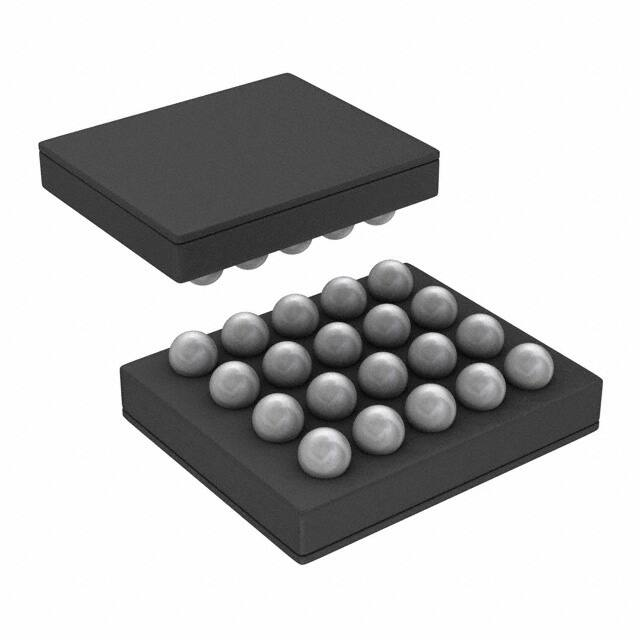

Sample & Buy Product Folder Technical Documents Support & Community Tools & Software LP5521 SNVS441I – JANUARY 2007 – REVISED NOVEMBER 2016 LP5521 Three-Channel RGB, White-LED Driver With Internal Program Memory and Integrated Charge Pump 1 Features 3 Description • The LP5521 is a three-channel LED driver designed to produce variety of lighting effects for mobile devices. A high-efficiency charge pump enables LED driving over full Li-Ion battery voltage range. The device has a program memory for creating variety of lighting sequences. When program memory has been loaded, LP5521 can operate autonomously without processor control allowing power savings. Adaptive Charge Pump With 1× and 1.5× Gain Provides Up to 95% LED Drive Efficiency Charge Pump with Soft Start and Overcurrent, Short-Circuit Protection Low Input Ripple and EMI Very Small Solution Size, No Inductor or Resistors Required 200-nA Typical Shutdown Current Automatic Power Save Mode I2C-Compatible Interface Independently Programmable Constant Current Outputs with 8-Bit Current Setting and 8-Bit PWM Control Typical LED Output Saturation Voltage 50 mV and Current Matching 1% Three Program Execution Engines with Flexible Instruction Set Autonomous Operation Without External Control Large SRAM Program Memory Two General Purpose Digital Outputs 1 • • • • • • • • • • • • 2 Applications • • • • • • • • Fun and Indicator Lights LCD Sub-Display Backlighting Keypad RGB Backlighting and Phone Cosmetics Vibra, Speakers, Waveform Generator Blood Glucose Meter Handheld POS Terminals Electronic Access Control Where RGB Indication is Needed The device maintains excellent efficiency over a wide operating range by automatically selecting proper charge pump gain based on LED forward voltage requirements and is able to automatically enter power-save mode, when LED outputs are not active and thus lowering current consumption. Three independent LED channels have accurate programmable current sources and PWM control. Each channel has program memory for creating desired lighting sequences with PWM control. The LP5521 has a flexible digital interface. Trigger I/O and a 32-kHz clock input allow synchronization between multiple devices. Interrupt output can be used to notify processor, when LED sequence has ended. The LP5521 has four pin selectable I2Ccompatible addresses. This allows connecting up to four parallel devices in one I2C-compatible bus. GPO and INT pins can be used as a digital control pin for other devices. The LP5521 requires only four small, low-cost ceramic capacitors. Comprehensive application tools are available, including command compiler for easy LED sequence programming. Device Information(1) PART NUMBER Typical Application Circuit CFLY1 CFLY2 0.47 µF CFLY1P + CIN 1 µF 0.47 µF CFLY1N CFLY2P VDD CFLY2N VOUT - EN BODY SIZE LP5521TM DSBGA (20) 2.093 mm × 1.733 mm (MAX) LP5521YQ WQFN (24) 5.00 mm × 4.00 mm (NOM) (1) For all available packages, see the orderable addendum at the end of the data sheet. RGB LED 0...25.5 mA/LED SCL SDA MCU COUT 1 µF PACKAGE R LP5521 G CLK_32K B INT TRIG GPO ADDR_SEL0 ADDR_SEL1 GNDs Copyright © 2016, Texas Instruments Incorporated 1 An IMPORTANT NOTICE at the end of this data sheet addresses availability, warranty, changes, use in safety-critical applications, intellectual property matters and other important disclaimers. PRODUCTION DATA. LP5521 SNVS441I – JANUARY 2007 – REVISED NOVEMBER 2016 www.ti.com Table of Contents 1 2 3 4 5 6 Features .................................................................. Applications ........................................................... Description ............................................................. Revision History..................................................... Pin Configuration and Functions ......................... Specifications......................................................... 1 1 1 2 3 5 6.1 6.2 6.3 6.4 6.5 6.6 6.7 5 5 5 6 6 7 Absolute Maximum Ratings ..................................... ESD Ratings.............................................................. Recommended Operating Conditions....................... Thermal Information .................................................. Electrical Characteristics........................................... Charge Pump Electrical Characteristics ................... LED Driver Electrical Characteristics (R, G, B Outputs) ..................................................................... 6.8 Logic Interface Characteristics.................................. 6.9 I2C Timing Requirements (SDA, SCL)...................... 6.10 Typical Characteristics ............................................ 7 7 7 8 9 Detailed Description ............................................ 11 7.1 Overview ................................................................. 11 7.2 Functional Block Diagram ....................................... 11 7.3 Feature Description................................................. 12 7.4 Device Functional Modes........................................ 18 7.5 Programming........................................................... 19 7.6 Register Maps ......................................................... 28 8 Application and Implementation ........................ 36 8.1 Application Information............................................ 36 8.2 Typical Applications ................................................ 36 8.3 Initialization Setup ................................................... 39 9 Power Supply Recommendations...................... 40 10 Layout................................................................... 40 10.1 Layout Guidelines ................................................. 40 10.2 Layout Example .................................................... 40 11 Device and Documentation Support ................. 41 11.1 11.2 11.3 11.4 11.5 11.6 11.7 Device Support...................................................... Documentation Support ........................................ Receiving Notification of Documentation Updates Community Resources.......................................... Trademarks ........................................................... Electrostatic Discharge Caution ............................ Glossary ................................................................ 41 41 41 41 41 41 41 12 Mechanical, Packaging, and Orderable Information ........................................................... 41 4 Revision History Changes from Revision H (May 2016) to Revision I • Page Changed wording of title ........................................................................................................................................................ 1 Changes from Revision G (September 2014) to Revision H Page • Added several new Applications ............................................................................................................................................ 1 • Changed Body Size of DSBGA package to MAX dimensions .............................................................................................. 1 • Changed Handling Ratings to ESD Ratings table ................................................................................................................. 5 • Changed RθJA value for DSBGA from 50 – 90°C/W to 70.7°C/W and WQFN from 37 – 90°C/W to 38.4°C/W; add additional thermal information ................................................................................................................................................ 6 • Added Community Resources ............................................................................................................................................. 41 Changes from Revision F (February 2013) to Revision G • 2 Page Added Pin Configuration and Functions section, Handling Rating table, Feature Description section, Device Functional Modes, Application and Implementation section, Power Supply Recommendations section, Layout section, Device and Documentation Support section, and Mechanical, Packaging, and Orderable Information section ................................................................................................................................................................................... 1 Submit Documentation Feedback Copyright © 2007–2016, Texas Instruments Incorporated Product Folder Links: LP5521 LP5521 www.ti.com SNVS441I – JANUARY 2007 – REVISED NOVEMBER 2016 5 Pin Configuration and Functions YFQ Package 20-Pin DSBGA Top View 4 CFLY 2P CFLY 1P VDD 3 CFLY 2N CFLY 1N GND 2 VOUT ADDR SEL1 1 B G A B YFQ Package 20-Pin DSBGA Bottom View GND TRIG CLK 32K INT ADDR SEL0 GPO EN R SCL C TRIG GND VDD CFLY 1P CFLY 2P 4 INT CLK 32K GND CFLY 1N CFLY 2N 3 EN GPO ADDR SEL0 ADDR SEL1 VOUT 2 SDA SCL R G B 1 E D C B A SDA D E NJA Package 24-Pin WQFN Top View 19 18 17 16 NJA Package 24-Pin WQFN Bottom View 15 14 13 13 20 12 21 11 22 10 23 9 14 15 16 17 18 19 12 20 11 21 10 22 9 23 8 24 8 24 1 2 3 4 5 6 7 7 6 5 4 3 2 1 Pin 1 Pin 1 Pin Functions LP5521TM PIN NUMBER NAME TYPE (1) DESCRIPTION 1A B A Current source output 1B G A Current source output 1C R A Current source output 1D SCL I I2C Serial interface clock input 1E SDA I/OD 2A VOUT A Charge pump output 2B ADDR_SEL1 I I2C address select input 2C ADDR_SEL0 I I2C address select input 2D GPO O General purpose output 2E EN I Chip enable 3A CFLY2N A Negative terminal of charge pump fly capacitor 2 3B CFLY1N A Negative terminal of charge pump fly capacitor 1 3C GND G Ground 3D CLK_32K I 32-kHz clock input (1) I2C Serial interface data input/output A: Analog Pin, G: Ground Pin, P: Power Pin, I: Input Pin, I/O: Input/Output Pin, O: Output Pin, OD: Open Drain Pin Submit Documentation Feedback Copyright © 2007–2016, Texas Instruments Incorporated Product Folder Links: LP5521 3 LP5521 SNVS441I – JANUARY 2007 – REVISED NOVEMBER 2016 www.ti.com Pin Functions LP5521TM (continued) PIN NUMBER NAME TYPE (1) DESCRIPTION 3E INT OD/O 4A CFLY2P A Interrupt output / General Purpose Output Positive terminal of charge pump fly capacitor 2 4B CFLY1P A Positive terminal of charge pump fly capacitor 1 4C VDD P Power supply pin 4D GND G Ground 4E TRIG I/OD Trigger input/output Pin Functions LP5521YQ PIN NUMBER NAME TYPE (1) DESCRIPTION 1 CFLY2P A Positive pin of charge pump fly capacitor 2 2 CFLY1P A Positive pin of charge pump fly capacitor 1 3 VDD P Power supply pin 4 GND G Ground 5 CLK_32K I 32-kHz clock input 6 INT OD/O Interrupt output / General purpose output 7 TRIG I/OD Trigger input/output 8 N/C 9 N/C 10 N/C 11 N/C 12 N/C I2C serial interface data input/output 13 SDA I/OD 14 EN I Chip enable 15 SCL I I2C Serial interface clock input 16 GPO O General purpose output 17 R A Current source output 18 G A Current source output 19 B A Current source output 20 ADDR_SEL0 I I2C address select input 21 ADDR_SEL1 I I2C address select input 22 VOUT A Charge pump output 23 CFLY2N A Negative pin of charge pump fly capacitor 2 24 CFLY1N A Negative pin of charge pump fly capacitor 1 (1) 4 A: Analog Pin, G: Ground Pin, P: Power Pin, I: Input Pin, I/O: Input/Output Pin, O: Output Pin, OD: Open Drain Pin Submit Documentation Feedback Copyright © 2007–2016, Texas Instruments Incorporated Product Folder Links: LP5521 LP5521 www.ti.com SNVS441I – JANUARY 2007 – REVISED NOVEMBER 2016 6 Specifications 6.1 Absolute Maximum Ratings over operating free-air temperature range (unless otherwise noted) (1) (2) (2) (3) MIN MAX UNIT V (VDD , VOUT, R, G, B) –0.3 6 V Voltage on logic pins –0.3 VDD + 0.3 with 6 V maximum V Continuous power dissipation (4) Internally Limited Junction temperature, TJ-MAX Maximum lead temperature (soldering) See Storage temperature, Tstg (1) (2) (3) (4) (5) 125 °C 150 °C (5) –65 Stresses beyond those listed under Absolute Maximum Ratings may cause permanent damage to the device. These are stress ratings only, and functional operation of the device at these or any other conditions beyond those indicated under Recommended Operating Conditions is not implied. Exposure to absolute-maximum-rated conditions for extended periods may affect device reliability. All voltages are with respect to the potential at the GND pins. If Military/Aerospace specified devices are required, contact the Texas Instruments Sales Office/ Distributors for availability and specifications. Internal thermal shutdown circuitry protects the device from permanent damage. Thermal shutdown engages at TJ = 150°C (typical) and disengages at TJ = 130°C (typical). For detailed soldering specifications and information, please refer to DSBGA Wafer Level Chip Scale Package (SNVA009) or Leadless Leadframe Package (LLP) (SNOA401). 6.2 ESD Ratings VALUE Human-body model (HBM), per ANSI/ESDA/JEDEC JS-001 V(ESD) (1) (2) Electrostatic discharge (1) UNIT ±2000 Charged-device model (CDM), per JEDEC specification JESD22C101 (2) V ±200 JEDEC document JEP155 states that 500-V HBM allows safe manufacturing with a standard ESD control process. JEDEC document JEP157 states that 250-V CDM allows safe manufacturing with a standard ESD control process. 6.3 Recommended Operating Conditions over operating free-air temperature range (unless otherwise noted) (1) (2) (2) MIN VDD Recommended charge pump load current IOUT Junction temperature, TJ, Ambient temperature, TA (1) (2) (3) (3) MAX UNIT 2.7 5.5 V 0 100 mA –30 125 °C –30 85 °C Stresses beyond those listed under Absolute Maximum Ratings may cause permanent damage to the device. These are stress ratings only, and functional operation of the device at these or any other conditions beyond those indicated under Recommended Operating Conditions is not implied. Exposure to absolute-maximum-rated conditions for extended periods may affect device reliability. All voltages are with respect to the potential at the GND pins. In applications where high power dissipation and/or poor package thermal resistance is present, the maximum ambient temperature may have to be derated. Maximum ambient temperature (TA-MAX) is dependent on the maximum operating junction temperature (TJ-MAX-OP = 125°C), the maximum power dissipation of the device in the application (PD-MAX), and the junction-to ambient thermal resistance of the part/package in the application (RθJA), as given by the following equation: TA-MAX = TJ-MAX-OP – (RθJA × PD-MAX). Submit Documentation Feedback Copyright © 2007–2016, Texas Instruments Incorporated Product Folder Links: LP5521 5 LP5521 SNVS441I – JANUARY 2007 – REVISED NOVEMBER 2016 www.ti.com 6.4 Thermal Information LP5521 THERMAL METRIC (1) YFQ (DSBGA) NJA (WQFN) 20 PINS 24 PINS UNIT 70.7 38.4 °C/W RθJA Junction-to-ambient thermal resistance RθJC(top) Junction-to-case (top) thermal resistance 0.5 27.3 °C/W RθJB Junction-to-board thermal resistance 12.1 15.4 °C/W ψJT Junction-to-top characterization parameter 0.2 0.2 °C/W ψJB Junction-to-board characterization parameter 12.0 15.4 °C/W RθJC(bot) Junction-to-case (bottom) thermal resistance n/a 3.1 °C/W (1) For more information about traditional and new thermal metrics, see the Semiconductor and IC Package Thermal Metrics application report, SPRA953. 6.5 Electrical Characteristics Unless otherwise noted, specifications apply to the LP5521 Functional Block Diagram with: 2.7 V ≤ VDD ≤ 5.5 V, COUT= CIN = 1 μF, CFLY1 = CFLY2 = 0.47 μF; limits are for TJ = 25°C unless specified in the test conditions. (1) (2) (3) SYMBOL PARAMETER Standby supply current TEST CONDITIONS MIN EN = 0 (pin), CHIP_EN = 0 (bit), external 32 kHz clock running or not running TYP Normal mode supply current Powersave mode supply current ƒOSC (1) (2) (3) 6 Internal oscillator frequency accuracy UNIT 0.2 μA EN = 0 (pin), CHIP_EN = 0 (bit), external 32kHz clock running or not running, –30°C < TA < 85°C IVDD MAX 2 EN = 1 (pin), CHIP_EN = 0 (bit), external 32kHz clock not running 1 μA EN = 1 (pin), CHIP_EN = 0 (bit), external 32kHz clock running 1.4 μA Charge pump and LED drivers disabled 0.25 mA Charge pump in 1x mode, no load, LED drivers disabled 0.7 mA Charge pump in 1.5x mode, no load, LED drivers disabled 1.5 mA Charge pump in 1x mode, no load, LED drivers enabled 1.2 mA External 32-kHz clock running 10 μA Internal oscillator running –30°C < TA < 85°C 0.25 mA –4% 4% –7% 7% All voltages are with respect to the potential at the GND pins. Minimum and Maximum limits are specified by design, test, or statistical analysis. Low-ESR Surface-Mount Ceramic Capacitors (MLCCs) used in setting electrical characteristics. Submit Documentation Feedback Copyright © 2007–2016, Texas Instruments Incorporated Product Folder Links: LP5521 LP5521 www.ti.com SNVS441I – JANUARY 2007 – REVISED NOVEMBER 2016 6.6 Charge Pump Electrical Characteristics Limits are for TJ = 25°C unless specified in the test conditions. (1) SYMBOL ROUT PARAMETER Charge pump output resistance fSW TEST CONDITION MIN Gain = 1.5× UNIT Ω Ω 1 1.25 –30°C < TA < 85°C –7% MHz 7% Gain = 1.5× 1.2 mA Gain = 1× 0.5 mA tON VOUT turn-on time from charge VDD = 3.6 V, CHIP_EN = H pump off to 1.5x mode IOUT = 60 mA 100 μs VOUT Charge pump output voltage 4.55 V (1) Ground current MAX 3.5 Gain = 1× Switching frequency IGND TYP VDD = 3.6 V, no load, Gain = 1.5× Input, output, and fly capacitors should be of the type X5R or X7R low ESR ceramic capacitor. 6.7 LED Driver Electrical Characteristics (R, G, B Outputs) Limits are for TJ = 25°C unless specified in the test conditions. SYMBOL ILEAKAGE PARAMETER TEST CONDITION MIN TYP R, G, B pin leakage current MAX UNIT 0.1 µA –30°C < TA < 85°C 1 IMAX Maximum source current Outputs R, G, B IOUT Accuracy of output current Output current set to 17.5 mA, VDD = 3.6 V –4% 25.5 4% mA Output current set to 17.5 mA, VDD = 3.6 V, –30°C < TA < 85°C –5% 5% IMATCH Matching (1) IOUT = 17.5 mA, VDD = 3.6 V 1% fLED LED PWM switching frequency PWM_HF = 1 Frequency defined by internal oscillator 558 Hz PWM_HF = 0 Frequency defined by 32-kHz clock (internal or external) 256 Hz Saturation voltage (2) VSAT (1) (2) IOUT set to 17.5 mA 50 2% 100 mV Matching is the maximum difference from the average of the three output's currents. Saturation voltage is defined as the voltage when the LED current has dropped 10% from the value measured at VOUT – 1 V. 6.8 Logic Interface Characteristics (V(EN) = 1.65 V...VDD, and limits apply through ambient temperature range –30°C < TA < +85°C, unless otherwise noted. PARAMETER TEST CONDITIONS MIN TYP MAX UNIT LOGIC INPUT EN VIL Input low level VIH Input high level II Logic input current tDELAY Input delay (1) (1) 0.5 1.2 V –1 TJ = 25°C V 1 2 µA µs 2 The I C-compatible host should allow at least 1 ms before sending data to the LP5521 after the rising edge of the enable line. Submit Documentation Feedback Copyright © 2007–2016, Texas Instruments Incorporated Product Folder Links: LP5521 7 LP5521 SNVS441I – JANUARY 2007 – REVISED NOVEMBER 2016 www.ti.com Logic Interface Characteristics (continued) (V(EN) = 1.65 V...VDD, and limits apply through ambient temperature range –30°C < TA < +85°C, unless otherwise noted. PARAMETER TEST CONDITIONS MIN TYP MAX UNIT LOGIC INPUT SCL, SDA, TRIG, CLK_32K VIL Input low level VIH Input high level II Input current ƒCLK_32K Clock frequency ƒSCL Clock frequency 0.2 × V(EN) 0.8 × V(EN) V –1 TJ = 25°C V 1 32 µA kHz 400 kHz 0.5 V 1 µA 0.2 × VDD V LOGIC OUTPUT SDA, TRIG, INT IOUT = 3 mA (pullup current), TJ = 25°C VOL Output low level IL Output leakage current 0.3 IOUT = 3 mA (pull-up current) LOGIC INPUT ADDR_SEL0, ADDR_SEL1 VIL Input low level VIH Input high level II Input current 0.8 × VDD V –1 1 µA 0.5 V LOGIC OUTPUT GPO, INT (IN GPO STATE) IOUT = 3 mA, TJ = 25°C VOL Output low level 0.3 IOUT = 3 mA TJ = 25°C VOH Output high level IL Output leakage current IOUT = –2 mA VDD – 0.3 VDD – 0.5 V 1 µA 6.9 I2C Timing Requirements (SDA, SCL) Limits are for TJ = 25°C (1) MIN MAX UNIT 400 kHz ƒSCL Clock frequency 1 Hold time (repeated) START condition 0.6 µs 2 Clock low time 1.3 µs 3 Clock high time 600 ns 4 Setup time for a repeated START condition 600 ns 5 Data hold time 50 ns 6 Data set-up time 100 ns 7 Rise time of SDA and SCL 20+0.1Cb 300 ns 8 Fall time of SDA and SCL 15+0.1Cb 300 ns 9 Set-up time for STOP condition 600 ns 10 Bus-free time between a STOP and a START condition 1.3 µs Cb Capacitive load for each bus line 10 (1) 200 pF Verified by design. Figure 1. I2C Timing Diagram 8 Submit Documentation Feedback Copyright © 2007–2016, Texas Instruments Incorporated Product Folder Links: LP5521 LP5521 www.ti.com SNVS441I – JANUARY 2007 – REVISED NOVEMBER 2016 6.10 Typical Characteristics Unless otherwise specified: VDD = 3.6 V Figure 2. LED Drive Efficiency vs Input Voltage Automatic Gain Change Figure 3. LED Current vs Output Pin Headroom Voltage Figure 4. LED Current vs Current Register Code Figure 5. LED Current vs Supply Voltage Figure 6. Charge Pump Efficiency vs Load Current Figure 7. Charge Pump Efficiency vs Input Voltage 1.5x Mode Submit Documentation Feedback Copyright © 2007–2016, Texas Instruments Incorporated Product Folder Links: LP5521 9 LP5521 SNVS441I – JANUARY 2007 – REVISED NOVEMBER 2016 www.ti.com Typical Characteristics (continued) Unless otherwise specified: VDD = 3.6 V 10 Figure 8. Charge Pump Output Voltage vs Load Current Figure 9. Charge Pump Output Voltage vs Input Voltage Automatic Gain Change from 1x to 1.5x Figure 10. Charge Pump Automatic Gain Change Hysteresis Figure 11. Charge Pump Start-Up in 1.5× Mode: No Load Figure 12. Charge Pump Automatic Gain Change (LED VF = 3.6 V) Figure 13. Standby Current vs Input Voltage Submit Documentation Feedback Copyright © 2007–2016, Texas Instruments Incorporated Product Folder Links: LP5521 LP5521 www.ti.com SNVS441I – JANUARY 2007 – REVISED NOVEMBER 2016 7 Detailed Description 7.1 Overview The LP5521 is a three-channel LED driver designed to produce variety of lighting effects for mobile devices. A high-efficiency charge pump enables LED driving over full Li-Ion battery voltage range. The device has a program memory for creating variety of lighting sequences. When program memory has been loaded, the LP5521 can operate autonomously without processor control allowing power savings. The device maintains excellent efficiency over a wide operating range by automatically selecting proper charge pump gain based on LED forward voltage requirements. the LP5521 is able to automatically enter power-save mode, when LED outputs are not active and thus lowering current consumption. Three independent LED channels have accurate programmable current sources and PWM control. Each channel has program memory for creating desired lighting sequences with PWM control. The LP5521 has a flexible digital interface. A trigger I/O and 32-kHz clock input allow synchronization between multiple devices. Interrupt output can be used to notify processor, when LED sequence has ended. LP5521 has four pin-selectable I2C-compatible addresses. This allows connecting up to four parallel devices in one I2Ccompatible bus. GPO and INT pins can be used as a digital control pin for other devices. The LP5521 requires only four small and low-cost ceramic capacitors. Comprehensive application tools are available, including command compiler for easy LED sequence programming. 7.2 Functional Block Diagram CFLY1 CFLY2 0.47 µF REF TSD POR CLK DET BIAS OSC 0.47 µF CHARGE PUMP 1x/1.5x VOUT VDD + CIN - 1 µF COUT 1 µF PROGRAM MEMORY Command based PWM pattern generator ADDR_SEL0 ADDR_SEL1 VDD_ IO SCL SDA EN MCU CLK_32K IDAC I2C VDD Control VOUT R VOUT G VOUT B D A INT TRIG GPO LP5521 GND Copyright © 2016, Texas Instruments Incorporated Submit Documentation Feedback Copyright © 2007–2016, Texas Instruments Incorporated Product Folder Links: LP5521 11 LP5521 SNVS441I – JANUARY 2007 – REVISED NOVEMBER 2016 www.ti.com 7.3 Feature Description 7.3.1 Charge Pump Operational Description The LP5521 includes a pre-regulated switched-capacitor charge pump with a programmable voltage multiplication of 1 and 1.5×. In 1.5× mode by combining the principles of a switched-capacitor charge pump and a linear regulator, the device generates a regulated 4.5-V output from Li-Ion input voltage range. A two-phase non-overlapping clock generated internally controls the operation of the charge pump. During the charge phase, both flying capacitors (CFLY1 and CFLY2) are charged from input voltage. In the pump phase that follows, the flying capacitors are discharged to output. A traditional switched capacitor charge pump operating in this manner uses switches with very low on-resistance, ideally 0 Ω, to generate an output voltage that is 1.5× the input voltage. The LP5521 regulates the output voltage by controlling the resistance of the input-connected pass-transistor switches in the charge pump. 7.3.1.1 Output Resistance At lower input voltages, the charge pump output voltage may degrade due to effective output resistance (ROUT) of the charge pump. The expected voltage drop can be calculated by using a simple model for the charge pump shown in Figure 14. Charge Pump VIN REG 9¶ 1.5 [ 9¶ VOUT 1.5 x ROUT Copyright © 2016, Texas Instruments Incorporated Figure 14. Charge Pump Block Diagram The model shows a linear pre-regulation block (REG), a voltage multiplier (1.5×), and an output resistance (ROUT). Output resistance models the output voltage drop that is inherent to switched capacitor converters. The output resistance is 3.5 Ω (typical) and is function of switching frequency, input voltage, capacitance value of the flying capacitors, internal resistances of switches, and ESR of flying capacitors. When the output voltage is in regulation, the regulator in the model controls the voltage V’ to keep the output voltage equal to 4.5 V (typical). With increased output current, the voltage drop across ROUT increases. To prevent drop in output voltage, the voltage drop across the regulator is reduced, V’ increases, and VOUT remains at 4.5 V. When the output current increases to the point that there is zero voltage drop across the regulator, V’ equals the input voltage, and the output voltage is on the edge of regulation. Additional output current causes the output voltage to fall out of regulation, so that the operation is similar to a basic open-loop 1.5× charge pump. In this mode, output current results in output voltage drop proportional to the output resistance of the charge pump. The out-of-regulation output voltage can be approximated by: VOUT= 1.5 × VIN – IOUT × ROUT. 7.3.1.2 Controlling Charge Pump The charge pump is controlled with two CP_MODE bits in register 08H. When both bits are low, the charge pump is disabled, and the output voltage is pulled down with 300 kΩ. Charge pump can be forced to bypass mode, so that battery voltage is going directly to RGB outputs. In 1.5× mode output voltage is boosted to 4.5 V. In automatic mode, charge pump operation mode is defined by LED outputs saturation described in LED Forward Voltage Monitoring. Table 1 lists operation modes and selection bits. Table 1. CONFIG Register (08H) 12 NAME BIT DESCRIPTION CP_MODE 4:3 Charge pump operation mode 00b = OFF 01b = Forced to bypass mode (1×) 10b = Forced to 1.5× mode 11b = Automatic mode selection Submit Documentation Feedback Copyright © 2007–2016, Texas Instruments Incorporated Product Folder Links: LP5521 LP5521 www.ti.com SNVS441I – JANUARY 2007 – REVISED NOVEMBER 2016 7.3.1.3 LED Forward Voltage Monitoring When charge pump automatic mode selection is enabled, voltages over LED drivers are monitored. If drivers do not have enough headroom, charge pump gain is set to 1.5×. Driver saturation monitor does not have a fixed voltage limit, since saturation voltage is a function of temperature and current. Charge pump gain is set to 1×, when battery voltage is high enough to supply all LEDs. In automatic gain change mode, charge pump is switched to bypass mode (1×), when LEDs are inactive for over 50 ms. Charge pump gain control utilizes digital filtering to prevent supply voltage disturbances from triggering gain changes. If the R driver current source is connected to a battery (address 08H, bit R_TO_BATT = 1), voltage monitoring is disabled in R output, but still functional in B and G outputs. LED forward voltage monitoring and gain control block diagram is shown in Figure 15. Charge Pump VOUT Current Source VOFS PWM MODE - Saturation Monitor R/G/B + Comparator Digital Filter Control Registers Program Memory Command Look-ahead Mode Control Copyright © 2016, Texas Instruments Incorporated Figure 15. Voltage Monitoring Block Diagram for One Output 7.3.2 LED Driver Operational Description The LP5521 LED drivers are constant current sources with 8-bit PWM control. Output current can be programmed with I2C register up to 25.5 mA. Current setting resolution is 100 μA (8-bit control). R driver has two modes: current source can be connected to the battery (VDD) or to the charge pump output. If a current source is connected to the battery, automatic charge pump gain control is not used for this output. This approach provides better efficiency when LED with low VF is connected to R driver, and battery voltage is high enough to drive this LED in all conditions. R driver mode can be selected with I2C register bit. When address 08H, bit R_TO_BATT = 1, R current source is connected to battery. When it is 0 (default), R current source is connected to charge pump same way as in G and B drivers. G and B drivers are always connected to charge pump output. Some LED configuration examples are given in Table 2. When LEDs with low VF are used, charge pump can be operating in bypass mode (1×). This eliminates the need of having double drivers for all outputs; one connected to battery and another connected to charge pump output. When LP5521 is driving a RGB LED, R channel can be configured to use battery power. This configuration increases power efficiency by minimizing the voltage drop across the LED driver. Table 2. LED Configuration Examples CONFIGURATION R OUTPUT TO BATT RGB LED with low VF red X R OUTPUT TO CP CP MODE Auto (1× or 1.5×) 3 × low VF LED X 1× 3 × white LED X Auto (1× or 1.5×) 1 × low VF LED (R output) X Disabled Submit Documentation Feedback Copyright © 2007–2016, Texas Instruments Incorporated Product Folder Links: LP5521 13 LP5521 SNVS441I – JANUARY 2007 – REVISED NOVEMBER 2016 www.ti.com PWM frequency is either 256 Hz or 558 Hz, frequency is set with PWM_HF bit in register 08H. When PWM_HF is 0, the frequency is 256 Hz, and when bit is 1, the PWM frequency is 558 Hz. Brightness adjustment is either linear or logarithmic. This can be set with register 00H LOG_EN bit. When LOG_EN = 0 linear adjustment scale is used, and when LOG_EN = 1 logarithmic scale is used. By using logarithmic scale the visual effect seems linear to the eye. Register control bits are presented in Table 3, Table 4, and Table 5: Table 3. R_CURRENT Register (05H), G_CURRENT register (06H), B_CURRENT register (07H): NAME BIT CURRENT 7:0 DESCRIPTION Current setting bin hex dec mA 0000 0000 0000 0001 0000 0010 0000 0011 0000 0100 0000 0101 0000 0110 ... 1010 1111 ... 1111 1011 1111 1100 1111 1101 1111 1110 1111 1111 00 01 02 03 04 05 06 ... AF ... FB FC FD FE FF 0 1 2 3 4 5 6 ... 175 ... 251 252 253 254 255 0.0 0.1 0.2 0.3 0.4 0.5 0.6 ... 17.5 (def) ... 25.1 25.2 25.3 25.4 25.5 Table 4. ENABLE Register (00H): NAME BIT LOG_EN 7 DESCRIPTION Logarithmic PWM adjustment enable bit 0 = Linear adjustment 1 = Logarithmic adjustment Table 5. CONFIG Register (08H): NAME BIT PWM_HF 6 DESCRIPTION PWM clock frequency 0 = 256 Hz, frequency defined by the 32-kHz clock (internal or external) 1 = 558 Hz, frequency defined by internal oscillator 100 95 90 85 80 75 70 BRIGHTNESS % 65 60 55 50 LOG_EN = 0 45 40 LOG_EN = 1 35 30 25 20 15 10 5 0 0 16 32 48 64 80 96 112 128 144 160 176 192 208 224 240 255 CONTROL (DEC) Figure 16. Logarithmic and Linear PWM Adjustment Curves 14 Submit Documentation Feedback Copyright © 2007–2016, Texas Instruments Incorporated Product Folder Links: LP5521 LP5521 www.ti.com SNVS441I – JANUARY 2007 – REVISED NOVEMBER 2016 7.3.3 Automatic Power Save Automatic power save mode is enabled when PWRSAVE_EN bit in register address 08H is 1. Almost all analog blocks are powered down in power save, if external clock is used. Only charge pump protection circuits remain active. However if internal clock has been selected only charge pump and led drivers are disabled during power save since digital part of the LED controller need to remain active. In both cases charge pump enters 'weak 1×' mode. In this mode charge pump utilizes a passive current limited keep-alive switch, which keeps the output voltage at battery level. During program execution LP5521 can enter power save if there is no PWM activity in R, G and B outputs. To prevent short power save sequences during program execution, LP5521 has command look-ahead filter. In every instruction cycle R, G, B commands are analyzed, and if there is sufficient time left with no PWM activity, the device enters power save. In power save program execution continues uninterruptedly. When a command that requires PWM activity is executed, fast internal start-up sequence will be started automatically. Table 6 describe commands and conditions that can activate power save. All channels (R,G,B) need to meet power save condition in order to enable power save. Table 6. LED Controller Operation LED CONTROLLER OPERATION MODE (R,G,B_MODE) POWER SAVE CONDITION 00b Disabled mode enables power save 01b Load program to SRAM mode prevents power save 10b Run program mode enables power save if there is no PWM activity and command look-ahead filter condition is met 11b Direct control mode enables power save if there is no PWM activity COMMAND Wait POWER SAVE CONDITION No PWM activity and current command wait time longer than 50 ms. If prescale = 1 then wait time needs to be longer than 80 ms. Ramp Ramp Command PWM value reaches minimum 0 and current command execution time left more than 50 ms. If prescale = 1 then time left needs to be more than 80 ms. Trigger No PWM activity during wait for trigger command execution. End Set PWM Other commands No PWM activity or Reset bit = 1 Enables power save if PWM set to 0 and next command generates at least 50 ms wait No effect to power save See application note LP5521 Power Efficiency Considerations (SNVA185) for more information. 7.3.4 External Clock Detection The presence of external clock can be detected by the LP5521. Program execution is clocked with internal 32 kHz clock or with external clock. Clocking is controlled with register address 08H bits, INT_CLK_EN and CLK_DET_EN as seen on the following table. External clock can be used if clock is present at CLK_32K pin. External clock frequency must be 32 kHz for the program execution / PWM timing to be like specified. If higher or lower frequency is used, it will affect the program engine execution speed. If other than 32 kHz clock frequency is used, the program execution timings must be scaled accordingly. The external clock detector block only detects too low clock frequency (< 15 kHz). If external clock frequency is higher than specified, the external clock detector notifies that external clock is present. External clock status can be checked with read only bit EXT_CLK_USED in register address 0CH, when the external clock detection is enabled (CLK_DET_EN bit = high). If EXT_CLK_USED = 1, then the external clock is detected and it is used for timing, if automatic clock selection is enabled (see Table 7). If external clock is stuck-at-zero or stuck-at-one, or the clock frequency is too low, the clock detector indicates that external clock is not present. If external clock is not used on the application, connect the CLK_32K pin to GND to prevent floating of this pin and extra current consumption. Submit Documentation Feedback Copyright © 2007–2016, Texas Instruments Incorporated Product Folder Links: LP5521 15 LP5521 SNVS441I – JANUARY 2007 – REVISED NOVEMBER 2016 www.ti.com Table 7. CONFIG Register (08H): NAME CLK_DET_EN, INT_CLK_EN BIT DESCRIPTION LED controller clock source 00b = External clock source (CLK_32K) 01b = Internal clock 10b = Automatic selection 11b = Internal clock 1:0 7.3.5 Logic Interface Operational Description LP5521 features a flexible logic interface for connecting to processor and peripheral devices. Communication is done with I2C compatible interface and different logic input/output pins makes it possible to synchronize operation of several devices. 7.3.5.1 I/O Levels I2C interface, CLK_32K and TRIG pins input levels are defined by EN pin. Using EN pin as voltage reference for logic inputs simplifies PWB routing and eliminates the need for dedicated VIO pin. Figure 17 describes EN pin connections. VDD Input Buffer EN SDA SCL Level Shifter Level Shifter Copyright © 2016, Texas Instruments Incorporated Figure 17. Using EN Pin as Digital I/O Voltage Reference ADDR_SEL0/1 are referenced to VDD voltage. GPO pin level is defined by VDD voltage. 7.3.5.2 GPO/INT Pins LP5521 has one General Purpose Output pin (GPO); the INT pin can also be configured as a GPO pin. When INT is configured as GPO output, its level is defined by the VDD voltage. State of the pins can be controlled with GPO register (0EH). GPO pins are digital CMOS outputs and no pullup or pulldown resistors are needed. When INT pin GPO function is disabled, it operates as an open drain pin. INT signal is active low; that is, when interrupt signal is sent, the pin is pulled to GND. External pullup resistor is needed for proper functionality. Table 8. GPO Register (0EH) 16 NAME BIT DESCRIPTION INT_AS_GPO 2 Enable INT pin GPO function 0 = INT pin functions as a INT pin 1 = INT pin functions as a GPO pin GPO 1 0 = GPO pin state is low 1 = GPO pin state is high INT 0 0 = INT pin state is low (INT_AS_GPO=1) 1 = INT pin state is high (INT_AS_GPO=1) Submit Documentation Feedback Copyright © 2007–2016, Texas Instruments Incorporated Product Folder Links: LP5521 LP5521 www.ti.com SNVS441I – JANUARY 2007 – REVISED NOVEMBER 2016 7.3.5.3 TRIG Pin The TRIG pin can function as an external trigger input or output. External trigger signal is active low; that is, when trigger is sent or received the pin is pulled to GND. TRIG is an open-drain pin and external pullup resistor is needed for trigger line. External trigger input signal must be at least two 32-kHz clock cycles long to be recognized. Trigger output signal is three 32-kHz clock cycles long. If TRIG pin is not used on application, connected the TRIG pin to GND to prevent floating of this pin and extra current consumption. 7.3.5.4 ADDR_SEL0,1 Pins The ADDR_SEL0,1 pins define the chip I2C address. Pins are referenced to VDD signal level. See I2C-Compatible Serial Bus Interface for I2C address definitions. 7.3.5.5 CLK_32K Pin The CLK_32K pin is used for connecting an external 32-kHz clock to LP5521. External clock can be used to synchronize the sequence engines of several LP5521. Using external clock can also improve automatic power save mode efficiency, because internal clock can be switched off automatically when device has entered power save mode, and external clock is present. See application note LP5521 Power Efficiency Considerations (SNVA185) for more information. Device can be used without the external clock. If external clock is not used on the application, connect the CLK_32K pin to GND to prevent floating of this pin and extra current consumption. Submit Documentation Feedback Copyright © 2007–2016, Texas Instruments Incorporated Product Folder Links: LP5521 17 LP5521 SNVS441I – JANUARY 2007 – REVISED NOVEMBER 2016 www.ti.com 7.4 Device Functional Modes 7.4.1 Modes of Operation RESET: In the RESET mode all the internal registers are reset to the default values. Reset is done always if Reset Register (0DH) is written FFH or internal power on reset (POR) is activated. POR activates when supply voltage is connected or when the supply voltage VDD falls below 1.5 V typical (0.8 V minimum). Once VDD rises above 1.5 V, POR inactivates, and the chip continues to the STANDBY mode. CHIP_EN control bit is low after POR by default. STANDBY: The STANDBY mode is entered if the register bit CHIP_EN or EN pin is LOW and Reset is not active. This is the low power consumption mode, when all circuit functions are disabled. Registers can be written in this mode if EN pin is high. Control bits are effective after start-up. START-UP: When CHIP_EN bit is written high and EN pin is high, the INTERNAL STARTUP SEQUENCE powers up all the needed internal blocks (VREF, bias, oscillator, etc.). Start-up delay is after setting EN pin high is 1 ms (typical). Start-up delay after setting CHIP_EN to 1 is 500 μs (typical). If the chip temperature rises too high, the thermal shutdown (TSD) disables the chip operation, and the chip state is in START-UP mode until no TSD event is present. (1) NORMAL: During NORMAL mode the user controls the chip using the Control Registers. If EN pin is set low, the CHIP_EN bit is reset to 0. POWER SAVE: In POWER SAVE mode analog blocks are disabled to minimize power consumption. See Automatic Power Save for further information. POR RESET 2 I C reset=H and EN=H (pin) or POR=H STANDBY EN=H (pin) and CHIP_EN=H (bit) EN=L (pin) or CHIP_EN=L (bit) INTERNAL STARTUP SEQUENCE TSD = L TSD = H NORMAL MODE Exit power save Enter power save POWER SAVE Figure 18. Modes of Operation (1) 18 Internal thermal shutdown circuitry protects the device from permanent damage. Thermal shutdown engages at TJ = 150°C (typical) and disengages at TJ = 130°C (typical). Submit Documentation Feedback Copyright © 2007–2016, Texas Instruments Incorporated Product Folder Links: LP5521 LP5521 www.ti.com SNVS441I – JANUARY 2007 – REVISED NOVEMBER 2016 7.5 Programming 7.5.1 I2C-Compatible Serial Bus Interface 7.5.1.1 Interface Bus Overview The I2C compatible synchronous serial interface provides access to the programmable functions and registers on the device. This protocol uses a two-wire interface for bidirectional communications between the IC's connected to the bus. The two interface lines are the serial data line (SDA), and the serial clock line (SCL). These lines should be connected to a positive supply, via a pullup resistor and remain HIGH even when the bus is idle. Every device on the bus is assigned a unique address and acts as either a Master or a Slave depending on whether it generates or receives the serial clock (SCL). 7.5.1.2 Data Transactions One data bit is transferred during each clock pulse. Data is sampled during the high state of the serial clock (SCL). Consequently, throughout the high period of the clock the data should remain stable. Any changes on the SDA line during the high state of the SCL and in the middle of a transaction, aborts the current transaction. New data should be sent during the low SCL state. This protocol permits a single data line to transfer both command/control information and data using the synchronous serial clock. SCL SDA data change allowed data valid data valid data change allowed data change allowed Figure 19. Data Validity Each data transaction is composed of a start condition, a number of byte transfers (set by the software) and a stop condition to terminate the transaction. Every byte written to the SDA bus must be 8 bits long and is transferred with the most significant bit first. After each byte, an acknowledge signal must follow. The following sections provide further details of this process. SCL Data Output by Receiver Data Output by Transmitter Transmitter Stays off the Bus During the Acknowledge Clock Acknowledge Signal from Receiver 1 2 3...6 7 8 9 S Start Condition Figure 20. Acknowledge Signal The Master device on the bus always generates the start and stop conditions (control codes). After a start condition is generated, the bus is considered busy and it retains this status until a certain time after a stop condition is generated. A high-to-low transition of the data line (SDA) while the clock (SCL) is high indicates a start condition. A low-to-high transition of the SDA line while the SCL is high indicates a stop condition. Submit Documentation Feedback Copyright © 2007–2016, Texas Instruments Incorporated Product Folder Links: LP5521 19 LP5521 SNVS441I – JANUARY 2007 – REVISED NOVEMBER 2016 www.ti.com Programming (continued) SDA SCL S P START condition STOP condition Figure 21. Start and Stop Conditions In addition to the first start condition, a repeated start condition can be generated in the middle of a transaction. This allows another device to be accessed, or a register read cycle. 7.5.1.3 Acknowledge Cycle The acknowledge cycle consists of two signals: the acknowledge clock pulse the master sends with each byte transferred, and the acknowledge signal sent by the receiving device. The master generates the acknowledge clock pulse on the ninth clock pulse of the byte transfer. The transmitter releases the SDA line (permits it to go high) to allow the receiver to send the acknowledge signal. The receiver must pull down the SDA line during the acknowledge clock pulse and ensure that SDA remains low during the high period of the clock pulse, thus signaling the correct reception of the last data byte and its readiness to receive the next byte. 7.5.1.4 Acknowledge After Every Byte Rule The master generates an acknowledge clock pulse after each byte transfer. The receiver sends an acknowledge signal after every byte received. There is one exception to the acknowledge after every byte rule. When the master is the receiver, it must indicate to the transmitter an end of data by not-acknowledging (negative acknowledge) the last byte clocked out of the slave. This negative acknowledge still includes the acknowledge clock pulse (generated by the master), but the SDA line is not pulled down. 7.5.1.5 Addressing Transfer Formats Each device on the bus has a unique slave address. The LP5521 operates as a slave device with the 7-bit address. The LP5521 I2C address is pin selectable from four different choices. If 8-bit address is used for programming, the 8th bit is 1 for read and 0 for write. Table 9 shows the 8-bit I2C addresses. Table 9. 8-Bit I2C Addresses ADDR_SEL [1:0] I2C ADDRESS WRITE (8 bits) I2C ADDRESS READ (8 bits) 00 01 10 11 0110 0100 = 64H 0110 0110 = 66H 0110 1000 = 68H 0110 1010 = 6AH 0110 0101 = 65H 0110 0111 = 67H 0110 1001 = 69H 0110 1011 = 6BH Before any data is transmitted, the master transmits the address of the slave being addressed. The slave device sends an acknowledge signal on the SDA line, once it recognizes its address. The slave address is the first seven bits after a start condition. The direction of the data transfer (R/W) depends on the bit sent after the slave address — the eighth bit. When the slave address is sent, each device in the system compares this slave address with its own. If there is a match, the device considers itself addressed and sends an acknowledge signal. Depending upon the state of the R/W bit (1:read, 0:write), the device acts as a transmitter or a receiver. 20 Submit Documentation Feedback Copyright © 2007–2016, Texas Instruments Incorporated Product Folder Links: LP5521 LP5521 www.ti.com SNVS441I – JANUARY 2007 – REVISED NOVEMBER 2016 MSB ADR6 Bit7 LSB ADR5 bit6 ADR4 bit5 ADR3 bit4 ADR2 bit3 ADR1 bit2 ADR0 bit1 R/W bit0 2 I C SLAVE address (chip address) Figure 22. I2C Chip Address 7.5.1.6 Control Register Write Cycle • Master device generates start condition. • Master device sends slave address (7 bits) and the data direction bit (r/w = 0). • Slave device sends acknowledge signal if the slave address is correct. • Master sends control register address (8 bits). • Slave sends acknowledge signal. • Master sends data byte to be written to the addressed register. • Slave sends acknowledge signal. • If master will send further data bytes the control register address is incremented by one after acknowledge signal. • Write cycle ends when the master creates stop condition. 7.5.1.7 Control Register Read Cycle • Master device generates a start condition. • Master device sends slave address (7 bits) and the data direction bit (r/w = 0). • Slave device sends acknowledge signal if the slave address is correct. • Master sends control register address (8 bits). • Slave sends acknowledge signal. • Master device generates repeated start condition. • Master sends the slave address (7 bits) and the data direction bit (r/w = 1). • Slave sends acknowledge signal if the slave address is correct. • Slave sends data byte from addressed register. • If the master device sends acknowledge signal, the control register address is incremented by one. Slave device sends data byte from addressed register. • Read cycle ends when the master does not generate acknowledge signal after data byte and generates stop condition. ADDRESS MODE Data Read [Ack] [Ack] [Ack] [Register Data] … additional reads from subsequent register address possible Data Write [Ack] [Ack] [Ack] … additional writes to subsequent register address possible Submit Documentation Feedback Copyright © 2007–2016, Texas Instruments Incorporated Product Folder Links: LP5521 21 LP5521 SNVS441I – JANUARY 2007 – REVISED NOVEMBER 2016 www.ti.com Data from master [ ] Data from slave ack from slave ack from slave start MSB Chip id LSB w ack MSB Register Addr LSB ack id = 011 0010b w ack address = 02H ack ack from slave MSB Data LSB ack stop address 02H data ack stop SCL SDA start Figure 23. Register Write Format When a READ function is to be accomplished, a WRITE function must precede the READ function, as shown in Figure 24. ack from slave start MSB Chip id LSB w ack from slave MSB Register Addr LSB repeated start ack from slave data from slave nack from master rs MSB Chip Address LSB rs id = 011 0010b r MSB Data LSB stop r ack address 00H data nack stop SCL SDA start id = 011 0010b w ack address = 00H ack w = write (SDA = 0) r = read (SDA = 1) ack = acknowledge (SDA pulled down by either master or slave rs = repeated start id = 7-bit chip address Figure 24. Register Read Format 7.5.2 LED Controller Operation Modes Operation modes are defined in register address 01H. Each output channel (R, G, B) operation mode can be configured separately. MODE registers are synchronized to a 32-kHz clock. Delay between consecutive I2C writes to OP_MODE register (01H) need to be longer than 153 µs (typical). Table 10. OP_MODE Register (01H): 22 NAME BIT DESCRIPTION R_MODE 5:4 R channel operation mode 00b = Disabled, reset R channel PC 01b = Load program to SRAM, reset R channel PC 10b = Run program defined by R_EXEC 11b = Direct control, reset R channel PC G_MODE 3:2 G channel operation mode 00b = Disabled, reset G channel PC 01b = Load program to SRAM, reset G channel PC 10b = Run program defined by G_EXEC 11b = Direct control, reset G channel PC B_MODE 1:0 B channel operation mode 00b = Disabled, reset B channel PC 01b = Load program to SRAM, reset B channel PC 10b = Run program defined by B_EXEC 11b = Direct control, reset B channel PC Submit Documentation Feedback Copyright © 2007–2016, Texas Instruments Incorporated Product Folder Links: LP5521 LP5521 www.ti.com SNVS441I – JANUARY 2007 – REVISED NOVEMBER 2016 7.5.2.1 Disabled Each channel can be configured to disabled mode. LED output current is 0 during this mode. Disabled mode resets PC of respective channel. 7.5.2.2 LOAD Program LP5521 can store 16 commands for each channel (R, G, B). Each command consists of 16 bits. Because one register has only 8 bits, one command requires two I2C register addresses. In order to reduce program load time LP5521 supports address auto incrementation. Register address is incremented after each 8 data bits. Whole program memory can be written in one I2C write sequence. Program memory is defined in the LP5521 register table, 10H to 2FH for R channel, 30H to 4FH for G channel and 50H to 6FH for B channel. In order to be able to access program memory at least one channel operation mode needs to be LOAD Program. Memory writes are allowed only to the channel in LOAD mode. All channels are in hold while one or several channels are in LOAD program mode, and PWM values are frozen for the channels which are not in LOAD mode. Program execution continues when all channels are out of LOAD program mode. LOAD Program mode resets PC of respective channel. 7.5.2.3 RUN Program RUN Program mode executes the commands defined in program memory for respective channel (R, G, B). Execution register bits in ENABLE register define how program is executed. Program start position can be programmed to Program Counter register (see the following tables). By manually selecting the PC start value, user can write different lighting sequences to the memory, and select appropriate sequence with the PC register. If program counter runs to end (15) the next command will be executed from program location 0. If internal clock is used in the RUN program mode, operation mode needs to be written disabled (00b) before disabling the chip (with CHIP_EN bit or EN pin) to ensure that the sequence starts from the correct program counter (PC) value when restarting the sequence. PC registers are synchronized to 32 kHz clock. Delay between consecutive I2C writes to PC registers (09H, 0AH, 0BH) need to be longer than 153 µs (typ.). Note that entering LOAD program or Direct Control Mode from RUN PROGRAM mode is not allowed. Engine execution mode should be set to Hold, and Operation Mode to disabled, when changing operation mode from RUN mode. Table 11. R Channel PC Register (09H), G CHANNEL PC Register (0AH), B CHANNEL PC Register (0BH) NAME BIT DESCRIPTION PC 3:0 Program counter value from 0 to 15d Table 12. ENABLE Register (00H) NAME BIT DESCRIPTION R_EXEC 5:4 R channel program execution 00b = Hold: Wait until current command is finished then stop while EXEC mode is hold. PC can be read or written only in this mode. 01b = Step: Execute instruction defined by current R channel PC value, increment PC and change R_EXEC to 00b (Hold) 10b = Run: Start at program counter value defined by current R channel PC value 11b = Execute instruction defined by current R channel PC value and change R_EXEC to 00b (Hold) G_EXEC 3:2 G channel program execution 00b = Hold: Wait until current command is finished then stop while EXEC mode is hold. PC can be read or written only in this mode. 01b = Step: Execute instruction defined by current G channel PC value, increment PC and change G_EXEC to 00b (Hold) 10b = Run: Start at program counter value defined by current G channel PC value 11b = Execute instruction defined by current G channel PC value and change G_EXEC to 00b (Hold) Submit Documentation Feedback Copyright © 2007–2016, Texas Instruments Incorporated Product Folder Links: LP5521 23 LP5521 SNVS441I – JANUARY 2007 – REVISED NOVEMBER 2016 www.ti.com Table 12. ENABLE Register (00H) (continued) NAME BIT DESCRIPTION B_EXEC 1:0 B channel program execution 00b = Hold: Wait until current command is finished then stop while EXEC mode is hold. PC can be read or written only in this mode. 01b = Step: Execute instruction defined by current B channel PC value, increment PC and change B_EXEC to 00b (Hold) 10b = Run: Start at program counter value defined by current B channel PC value 11b = Execute instruction defined by current B channel PC value and change B_EXEC to 00b (Hold) EXEC registers are synchronized to 32-kHz clock. Delay between consecutive I2C writes to ENABLE register (00H) need to be longer than 488 μs (typ.). 7.5.2.3.1 DIRECT Control When R, G or B channel mode is set to 11b, the LP5521 drivers work in direct control mode. LP5521 LED channels can be controlled independently through I2C. For each channel there is a PWM control register and a output current control register. With output current control register is set what is the maximum output current with 8-bit resolution, step size is 100 μA. Duty cycle can be set with 8-bit resolution. Direct control mode resets respective channel’s PC. PWM control bits are presented in Table 13: Table 13. R_PWM Register (02H), G_PWM Register (03H), B_PWM Register (04H): NAME BIT DESCRIPTION PWM 7:0 LED PWM value during direct control operation mode 0000 0000b = 0% 1111 1111b = 100% If charge pump automatic gain change is used in this mode, then PWM values need to be written 0 before changing the drivers’ operation mode to disabled (00b) to ensure proper automatic gain change operation. 7.5.3 LED Controller Programming Commands LP5521 has three independent programmable channels (R, G, B). Trigger connections between channels are common for all channels. All channels have own program memories for storing complex patterns. Brightness control and patterns are done with 8-bit PWM control (256 steps) to get accurate and smooth color control. Program execution is timed with 32 768 Hz clock. This clock can be generated internally or external 32 kHz clock can be connected to CLK_32K pin. Using external clock enables synchronization of LED timing to this clock rather than internal clock. Selection of the clock is made with address 08H bits INT_CLK_EN and CLK_DET_EN. See External Clock Detection for details. Supported commands are listed in Table 14. Command compiler is available for easy sequence programming. With Command compiler it is possible to write sequences with simple ASCII commands, which are then converted to binary or hex format. See application note "LP5521 Programming Considerations" for examples of Command compiler usage. Table 14. LED Controller Programming Commands Command 15 14 Ramp Wait 0 Prescale Step time Set PWM 0 1 0 Go to Start 0 0 0 Branch 1 0 1 End 1 1 0 Trigger 1 1 1 24 13 12 11 10 9 8 7 5 Sign 4 3 2 1 0 0 0 Increment (number of steps) PWM Value 0 Loop count Int 6 Reset 0 0 x 0 0 0 Step / command number X Wait for trigger on channels 5-0 Submit Documentation Feedback Send trigger on channels 5-0 X Copyright © 2007–2016, Texas Instruments Incorporated Product Folder Links: LP5521 LP5521 www.ti.com SNVS441I – JANUARY 2007 – REVISED NOVEMBER 2016 X means do not care whether 1 or 0. 7.5.3.1 RAMP/WAIT Ramp command generates a PWM ramp starting from current value. At each ramp step the output is incremented by one. Time for one step is defined with Prescale and Step time bits. Minimum time for one step is 0.49 ms and maximum time is 63 × 15.6 ms = 1 second/step, so it is possible to program very fast and also very slow ramps. Increment value defines how many steps are taken in one command. Number of actual steps is Increment + 1. Maximum value is 127d, which corresponds to half of full scale (128 steps). If during ramp command PWM reaches minimum/maximum (0/255) ramp command is executed to the end, and PWM stays at minimum/maximum. This enables ramp command to be used as combined ramp and wait command in a single instruction. Ramp command can be used as wait instruction when increment is zero. Setting register 00H bit LOG_EN sets the scale from linear to logarithmic. When LOG_EN = 0 linear scale is used, and when LOG_EN = 1 logarithmic scale is used. By using logarithmic scale the visual effect of the ramp command seems linear to the eye. Table 15. Ramp/Wait Command 15 14 0 Prescale 13 NAME Prescale Step time Sign Increment 12 11 10 9 8 7 Step time 6 5 Sign 4 3 2 1 0 Increment VALUE(d) DESCRIPTION 0 Divides master clock (32 768Hz) by 16 = 2048 Hz, 0.49 ms cycle time 1 Divides master clock (32 768Hz) by 512 = 64 Hz, 15.6 ms cycle time 1-63 One ramp increment done in (step time) x (clock after prescale) Note: 0 means Set PMW command. 0 Increase PWM output 1 Decrease PWM output 0-127 The number of steps is Increment + 1. Note: 0 is a wait instruction. Application example: For example if following parameters are used for ramp: • Prescale = 1 → cycle time = 15.6 ms • Step time = 2 → time = 15.6 ms x 2 = 31.2 ms • Sign = 0 → rising ramp • Increment = 4 → 5 cycles Ramp command will be: 0100 0010 0000 0100b = 4204H If current PWM value is 3, and the first command is as described above and next command is a ramp with otherwise same parameters, but with Sign = 1 (Command = 4284H), the result will be like in Figure 25: PWM Control Value 8 End of 1st Ramp command, start next command End of 2nd Ramp command, start next command Rising ramp, Sign = 0 7 6 Increment = 4 => 5 cycles 5 4 Current value 3 2 Downward ramp, Sign = 1 Step time = 31.2 ms 1 Steps 1 2 3 4 5 6 7 8 9 10 Figure 25. Example of 2 Sequential Ramp Commands. Submit Documentation Feedback Copyright © 2007–2016, Texas Instruments Incorporated Product Folder Links: LP5521 25 LP5521 SNVS441I – JANUARY 2007 – REVISED NOVEMBER 2016 www.ti.com 7.5.3.2 Set PWM Set PWM output value from 0 to 255. Command takes sixteen 32 kHz clock cycles (= 488 μs). Setting register 00H bit LOG_EN sets the scale from linear to logarithmic. Table 16. Set PWM Command 15 14 13 12 11 10 9 8 0 1 0 0 0 0 0 0 7 6 5 4 3 2 1 0 PWM value 7.5.3.3 Go to Start Go to start command resets Program Counter register and continues executing program from the 00H location. Command takes sixteen 32 kHz clock cycles. Note that default value for all program memory registers is 0000H, which is Go to start command. Go to start command 15 14 13 12 11 10 9 8 7 6 5 4 3 2 1 0 0 0 0 0 0 0 0 0 0 0 0 0 0 0 0 0 7.5.3.4 Branch When branch command is executed, the 'step number' value is loaded to PC and program execution continues from this location. Looping is done by the number defined in loop count parameter. Nested looping is supported (loop inside loop). The number of nested loops is not limited. Command takes sixteen 32-kHz clock cycles. Table 17. Branch Command 15 14 13 1 0 1 12 11 10 9 8 7 Loop count 6 5 4 X X X NAME VALUE(d) loop count 0-63 The number of loops to be done. 0 means infinite loop. step number 0-15 The step number to be loaded to program counter. 3 2 1 0 Step number DESCRIPTION 7.5.3.5 End End program execution, resets the program counter and sets the corresponding EXEC register to 00b (hold). Command takes sixteen 32-kHz clock cycles. Table 18. End Command 15 14 13 12 11 10 9 8 7 6 5 4 3 2 1 0 1 1 0 int reset X X X X X X X X X X X NAME int reset 26 VALUE DESCRIPTION 0 No interrupt will be sent. 1 Send interrupt to processor by pulling the INT pin down and setting corresponding status register bit high to notify that program has ended. Interrupt can only be cleared by reading interrupt status register 0CH. 0 Keep the current PWM value. 1 Set PWM value to 0. Submit Documentation Feedback Copyright © 2007–2016, Texas Instruments Incorporated Product Folder Links: LP5521 LP5521 www.ti.com SNVS441I – JANUARY 2007 – REVISED NOVEMBER 2016 X means do not care whether 1 or 0. 7.5.3.6 Trigger Wait or send triggers can be used to, for example, synchronize operation between different channels. Send trigger command takes sixteen 32-kHz clock cycles, and wait for trigger takes at least sixteen 32 kHz clock cycles. The receiving channel stores sent triggers. Received triggers are cleared by wait for trigger command if received triggers match to channels defined in the command. Channel waits for until all defined triggers have been received. External trigger input signal must be at least two 32-kHz clock cycles (= 61 μs typical) long to be recognized. Trigger output signal is three 32-kHz clock cycles (92 μs typical) long. External trigger signal is active low; that is, when trigger is sent/received the pin is pulled to GND. Sent external trigger is masked; that is, the device which has sent the trigger does not recognize it. If send and wait external trigger are used on the same command, the send external trigger is executed first, then the wait external trigger. Table 19. Trigger Command 15 1 14 1 13 1 12 11 10 9 8 7 6 wait trigger EXT X B 5 4 3 2 1 G R send trigger G R EXT X B 0 X NAME VALUE(d) DESCRIPTION wait trigger 0-31 Wait for trigger for the channel(s) defined. Several triggers can be defined in the same command. Bit 0 is R, bit 1 is G, bit 2 is B and bit 5 is external trigger I/O. Bits 3 and 4 are not in use. send trigger 0-31 Send trigger for the channel(s) defined. Several triggers can be defined in the same command. Bit 0 is R, bit 1 is G, bit 2 is B and bit 5 is external trigger I/O. Bits 3 and 4 are not in use. X means do not care whether 1 or 0. Submit Documentation Feedback Copyright © 2007–2016, Texas Instruments Incorporated Product Folder Links: LP5521 27 LP5521 SNVS441I – JANUARY 2007 – REVISED NOVEMBER 2016 www.ti.com 7.6 Register Maps Table 20. LP5521 Control Register Names and Default Values ADDR (HEX) REGISTER D7 D6 00 ENABLE LOG_EN CHIP_EN 01 OP MODE 02 R PWM R_PWM[7:0] 0000 0000 03 G PWM G_PWM[7:0] 0000 0000 D5 D4 D3 R_EXEC[1:0] R_MODE[1:0] D2 D1 D0 DEFAULT G_EXEC[1:0] B_EXEC[1:0] 0000 0000 G_MODE[1:0] B_MODE[1:0] 0000 0000 04 B PWM B_PWM[7:0] 0000 0000 05 R CURRENT R_CURRENT[7:0] 1010 1111 06 G CURRENT G_CURRENT[7:0] 1010 1111 07 B CURRENT 08 CONFIG 09 R PC R_PC[3:0] 0000 0000 0A G PC G_PC[3:0] 0000 0000 0B B PC 0C STATUS 0D RESET B_CURRENT[7:0] PWM_HF PWRSAVE_EN CP_MODE[1:0] 1010 1111 R_TO_BATT CLK_DET_EN INT_CLK_EN B_PC[3:0] EXT_CLK_USED R_INT 0000 0000 0000 0000 G_INT B_INT RESET[7:0] 0000 0000 0000 0000 0E GPO 10 PROG MEM R CMD_R1[15:8] INT_AS_GPO GPO INT 0000 0000 0000 0000 11 PROG MEM R CMD_R1[7:0] 0000 0000 2E PROG MEM R CMD_R16[15:8] 0000 0000 2F PROG MEM R CMD_R16[7:0] 0000 0000 30 PROG MEM G CMD_G1[15:8] 0000 0000 31 PROG MEM G CMD_G1[7:0] 0000 0000 ... ... 4E PROG MEM G CMD_G16[15:8] 0000 0000 4F PROG MEM G CMD_G16[7:0] 0000 0000 50 PROG MEM B CMD_B1[15:8] 0000 0000 51 PROG MEM B CMD_B1[7:0] 0000 0000 6E PROG MEM B CMD_B16[15:8] 0000 0000 6F PROG MEM B CMD_B16[7:0] 0000 0000 ... 28 Submit Documentation Feedback Copyright © 2007–2016, Texas Instruments Incorporated Product Folder Links: LP5521 LP5521 www.ti.com SNVS441I – JANUARY 2007 – REVISED NOVEMBER 2016 7.6.1 Enable Register (Enable) Address 00H Reset value 00H Table 21. Enable Register 7 6 5 4 3 2 1 0 LOG_EN CHIP_EN R_EXEC[1] R_EXEC[0] G_EXEC[1] G_EXEC[0] B_EXEC[1] B_EXEC[0] NAME BIT ACCESS ACTIVE LOG_EN 7 R/W High Logarithmic PWM adjustment generation enable CHIP_EN 6 R/W High Master chip enable. Enables device internal startup sequence. Startup delay after setting CHIP_EN is 500 μs. See Operation for further information. Setting EN pin low resets the CHIP_EN state to 0. R_EXEC G_EXEC B_EXEC 5:4 3:2 1:0 DESCRIPTION R/W R channel program execution. 00b = Hold: Wait until current command is finished then stop while EXEC mode is hold. PC can be read or written only in this mode. 01b = Step: Execute instruction defined by current R channel PC value, increment PC and change R_EXEC to 00b (Hold) 10b = Run: Start at program counter value defined by current R Channel PC value 11b = Execute instruction defined by current R channel PC value and change R_EXEC to 00b (Hold) R/W G channel program execution 00b = Hold: Wait until current command is finished then stop while EXEC mode is hold. PC can be read or written only in this mode. 01b = Step: Execute instruction defined by current G channel PC value, increment PC and change G_EXEC to 00b (Hold) 10b = Run: Start at program counter value defined by current G Channel PC value 11b = Execute instruction defined by current G channel PC value and change G_EXEC to 00b (Hold) R/W B channel program execution 00b = Hold: Wait until current command is finished then stop while EXEC mode is hold. PC can be read or written only in this mode. 01b = Step: Execute instruction defined by current B channel PC value, increment PC and change B_EXEC to 00b (Hold) 10b = Run: Start at program counter value defined by current B Channel PC value 11b = Execute instruction defined by current B channel PC value and change B_EXEC to 00b (Hold) EXEC registers are synchronized to 32 kHz clock. Delay between consecutive I2C writes to ENABLE register (00H) need to be longer than 488 μs (typ). Submit Documentation Feedback Copyright © 2007–2016, Texas Instruments Incorporated Product Folder Links: LP5521 29 LP5521 SNVS441I – JANUARY 2007 – REVISED NOVEMBER 2016 www.ti.com 7.6.2 Operation Mode Register (OP Mode) Address 01H Reset value 00H Table 22. OP Mode Register 7 6 NAME BIT R_MODE 3:2 B_MODE 4 3 2 1 0 R_MODE[0] G_MODE[1] G_MODE[0] B_MODE[1] B_MODE[0] ACCESS 5:4 G_MODE 5 R_MODE[1] 1:0 ACTIVE DESCRIPTION R/W R channel operation mode 00b = Disabled 01b = Load program to SRAM, reset R channel PC 10b = Run program defined by R_EXEC 11b = Direct control R/W G channel operation mode 00b = Disabled 01b = Load program to SRAM, reset G channel PC 10b = Run program defined by G_EXEC 11b = Direct control R/W B channel operation mode 00b = Disabled 01b = Load program to SRAM, reset B channel PC 10b = Run program defined by B_EXEC 11b = Direct control MODE registers are synchronized to 32 kHz clock. Delay between consecutive I2C writes to OP_MODE register (01H) need to be longer than 153 μs (typ). 7.6.3 R Channel PWM Control (R_PWM) Address 02H Reset value 00H Table 23. R PWM Register 7 6 5 4 3 2 1 0 R_PWM[7:0] 30 NAME BIT ACCESS R_PWM 7:0 R/W ACTIVE DESCRIPTION R Channel PWM value during direct control operation mode Submit Documentation Feedback Copyright © 2007–2016, Texas Instruments Incorporated Product Folder Links: LP5521 LP5521 www.ti.com SNVS441I – JANUARY 2007 – REVISED NOVEMBER 2016 7.6.4 G Channel PWM Control (G_PWM) Address 03H Reset value 00H Table 24. G PWM Register 7 6 5 4 3 2 1 0 1 0 1 0 G_PWM[7:0] NAME BIT ACCESS G_PWM 7:0 R/W ACTIVE DESCRIPTION G Channel PWM value during direct control operation mode 7.6.5 B Channel PWM Control (B_PWM) Address 04H Reset value 00H Table 25. B PWM Register 7 6 5 4 3 2 B_PWM[7:0] NAME BIT ACCESS B_PWM 7:0 R/W ACTIVE DESCRIPTION B Channel PWM value during direct control operation mode 7.6.6 R Channel Current (R_CURRENT) Address 05H Reset Value AFH Table 26. R CURRENT Register 7 6 5 4 3 2 R_CURRENT[7:0] NAME R_CURRENT BIT 7:0 ACCESS R/W ACTIVE DESCRIPTION Current setting 0000 0000b = 0.0 mA 0000 0001b = 0.1 mA 0000 0010b = 0.2 mA 0000 0011b = 0.3 mA 0000 0100b = 0.4 mA 0000 0101b = 0.5 mA 0000 0110b = 0.6 mA ... 1010 1111b = 17.5 mA (default) ... 1111 1011b = 25.1 mA 1111 1100b = 25.2 mA 1111 1101b = 25.3 mA 1111 1110b = 25.4 mA 1111 1111b = 25.5 mA Submit Documentation Feedback Copyright © 2007–2016, Texas Instruments Incorporated Product Folder Links: LP5521 31 LP5521 SNVS441I – JANUARY 2007 – REVISED NOVEMBER 2016 www.ti.com 7.6.7 G Channel Current (G_CURRENT) Address 06H Reset Value AFH Table 27. G CURRENT Register 7 6 5 4 3 2 1 0 1 0 G_CURRENT[7:0] NAME G_CURRENT BIT ACCESS 7:0 ACTIVE DESCRIPTION Current setting 0000 0000b = 0.0 mA 0000 0001b = 0.1 mA 0000 0010b = 0.2 mA 0000 0011b = 0.3 mA 0000 0100b = 0.4 mA 0000 0101b = 0.5 mA 0000 0110b = 0.6 mA ... 1010 1111b = 17.5 mA (default) ... 1111 1011b = 25.1 mA 1111 1100b = 25.2 mA 1111 1101b = 25.3 mA 1111 1110b = 25.4 mA 1111 1111b = 25.5 mA R/W 7.6.8 B Channel Current (B_CURRENT) Address 07H Reset value AFH Table 28. B CURRENT Register 7 6 5 4 3 2 B_CURRENT[7:0] NAME B_CURRENT 32 BIT ACCESS 7:0 R/W ACTIVE DESCRIPTION Current setting 0000 0000b = 0.0 mA 0000 0001b = 0.1 mA 0000 0010b = 0.2 mA 0000 0011b = 0.3 mA 0000 0100b = 0.4 mA 0000 0101b = 0.5 mA 0000 0110b = 0.6 mA ... 1010 1111b = 17.5 mA (default) ... 1111 1011b = 25.1 mA 1111 1100b = 25.2 mA 1111 1101b = 25.3 mA 1111 1110b = 25.4 mA 1111 1111b = 25.5 mA Submit Documentation Feedback Copyright © 2007–2016, Texas Instruments Incorporated Product Folder Links: LP5521 LP5521 www.ti.com SNVS441I – JANUARY 2007 – REVISED NOVEMBER 2016 7.6.9 Configuration Control (CONFIG) Address 08H Reset value 00H Table 29. CONFIG Register 7 6 5 PWM_HF PWRSAVE_EN 4 3 CP_MODE[1:0] 2 1 0 R_TO_BATT CLK_DET_EN INT_CLK_EN NAME BIT ACCESS ACTIVE PWM_HF 6 R/W High PWM clock 0 = 256 Hz PWM clock used (CLK_32K) 1 = 558 Hz PWM clock used (internal oscillator) PWRSAVE_EN 5 R/W High Power save mode enable CP_MODE 4:3 R/W R_TO_BATT 2 R/W CLK_DET_EN, INT_CLK_EN 1:0 DESCRIPTION Charge pump operation mode 00b = OFF 01b = Forced to bypass mode (1x) 10b = Forced to 1.5x mode 11b = Automatic mode selection R channel supply connection 0 = R output connected to charge pump 1 = R output connected to battery High LED Controller clock source 00b = External clock source (CLK_32K) 01b = Internal clock 10b = Automatic selection 11b = Internal clock R/W 7.6.10 R Channel Program Counter Value (R Channel PC) Address 09H Reset value 00H Table 30. R Channel PC Register 7 6 5 NAME BIT ACCESS R_PC 3:0 R/W 4 ACTIVE 3 2 1 0 R_PC[3] R_PC[2] R_PC[1] R_PC[0] DESCRIPTION R channel program counter value PC registers are synchronized to a 32-kHz clock. Delay between consecutive I2C writes to PC registers needs to be longer than 153 μs (typ.). PC register can be read or written only when EXEC mode is 'hold'. Submit Documentation Feedback Copyright © 2007–2016, Texas Instruments Incorporated Product Folder Links: LP5521 33 LP5521 SNVS441I – JANUARY 2007 – REVISED NOVEMBER 2016 www.ti.com 7.6.11 G Channel Program Counter Value (G Channel PC) Address 0AH Reset value 00H Table 31. G Channel PC Register 7 6 5 NAME BIT ACCESS G_PC 3:0 R/W 4 ACTIVE 3 2 1 0 G_PC[3] G_PC[2] G_PC[1] G_PC[0] DESCRIPTION G channel program counter value PC registers are synchronized to 32 kHz clock. Delay between consecutive I2C writes to PC registers needs to be longer than 153 μs (typ.). PC register can be read or written only when EXEC mode is 'hold'. 7.6.12 B Channel Program Counter Value (B Channel PC) Address 0BH Reset value 00H Table 32. B Channel PC Register 7 6 5 NAME BIT ACCESS B_PC 3:0 R/W 4 ACTIVE 3 2 1 0 B_PC[3] B_PC[2] B_PC[1] B_PC[0] DESCRIPTION B channel program counter value PC registers are synchronized to a 32-kHz clock. Delay between consecutive I2C writes to PC registers must be longer than 153 μs (typ.). PC register can be read or written only when EXEC mode is 'hold'. 7.6.13 Status/Interrupt Register Address 0CH Reset value 00H Table 33. STATUS/INTERRUPT Register 7 6 5 NAME BIT ACCESS EXT_CLK USED 3 R 4 ACTIVE 3 2 1 0 EXT_CLK USED R_INT G_INT B_INT DESCRIPTION External clock state 0 = Internal 32kHz clock used 1 = External 32kHz clock used R_INT 2 R High Interrupt from R channel G_INT 1 R High Interrupt from G channel B_INT 0 R High Interrupt from B channel Note: Register INT bits will be cleared when read operation to Status/Interrupt register occurs. INT output pin (active low) will go high after read operation. 34 Submit Documentation Feedback Copyright © 2007–2016, Texas Instruments Incorporated Product Folder Links: LP5521 LP5521 www.ti.com SNVS441I – JANUARY 2007 – REVISED NOVEMBER 2016 7.6.14 RESET Register Address 0DH Reset value 00H Table 34. RESET Register 7 6 5 4 3 2 1 0 RESET RESET RESET RESET RESET RESET RESET RESET NAME BIT ACCESS RESET 7:0 W ACTIVE DESCRIPTION Reset all register values when FFH is written. No acknowledge from LP5521 after write. 7.6.15 GPO Register Address 0EH Reset value 00H Table 35. GPO Register 7 6 5 4 3 2 1 0 INT_AS_GPO GPO INT NAME BIT ACCESS ACTIVE INT_AS_GPO 2 R/W High DESCRIPTION Enable INT pin GPO function GPO 1 R/W High GPO pin state: 0 = LOW 1 = HIGH INT 0 R/W High INT pin state (when INT_AS_GPO=1): 0 = LOW 1 = HIGH 7.6.16 Program Memory Address 10H – 6FH Reset values 00H Please see LED Controller Programming Commands for further information. Command 15 14 Ramp Wait 0 Prescale 13 12 11 10 Step time Set PWM 0 1 0 Go toStart 0 0 0 Branch 1 0 1 End 1 1 0 Trigger 1 1 1 9 8 7 5 4 Sign 3 2 1 0 0 0 0 Increment PWM Value 0 Loop Count Int 6 Reset 0 0 X 0 0 Step number X Wait for trigger on channels 5-0 Send trigger on channels 5-0 Submit Documentation Feedback Copyright © 2007–2016, Texas Instruments Incorporated Product Folder Links: LP5521 X 35 LP5521 SNVS441I – JANUARY 2007 – REVISED NOVEMBER 2016 www.ti.com 8 Application and Implementation NOTE Information in the following applications sections is not part of the TI component specification, and TI does not warrant its accuracy or completeness. TI’s customers are responsible for determining suitability of components for their purposes. Customers should validate and test their design implementation to confirm system functionality. 8.1 Application Information The LP5521 is designed as a autonomous lighting controller for mobile devices. These devices need extremely small form factor; therefore, the LP5521 is designed to require only 4 small capacitors: input, output, and two flycapacitors for charge pump. If charge pump is not needed in the application (input voltage is high enough for driving LEDs), the charge pump capacitors can be omitted thus reducing the solution size even further. LED can be RGB LED or any color if desired. 8.2 Typical Applications Application with Charge Pump shows an example of typical application which uses charge pump to get high enough voltage to drive LEDs. The device is powered from single Li-Ion battery with voltage range of 2.7 V to 4.2 V. 8.2.1 Application with Charge Pump CFLY1 CFLY2 0.47 µF CFLY1P + CIN 1 µF 0.47 µF CFLY1N CFLY2P CFLY2N VDD VOUT RGB LED 0...25.5 mA/LED - SCL SDA EN MCU COUT 1 µF R LP5521 G CLK_32K B INT TRIG GPO ADDR_SEL0 ADDR_SEL1 GNDs Copyright © 2016, Texas Instruments Incorporated Figure 26. LP5521 Typical Application Schematic With Charge Pump 8.2.1.1 Design Requirements 36 DESIGN PARAMETER EXAMPLE VALUE Input voltage range 2.7 V to 4.2 V (single Li-Ion cell battery) LED VF (maximum) 3.6 V LED current 25.5 mA maximum Input capacitor CIN = 1 μF Output capacitor COUT = 1 μF Fly capacitors CFLY1 = CFLY2 = 470 nF Charge pump mode Automatic or 1.5× Submit Documentation Feedback Copyright © 2007–2016, Texas Instruments Incorporated Product Folder Links: LP5521 LP5521 www.ti.com SNVS441I – JANUARY 2007 – REVISED NOVEMBER 2016 8.2.1.2 Detailed Design Procedure 8.2.1.2.1 Capacitor Selection The LP5521 requires 4 external capacitors for proper operation (CIN = COUT = 1 μF, CFLY1 = CFLY2 = 470 nF). Surface-mount multi-layer ceramic capacitors are recommended. These capacitors are small, inexpensive and have very low equivalent series resistance (ESR < 20 mΩ typical). Tantalum capacitors, OS-CON capacitors, and aluminum electrolytic capacitors are not recommended for use with the LP5521 due to their high ESR, as compared to ceramic capacitors. For most applications, ceramic capacitors with X7R or X5R temperature characteristic are preferred for use with the LP5521. These capacitors have tight capacitance tolerance (as good as ±10%) and hold their value over temperature (X7R: ±15% over –55°C to 125°C; X5R: ±15% over –55°C to 85°C). Capacitors with Y5V or Z5U temperature characteristic are generally not recommended for use with the LP5521. Capacitors with these temperature characteristics typically have wide capacitance tolerance (+80%, –20%) and vary significantly over temperature (Y5V: +22%, –82% over –30°C to +85°C range; Z5U: +22%, –56% over +10°C to +85°C range). Under some conditions, a nominal 1-μF Y5V or Z5U capacitor could have a capacitance of only 0.1 μF. Such detrimental deviation is likely to cause Y5V and Z5U capacitors to fail to meet the minimum capacitance requirements of the LP5521. The minimum voltage rating acceptable for all capacitors is 6.3 V. The recommended voltage rating of the output capacitor is 10 V to account for DC bias capacitance losses. NOTE Some ceramic capacitors, especially those in small packages, exhibit a strong capacitance reduction with the increased applied voltage (DC bias effect). The capacitance value can fall below half of the nominal capacitance. Choose output and input capacitor with DC bias voltage effect better than –50% at 5 V voltage (0.5 μF at 5 V). Table 36. External Component Examples MODEL TYPE VENDOR VOLTAGE RATING SIZE INCH (mm) 1 μF for COUT and CIN C1005X5R1A105K Ceramic X5R TDK 10 V 0402 (1005) ECJ0EB1A105M Ceramic X5R Panasonic 10 V 0402 (1005) ECJUVBPA105M Ceramic X5R, array of two Panasonic 10 V 0504 470 nF for CFLY1-2 C1005X5R1A474K Ceramic X5R TDK 10 V 0402 (1005) ECJ0EB0J474K Ceramic X5R Panasonic 10 V 0402 (1005) LEDs User Defined Submit Documentation Feedback Copyright © 2007–2016, Texas Instruments Incorporated Product Folder Links: LP5521 37 LP5521 SNVS441I – JANUARY 2007 – REVISED NOVEMBER 2016 www.ti.com 8.2.1.3 Application Curves Figure 28. Charge Pump Line Transient Response 1.5× Mode (VIN 3.5V to 4 V) Figure 27. Charge Pump Load Transient Response in 1.5× Mode (0 to 25.5 mA) 8.2.2 Application Without Charge Pump In this application example the input voltage is high enough to drive the LEDs even without charge pump. In that case the charge pump components are omitted, allowing savings on bill-of-material and also board space. Charge pump must be set to 1× mode (bypass) in this case. CFLY1P + CIN 1 PF CFLY1N CFLY2P CFLY2N VDD VOUT COUT 1 PF RGB LED 0...25.5 mA/LED - SCL SDA LP5521 EN MCU R G CLK_32K INT B TRIG GPO ADDR_SEL0 ADDR_SEL1 GNDs Copyright © 2016, Texas Instruments Incorporated Figure 29. Typical Application Schematic Without Charge Pump 8.2.2.1 Design Requirements 38 DESIGN PARAMETER EXAMPLE VALUE Input voltage range 4.5 V to 5.5 V LED VF (max) 3.6 V LED current 25.5 mA maximum Input capacitor CIN = 1 μF Output capacitor COUT = 1 μF Fly capacitors none Charge pump mode 1X Submit Documentation Feedback Copyright © 2007–2016, Texas Instruments Incorporated Product Folder Links: LP5521 LP5521 www.ti.com SNVS441I – JANUARY 2007 – REVISED NOVEMBER 2016 8.2.2.2 Detailed Design Procedures Selecting input and output capacitors follows the same procedure as in the application with charge pump. 8.3 Initialization Setup 8.3.1 Program Load and Execution Example 1. Startup Device and Configure Device to SRAM Write Mode: – Supply e.g. 3.6 V to VDD – Supply e.g. 1.8 V to EN – Wait 1 ms (startup delay) – Generate 32 kHz clock to CLK_32K pin – Write to address 00H 0100 0000b (enable LP5521) – Wait 500 μs (startup delay) – Write to address 01H 0001 0000b (Configure R channel into "Load program to SRAM" mode) 2. Program Load to SRAM (see Figure 30): – Write to address 10H 0000 0011b (1st ramp command 8 MSB) – Write to address 11H 0111 1111b (1st ramp command 8 LSB) – Write to address 12H 0100 1101b (1st wait command 8 MSB) – Write to address 13H 0000 0000b (1st wait command 8 LSB) – Write to address 14H 0000 0011b (2nd ramp command 8 MSB) – Write to address 15H 1111 1111b (2nd ramp command 8 LSB) – Write to address 16H 0110 0000b (2nd wait command 8 MSB) – Write to address 17H 0000 0000b (2nd wait command 8 LSB) 3. Enable Powersave, charge pump automatic mode (1x / 1.5x) and use external 32 kHz clock: – Write to address 08H 0011 1000b 4. Run program: – Write to address 01H 0010 0000b (Configure LED controller operation mode to "Run program" in R channel – Write to address 00H 0110 0000b (Configure program execution mode from "Hold" to "Run" in R channel LP5521 will generate 1100 ms long LED pattern which will be repeated infinitely. LED pattern is illustrated in Figure 30. PWM value 255 127 R Time (ms) 100 200 300 400 500 600 R program: ramp up to PWM value 128 in 200 ms wait 200 ms ramp down to PWM value 0 in 200 ms wait 500 ms 700 800 900 1000 1100 1200 1300 1400 1500 1600 1700 R program as binary code: 0000001101111111 0100110100000000 0000001111111111 0110000000000000 Figure 30. Sequence Diagram 8.3.2 Direct PWM Control Example 1. Start up device: – Supply, for example, 3.6 V to VDD – Supply, for example,1.8 V to EN – Wait 1 ms (start-up delay) – Write to address 00H 0100 0000b (enable LP5521) Submit Documentation Feedback Copyright © 2007–2016, Texas Instruments Incorporated Product Folder Links: LP5521 39 LP5521 SNVS441I – JANUARY 2007 – REVISED NOVEMBER 2016 www.ti.com Initialization Setup (continued) – Wait 500 µs (start-up delay) 2. Enable charge pump 1.5x mode and use internal clock: – Write to address 08H 0001 0001b 3. Direct PWM control: – Write to address 01H 0011 1111b (Configure R, G and B channels into "Direct PWM control mode") 4. Write PWM values: – Write to address 02H 1000 0000b (R driver PWM 50% duty cycle) – Write to address 03H 1100 0000b (G driver PWM 75% duty cycle) – Write to address 04H 1111 1111b (B driver PWM 100% duty cycle) LEDs are turned on after the PWM values are written. Changes to the PWM value registers are reflected immediately to the LED brightness. Default LED current (17.5 mA) is used for LED outputs, if no other values are written. 9 Power Supply Recommendations The device is designed to operate from an input voltage supply range between 2.7 V and 5.5V. In a typical application this is from single Li-ion battery cell. This input supply must be well regulated and able to withstand maximum input current and maintain stable voltage without voltage drop even at load transition condition (startup or rapid brightness change). The resistance of the input supply rail must be low enough that the input current transient does not cause drop below a 2.7-V level in the LP5521 supply voltage. 10 Layout 10.1 Layout Guidelines Place capacitors as close to the LP5521 device as possible to minimize the current loops. Figure 31 shows an example of LP5521 PCB layout and component placement. 10.2 Layout Example MicroVias CFLY 2P CFLY 1P VDD GND TRIG CFLY 2N CFLY 1N GND CLK 32K INT VOUT ADDR SEL1 ADDR SEL0 GPO EN B G R SCL SDA Control signals Top Layer Inner Layer Vias to GND plane To LEDs Figure 31. Example of Typical Layout 40 Submit Documentation Feedback Copyright © 2007–2016, Texas Instruments Incorporated Product Folder Links: LP5521 LP5521 www.ti.com SNVS441I – JANUARY 2007 – REVISED NOVEMBER 2016 11 Device and Documentation Support 11.1 Device Support 11.1.1 Third-Party Products Disclaimer TI'S PUBLICATION OF INFORMATION REGARDING THIRD-PARTY PRODUCTS OR SERVICES DOES NOT CONSTITUTE AN ENDORSEMENT REGARDING THE SUITABILITY OF SUCH PRODUCTS OR SERVICES OR A WARRANTY, REPRESENTATION OR ENDORSEMENT OF SUCH PRODUCTS OR SERVICES, EITHER ALONE OR IN COMBINATION WITH ANY TI PRODUCT OR SERVICE. 11.2 Documentation Support 11.2.1 Related Documentation • See LP5521 Programming Considerations for more information about programming of the device. • See LP5521 Power Efficiency Consideration for more information about powering the device and partitioning the system. • See LP5521TM Evaluation Kit for more information about evaluation kit for LP5521TM. 11.3 Receiving Notification of Documentation Updates To receive notification of documentation updates, navigate to the device product folder on ti.com. In the upper right corner, click on Alert me to register and receive a weekly digest of any product information that has changed. For change details, review the revision history included in any revised document. 11.4 Community Resources The following links connect to TI community resources. Linked contents are provided "AS IS" by the respective contributors. They do not constitute TI specifications and do not necessarily reflect TI's views; see TI's Terms of Use. TI E2E™ Online Community TI's Engineer-to-Engineer (E2E) Community. Created to foster collaboration among engineers. At e2e.ti.com, you can ask questions, share knowledge, explore ideas and help solve problems with fellow engineers. Design Support TI's Design Support Quickly find helpful E2E forums along with design support tools and contact information for technical support. 11.5 Trademarks E2E is a trademark of Texas Instruments. All other trademarks are the property of their respective owners. 11.6 Electrostatic Discharge Caution These devices have limited built-in ESD protection. The leads should be shorted together or the device placed in conductive foam during storage or handling to prevent electrostatic damage to the MOS gates. 11.7 Glossary SLYZ022 — TI Glossary. This glossary lists and explains terms, acronyms, and definitions. 12 Mechanical, Packaging, and Orderable Information The following pages include mechanical, packaging, and orderable information. This information is the most current data available for the designated devices. This data is subject to change without notice and revision of this document. For browser-based versions of this data sheet, refer to the left-hand navigation. Submit Documentation Feedback Copyright © 2007–2016, Texas Instruments Incorporated Product Folder Links: LP5521 41 PACKAGE OPTION ADDENDUM www.ti.com 10-Dec-2020 PACKAGING INFORMATION Orderable Device Status (1) Package Type Package Pins Package Drawing Qty Eco Plan (2) Lead finish/ Ball material MSL Peak Temp Op Temp (°C) Device Marking (3) (4/5) (6) LP5521TM/NOPB ACTIVE DSBGA YFQ 20 250 RoHS & Green SNAGCU Level-1-260C-UNLIM -30 to 85 5521 LP5521TMX/NOPB ACTIVE DSBGA YFQ 20 3000 RoHS & Green SNAGCU Level-1-260C-UNLIM -30 to 85 5521 LP5521YQ/NOPB ACTIVE WQFN NJA 24 1000 RoHS & Green SNAGCU Level-1-260C-UNLIM -30 to 85 L5521YQ LP5521YQX/NOPB ACTIVE WQFN NJA 24 4500 RoHS & Green SNAGCU Level-1-260C-UNLIM -30 to 85 L5521YQ (1) The marketing status values are defined as follows: ACTIVE: Product device recommended for new designs. LIFEBUY: TI has announced that the device will be discontinued, and a lifetime-buy period is in effect. NRND: Not recommended for new designs. Device is in production to support existing customers, but TI does not recommend using this part in a new design. PREVIEW: Device has been announced but is not in production. Samples may or may not be available. OBSOLETE: TI has discontinued the production of the device. (2) RoHS: TI defines "RoHS" to mean semiconductor products that are compliant with the current EU RoHS requirements for all 10 RoHS substances, including the requirement that RoHS substance do not exceed 0.1% by weight in homogeneous materials. Where designed to be soldered at high temperatures, "RoHS" products are suitable for use in specified lead-free processes. TI may reference these types of products as "Pb-Free". RoHS Exempt: TI defines "RoHS Exempt" to mean products that contain lead but are compliant with EU RoHS pursuant to a specific EU RoHS exemption. Green: TI defines "Green" to mean the content of Chlorine (Cl) and Bromine (Br) based flame retardants meet JS709B low halogen requirements of
