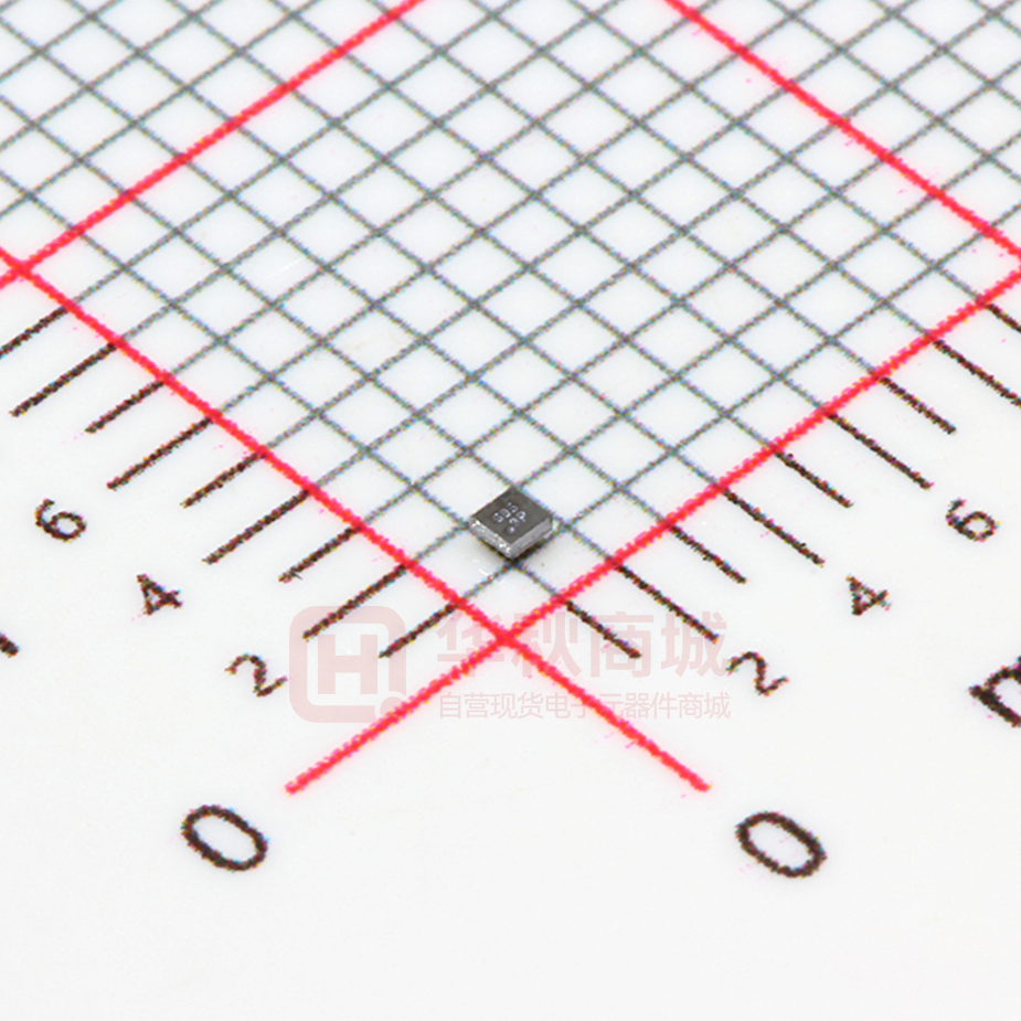

Product Folder Sample & Buy Support & Community Tools & Software Technical Documents TPS22901, TPS22902, TPS22902B SLVS803D – NOVEMBER 2008 – REVISED JANUARY 2015 TPS2290x 3.6-V, 500-mA, 78-mΩ ON-Resistance Load Switch With Controlled Turnon 1 Features 2 Applications • • • • • • • • • • • 1 • • • • • • • • Integrated P-Channel Load Switch Low Input Voltage: 1 V to 3.6 V ON-Resistance (Typical Values) – rON = 78 mΩ at VIN = 3.6 V – rON = 93 mΩ at VIN = 2.5 V – rON = 109 mΩ at VIN = 1.8 V – rON = 146 mΩ at VIN = 1.2 V 500 mA Maximum Continuous Switch Current Quiescent Current: 82 nA at 1.8 V Shutdown Current: 44 nA at 1.8 V Low Control Input Thresholds Enable Use of 1.2-V, 1.8-V, 2.5-V, and 3.3-V Logic Controlled Slew Rate to Avoid Inrush Currents – tr = 40 μs at VIN = 1.8 V (TPS22901/2) – tr = 220 μs at VIN = 1.8 V (TPS22902B) Quick Output Discharge (TPS22902/2B) ESD Performance Tested Per JESD 22 – 2000-V Human Body Model (A114-B, Class II) – 1000-V Charged-Device Model (C101) Four-Pin Wafer-Chip-Scale DSBGA Package – 0.8-mm × 0.8-mm, 0.4-mm Pitch, 0.5-mm Height (YFP) Personal Digital Assistants (PDAs) Cellular Phones GPS Devices MP3 Players Digital Cameras Peripheral Ports Portable Instrumentation RF Modules 3 Description The TPS22901, TPS22902, and TPS22902B are small, low ON-resistance (rON) load switches with a controlled turnon. These devices contain a P-channel MOSFET that operates over an input voltage range of 1.0 V to 3.6 V. The switch is controlled by an on/off input (ON), which can interface directly with lowvoltage control signals. In the TPS22902 and TPS22902B, an 88-Ω on-chip load resistor is added for output quick discharge when the switch is turned off. The TPS22901, TPS22902, and TPS22902B are available in a space-saving 4-pin DSBGA (YFP) with 0.4-mm pitch. These devices are characterized for operation over the free-air temperature range of –40°C to 85°C. Device Information(1) PART NUMBER PACKAGE BODY SIZE (NOM) DSBGA (4) 0.80 mm × 0.80 mm TPS22901 TPS22902 TPS22902B (1) For all available packages, see the orderable addendum at the end of the data sheet. 4 Typical Application Schematic VBATT VIN SMPS ON (see Note A) CIN = 1 µF CL VOUT LOAD TPS22901/02/02B CL RL OFF GND GND A. GND Switched-mode power supply 1 An IMPORTANT NOTICE at the end of this data sheet addresses availability, warranty, changes, use in safety-critical applications, intellectual property matters and other important disclaimers. PRODUCTION DATA. TPS22901, TPS22902, TPS22902B SLVS803D – NOVEMBER 2008 – REVISED JANUARY 2015 www.ti.com Table of Contents 1 2 3 4 5 6 7 8 Features .................................................................. Applications ........................................................... Description ............................................................. Typical Application Schematic............................. Revision History..................................................... Device Comparison Table..................................... Pin Configuration and Functions ......................... Specifications......................................................... 1 1 1 1 2 3 3 4 8.1 8.2 8.3 8.4 8.5 8.6 8.7 8.8 8.9 8.10 8.11 8.12 4 4 4 4 5 6 6 7 7 8 8 9 Absolute Maximum Ratings ..................................... ESD Ratings.............................................................. Recommended Operating Conditions....................... Thermal Information .................................................. Electrical Characteristics........................................... Switching Characteristics (VIN = 1.1 V)..................... Switching Characteristics (VIN = 1.2 V)..................... Switching Characteristics (VIN = 1.8 V)..................... Switching Characteristics (VIN = 2.5 V)..................... Switching Characteristics (VIN = 3.0 V)................... Switching Characteristics (VIN = 3.6 V)................... Typical DC Characteristics...................................... 9 Parameter Measurement Information ................ 19 10 Detailed Description ........................................... 20 10.1 10.2 10.3 10.4 Overview ............................................................... Functional Block Diagram ..................................... Feature Description............................................... Device Functional Modes...................................... 20 20 20 20 11 Application and Implementation........................ 21 11.1 Application Information.......................................... 21 11.2 Typical Application ................................................ 21 12 Power Supply Recommendations ..................... 24 13 Layout................................................................... 24 13.1 Layout Guidelines ................................................. 24 13.2 Layout Example .................................................... 24 14 Device and Documentation Support ................. 25 14.1 14.2 14.3 14.4 Related Links ........................................................ Trademarks ........................................................... Electrostatic Discharge Caution ............................ Glossary ................................................................ 25 25 25 25 15 Mechanical, Packaging, and Orderable Information ........................................................... 25 5 Revision History NOTE: Page numbers for previous revisions may differ from page numbers in the current version. Changes from Revision C (December 2012) to Revision D Page • Added ESD Rating table, Feature Description section, Device Functional Modes, Application and Implementation section, Power Supply Recommendations section, Layout section, Device and Documentation Support section, and Mechanical, Packaging, and Orderable Information section. ................................................................................................. 1 • Deleted the ORDERING INFORMATION table...................................................................................................................... 3 Changes from Revision B (March 2009) to Revision C • 2 Page Changed the ORDERING INFORMATION table.................................................................................................................... 3 Submit Documentation Feedback Copyright © 2008–2015, Texas Instruments Incorporated Product Folder Links: TPS22901 TPS22902 TPS22902B TPS22901, TPS22902, TPS22902B www.ti.com SLVS803D – NOVEMBER 2008 – REVISED JANUARY 2015 6 Device Comparison Table RON at 1.8 V (TYP) RISE TIME (TYP at 1.8 V) TPS22901 TPS22902 109 mΩ MAX OUTPUT CURRENT ENABLE 500 mA Active high No 40 μs Yes 220 μs TPS22902B (1) QUICK OUTPUT DISCHARGE (1) Yes This feature discharges the output of the switch to ground through an 88 Ω resistor, preventing the output from floating. 7 Pin Configuration and Functions YFP Package 4-Pin DSBGA B B A A 2 1 Laser Marking View 1 2 Bump View Pin Assignments B ON GND A VIN VOUT 2 1 Pin Functions PIN I/O DESCRIPTION NO. NAME A1 VOUT O Switch output A2 VIN I Switch input, bypass this input with a ceramic capacitor to ground B1 GND - Ground B2 ON I Switch control input, active high Copyright © 2008–2015, Texas Instruments Incorporated Product Folder Links: TPS22901 TPS22902 TPS22902B Submit Documentation Feedback 3 TPS22901, TPS22902, TPS22902B SLVS803D – NOVEMBER 2008 – REVISED JANUARY 2015 www.ti.com 8 Specifications 8.1 Absolute Maximum Ratings over operating free-air temperature range (unless otherwise noted) (1) VIN Input voltage VOUT Output voltage VON Input voltage P Power dissipation at TA = 25°C IMAX Maximum continuous switch current TA Operating free-air temperature Tlead Maximum lead temperature (10-s soldering time) Tstg Storage temperature (1) MIN MAX UNIT –0.3 4 V VIN + 0.3 V –0.3 –40 –65 4 V 0.48 W 500 mA 85 °C 300 °C 150 °C Stresses beyond those listed under Absolute Maximum Ratings may cause permanent damage to the device. These are stress ratings only, which do not imply functional operation of the device at these or any other conditions beyond those indicated under Recommended Operating Conditions. Exposure to absolute-maximum-rated conditions for extended periods may affect device reliability. 8.2 ESD Ratings VALUE Human body model (HBM), per ANSI/ESDA/JEDEC JS-001 V(ESD) (1) (2) Electrostatic discharge (1) UNIT ±2000 Charged-device model (CDM), per JEDEC specification JESD22C101 (2) V ±1000 JEDEC document JEP155 states that 500-V HBM allows safe manufacturing with a standard ESD control process. JEDEC document JEP157 states that 250-V CDM allows safe manufacturing with a standard ESD control process. 8.3 Recommended Operating Conditions VIN Input voltage VOUT Output voltage VIH High-level input voltage, ON VIL Low-level input voltage, ON CIN Input capacitor (1) MIN MAX 1 3.6 V VIN V 3.6 V 0.85 UNIT 0.4 See (1) V μF See Input Capacitor (Optional). 8.4 Thermal Information TPS2290X THERMAL METRIC (1) YFP (DSBGA) UNIT 4 PINS RθJA Junction-to-ambient thermal resistance RθJC(top) Junction-to-case (top) thermal resistance 2.3 RθJB Junction-to-board thermal resistance 35.8 ψJT Junction-to-top characterization parameter 11.8 ψJB Junction-to-board characterization parameter 35.6 (1) 4 192.1 °C/W For more information about traditional and new thermal metrics, see the IC Package Thermal Metrics application report, SPRA953. Submit Documentation Feedback Copyright © 2008–2015, Texas Instruments Incorporated Product Folder Links: TPS22901 TPS22902 TPS22902B TPS22901, TPS22902, TPS22902B www.ti.com SLVS803D – NOVEMBER 2008 – REVISED JANUARY 2015 8.5 Electrical Characteristics VIN = 1.0 V to 3.6 V, TA = –40°C to 85°C (unless otherwise noted). Typical values are for TA = 25°C PARAMETER IQ IIN(OFF) IIN(LEAKAGE) TEST CONDITIONS Quiescent current IOUT = 0, VIN = VON OFF-state supply current VON = GND, VOUT = Open OFF-state switch current VON = GND, VOUT = 0 V IOUT = - 200 mA TYP MAX Full 37 120 VIN = 1.8 V Full 82 235 VIN = 3.6 V Full 204 880 VIN = 1.1 V Full 22 210 VIN = 1.8 V Full 44 260 VIN = 3.6 V Full 137 700 VIN = 1.1 V Full 22 140 VIN = 1.8 V Full 45 230 VIN = 3.6 V Full 137 610 25°C 78 95 93 110 VIN = 2.5 V ON-state resistance MIN VIN = 1.1 V VIN = 3.6 V rON TA VIN = 1.8 V VIN = 1.2 V VIN = 1.1 V rPD Output pulldown resistance VIN = 3.3 V, VON = 0, IOUT = 30 mA (TPS22902/TPS22902B only) ION ON input leakage current VON = 1.1 V to 3.6 V or GND Copyright © 2008–2015, Texas Instruments Incorporated Product Folder Links: TPS22901 TPS22902 TPS22902B Full 25°C 146 Full nA mΩ 200 200 174 Full 25°C 130 130 Full 25°C nA 110 109 Full 25°C nA 95 Full 25°C UNIT 330 330 88 120 Ω 25 nA Submit Documentation Feedback 5 TPS22901, TPS22902, TPS22902B SLVS803D – NOVEMBER 2008 – REVISED JANUARY 2015 www.ti.com 8.6 Switching Characteristics (VIN = 1.1 V) VIN = 1.1 V, TA = 25°C (unless otherwise noted) PARAMETER tON Turn-ON time TEST CONDITIONS RL = 500 Ω MIN tr tf Turn-OFF time VOUT rise time VOUT fall time RL = 500 Ω RL = 500 Ω RL = 500 Ω MAX MIN TYP MAX MIN TYP 108 108 531 CL = 1 μF 131 131 596 CL = 3.3 μF 153 153 659 11 39 11 317 69 67 CL = 3.3 μF 1105 238 225 CL = 0.1 μF 70 70 365 CL = 1 μF 78 78 367 CL = 3.3 μF 92 92 395 CL = 0.1 μF 107 18 21 CL = 1 μF 966 175 189 3532 632 565 CL = 1 μF CL = 3.3 μF (1) TYP TPS22902B (1) CL = 0.1 μF CL = 0.1 μF tOFF TPS22902 (1) TPS22901 MAX UNIT μs μs μs μs Quick Output Discharge 8.7 Switching Characteristics (VIN = 1.2 V) VIN = 1.2 V, TA = 25°C (unless otherwise noted) PARAMETER TEST CONDITIONS CL = 0.1 μF tON tOFF tr tf Turn-ON time Turn-OFF time VOUT rise time VOUT fall time RL = 500 Ω RL = 500 Ω RL = 500 Ω RL = 500 Ω 6 MIN TYP MAX MIN TYP TPS22902B (1) MAX MIN TYP 96 96 471 CL = 1 μF 116 116 527 CL = 3.3 μF 135 135 587 CL = 0.1 μF 39 10 10 317 62 61 CL = 3.3 μF 1110 210 199 CL = 0.1 μF 62 62 324 CL = 1 μF 69 69 325 CL = 3.3 μF 81 81 350 CL = 0.1 μF 109 17 20 CL = 1 μF 995 163 175 3650 587 523 CL = 1 μF CL = 3.3 μF (1) TPS22902 (1) TPS22901 MAX UNIT μs μs μs μs Quick Output Discharge Submit Documentation Feedback Copyright © 2008–2015, Texas Instruments Incorporated Product Folder Links: TPS22901 TPS22902 TPS22902B TPS22901, TPS22902, TPS22902B www.ti.com SLVS803D – NOVEMBER 2008 – REVISED JANUARY 2015 8.8 Switching Characteristics (VIN = 1.8 V) VIN = 1.8 V, TA = 25°C (unless otherwise noted) PARAMETER tON Turn-ON time TEST CONDITIONS RL = 500 Ω MIN tr Turn-OFF time VOUT rise time RL = 500 Ω RL = 500 Ω (1) VOUT fall time RL = 500 Ω MAX MIN TYP MAX MIN TYP 61 61 302 CL = 1 μF 72 72 335 CL = 3.3 μF 83 83 367 38 8 8 317 49 49 CL = 3.3 μF 1135 169 167 CL = 0.1 μF 40 40 220 CL = 1 μF 45 45 220 CL = 3.3 μF 53 53 235 CL = 1 μF CL = 0.1 μF tf TYP TPS22902B (1) CL = 0.1 μF CL = 0.1 μF tOFF TPS22902 (1) TPS22901 111 15 15 CL = 1 μF 1020 140 159 CL = 3.3 μF 3700 517 481 MAX UNIT μs μs μs μs Quick Output Discharge 8.9 Switching Characteristics (VIN = 2.5 V) VIN = 2.5 V, TA = 25°C (unless otherwise noted) PARAMETER tON tOFF tr Turn-ON time Turn-OFF time VOUT rise time TEST CONDITIONS RL = 500 Ω RL = 500 Ω RL = 500 Ω (1) VOUT fall time RL = 500 Ω MIN TYP MAX MIN TYP TPS22902B (1) MAX MIN TYP CL = 0.1 μF 45 45 223 CL = 1 μF 53 53 246 CL = 3.3 μF 61 61 268 CL = 0.1 μF 38 7 7 314 46 47 CL = 3.3 μF 1140 161 158 CL = 0.1 μF 32 32 175 CL = 1 μF 35 35 175 CL = 3.3 μF 41 41 187 CL = 1 μF CL = 0.1 μF tf TPS22902 (1) TPS22901 113 14 18 CL = 1 μF 1040 139 185 CL = 3.3 μF 3795 516 471 MAX UNIT μs μs μs μs Quick Output Discharge Copyright © 2008–2015, Texas Instruments Incorporated Product Folder Links: TPS22901 TPS22902 TPS22902B Submit Documentation Feedback 7 TPS22901, TPS22902, TPS22902B SLVS803D – NOVEMBER 2008 – REVISED JANUARY 2015 www.ti.com 8.10 Switching Characteristics (VIN = 3.0 V) VIN = 3.0 V, TA = 25°C (unless otherwise noted) PARAMETER tON Turn-ON time TEST CONDITIONS RL = 500 Ω MIN tr Turn-OFF time VOUT rise time RL = 500 Ω RL = 500 Ω (1) VOUT fall time RL = 500 Ω MAX MIN TYP MAX MIN TYP 38 38 191 CL = 1 μF 45 45 211 CL = 3.3 μF 53 53 231 38 7 7 320 46 46 CL = 3.3 μF 1145 53 156 CL = 0.1 μF 28 28 159 CL = 1 μF 31 31 160 CL = 3.3 μF 37 37 170 CL = 1 μF CL = 0.1 μF tf TYP TPS22902B (1) CL = 0.1 μF CL = 0.1 μF tOFF TPS22902 (1) TPS22901 114 14 17 CL = 1 μF 1045 139 160 CL = 3.3 μF 3815 509 473 MAX UNIT μs μs μs μs Quick Output Discharge 8.11 Switching Characteristics (VIN = 3.6 V) VIN = 3.6 V, TA = 25°C (unless otherwise noted) PARAMETER tON tOFF tr Turn-ON time Turn-OFF time VOUT rise time TEST CONDITIONS RL = 500 Ω RL = 500 Ω RL = 500 Ω (1) 8 VOUT fall time RL = 500 Ω MIN TYP MAX MIN TYP TPS22902B (1) MAX MIN TYP CL = 0.1 μF 33 33 166 CL = 1 μF 39 39 183 CL = 3.3 μF 46 46 201 CL = 0.1 μF 38 7 7 322 46 45 CL = 3.3 μF 1145 156 155 CL = 0.1 μF 25 25 146 CL = 1 μF 28 28 146 CL = 3.3 μF 34 34 156 CL = 1 μF CL = 0.1 μF tf TPS22902 (1) TPS22901 116 14 17 CL = 1 μF 1060 139 161 CL = 3.3 μF 3840 512 475 MAX UNIT μs μs μs μs Quick Output Discharge Submit Documentation Feedback Copyright © 2008–2015, Texas Instruments Incorporated Product Folder Links: TPS22901 TPS22902 TPS22902B TPS22901, TPS22902, TPS22902B www.ti.com SLVS803D – NOVEMBER 2008 – REVISED JANUARY 2015 8.12 Typical DC Characteristics 75 1.0 0.9 0.8 ON-State Resistance, rON (mΩ) 70 ON-State Resistance, rON (Ω) 0.7 0.6 0.5 0.4 0.3 0.2 65 60 55 0.1 0.0 50 –40 0.7 0.8 0.9 1.0 1.1 1.2 1.3 1.4 1.5 1.6 1.7 1.8 1.9 2.0 2.1 2.2 2.3 2.4 2.5 2.6 2.7 2.8 2.9 3.0 3.1 3.2 3.3 25 Temperature(°C) Input Voltage, VIN (V) Figure 1. rON vs VIN Figure 2. rON vs Temperature (VIN = 3.3 V) 200 90 180 80 160 Quiescent Current, IIN (nA) 100 Voltage Drop (mV) 70 Vdrop = 1.0 V 60 Vdrop = 1.2 V 50 Vdrop = 1.8 V Vdrop = 2.5 V 40 Vdrop = 3.3 V 30 140 120 100 80 60 20 40 10 20 0 0.00 0.05 0.10 0.15 85 0.20 0.25 0.30 Load Current (A) 0.35 0.40 0.45 0 0.5 0.50 Figure 3. Voltage Drop vs. Load Current 1.0 1.5 2.0 2.5 3.0 Input Voltage, VIN(V) 3.5 4.0 Figure 4. Quiescent Current vs VIN (VON = VIN, IOUT = 0) 120 250 200 IIN(OFF) Current (nA) Quiescent Current, IIN (nA) 100 150 100 80 60 40 50 20 0 –40 25 Temperature(°C) 85 Figure 5. Quiescent Current vs Temperature (VIN = 3.3 V, IOUT = 0) 0 0.5 1.0 1.5 2.0 2.5 Input Voltage, VIN(V) 3.0 3.5 4.0 Figure 6. IIN(OFF) vs VIN (VON = 0 V) Copyright © 2008–2015, Texas Instruments Incorporated Product Folder Links: TPS22901 TPS22902 TPS22902B Submit Documentation Feedback 9 TPS22901, TPS22902, TPS22902B SLVS803D – NOVEMBER 2008 – REVISED JANUARY 2015 www.ti.com Typical DC Characteristics (continued) 250 120 225 100 IIN (Leakage) Current (nA) 200 IIN(OFF) Current (nA) 175 150 125 100 80 60 40 75 20 50 25 0 0.5 0 –40 25 Temperature(°C) 1.0 1.5 2.0 2.5 3.0 3.5 4.0 Input Voltage, VIN (V) 85 Figure 7. IIN(OFF) vs Temperature (VIN = 3.3 V) Figure 8. IIN(Leakage) vs VIN (IOUT = 0) 250 4.0 225 3.5 VIN = 3.6 V VIN = 3.3 V 3.0 175 VIN = 3 V VIN = 2.5 V 2.5 150 VOUT (V) IIN (Leakage) Current (nA) 200 125 2.0 VIN = 1.8 V VIN = 1.5 V 1.5 100 VIN = 1.2 V 1.0 75 VIN = 1.1 V 0.5 50 0.0 25 0 –0.5 –40 25 85 0.3 0.4 Temperature (°C) Figure 9. IIN (Leakage) vs Temperature (VIN = 3.3 V) 10 Submit Documentation Feedback 0.5 0.6 Input Voltage, VON (V) 0.7 0.8 Figure 10. ON-Input Threshold Copyright © 2008–2015, Texas Instruments Incorporated Product Folder Links: TPS22901 TPS22902 TPS22902B TPS22901, TPS22902, TPS22902B www.ti.com SLVS803D – NOVEMBER 2008 – REVISED JANUARY 2015 8.12.1 Typical AC Characteristics 8.12.1.1 TPS22901 42 130 VIN = 3.3 V CL = 0.1 µF RL = 500 Ω 120 40 110 tOFF 100 80 VIN = 3.3 V CL = 0.1 µF RL = 500 Ω 70 60 tON/tOFF (µs) 90 trise/tfall (µs) 38 tfall 36 34 tON 50 32 40 trise 30 30 20 28 –50 –40 –30 –20 –10 10 –50 –40 –30 –20 –10 0 10 20 30 40 Temperature (°C) 50 60 70 80 90 100 0 10 20 30 40 Temperature (°C) 50 60 70 80 90 100 Figure 12. tON/tOFF vs Temperature Figure 11. trise/tfall vs Temperature 8.12.1.2 TPS22902 40 30 28 35 tON 26 VIN = 3.3 V CL = 0.1 µF RL = 500 Ω 22 20 18 tON/tOFF (µs) 24 trise/tfall (µs) 30 trise 25 VIN = 3.3 V CL = 0.1 µF RL = 500 Ω 20 15 tfall 16 tOFF 10 14 5 12 0 10 –50 –40 –30 –20 –10 0 10 20 30 40 Temperature (°C) 50 60 70 80 –50 –40 –30 –20 –10 90 100 0 10 20 30 40 Temperature (°C) 50 60 70 80 90 100 Figure 14. tON/tOFF vs Temperature Figure 13. trise/tfall vs Temperature 8.12.1.3 TPS22902B 170 160 150 140 130 trise 120 trise/tfall (µs) 100 90 tON/tOFF (µs) VIN = 3.3 V CL = 0.1 µF RL = 500 Ω 110 80 70 60 50 40 tfall 30 20 10 0 –50 –35 –20 –5 10 25 40 Temperature (°C) 55 70 85 Figure 15. trise/tfall vs Temperature 100 200 190 180 170 160 150 140 130 120 110 100 90 80 70 60 50 40 30 20 10 0 –50 tON VIN = 3.3 V CL = 0.1 µF RL = 500 Ω tOFF –35 –20 –5 10 25 40 Temperature (°C) 55 70 85 100 Figure 16. tON/tOFF vs Temperature Copyright © 2008–2015, Texas Instruments Incorporated Product Folder Links: TPS22901 TPS22902 TPS22902B Submit Documentation Feedback 11 TPS22901, TPS22902, TPS22902B SLVS803D – NOVEMBER 2008 – REVISED JANUARY 2015 www.ti.com Typical AC Characteristics (continued) 6.00 5.00 3.00 VON 2.00 1.00 0.00 –1.00 –2.00 –3.00 CL = 0.1 µF RL = 500 Ω VIN = 3.3 V Control Input Voltage (V) 4.00 –4.00 –5.00 –6.00 –7.00 –8.00 0 50 100 150 200 250 Time (µs) 300 350 400 2.00 1.80 1.60 1.40 1.20 1.00 0.80 0.60 0.40 0.20 0.00 –0.20 –0.40 –0.60 –0.80 –1.00 –1.20 –1.40 –1.60 –1.80 –2.00 –10 450 400 300 250 200 VON 50 0.0 –50 –100 –150 CL = 0.1 µF RL = 11 Ω VIN = 3.3 V 8.00 7.00 IOUT 6.00 5.00 3.00 VON 2.00 1.00 0.005 0.00 –1.00 –2.00 –3.00 CL = 3.3 µF RL = 500 Ω VIN = 3.3 V Control Input Voltage (V) 4.00 –4.00 –5.00 –6.00 –7.00 –8.00 0 50 100 150 200 250 Time (µs) 300 350 400 10 3.50 3.00 IOUT 2.50 VON 1.50 1.00 0.50 0.00 –0.50 –1.00 –1.50 CL = 0.1 µF RL = 500 Ω VIN = 1.2 V –2.50 –3.00 –3.50 –4.00 100 150 200 250 Time (µs) 300 350 Figure 21. tON Response 12 –2.00 Submit Documentation Feedback 400 450 Control Input Voltage (V) 2.00 50 20 30 40 50 Time (µs) 60 70 80 90 400 350 IOUT 300 250 200 VON 150 100 50 0.0 –50 –100 –150 CL = 3.3 µF RL = 11 Ω VIN = 3.3 V –200 –250 –300 –350 –400 0 50 100 150 200 250 Time (µs) 300 350 400 450 Figure 20. tON Response 4.00 0 –300 –400 0 2.00 1.80 1.60 1.40 1.20 1.00 0.80 0.60 0.40 0.20 0.00 –0.20 –0.40 –0.60 –0.80 –1.00 –1.20 –1.40 –1.60 –1.80 –2.00 –50 450 Output Current (mA) Control Input Voltage (V) –50 –250 –350 Figure 19. tON Response 2.00 1.80 1.60 1.40 1.20 1.00 0.80 0.60 0.40 0.20 0.00 –0.20 –0.40 –0.60 –0.80 –1.00 –1.20 –1.40 –1.60 –1.80 –2.00 –200 Figure 18. tON Response Output Current (mA) Control Input Voltage (V) –50 150 100 Figure 17. tON Response 2.00 1.80 1.60 1.40 1.20 1.00 0.80 0.60 0.40 0.20 0.00 –0.20 –0.40 –0.60 –0.80 –1.00 –1.20 –1.40 –1.60 –1.80 –2.00 350 IOUT Output Current (mA) 7.00 Output Current (mA) –50 8.00 IOUT 2.00 1.80 1.60 1.40 1.20 1.00 0.80 0.60 0.40 0.20 0.00 –0.20 –0.40 –0.60 –0.80 –1.00 –1.20 –1.40 –1.60 –1.80 –2.00 –50 199 180 160 140 120 100 80 60 40 20 0.0 –20 –40 –60 –80 –100 –120 –140 –160 –180 –200 IOUT VON CL = 0.1 µF RL = 11 Ω VIN = 1.2 V 0 50 100 150 200 250 Time (µs) 300 350 400 Output Current (mA) 2.00 1.80 1.60 1.40 1.20 1.00 0.80 0.60 0.40 0.20 0.00 –0.20 –0.40 –0.60 –0.80 –1.00 –1.20 –1.40 –1.60 –1.80 –2.00 Output Current (mA) Control Input Voltage (V) 8.12.1.4 TPS22901 and TPS22902 450 Figure 22. tON Response Copyright © 2008–2015, Texas Instruments Incorporated Product Folder Links: TPS22901 TPS22902 TPS22902B TPS22901, TPS22902, TPS22902B www.ti.com SLVS803D – NOVEMBER 2008 – REVISED JANUARY 2015 –50 4.00 3.50 3.00 IOUT 2.50 1.50 VON 1.00 0.50 0.00 –0.50 –1.00 –1.50 CL = 3.3 µF RL = 500 Ω VIN = 1.2 V Control Input Voltage (V) 2.00 –2.00 –2.50 –3.00 –3.50 –4.00 0 50 100 150 200 250 Time (µs) 300 350 400 450 2.00 1.80 1.60 1.40 1.20 1.00 0.80 0.60 0.40 0.20 0.00 –0.20 –0.40 –0.60 –0.80 –1.00 –1.20 –1.40 –1.60 –1.80 –2.00 –50 199 180 160 140 120 100 80 60 40 20 0.0 –20 –40 –60 –80 –100 –120 –140 –160 –180 –200 IOUT VON CL = 3.3 µF RL = 11 Ω VIN = 1.2 V 0 50 Figure 23. tON Response 100 150 200 250 Time (µs) 300 350 400 Output Current (mA) 2.00 1.80 1.60 1.40 1.20 1.00 0.80 0.60 0.40 0.20 0.00 –0.20 –0.40 –0.60 –0.80 –1.00 –1.20 –1.40 –1.60 –1.80 –2.00 Output Current (mA) Control Input Voltage (V) Typical AC Characteristics (continued) 450 Figure 24. tON Response 8.12.1.5 TPS22901 2.5 9.00 2.2 2.0 1.8 1.6 1.4 1.2 1.0 800 600 400 200 0.0 –200 –400 –600 –800 –1.0 –1.2 –1.5 8.00 7.00 5.00 4.00 3.00 2.00 1.00 VON 0.00 –1.00 Control Input Voltage (V) 6.00 IOUT –2.00 –3.00 –4.00 –5.00 –6.00 0 50 100 150 200 250 Time (µs) 300 350 400 –50 450 499 CL = 0.1 µF RL = 11 Ω VIN = 3.3 V CL = 3.3 µF RL = 500 Ω VIN = 3.3 V 2.5 9.00 2.2 2.0 1.8 1.6 1.4 1.2 1.0 800 600 400 200 0.0 –200 –400 –600 –800 –1.0 –1.2 –1.5 8.00 7.00 5.00 IOUT 4.00 3.00 2.00 1.00 VON 0.00 –1.00 –2.00 –3.00 –4.00 –5.00 –6.00 10 20 30 40 50 Time (µs) 60 70 Figure 27. tOFF Response 80 90 Control Input Voltage (V) 6.00 0 350 300 250 200 150 100 VON 50 0.00 –50 –150 –200 –250 –300 0 50 100 150 200 250 Time (µs) 300 350 400 450 Figure 26. tOFF Response 10.00 Output Current (mA) Control Input Voltage (V) –10 400 IOUT Figure 25. tOFF Response 2.5 2.2 2.0 1.8 1.6 1.4 1.2 1.0 800 600 400 200 0.0 –200 –400 –600 –800 –1.0 –1.2 –1.5 450 –50 499 CL = 3.3 µF RL = 11 Ω VIN = 3.3 V 450 400 350 300 250 200 150 IOUT 100 VON 50 0.00 Output Current (mA) –50 10.00 Output Current (mA) CL = 0.1 µF RL = 500 Ω VIN = 3.3 V 2.2 2.0 1.8 1.6 1.4 1.2 1.0 800 600 400 200 0.0 –200 –400 –600 –800 –1.0 –1.2 –1.5 Output Current (mA) Control Input Voltage (V) 2.5 –50 –150 –200 –250 –300 0 50 100 150 200 250 Time (µs) 300 350 400 450 Figure 28. tOFF Response Copyright © 2008–2015, Texas Instruments Incorporated Product Folder Links: TPS22901 TPS22902 TPS22902B Submit Documentation Feedback 13 TPS22901, TPS22902, TPS22902B SLVS803D – NOVEMBER 2008 – REVISED JANUARY 2015 www.ti.com CL = 0.1 µF RL = 500 Ω VIN = 1.2 V 5.00 2.5 4.50 2.2 2.0 1.8 1.6 1.4 1.2 1.0 800 600 400 200 0.0 –200 –400 –600 –800 –1.0 –1.2 –1.5 4.00 3.50 2.50 0.8 0.6 0.4 0.2 0.0 –0.2 –0.4 –0.6 –0.8 –1.0 –1.2 –1.5 2.00 IOUT 1.50 500 VON 0.00 –500 Control Input Voltage (V) 3.00 –1.00 –1.50 –2.00 –2.50 –3.00 –50 0 50 100 150 200 250 Time (µs) 300 350 400 CL = 0.1 µF RL = 11 Ω VIN = 1.2 V IOUT VON –5.0 450 0 5.0 Figure 29. tOFF Response 5.00 2.5 4.50 2.2 2.0 1.8 1.6 1.4 1.2 1.0 0.8 0.6 0.4 0.2 0.0 –0.2 –0.4 –0.6 –0.8 –1.0 –1.2 –1.5 4.00 3.50 2.50 2.00 IOUT 1.50 1.00 0.50 VON 0.00 –0.50 Control Input Voltage (V) 3.00 Output Current (mA) Control Input Voltage (V) CL = 3.3 µF RL = 500 Ω VIN = 1.2 V –1.00 –1.50 –2.00 –2.50 –3.00 –1.0 0 1.0 2.0 3.0 4.0 5.0 Time (ms) 6.0 7.0 15.0 20.0 25.0 Time (µs) 30.0 35.0 40.0 Figure 30. tOFF Response 2.5 2.2 2.0 1.8 1.6 1.4 1.2 1.0 0.8 0.6 0.4 0.2 0.0 –0.2 –0.4 –0.6 –0.8 –1.0 –1.2 –1.5 10.0 249 220 200 180 160 140 120 100 80 60 40 20 0.00 –20 –40 –60 –80 –100 –120 –150 45.0 8.0 IOUT VON –50 9.0 249 220 200 180 160 140 120 100 80 60 40 20 0.00 –20 –40 –60 –80 –100 –120 –150 CL = 3.3 µF RL = 11 Ω VIN = 1.2 V 0 50 Figure 31. tOFF Response 100 150 200 250 Time (µs) 300 350 400 Output Current (mA) 2.2 2.0 1.8 1.6 1.4 1.2 1.0 Output Current (mA) Control Input Voltage (V) 2.5 Output Current (mA) Typical AC Characteristics (continued) 450 Figure 32. tOFF Response –50 6.00 5.00 4.00 VON 3.00 2.00 1.00 0.00 –1.00 –2.00 –3.00 –4.00 –5.00 –6.00 –7.00 –8.00 0 50 100 150 200 250 Time (µs) 300 350 Figure 33. tOFF Response 14 7.00 CL = 0.1 µF RL = 500 Ω VIN = 3.3 V Submit Documentation Feedback 400 450 2.00 1.80 1.60 1.40 1.20 1.00 0.80 0.60 0.40 0.20 0.00 –0.20 –0.40 –0.60 –0.80 –1.00 –1.20 –1.40 –1.60 –1.80 –2.00 –10 400 350 CL = 0.1 µF RL = 11 Ω VIN = 3.3 V IOUT 300 250 200 VON 150 100 50 0.0 –50 –100 Output Current (mA) 8.00 IOUT Control Input Voltage (V) 2.00 1.80 1.60 1.40 1.20 1.00 0.80 0.60 0.40 0.20 0.00 –0.20 –0.40 –0.60 –0.80 –1.00 –1.20 –1.40 –1.60 –1.80 –2.00 Output Current (mA) Control Input Voltage (V) 8.12.1.6 TPS22902 –150 –200 –250 –300 –350 –400 0 10 20 30 40 50 Time (µs) 60 70 80 90 Figure 34. tOFF Response Copyright © 2008–2015, Texas Instruments Incorporated Product Folder Links: TPS22901 TPS22902 TPS22902B TPS22901, TPS22902, TPS22902B www.ti.com SLVS803D – NOVEMBER 2008 – REVISED JANUARY 2015 7.00 CL = 3.3 µF RL = 500 Ω VIN = 3.3 V 6.00 5.00 4.00 VON 3.00 2.00 1.00 0.00 –1.00 –2.00 –3.00 –4.00 –5.00 –6.00 –7.00 –8.00 200 400 600 800 1000 Time (µs) 1200 1400 1600 150 100 50 0.0 –50 –100 –150 –200 –250 –300 –350 –400 0 50 3.50 3.00 2.50 1.50 1.00 500 0.00 –500 –1.00 –1.50 Control Input Voltage (V) 2.00 VON Output Current (mA) Control Input Voltage (V) 4.00 –2.00 –2.50 –3.00 –3.50 –4.00 –50 0 50 100 150 200 250 Time (µs) 300 350 400 2.00 1.80 1.60 1.40 1.20 1.00 0.80 0.60 0.40 0.20 0.00 –0.20 –0.40 –0.60 –0.80 –1.00 –1.20 –1.40 –1.60 –1.80 –2.00 3.50 CL = 3.3 µF RL = 500 Ω VIN = 1.2 V 3.00 2.50 1.50 1.00 0.50 0.00 –0.50 –1.00 –1.50 –2.00 –2.50 –3.00 –3.50 –4.00 200 400 600 800 1000 Time (µs) 1200 1400 Figure 39. tOFF Response 1600 1800 Control Input Voltage (V) 2.00 VON 0 300 350 400 450 VON 0 10 20 30 40 50 Time (µs) 60 70 80 200 180 160 140 120 100 80 60 40 20 0.0 –20 –40 –60 –80 –100 –120 –140 –160 –180 –200 200 180 160 140 120 100 80 60 40 20 0.0 –20 –40 –60 –80 –100 –120 –140 –160 –180 –200 90 Figure 38. tOFF Response Output Current (mA) Control Input Voltage (V) –200 200 250 Time (µs) IOUT –10 450 4.00 IOUT 150 CL = 0.1 µF RL = 11 Ω VIN = 1.2 V Figure 37. tOFF Response 2.00 1.80 1.60 1.40 1.20 1.00 0.80 0.60 0.40 0.20 0.00 –0.20 –0.40 –0.60 –0.80 –1.00 –1.20 –1.40 –1.60 –1.80 –2.00 100 Figure 36. tOFF Response CL = 0.1 µF RL = 500 Ω VIN = 1.2 V IOUT 250 200 Figure 35. tOFF Response 2.00 1.80 1.60 1.40 1.20 1.00 0.80 0.60 0.40 0.20 0.00 –0.20 –0.40 –0.60 –0.80 –1.00 –1.20 –1.40 –1.60 –1.80 –2.00 300 VON –50 1800 350 Output Current (mA) 0 400 CL = 3.3 µF RL = 11 Ω VIN = 3.3 V IOUT Output Current (mA) –200 2.00 1.80 1.60 1.40 1.20 1.00 0.80 0.60 0.40 0.20 0.00 –0.20 –0.40 –0.60 –0.80 –1.00 –1.20 –1.40 –1.60 –1.80 –2.00 Output Current (mA) 8.00 IOUT Control Input Voltage (V) 2.00 1.80 1.60 1.40 1.20 1.00 0.80 0.60 0.40 0.20 0.00 –0.20 –0.40 –0.60 –0.80 –1.00 –1.20 –1.40 –1.60 –1.80 –2.00 Output Current (mA) Control Input Voltage (V) Typical AC Characteristics (continued) 2.00 1.80 1.60 1.40 1.20 1.00 0.80 0.60 0.40 0.20 0.00 –0.20 –0.40 –0.60 –0.80 –1.00 –1.20 –1.40 –1.60 –1.80 –2.00 –50 CL = 3.3 µF RL = 11 Ω VIN = 1.2 V IOUT VON 0 50 100 150 200 250 Time (µs) 300 350 400 450 Figure 40. tOFF Response Copyright © 2008–2015, Texas Instruments Incorporated Product Folder Links: TPS22901 TPS22902 TPS22902B Submit Documentation Feedback 15 TPS22901, TPS22902, TPS22902B SLVS803D – NOVEMBER 2008 – REVISED JANUARY 2015 www.ti.com Typical AC Characteristics (continued) 8.12.1.7 TPS22902B 0.6 IOUT 0.05 0.5 0.4 0.3 0.2 Output Current (A) Control Input Voltage (V) 0.7 0.1 Control Input Voltage (V) 0.8 0.00 0.0 –0.1 –0.2 –0.3 –200 0.0 200 400 600 800 1000 1200 VON –0.05 –0.5 0.00 1500 –1000 –500 0.0 500 Time (µs) CL = 3 µF RL = 500 Ω VIN = 3.3 V 1.1 1.0 VON 0.9 0.01 IOUT 0.6 0.05 0.5 0.4 0.3 0.2 0.1 Control Input Voltage (V) 0.7 Output Current (A) Control Input Voltage (V) 0.8 0.00 0.0 –0.1 –0.2 –0.3 2500 3000 0.35 0.0 500 1000 Time (µs) 1500 2000 2500 CL = 3 µF RL = 11 Ω VIN = 3.3 V IOUT 3.2 3.0 2.8 2.6 2.4 2.2 2.0 1.8 1.6 1.4 1.2 1.0 0.8 0.6 0.4 0.2 0.0 –0.2 3000 –1000 –0.05 –500 0.0 500 1000 Time (µs) 1500 2000 2500 CL = 0.1 µF RL = 500 Ω VIN = 1.2 V 1.0 VON 0.9 0.01 0.6 0.05 0.4 0.3 IOUT 0.2 0.1 0.00 0.0 –0.1 –0.2 –0.3 –0.00 –200 0.0 200 400 600 Time (µs) 800 1000 1200 Figure 45. tON Response Submit Documentation Feedback 1500 Output Current (A) 0.7 Control Input Voltage (V) 0.8 0.5 3000 Figure 44. tON Response 0.35 3.5 1.1 0.32 0.30 0.28 0.26 0.24 0.22 0.20 0.18 0.16 0.14 0.12 0.10 0.08 0.06 0.04 0.02 0.00 –0.02 VON Figure 43. tON Response Control Input Voltage (V) 2000 –0.5 –0.00 –500 1.2 16 1500 3.5 1.2 –0.4 –5000 1000 Time (µs) Figure 42. tON Response Figure 41. tON Response –0.4 –1000 0.32 0.30 0.28 0.26 0.24 0.22 0.20 0.18 0.16 0.14 0.12 0.10 0.08 0.06 0.04 0.02 0.00 –0.02 Output Current (A) VON 0.9 0.01 CL = 0.1 µF RL = 11 Ω VIN = 1.2 V 3.2 3.0 2.8 2.6 2.4 2.2 2.0 1.8 1.6 1.4 1.2 1.0 0.8 0.6 0.4 0.2 0.0 –0.2 –0.5 –1000 IOUT VON 0.32 0.30 0.28 0.26 0.24 0.22 0.20 0.18 0.16 0.14 0.12 0.10 0.08 0.06 0.04 0.02 0.00 –0.02 Output Current (A) 1.0 CL = 0.1 µF RL = 11 Ω VIN = 3.3 V IOUT 3.2 3.0 2.8 2.6 2.4 2.2 2.0 1.8 1.6 1.4 1.2 1.0 0.8 0.6 0.4 0.2 0.0 –0.2 Output Current (A) CL = 0.1 µF RL = 500 Ω VIN = 3.3 V 1.1 –0.4 –500 0.35 3.5 1.2 –0.05 –500 0.0 500 1000 Time (µs) 1500 2000 2500 3000 Figure 46. tON Response Copyright © 2008–2015, Texas Instruments Incorporated Product Folder Links: TPS22901 TPS22902 TPS22902B TPS22901, TPS22902, TPS22902B www.ti.com SLVS803D – NOVEMBER 2008 – REVISED JANUARY 2015 Typical AC Characteristics (continued) 0.9 0.01 0.6 0.05 0.5 0.4 0.3 IOUT 0.2 0.1 Control Input Voltage (V) 0.7 Output Current (A) Control Input Voltage (V) 0.8 0.00 0.0 –0.1 –0.2 –0.3 –500 0.0 500 1000 Time (µs) 1500 2000 2500 IOUT VON –0.05 –0.5 –0.00 3000 –1000 –500 0.0 Figure 47. tON Response 1.0 VON 0.01 0.6 0.05 0.5 0.4 0.3 IOUT 0.2 0.1 Control Input Voltage (V) 0.7 Output Current (A) Control Input Voltage (V) 0.8 0.00 0.0 –0.1 –0.2 –0.3 0.0 200 400 600 Time (µs) 800 1000 1200 3.2 3.0 2.8 2.6 2.4 2.2 2.0 1.8 1.6 1.4 1.2 1.0 0.8 0.6 0.4 0.2 0.0 –0.2 2500 3000 0.35 CL = 0.1 µF RL = 11 Ω VIN = 3.3 V 0.32 0.30 0.28 0.26 0.24 0.22 0.20 0.18 0.16 0.14 0.12 0.10 0.08 0.06 0.04 0.02 0.00 –0.02 VON 1500 –250 –0.05 –100 0.0 100 200 300 Time (µs) 400 500 600 750 Figure 50. tOFF Response 0.35 3.5 CL = 3 µF RL = 500 Ω VIN = 3.3 V 1.1 1.0 VON 0.01 0.6 0.05 0.5 0.4 0.3 IOUT 0.2 0.1 0.00 0.0 –0.1 –0.2 –0.3 –0.00 –200 0.0 200 400 600 Time (µs) 800 1000 1200 Figure 51. tOFF Response 1500 Output Current (A) 0.7 Control Input Voltage (V) 0.8 Control Input Voltage (V) 2000 IOUT Figure 49. tOFF Response –0.4 –5000 1500 –0.5 –0.00 –200 1.2 0.9 1000 Time (µs) Figure 48. tON Response CL = 0.1 µF RL = 500 Ω VIN = 3.3 V 1.1 –0.4 –5000 500 3.5 1.2 0.9 0.32 0.30 0.28 0.26 0.24 0.22 0.20 0.18 0.16 0.14 0.12 0.10 0.08 0.06 0.04 0.02 0.00 –0.02 Output Current (A) VON 3.2 3.0 2.8 2.6 2.4 2.2 2.0 1.8 1.6 1.4 1.2 1.0 0.8 0.6 0.4 0.2 0.0 –0.2 CL = 3 µF RL = 11 Ω VIN = 3.3 V IOUT 0.32 0.30 0.28 0.26 0.24 0.22 0.20 0.18 0.16 0.14 0.12 0.10 0.08 0.06 0.04 0.02 0.00 –0.02 VON –0.05 –0.5 –250 Output Current (A) 1.0 CL = 3 µF RL = 11 Ω VIN = 1.2 V 3.2 3.0 2.8 2.6 2.4 2.2 2.0 1.8 1.6 1.4 1.2 1.0 0.8 0.6 0.4 0.2 0.0 –0.2 Output Current (A) CL = 3 µF RL = 500 Ω VIN = 1.2 V 1.1 –0.4 –1000 0.35 3.5 1.2 –100 0.0 100 200 300 Time (µs) 400 500 600 750 Figure 52. tOFF Response Copyright © 2008–2015, Texas Instruments Incorporated Product Folder Links: TPS22901 TPS22902 TPS22902B Submit Documentation Feedback 17 TPS22901, TPS22902, TPS22902B SLVS803D – NOVEMBER 2008 – REVISED JANUARY 2015 www.ti.com Typical AC Characteristics (continued) VON 0.01 0.6 0.05 0.5 0.4 0.3 IOUT 0.2 0.1 Control Input Voltage (V) 0.7 Output Current (A) Control Input Voltage (V) 0.8 0.00 0.0 –0.1 –0.2 –0.3 –0.4 –50 0.0 20 40 60 Time (µs) 80 100 120 150 –250 IOUT VON –0.05 –100 0.0 Figure 53. tOFF Response 1.0 VON 0.01 0.6 0.05 0.5 0.4 0.3 0.2 IOUT 0.1 0.00 0.0 –0.1 –0.2 –0.3 –0.00 –500 0.0 500 1000 Time (µs) 1500 2000 2500 Figure 55. tOFF Response Submit Documentation Feedback 3000 Control Input Voltage (V) 0.7 Output Current (A) Control Input Voltage (V) 0.8 18 200 300 Time (µs) 400 500 600 750 Figure 54. tOFF Response CL = 3 µF RL = 500 Ω VIN = 1.2 V 1.1 –0.4 –1000 100 0.35 3.5 1.2 0.9 0.32 0.30 0.28 0.26 0.24 0.22 0.20 0.18 0.16 0.14 0.12 0.10 0.08 0.06 0.04 0.02 0.00 –0.02 –0.5 –0.00 –20 CL = 0.1 µF RL = 11 Ω VIN = 1.2 V 3.2 3.0 2.8 2.6 2.4 2.2 2.0 1.8 1.6 1.4 1.2 1.0 0.8 0.6 0.4 0.2 0.0 –0.2 CL = 3 µF RL = 11 Ω VIN = 1.2 V 0.32 0.30 0.28 0.26 0.24 0.22 0.20 0.18 0.16 0.14 0.12 0.10 0.08 0.06 0.04 0.02 0.00 –0.02 IOUT VON –0.05 –0.5 –250 Output Current (A) 1.0 3.2 3.0 2.8 2.6 2.4 2.2 2.0 1.8 1.6 1.4 1.2 1.0 0.8 0.6 0.4 0.2 0.0 –0.2 Output Current (A) CL = 0.1 µF RL = 500 Ω VIN = 1.2 V 1.1 0.9 0.35 3.5 1.2 –100 0.0 100 200 300 Time (µs) 400 500 600 750 Figure 56. tOFF Response Copyright © 2008–2015, Texas Instruments Incorporated Product Folder Links: TPS22901 TPS22902 TPS22902B TPS22901, TPS22902, TPS22902B www.ti.com SLVS803D – NOVEMBER 2008 – REVISED JANUARY 2015 9 Parameter Measurement Information VIN ON VOUT (A) RL CL + – TPS22901/02 OFF CIN =1 µF GND GND GND TEST CIRCUIT 1.8 V VON VON VON/2 VON/2 tr 0V tON tOFF VOUT/2 VOUT/2 90% VOUT VOH VOUT tf 0V 10% 90% 10% VOL tON/tOFF WAVEFORMS A. trise and tfall of the control signal is 100 ns. Figure 57. Test Circuit and tON/tOFF Waveforms Copyright © 2008–2015, Texas Instruments Incorporated Product Folder Links: TPS22901 TPS22902 TPS22902B Submit Documentation Feedback 19 TPS22901, TPS22902, TPS22902B SLVS803D – NOVEMBER 2008 – REVISED JANUARY 2015 www.ti.com 10 Detailed Description 10.1 Overview The TPS2290x and TPS22902B is a single channel, 500-mA load switch in a small, space-saving DSBGA-4 package. These devices implement a P-channel MOSFET to provide a low ON-resistance for a low voltage drop across the device. A controlled rise time is used in applications to limit the inrush current. 10.2 Functional Block Diagram VIN A2 Turn-On Slew Rate Controlled Driver ON Control Logic B2 ESD Protection A1 VOUT Output Discharge (TPS22902, TPS22902B Only) B1 GND 10.3 Feature Description 10.3.1 ON/OFF Control The ON pin controls the state of the switch. Activating ON continuously holds the switch in the on state. ON is active-high and has a low threshold, making it capable of interfacing with low-voltage signals. The ON pin is compatible with standard GPIO logic threshold, and it can be used with any microcontroller with 1.2 V, 1.8 V, 2.5 V or 3.3 V GPIOs. 10.3.2 Quick Output Discharge The TPS2290x and TPS22902B includes the Quick Output Discharge (QOD) feature. When the switch is disabled, a discharge resistance with a typical value of 88 Ω is connected between the output and ground. This resistance pulls down the output and prevents it from floating when the device is disabled. 10.4 Device Functional Modes Table 1 lists the VOURT pin connections for a particular device as determined by the ON pin. Table 1. VOUT Function Table 20 ON (Control Input) TPS22901 TPS22902/2B L Open GND H VIN VIN Submit Documentation Feedback Copyright © 2008–2015, Texas Instruments Incorporated Product Folder Links: TPS22901 TPS22902 TPS22902B TPS22901, TPS22902, TPS22902B www.ti.com SLVS803D – NOVEMBER 2008 – REVISED JANUARY 2015 11 Application and Implementation NOTE Information in the following applications sections is not part of the TI component specification, and TI does not warrant its accuracy or completeness. TI’s customers are responsible for determining suitability of components for their purposes. Customers should validate and test their design implementation to confirm system functionality. 11.1 Application Information 11.1.1 Input Capacitor (Optional) To limit the voltage drop on the input supply caused by transient inrush currents when the switch turns on into a discharged load capacitor, a capacitor needs to be placed between VIN and GND. A 1-μF ceramic capacitor, CIN, placed close to the pins is usually sufficient. Higher values of CIN can be use to further reduce the voltage drop during high current application. When switching heavy loads, TI recommends using an input capacitor about 10 times higher than the output capacitor in order to avoid excessive voltage drop. 11.1.2 Output Capacitor (Optional) Because of the integral body diode in the PMOS switch, a CIN greater than CL is highly recommended. A CL greater than CIN can cause VOUT to exceed VIN when the system supply is removed. This could result in current flow through the body diode from VOUT to VIN. 11.2 Typical Application VBATT VIN SMPS ON (see Note A) CIN = 1 µF VOUT LOAD TPS22901/02/02B CL CL RL OFF GND GND GND A. Switched-mode power supply Figure 58. Typical Application Schematic 11.2.1 Design Requirements Table 2. Design Parameters DESIGN PARAMETER EXAMPLE VALUE VIN 1.8 V CL 4.7 µF Load current 500 mA Ambient Temperature 25 °C Maximum inrush current 200 mA Copyright © 2008–2015, Texas Instruments Incorporated Product Folder Links: TPS22901 TPS22902 TPS22902B Submit Documentation Feedback 21 TPS22901, TPS22902, TPS22902B SLVS803D – NOVEMBER 2008 – REVISED JANUARY 2015 www.ti.com 11.2.2 Detailed Design Procedure 11.2.2.1 Managing Inrush Current When the switch is enabled, the output capacitors must be charged up from 0 V to the set value (1.8 V in this example). This charge arrives in the form of inrush current. Inrush current can be calculated using the following equation: dV IINRUSH = CL ´ OUT dt where: • • • CL = Output capacitance dVOUT = Output voltage dt = Rise time (1) The TPS2290x and TPS22902B offers a controlled rise time for minimizing inrush current. This device can be selected based upon the minimum acceptable rise time which can be calculated using the design requirements and the inrush current equation. An output capacitance of 4.7 µF will be used since the amount of inrush current increases with output capacitance: 200 mA = 4.7 µF × 1.8V / dt dt = 42.3 µs (2) To ensure an inrush current of less than 200 mA, a device with a rise time greater than 42.3 µs must be used. The TPS22902B has a typical rise time of 220 µs at 1.8 V which meets the above design requirements. The TPS22901/2 has a faster rise time of 40 µs at 1.8 V, and this would result in an inrush current larger than desired. 11.2.2.2 VIN to VOUT Voltage Drop The voltage drop from VIN to VOUT is determined by the ON-resistance of the device and the load current. RON can be found in Electrical Characteristics and is dependent on temperature. When the value of RON is found, the following equation can be used to calculate the voltage drop across the device: ΔV = ILOAD × RON where: • • • ΔV = Voltage drop across the device ILOAD = Load current RON = ON-resistance of the device (3) At VIN = 1.8 V, the TPS22901/2/2B has an RON value of 109 mΩ. Using this value and the defined load current, the above equation can be evaluated: ΔV = 500 mA × 109 mΩ ΔV = 54.5 mV (4) Therefore, the voltage drop across the device will be 54.5 mV. 22 Submit Documentation Feedback Copyright © 2008–2015, Texas Instruments Incorporated Product Folder Links: TPS22901 TPS22902 TPS22902B TPS22901, TPS22902, TPS22902B www.ti.com SLVS803D – NOVEMBER 2008 – REVISED JANUARY 2015 11.2.3 Application Curve Figure 59 shows the expected voltage drop across the device for different load currents and input voltages. 100 90 80 Voltage Drop (mV) 70 Vdrop = 1.0 V 60 Vdrop = 1.2 V 50 Vdrop = 1.8 V Vdrop = 2.5 V 40 Vdrop = 3.3 V 30 20 10 0 0.00 0.05 0.10 0.15 0.20 0.25 0.30 Load Current (A) 0.35 0.40 0.45 0.50 Figure 59. Voltage Drop vs Load Current Copyright © 2008–2015, Texas Instruments Incorporated Product Folder Links: TPS22901 TPS22902 TPS22902B Submit Documentation Feedback 23 TPS22901, TPS22902, TPS22902B SLVS803D – NOVEMBER 2008 – REVISED JANUARY 2015 www.ti.com 12 Power Supply Recommendations The device is designed to operate with a VIN range of 1 V to 3.6 V. This supply must be well regulated and placed as close to the device terminals as possible. It must also be able to withstand all transient and load currents, using a recommended input capacitance of 1 µF if necessary. If the supply is located more than a few inches from the device terminals, additional bulk capacitance may be required in addition to the ceramic bypass capacitors. If additional bulk capacitance is required, an electrolytic, tantalum, or ceramic capacitor of 10 µF may be sufficient. 13 Layout 13.1 Layout Guidelines For best performance, VIN, VOUT, and GND traces should be as short and wide as possible to help minimize the parasitic electrical effects. To be most effective, the input and output capacitors should be placed close to the device to minimize the effects that parasitic trace inductances may have on normal operation. For higher reliability, the maximum IC junction temperature, TJ(max), should be restricted to 125˚C under normal operating conditions. Junction temperature is directly proportional to power dissipation in the device and the two are related by TJ = TA + θJA × PD where: • • • • TJ = Junction temperature of the device TA = Ambient temperature PD = Power dissipation inside the device θJA = Junction to ambient thermal resistance. See Thermal Information section of the datasheet. This parameter is highly dependent on board layout. (5) 13.2 Layout Example Figure 60. Layout Example Schematic 24 Submit Documentation Feedback Copyright © 2008–2015, Texas Instruments Incorporated Product Folder Links: TPS22901 TPS22902 TPS22902B TPS22901, TPS22902, TPS22902B www.ti.com SLVS803D – NOVEMBER 2008 – REVISED JANUARY 2015 14 Device and Documentation Support 14.1 Related Links The table below lists quick access links. Categories include technical documents, support and community resources, tools and software, and quick access to sample or buy. Table 3. Related Links PARTS PRODUCT FOLDER SAMPLE & BUY TECHNICAL DOCUMENTS TOOLS & SOFTWARE SUPPORT & COMMUNITY TPS22901 Click here Click here Click here Click here Click here TPS22902 Click here Click here Click here Click here Click here TPS22902B Click here Click here Click here Click here Click here 14.2 Trademarks All trademarks are the property of their respective owners. 14.3 Electrostatic Discharge Caution These devices have limited built-in ESD protection. The leads should be shorted together or the device placed in conductive foam during storage or handling to prevent electrostatic damage to the MOS gates. 14.4 Glossary SLYZ022 — TI Glossary. This glossary lists and explains terms, acronyms, and definitions. 15 Mechanical, Packaging, and Orderable Information The following pages include mechanical, packaging, and orderable information. This information is the most current data available for the designated devices. This data is subject to change without notice and revision of this document. For browser-based versions of this data sheet, refer to the left-hand navigation. Copyright © 2008–2015, Texas Instruments Incorporated Product Folder Links: TPS22901 TPS22902 TPS22902B Submit Documentation Feedback 25 PACKAGE OPTION ADDENDUM www.ti.com 25-Oct-2016 PACKAGING INFORMATION Orderable Device Status (1) Package Type Package Pins Package Drawing Qty Eco Plan Lead/Ball Finish MSL Peak Temp (2) (6) (3) Op Temp (°C) Device Marking (4/5) TPS22901YFPR ACTIVE DSBGA YFP 4 3000 Green (RoHS & no Sb/Br) SNAGCU Level-1-260C-UNLIM -40 to 85 3P (3 ~ 5) TPS22902BYFPR ACTIVE DSBGA YFP 4 3000 Green (RoHS & no Sb/Br) SNAGCU Level-1-260C-UNLIM -40 to 85 3S 3 TPS22902YFPR ACTIVE DSBGA YFP 4 3000 Green (RoHS & no Sb/Br) SNAGCU Level-1-260C-UNLIM -40 to 85 3R (1) The marketing status values are defined as follows: ACTIVE: Product device recommended for new designs. LIFEBUY: TI has announced that the device will be discontinued, and a lifetime-buy period is in effect. NRND: Not recommended for new designs. Device is in production to support existing customers, but TI does not recommend using this part in a new design. PREVIEW: Device has been announced but is not in production. Samples may or may not be available. OBSOLETE: TI has discontinued the production of the device. (2) Eco Plan - The planned eco-friendly classification: Pb-Free (RoHS), Pb-Free (RoHS Exempt), or Green (RoHS & no Sb/Br) - please check http://www.ti.com/productcontent for the latest availability information and additional product content details. TBD: The Pb-Free/Green conversion plan has not been defined. Pb-Free (RoHS): TI's terms "Lead-Free" or "Pb-Free" mean semiconductor products that are compatible with the current RoHS requirements for all 6 substances, including the requirement that lead not exceed 0.1% by weight in homogeneous materials. Where designed to be soldered at high temperatures, TI Pb-Free products are suitable for use in specified lead-free processes. Pb-Free (RoHS Exempt): This component has a RoHS exemption for either 1) lead-based flip-chip solder bumps used between the die and package, or 2) lead-based die adhesive used between the die and leadframe. The component is otherwise considered Pb-Free (RoHS compatible) as defined above. Green (RoHS & no Sb/Br): TI defines "Green" to mean Pb-Free (RoHS compatible), and free of Bromine (Br) and Antimony (Sb) based flame retardants (Br or Sb do not exceed 0.1% by weight in homogeneous material) (3) MSL, Peak Temp. - The Moisture Sensitivity Level rating according to the JEDEC industry standard classifications, and peak solder temperature. (4) There may be additional marking, which relates to the logo, the lot trace code information, or the environmental category on the device. (5) Multiple Device Markings will be inside parentheses. Only one Device Marking contained in parentheses and separated by a "~" will appear on a device. If a line is indented then it is a continuation of the previous line and the two combined represent the entire Device Marking for that device. (6) Lead/Ball Finish - Orderable Devices may have multiple material finish options. Finish options are separated by a vertical ruled line. Lead/Ball Finish values may wrap to two lines if the finish value exceeds the maximum column width. Important Information and Disclaimer:The information provided on this page represents TI's knowledge and belief as of the date that it is provided. TI bases its knowledge and belief on information provided by third parties, and makes no representation or warranty as to the accuracy of such information. Efforts are underway to better integrate information from third parties. TI has taken and Addendum-Page 1 Samples PACKAGE OPTION ADDENDUM www.ti.com 25-Oct-2016 continues to take reasonable steps to provide representative and accurate information but may not have conducted destructive testing or chemical analysis on incoming materials and chemicals. TI and TI suppliers consider certain information to be proprietary, and thus CAS numbers and other limited information may not be available for release. In no event shall TI's liability arising out of such information exceed the total purchase price of the TI part(s) at issue in this document sold by TI to Customer on an annual basis. Addendum-Page 2 PACKAGE MATERIALS INFORMATION www.ti.com 12-Feb-2019 TAPE AND REEL INFORMATION *All dimensions are nominal Device Package Package Pins Type Drawing SPQ Reel Reel A0 Diameter Width (mm) (mm) W1 (mm) B0 (mm) K0 (mm) P1 (mm) TPS22901YFPR DSBGA YFP 4 3000 178.0 9.2 TPS22902BYFPR DSBGA YFP 4 3000 180.0 TPS22902YFPR DSBGA YFP 4 3000 178.0 TPS22902YFPR DSBGA YFP 4 3000 180.0 0.89 0.89 0.58 4.0 8.0 Q1 8.4 0.89 0.89 0.58 4.0 8.0 Q1 9.2 0.89 0.89 0.58 4.0 8.0 Q1 8.4 0.89 0.89 0.58 4.0 8.0 Q1 Pack Materials-Page 1 W Pin1 (mm) Quadrant PACKAGE MATERIALS INFORMATION www.ti.com 12-Feb-2019 *All dimensions are nominal Device Package Type Package Drawing Pins SPQ Length (mm) Width (mm) Height (mm) TPS22901YFPR DSBGA YFP 4 3000 220.0 220.0 35.0 TPS22902BYFPR DSBGA YFP 4 3000 182.0 182.0 20.0 TPS22902YFPR DSBGA YFP 4 3000 270.0 225.0 227.0 TPS22902YFPR DSBGA YFP 4 3000 182.0 182.0 20.0 Pack Materials-Page 2 PACKAGE OUTLINE YFP0004 DSBGA - 0.5 mm max height SCALE 10.000 DIE SIZE BALL GRID ARRAY B E A BALL A1 CORNER D C 0.5 MAX SEATING PLANE 0.19 0.13 BALL TYP 0.05 C 0.4 TYP B D: Max = 0.79 mm, Min = 0.73 mm SYMM 0.4 TYP E: Max = 0.79 mm, Min = 0.73 mm A 4X 0.015 0.25 0.21 C A B 1 2 SYMM 4223507/A 01/2017 NOTES: 1. All linear dimensions are in millimeters. Any dimensions in parenthesis are for reference only. Dimensioning and tolerancing per ASME Y14.5M. 2. This drawing is subject to change without notice. www.ti.com EXAMPLE BOARD LAYOUT YFP0004 DSBGA - 0.5 mm max height DIE SIZE BALL GRID ARRAY (0.4) TYP 4X ( 0.23) 2 1 A SYMM (0.4) TYP B SYMM LAND PATTERN EXAMPLE EXPOSED METAL SHOWN SCALE:50X ( 0.23) METAL SOLDER MASK OPENING 0.05 MAX EXPOSED METAL 0.05 MIN METAL UNDER SOLDER MASK EXPOSED METAL ( 0.23) SOLDER MASK OPENING NON-SOLDER MASK DEFINED (PREFERRED) SOLDER MASK DEFINED SOLDER MASK DETAILS NOT TO SCALE 4223507/A 01/2017 NOTES: (continued) 3. Final dimensions may vary due to manufacturing tolerance considerations and also routing constraints. For more information, see Texas Instruments literature number SNVA009 (www.ti.com/lit/snva009). www.ti.com EXAMPLE STENCIL DESIGN YFP0004 DSBGA - 0.5 mm max height DIE SIZE BALL GRID ARRAY (0.4) TYP (R0.05) TYP 4X ( 0.25) 1 2 A SYMM (0.4) TYP B METAL TYP SYMM SOLDER PASTE EXAMPLE BASED ON 0.1 mm THICK STENCIL SCALE:50X 4223507/A 01/2017 NOTES: (continued) 4. Laser cutting apertures with trapezoidal walls and rounded corners may offer better paste release. www.ti.com IMPORTANT NOTICE AND DISCLAIMER TI PROVIDES TECHNICAL AND RELIABILITY DATA (INCLUDING DATASHEETS), DESIGN RESOURCES (INCLUDING REFERENCE DESIGNS), APPLICATION OR OTHER DESIGN ADVICE, WEB TOOLS, SAFETY INFORMATION, AND OTHER RESOURCES “AS IS” AND WITH ALL FAULTS, AND DISCLAIMS ALL WARRANTIES, EXPRESS AND IMPLIED, INCLUDING WITHOUT LIMITATION ANY IMPLIED WARRANTIES OF MERCHANTABILITY, FITNESS FOR A PARTICULAR PURPOSE OR NON-INFRINGEMENT OF THIRD PARTY INTELLECTUAL PROPERTY RIGHTS. These resources are intended for skilled developers designing with TI products. You are solely responsible for (1) selecting the appropriate TI products for your application, (2) designing, validating and testing your application, and (3) ensuring your application meets applicable standards, and any other safety, security, or other requirements. These resources are subject to change without notice. TI grants you permission to use these resources only for development of an application that uses the TI products described in the resource. Other reproduction and display of these resources is prohibited. No license is granted to any other TI intellectual property right or to any third party intellectual property right. TI disclaims responsibility for, and you will fully indemnify TI and its representatives against, any claims, damages, costs, losses, and liabilities arising out of your use of these resources. TI’s products are provided subject to TI’s Terms of Sale (www.ti.com/legal/termsofsale.html) or other applicable terms available either on ti.com or provided in conjunction with such TI products. TI’s provision of these resources does not expand or otherwise alter TI’s applicable warranties or warranty disclaimers for TI products. Mailing Address: Texas Instruments, Post Office Box 655303, Dallas, Texas 75265 Copyright © 2019, Texas Instruments Incorporated
