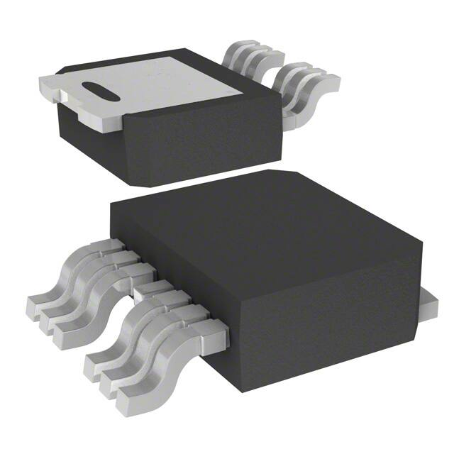

VN5E010MH-E Single-channel high-side driver with analog current sense for automotive applications Features Max supply voltage VCC Operating voltage range VCC 4.5 V to 28 V Typ. ON-state resistance RON 10 m Current limitation (typ) ILIMH 85 A IS 2 µA(1) OFF-state supply current 41 V – Reverse battery protection with self switch on of the Power MOSFET – Electrostatic discharge protection 1. Typical value with all loads connected. ■ ■ ■ General – Inrush current active management by power limitation – Very low standby current – 3 V CMOS compatible inputs – Optimized electromagnetic emissions – Very low electromagnetic susceptibility – In compliance with the 2002/95/EC european directive – Very low current sense leakage Diagnostic functions – Proportional load current sense – High current sense precision for wide current range – Current sense disable – Output short to ground indication – Overload and short to ground (power limitation) indication – Thermal shutdown indication Protections – Undervoltage shutdown – Overvoltage clamp – Load current limitation – Self limiting of fast thermal transients – Protection against loss of ground and loss of VCC – Overtemperature shutdown with autorestart (thermal shutdown) September 2013 Application ■ All types of resistive, inductive and capacitive loads Description The VN5E010MH-E is a single-channel high-side driver manufactured in the ST proprietary VIPower M0-5 technology and housed in the tiny HPAK package. The VN5E010MH-E is designed to drive 12 V automotive grounded loads delivering protection, diagnostics and easy 3 V and 5 V CMOS compatible interface with any microcontroller. The device integrates advanced protective functions such as load current limitation, inrush and overload active management by power limitation, overtemperature shut-off with auto restart and overvoltage active clamp. A dedicated analog current sense pin is associated with every output channel in order to provide enhanced diagnostic functions including fast detection of overload and short-circuit to ground through power limitation indication and overtemperature indication. The current sensing and diagnostic feedback of the whole device can be disabled by pulling the CS_DIS pin high to allow sharing of the external sense resistor with other similar devices. Doc ID 15681 Rev 6 1/34 www.st.com 1 Contents VN5E010MH-E Contents 1 Block diagram and pin configuration . . . . . . . . . . . . . . . . . . . . . . . . . . . 5 2 Electrical specifications . . . . . . . . . . . . . . . . . . . . . . . . . . . . . . . . . . . . . . 7 3 2.1 Absolute maximum ratings . . . . . . . . . . . . . . . . . . . . . . . . . . . . . . . . . . . . . 7 2.2 Thermal data . . . . . . . . . . . . . . . . . . . . . . . . . . . . . . . . . . . . . . . . . . . . . . . 8 2.3 Electrical characteristics . . . . . . . . . . . . . . . . . . . . . . . . . . . . . . . . . . . . . . . 9 2.4 Waveforms . . . . . . . . . . . . . . . . . . . . . . . . . . . . . . . . . . . . . . . . . . . . . . . . 17 2.5 Electrical characteristics curves . . . . . . . . . . . . . . . . . . . . . . . . . . . . . . . . 19 2.6 Application information . . . . . . . . . . . . . . . . . . . . . . . . . . . . . . . . . . . . . . . 22 2.7 Load dump protection . . . . . . . . . . . . . . . . . . . . . . . . . . . . . . . . . . . . . . . . 22 2.8 MCU I/Os protection . . . . . . . . . . . . . . . . . . . . . . . . . . . . . . . . . . . . . . . . . 22 2.9 Current sense and diagnostic . . . . . . . . . . . . . . . . . . . . . . . . . . . . . . . . . . 23 2.10 Maximum demagnetization energy (VCC = 13.5 V) . . . . . . . . . . . . . . . . . 24 Package and PC board thermal data . . . . . . . . . . . . . . . . . . . . . . . . . . . 25 3.1 4 HPAK thermal data . . . . . . . . . . . . . . . . . . . . . . . . . . . . . . . . . . . . . . . . . . 25 Package and packing information . . . . . . . . . . . . . . . . . . . . . . . . . . . . . 28 4.1 ECOPACK® . . . . . . . . . . . . . . . . . . . . . . . . . . . . . . . . . . . . . . . . . . . . . . . 28 4.2 HPAK mechanical data . . . . . . . . . . . . . . . . . . . . . . . . . . . . . . . . . . . . . . . 28 4.3 HPAK suggested land pattern . . . . . . . . . . . . . . . . . . . . . . . . . . . . . . . . . 30 4.4 Packing information . . . . . . . . . . . . . . . . . . . . . . . . . . . . . . . . . . . . . . . . . 31 5 Order codes . . . . . . . . . . . . . . . . . . . . . . . . . . . . . . . . . . . . . . . . . . . . . . . 32 6 Revision history . . . . . . . . . . . . . . . . . . . . . . . . . . . . . . . . . . . . . . . . . . . 33 2/34 Doc ID 15681 Rev 6 VN5E010MH-E List of tables List of tables Table 1. Table 2. Table 3. Table 4. Table 5. Table 6. Table 7. Table 8. Table 9. Table 10. Table 11. Table 12. Table 13. Table 14. Table 15. Table 16. Table 17. Pin functions . . . . . . . . . . . . . . . . . . . . . . . . . . . . . . . . . . . . . . . . . . . . . . . . . . . . . . . . . . . . . 5 Suggested connections for unused and not connected pins . . . . . . . . . . . . . . . . . . . . . . . . 6 Absolute maximum ratings . . . . . . . . . . . . . . . . . . . . . . . . . . . . . . . . . . . . . . . . . . . . . . . . . . 7 Thermal data. . . . . . . . . . . . . . . . . . . . . . . . . . . . . . . . . . . . . . . . . . . . . . . . . . . . . . . . . . . . . 8 Power section . . . . . . . . . . . . . . . . . . . . . . . . . . . . . . . . . . . . . . . . . . . . . . . . . . . . . . . . . . . . 9 Switching (VCC = 13 V, Tj = 25 °C) . . . . . . . . . . . . . . . . . . . . . . . . . . . . . . . . . . . . . . . . . . . 9 Logic inputs. . . . . . . . . . . . . . . . . . . . . . . . . . . . . . . . . . . . . . . . . . . . . . . . . . . . . . . . . . . . . 10 Protection and diagnostics . . . . . . . . . . . . . . . . . . . . . . . . . . . . . . . . . . . . . . . . . . . . . . . . . 10 Current sense (8 V < VCC < 18 V). . . . . . . . . . . . . . . . . . . . . . . . . . . . . . . . . . . . . . . . . . . . 11 Truth table. . . . . . . . . . . . . . . . . . . . . . . . . . . . . . . . . . . . . . . . . . . . . . . . . . . . . . . . . . . . . . 15 Electrical transient requirements (part 1) . . . . . . . . . . . . . . . . . . . . . . . . . . . . . . . . . . . . . . 16 Electrical transient requirements (part 2) . . . . . . . . . . . . . . . . . . . . . . . . . . . . . . . . . . . . . . 16 Electrical transient requirements (part 3) . . . . . . . . . . . . . . . . . . . . . . . . . . . . . . . . . . . . . . 16 Thermal parameter . . . . . . . . . . . . . . . . . . . . . . . . . . . . . . . . . . . . . . . . . . . . . . . . . . . . . . . 27 HPAK mechanical data . . . . . . . . . . . . . . . . . . . . . . . . . . . . . . . . . . . . . . . . . . . . . . . . . . . . 29 Device summary . . . . . . . . . . . . . . . . . . . . . . . . . . . . . . . . . . . . . . . . . . . . . . . . . . . . . . . . . 32 Document revision history . . . . . . . . . . . . . . . . . . . . . . . . . . . . . . . . . . . . . . . . . . . . . . . . . 33 Doc ID 15681 Rev 6 3/34 List of figures VN5E010MH-E List of figures Figure 1. Figure 2. Figure 3. Figure 4. Figure 5. Figure 6. Figure 7. Figure 8. Figure 9. Figure 10. Figure 11. Figure 12. Figure 13. Figure 14. Figure 15. Figure 16. Figure 17. Figure 18. Figure 19. Figure 20. Figure 21. Figure 22. Figure 23. Figure 24. Figure 25. Figure 26. Figure 27. Figure 28. Figure 29. Figure 30. Figure 31. Figure 32. Figure 33. Figure 34. Figure 35. Figure 36. Figure 37. Figure 38. Figure 39. 4/34 Block diagram . . . . . . . . . . . . . . . . . . . . . . . . . . . . . . . . . . . . . . . . . . . . . . . . . . . . . . . . . . . . 5 Configuration diagram (top view) not in scale. . . . . . . . . . . . . . . . . . . . . . . . . . . . . . . . . . . . 6 Current and voltage conventions . . . . . . . . . . . . . . . . . . . . . . . . . . . . . . . . . . . . . . . . . . . . . 7 Current sense delay characteristics . . . . . . . . . . . . . . . . . . . . . . . . . . . . . . . . . . . . . . . . . . 12 Switching characteristics . . . . . . . . . . . . . . . . . . . . . . . . . . . . . . . . . . . . . . . . . . . . . . . . . . 13 Delay response time between rising edge of ouput current and rising edge of current sense (CS enabled). . . . . . . . . . . . . . . . . . . . . . . . . . . . . . . . . . . . . . . . . . . . . . . . . . . . . . . . . . . . 13 Output voltage drop limitation . . . . . . . . . . . . . . . . . . . . . . . . . . . . . . . . . . . . . . . . . . . . . . . 14 IOUT/ISENSE vs. IOUT . . . . . . . . . . . . . . . . . . . . . . . . . . . . . . . . . . . . . . . . . . . . . . . . . . . . . 14 Maximum current sense ratio drift vs. load current(1) . . . . . . . . . . . . . . . . . . . . . . . . . . . . . 15 Normal operation . . . . . . . . . . . . . . . . . . . . . . . . . . . . . . . . . . . . . . . . . . . . . . . . . . . . . . . . 17 Overload or short to GND . . . . . . . . . . . . . . . . . . . . . . . . . . . . . . . . . . . . . . . . . . . . . . . . . . 17 Intermittent overload . . . . . . . . . . . . . . . . . . . . . . . . . . . . . . . . . . . . . . . . . . . . . . . . . . . . . . 18 TJ evolution in overload or short to GND . . . . . . . . . . . . . . . . . . . . . . . . . . . . . . . . . . . . . . 18 OFF-state output current . . . . . . . . . . . . . . . . . . . . . . . . . . . . . . . . . . . . . . . . . . . . . . . . . . 19 High-level input current . . . . . . . . . . . . . . . . . . . . . . . . . . . . . . . . . . . . . . . . . . . . . . . . . . . . 19 Input clamp voltage. . . . . . . . . . . . . . . . . . . . . . . . . . . . . . . . . . . . . . . . . . . . . . . . . . . . . . . 19 Low-level input voltage . . . . . . . . . . . . . . . . . . . . . . . . . . . . . . . . . . . . . . . . . . . . . . . . . . . . 19 High-level input voltage . . . . . . . . . . . . . . . . . . . . . . . . . . . . . . . . . . . . . . . . . . . . . . . . . . . 19 Input hysteresis voltage . . . . . . . . . . . . . . . . . . . . . . . . . . . . . . . . . . . . . . . . . . . . . . . . . . . 19 ON-state resistance vs. Tcase . . . . . . . . . . . . . . . . . . . . . . . . . . . . . . . . . . . . . . . . . . . . . . . 20 ON-state resistance vs. VCC . . . . . . . . . . . . . . . . . . . . . . . . . . . . . . . . . . . . . . . . . . . . . . . . 20 Undervoltage shutdown . . . . . . . . . . . . . . . . . . . . . . . . . . . . . . . . . . . . . . . . . . . . . . . . . . . 20 Turn-on voltage slope . . . . . . . . . . . . . . . . . . . . . . . . . . . . . . . . . . . . . . . . . . . . . . . . . . . . . 20 ILIMH vs. Tcase . . . . . . . . . . . . . . . . . . . . . . . . . . . . . . . . . . . . . . . . . . . . . . . . . . . . . . . . . 20 Turn-off voltage slope . . . . . . . . . . . . . . . . . . . . . . . . . . . . . . . . . . . . . . . . . . . . . . . . . . . . . 20 High-level CS_DIS voltage . . . . . . . . . . . . . . . . . . . . . . . . . . . . . . . . . . . . . . . . . . . . . . . . . 21 CS_DIS clamp voltage . . . . . . . . . . . . . . . . . . . . . . . . . . . . . . . . . . . . . . . . . . . . . . . . . . . . 21 Low-level CS_DIS voltage . . . . . . . . . . . . . . . . . . . . . . . . . . . . . . . . . . . . . . . . . . . . . . . . . 21 Application schematic . . . . . . . . . . . . . . . . . . . . . . . . . . . . . . . . . . . . . . . . . . . . . . . . . . . . . 22 Current sense and diagnostic . . . . . . . . . . . . . . . . . . . . . . . . . . . . . . . . . . . . . . . . . . . . . . . 23 Maximum turn-off current versus inductance(1) . . . . . . . . . . . . . . . . . . . . . . . . . . . . . . . . . 24 PC board(1) . . . . . . . . . . . . . . . . . . . . . . . . . . . . . . . . . . . . . . . . . . . . . . . . . . . . . . . . . . . . . 25 Rthj-amb vs. PCB copper area in open box free air condition . . . . . . . . . . . . . . . . . . . . . . 25 HPAK thermal impedance junction ambient single pulse . . . . . . . . . . . . . . . . . . . . . . . . . . 26 Thermal fitting model of a single-channel HSD in HPAK(1) . . . . . . . . . . . . . . . . . . . . . . . . 26 HPAK package dimension . . . . . . . . . . . . . . . . . . . . . . . . . . . . . . . . . . . . . . . . . . . . . . . . . 28 HPAK suggested pad layout(1) . . . . . . . . . . . . . . . . . . . . . . . . . . . . . . . . . . . . . . . . . . . . . . 30 HPAK tube shipment (no suffix) . . . . . . . . . . . . . . . . . . . . . . . . . . . . . . . . . . . . . . . . . . . . . 31 HPAK tape and reel (suffix “TR”) . . . . . . . . . . . . . . . . . . . . . . . . . . . . . . . . . . . . . . . . . . . . 31 Doc ID 15681 Rev 6 VN5E010MH-E 1 Block diagram and pin configuration Block diagram and pin configuration Figure 1. Block diagram Table 1. Pin functions Name Function VCC Battery connection OUT Power output (1) GND Ground connection IN Voltage controlled input pin with hysteresis, CMOS compatible. Controls output switch state CS Analog current sense pin, delivers a current proportional to the load current CS_DIS Active high CMOS compatible pin, to disable the current sense pin 1. Pins 1 and 7 must be externally tied together. Doc ID 15681 Rev 6 5/34 Block diagram and pin configuration Figure 2. Table 2. 6/34 VN5E010MH-E Configuration diagram (top view) not in scale 1 2 3 4 OUT GND IN Vcc 5 6 7 CS CS_DIS OUT Suggested connections for unused and not connected pins Connection / pin CS OUT IN CS_DIS Floating Not allowed X X X To ground Through 1k resistor Through 22 k resistor Through 10 k resistor Through 10 k resistor Doc ID 15681 Rev 6 VN5E010MH-E 2 Electrical specifications Electrical specifications Figure 3. Current and voltage conventions IS VCC IOUT ICSD VCSD VCC CS_DIS OUT IN CS ISENSE IIN VIN VOUT VSENSE GND IGND 2.1 Absolute maximum ratings Stressing the device above the rating listed in the Table 3: Absolute maximum ratings may cause permanent damage to the device. These are stress ratings only and operation of the device at these or any other conditions above those indicated in the operating sections of this specification is not implied. Exposure to absolute maximum rating conditions for extended periods may affect device reliability. Refer also to the STMicroelectronics SURE program and other relevant quality document. Table 3. Absolute maximum ratings Symbol Parameter Value Unit VCC DC supply voltage 41 V -VCC Reverse DC supply voltage 16 V IOUT DC output current Internally limited A -IOUT Reverse DC output current 20 A DC input current -1 to 10 mA DC current sense disable input current -1 to 10 mA VCC - 41 +VCC V V 645 mJ IIN ICSD VCSENSE Current sense maximum voltage (VCC > 0) EMAX Maximum switching energy (single pulse) (L = 2.2 mH; RL = 0; VBAT = 13.5 V; Tjstart = 150 °C; IOUT = IlimL(Typ.)) Doc ID 15681 Rev 6 7/34 Electrical specifications Table 3. VN5E010MH-E Absolute maximum ratings (continued) Symbol Value Unit VESD Electrostatic discharge (human body model: R= 1.5 K C= 100 pF) – IN – CS – CS_DIS – OUT – VCC 4000 2000 4000 5000 5000 V V V V V VESD Charge device model (CDM-AEC-Q100-011) 750 V Junction operating temperature -40 to 150 °C Storage temperature -55 to 150 °C Tj Tstg 2.2 Thermal data Table 4. Symbol 8/34 Parameter Thermal data Parameter Max. value Unit Rthj-case Thermal resistance junction-case 0.55 °C/W Rthj-amb Thermal resistance junction-ambient 67.7 °C/W Doc ID 15681 Rev 6 VN5E010MH-E 2.3 Electrical specifications Electrical characteristics Values specified in this section are for 8 V < VCC < 28 V, -40 °C < Tj < 150 °C, unless otherwise specified. Table 5. Power section Symbol Parameter Test conditions Min. Typ. Max. Unit VCC Operating supply voltage 4.5 13 28 V VUSD Undervoltage shutdown 3.5 4.5 V VUSDhyst Undervoltage shutdown hysteresis 0.5 IOUT = 6 A; Tj = 25 °C RON RON-Rev Vclamp IS IL(off) ON-state resistance 10 IOUT = 6 A; Tj = 150 °C 20 IOUT = 6 A; VCC = 5 V; Tj = 25 °C 13 RDSON in reverse battery condition VCC = -13 V; IOUT = -6 A; Tj = 25 °C Clamp voltage ICC = 20 mA; IOUT = 0 A 10 41 ON-state: VCC = 13 V; VIN = 5 V; IOUT = 0 A OFF-state output current Table 6. m m 46 52 V 2 5 µA 1.5 3 mA 0.01 3 µA OFF-state: VCC = 13 V; Tj = 25 °C; VIN = VOUT = VSENSE = 0 V Supply current V VIN = VOUT = 0 V; VCC = 13 V; Tj = 25 °C 0 VIN = VOUT = 0 V; VCC = 13 V; Tj = 125 °C 0 5 Min. Typ. Max. Unit Switching (VCC = 13 V, Tj = 25 °C) Symbol Parameter Test conditions td(on) Turn-on delay time RL = 2.2  (see Figure 5) - 40 - µs td(off) Turn-off delay time RL = 2.2  (see Figure 5) - 28 - µs (dVOUT/dt)on Turn-on voltage slope RL = 2.2  - (see Figure 23) - Vµs (dVOUT/dt)off Turn-off voltage slope RL = 2.2  - (see Figure 25) - Vµs WON Switching energy losses at turn-on (twon) RL = 2.2  (see Figure 5) - 2 - mJ WOFF Switching energy losses at turn-off (twoff) RL = 2.2  (see Figure 5) - 0.6 - mJ Doc ID 15681 Rev 6 9/34 Electrical specifications Table 7. Symbol VN5E010MH-E Logic inputs Parameter Test conditions VIL Low-level input voltage IIL Low-level input current VIH High-level input voltage IIH High-level input current VI(hyst) Input hysteresis voltage VICL Min. VIN = 0.9 V Low-level CS_DIS voltage ICSDL Low-level CS_DIS current VCSDH High-level CS_DIS voltage ICSDH High-level CS_DIS current a Table 8. Symbol CS_DIS clamp voltage V 7 V -0.7 µA 2.1 V VCSD = 2.1 V 10 0.25 ICSD = 1 mA V 1 µA V 5.5 7 V ICSD = -1 mA -0.7 Protection and diagnostics(1) Parameter Test conditions VCC = 13 V Short-circuit current VCC = 13 V; TR < Tj < TTSD during thermal cycling TTSD Shutdown temperature Min. Typ. Max. 60 85 120 TR Reset temperature TRS Thermal reset of status Turn-off output voltage IOUT = 2 A; VIN = 0; clamp L = 6 mH Output voltage drop limitation 120 21 150 175 TRS + 1 TRS + 5 A 200 135 Thermal hysteresis (TTSD-TR) IOUT = 0.5 A; Tj = -40 °C to 150 °C Doc ID 15681 Rev 6 Unit A 5 V < VCC < 28 V °C °C °C 7 °C VCC - 41 VCC - 46 VCC - 52 V 25 mV 1. To ensure long term reliability under heavy overload or short-circuit conditions, protection and related diagnostic signals must be used together with a proper software strategy. If the device is subjected to abnormal conditions, this software must limit the duration and number of activation cycles. 10/34 µA V 5.5 VCSD = 0.9 V IlimL VON 2.1 0.9 Short-circuit current VDEMAG V 0.25 IlimH THYST 0.9 10 VCSD(hyst) CS_DIS hysteresis voltage VCSCL Unit µA IIN = -1 mA VCSDL Max. 1 VIN = 2.1 V IIN = 1 mA Input clamp voltage Typ. VN5E010MH-E Electrical specifications Table 9. Symbol Current sense (8 V < VCC < 18 V) Parameter Test conditions Min. Typ. Max. K0 IOUT/ISENSE IOUT = 0.25 A; VSENSE = 0.5 V Tj = -40 °C to 150 °C Tj = 25 °C to 150 °C 3000 3000 7410 12000 7410 11600 K1 IOUT/ISENSE IOUT = 6 A; VSENSE = 0.5 V Tj = -40 °C to 150 °C Tj = 25 °C to 150 °C 5350 5510 6740 6740 dK1/K1(1) K2 dK2/K2(1) K3 dK3/K3(1) ISENSE0 IOUT = 6 A; VSENSE = 0.5 V; Current sense ratio drift VCSD = 0 V; Tj = -40 °C to 150 °C IOUT = 10 A; VSENSE = 4 V Tj = -40 °C to 150 °C Tj = 25 °C to 150 °C IOUT/ISENSE IOUT = 10 A; VSENSE = 4 V; Current sense ratio drift VCSD = 0 V; Tj = -40 °C to 150 °C IOUT = 25 A; VSENSE = 4 V Tj = -40 °C to 150 °C Tj = 25 °C to 150 °C IOUT/ISENSE IOUT = 25 A; VSENSE = 4 V; Current sense ratio drift VCSD = 0 V; Tj = -40 °C to 150 °C Analog sense leakage current -15 5850 5800 -11 5915 5850 6420 6420 VSENSE % 7690 7195 11 % 7000 6755 -8 8 IOUT = 0 A; VSENSE = 0 V; VCSD = 5 V; VIN = 0 V; Tj = -40 °C to 150 °C 0 1 IOUT = 0 A; VSENSE = 0 V; VCSD = 0 V; VIN= 5 V; Tj = -40 °C to 150 °C 0 2 IOUT = 2 A; VSENSE = 0 V; VCSD = 5 V; VIN = 5 V; Tj = -40 °C to 150 °C IOL 8500 7745 15 6570 6570 Unit % µA 1 Open load ON-state current detection threshold VIN = 5 V, 8 V < VCC < 18 V ISENSE = 5 µA 5 Max analog sense output voltage IOUT = 18 A; RSENSE = 3.9 k 5 80 mA V VSENSEH(2) Analog sense output V = 13 V; RSENSE = 3.9 k voltage in fault condition CC 8 V ISENSEH(2) Analog sense output V = 13 V; VSENSE = 5 V current in fault condition CC 9 mA Doc ID 15681 Rev 6 11/34 Electrical specifications Table 9. VN5E010MH-E Current sense (8 V < VCC < 18 V) (continued) Symbol Parameter Test conditions Min. Typ. Max. Unit tDSENSE1H Delay response time from falling edge of CS_DIS pin VSENSE < 4 V, 1.5 A < IOUT < 25 A ISENSE = 90% of ISENSE MAX (see Figure 4) 50 100 µs tDSENSE1L Delay response time from rising edge of CS_DIS pin VSENSE < 4 V, 1.5 A Power Limitation Thermal cycling ILimL > IOUT VSENSE VCS_DIS Doc ID 15681 Rev 6 17/34 Electrical specifications VN5E010MH-E Figure 12. Intermittent overload INPUT Overload ILimH > ILimL > Nominal load IOUT VSENSEH> VSENSE VCS_DIS Figure 13. TJ evolution in overload or short to GND INPUT Self-limitation of fast thermal transients TTSD THYST TR TJ_START TJ ILimH > Power Limitation < ILimL IOUT 18/34 Doc ID 15681 Rev 6 VN5E010MH-E 2.5 Electrical specifications Electrical characteristics curves Figure 14. OFF-state output current Figure 15. High-level input current Iih [uA] Iloff [nA] 5 6000 4.5 5000 Vin= 2.1V 4 3.5 4000 3 2.5 3000 2 2000 1.5 1 1000 0.5 0 -50 -25 0 25 50 75 100 125 150 175 0 -50 -25 0 25 Tc [°C] 125 150 175 Vil [V] 7 2 6.8 1.8 1.6 Iin= 1m A 6.4 1.4 6.2 1.2 6 1 5.8 0.8 5.6 0.6 5.4 0.4 5.2 0.2 -25 0 25 50 75 100 125 150 175 0 -50 -25 0 25 50 75 100 125 150 175 Tc [°C] Tc [°C] Figure 18. High-level input voltage Figure 19. Input hysteresis voltage Vihyst [V] Vih [V] 1 4 0.9 3.5 0.8 3 0.7 2.5 0.6 2 0.5 1.5 0.4 0.3 1 0.2 0.5 0 -50 100 Figure 17. Low-level input voltage Vicl [V] 5 -50 75 Tc [°C] Figure 16. Input clamp voltage 6.6 50 0.1 -25 0 25 50 75 100 125 150 175 0 -50 Tc [°C] -25 0 25 50 75 100 125 150 175 Tc [°C] Doc ID 15681 Rev 6 19/34 Electrical specifications VN5E010MH-E Figure 20. ON-state resistance vs. Tcase Figure 21. ON-state resistance vs. VCC Ron [m Ohm ] Ron [m Ohm ] 80 30 70 25 60 50 20 Iout= 6A Vcc= 13V 40 30 Tc= 150°C 15 Tc= 125°C 10 Tc= 25°C 20 0 -50 Tc= -40°C 5 10 0 -25 0 25 50 75 100 125 150 175 0 5 10 15 Tc [°C] 20 25 30 35 40 Vcc [V] Figure 22. Undervoltage shutdown Figure 23. Turn-on voltage slope (dVout/dt)On [V/m s] Vusd [V] 1000 16 900 14 800 12 Vcc= 13V Rl= 13Ω 700 10 600 8 500 400 6 300 4 200 2 0 -50 100 -25 0 25 50 75 100 125 150 175 0 -50 -25 0 25 50 75 100 125 150 175 Tc [°C] Tc [°C] Figure 24. ILIMH vs. Tcase Figure 25. Turn-off voltage slope Ilim h [A] (dVout/dt)Off [V/m s] 100 1000 900 Vcc= 13V 90 800 Vcc= 13V Rl= 13Ω 700 80 600 70 500 400 60 300 50 200 100 40 -50 -25 0 25 50 75 Tc [°C] 20/34 100 125 150 175 0 -50 -25 0 25 50 75 Tc [°C] Doc ID 15681 Rev 6 100 125 150 175 VN5E010MH-E Electrical specifications Figure 26. High-level CS_DIS voltage Figure 27. CS_DIS clamp voltage Vcsdh [V] Vcsdcl [V] 4 10 3.5 9 Iin= 1m A 8 3 7 2.5 6 2 5 1.5 4 3 1 2 0.5 0 -50 1 -25 0 25 50 75 100 125 150 175 0 -50 Tc [°C] -25 0 25 50 75 100 125 150 175 Tc [°C] Figure 28. Low-level CS_DIS voltage Vcsdl [V] 4 3.5 3 2.5 2 1.5 1 0.5 0 -50 -25 0 25 50 75 100 125 150 175 Tc [°C] Doc ID 15681 Rev 6 21/34 Electrical specifications 2.6 VN5E010MH-E Application information Figure 29. Application schematic +5V VCC 20V Rprot CS_DIS Dld MCU Rprot IN OUT CS Rprot 45V RSENSE GND Cext 2.7 Load dump protection Dld is necessary (voltage transient suppressor) if the load dump peak voltage exceeds the VCC max DC rating. The same applies if the device is subject to transients on the VCC line that are greater than the ones shown in the ISO 7637-2 2004 (E) table. 2.8 MCU I/Os protection When negative transients are present on the VCC line, the control pins are pulled negative to approximatly -1.5 V. ST suggests to insert a resistor (Rprot) in line to prevent the microcontroller I/Os pins to latch-up. The value of these resistors is a compromise between the leakage current of microcontroller and the current required by the HSD I/Os (input levels compatibility) with the latch-up limit of microcontroller I/Os. Equation 1 -VCCpeak / Ilatchup  Rprot  (VOHC - VIH ) / IIHmax Calculation example: For VCCpeak = - 1.5 V; Ilatchup  20 mA; VOHC  4.5 V 75   Rprot  240 k. Recommended values: Rprot =10 kCEXT = 10 nF. 22/34 Doc ID 15681 Rev 6 VN5E010MH-E 2.9 Electrical specifications Current sense and diagnostic The current sense pin performs a double function (see Figure 30: Current sense and diagnostic): ● Current mirror of the load current in normal operation, delivering a current proportional to the load one according to a know ratio KX. The current ISENSE can be easily converted to a voltage VSENSE by means of an external resistor RSENSE. Linearity between IOUT and VSENSE is ensured up to 5 V minimum (see parameter VSENSE in Table 9: Current sense (8 V < VCC < 18 V)). The current sense accuracy depends on the output current (refer to current sense electrical characteristics Table 9: Current sense (8 V < VCC < 18 V)). ● Diagnostic flag in fault conditions, delivering a fixed voltage VSENSEH up to a maximum current ISENSEH in case of the following fault conditions (refer to Table 10: Truth table): – Power limitation activation – Overtemperature A logic level high on CS_DIS pin sets at the same time all the current sense pins of the device in a high-impedance state, thus disabling the current monitoring and diagnostic detection. This feature allows multiplexing of the microcontroller analog inputs by sharing of sense resistance and ADC line among different devices. Figure 30. Current sense and diagnostic VBAT VCC Main MOSn 41V Overtemperature IOUT/KX ISENSEH Pwr_Lim OUTn VSENSEH CS_DIS CURRENT SENSEn GND Load RPROT To uC ADC RSENSE VSENSE Doc ID 15681 Rev 6 23/34 Electrical specifications 2.10 VN5E010MH-E Maximum demagnetization energy (VCC = 13.5 V) Figure 31. Maximum turn-off current versus inductance(1) 100 A B C I (A) 10 1 0,1 1 L (mH) 10 100 A: Tjstart = 150 °C (single pulse) B: Tjstart = 100 °C (repetitive pulse) C: Tjstart = 125 °C (repetitive pulse) VIN, IL Demagnetization Demagnetization Demagnetization t 1. Values are generated with RL = 0  In case of repetitive pulses, Tjstart (at beginning of each demagnetization) of every pulse must not exceed the temperature specified above for curves A and B. 24/34 Doc ID 15681 Rev 6 VN5E010MH-E Package and PC board thermal data 3 Package and PC board thermal data 3.1 HPAK thermal data Figure 32. PC board(1) 1. Layout condition of Rth and Zth measurements (PCB FR4 area = 58 mm x 58 mm, PCB thickness =1.8 mm, Cu thickness = 70 µm, Copper areas: from minimum pad lay-out to 8 cm2). Figure 33. Rthj-amb vs. PCB copper area in open box free air condition RTHj_amb(°C/W) 70 65 60 55 50 45 40 35 30 0 2 4 6 8 10 PCB Cu heatsink area (cm^2) Doc ID 15681 Rev 6 25/34 Package and PC board thermal data VN5E010MH-E Figure 34. HPAK thermal impedance junction ambient single pulse ZTH (°C/W) 100 Cu=8 cm2 Cu=2 cm2 Cu=foot print 10 1 0.1 0.001 0.01 0.1 1 Time (s) 10 100 Figure 35. Thermal fitting model of a single-channel HSD in HPAK(1) 1. The fitting model is a simplified thermal tool and is valid for transient evolutions where the embedded protections (power limitation or thermal cycling during thermal shutdown) are not triggered. Equation 2: pulse calculation formula Z TH = R TH   + Z THtp  1 –   where  = tP/T 26/34 Doc ID 15681 Rev 6 1000 VN5E010MH-E Package and PC board thermal data Table 14. Thermal parameter Area/island (cm2) Footprint R1 (°C/W) 0.01 R2 (°C/W) 0.15 R3 (°C/W) 0.5 R4 (°C/W) 8 R5 (°C/W) 4 8 28 22 12 R6 (°C/W) 31 25 16 C1 (W.s/°C) 0.005 C2 (W.s/°C) 0.05 C3 (W.s/°C) 0.1 C4 (W.s/°C) 0.4 C5 (W.s/°C) 0.8 1.4 3 C6 (W.s/°C) 3 6 9 Doc ID 15681 Rev 6 27/34 Package and packing information VN5E010MH-E 4 Package and packing information 4.1 ECOPACK® In order to meet environmental requirements, ST offers these devices in different grades of ECOPACK® packages, depending on their level of environmental compliance. ECOPACK® specifications, grade definitions and product status are available at: www.st.com. ECOPACK® is an ST trademark. 4.2 HPAK mechanical data Figure 36. HPAK package dimension 28/34 Doc ID 15681 Rev 6 VN5E010MH-E Package and packing information Table 15. HPAK mechanical data Data book mm Ref. dim Nom. Min. Max. A 2.20 2.40 A1 0.90 1.10 A2 0.03 0.23 b 0.45 0.60 b4 5.20 5.40 c 0.45 0.60 c2 0.48 0.60 D 6.00 6.20 6.40 6.60 e1 1.60 1.80 e2 3.30 3.50 e3 5.00 5.20 H 9.35 10.10 L 1 D1 5.10 E E1 5.20 e 0.85 (L1) 2.80 L2 0.80 L4 R 0.60 1.00 0° 8° 0.20 V2 Doc ID 15681 Rev 6 29/34 Package and packing information 4.3 VN5E010MH-E HPAK suggested land pattern Figure 37. HPAK suggested pad layout(1) All dimensions are in mm. 1. The land pattern proposed is not intended to overrule User's PCB design, manufacturing and soldering process rules 30/34 Doc ID 15681 Rev 6 VN5E010MH-E 4.4 Package and packing information Packing information The devices can be packed in tube or tape and reel shipments (see Table 16: Device summary). Figure 38. HPAK tube shipment (no suffix) A Base q.ty Bulk q.ty Tube length (± 0.5) A B C (± 0.1) C B 75 3000 532 6 21.3 0.6 All dimensions are in mm. Figure 39. HPAK tape and reel (suffix “TR”) REEL DIMENSIONS All dimensions are in mm. Base q.ty Bulk q.ty A (max) B (min) C (± 0.2) F G (+ 2 / -0) N (min) T (max) 2500 2500 330 1.5 13 20.2 16.4 60 22.4 TAPE DIMENSIONS According to Electronic Industries Association (EIA) Standard 481 rev. A, Feb 1986 Tape width Tape hole spacing Component spacing Hole diameter Hole diameter Hole position Compartment depth Hole spacing W P0 (± 0.1) P D (± 0.1/-0) D1 (min) F (± 0.05) K (max) P1 (± 0.1) All dimensions are in mm. 16 4 8 1.5 1.5 7.5 2.75 2 End Start Top cover tape No components Components No components 500mm min Empty components pockets saled with cover tape. 500mm min User direction of feed Doc ID 15681 Rev 6 31/34 Order codes 5 VN5E010MH-E Order codes Table 16. Device summary Order codes Package 6 pins HPAK 32/34 Tube Tape and reel VN5E010MH-E VN5E010MHTR-E Doc ID 15681 Rev 6 VN5E010MH-E 6 Revision history Revision history Table 17. Document revision history Date Revision Changes 28-May-2009 1 Initial release. 18-Jun-2009 2 Figure 32: PC board(1) – Changed footnote 15-Dec-2009 3 Updated Table 7: Logic inputs 25-Jan-2010 4 Updated Table 9: Current sense (8 V < VCC < 18 V) 27-May-2010 5 Updated Table 15: HPAK mechanical data. 18-Sep-2013 6 Updated Disclaimer. Doc ID 15681 Rev 6 33/34 VN5E010MH-E Please Read Carefully: Information in this document is provided solely in connection with ST products. STMicroelectronics NV and its subsidiaries (“ST”) reserve the right to make changes, corrections, modifications or improvements, to this document, and the products and services described herein at any time, without notice. All ST products are sold pursuant to ST’s terms and conditions of sale. Purchasers are solely responsible for the choice, selection and use of the ST products and services described herein, and ST assumes no liability whatsoever relating to the choice, selection or use of the ST products and services described herein. No license, express or implied, by estoppel or otherwise, to any intellectual property rights is granted under this document. If any part of this document refers to any third party products or services it shall not be deemed a license grant by ST for the use of such third party products or services, or any intellectual property contained therein or considered as a warranty covering the use in any manner whatsoever of such third party products or services or any intellectual property contained therein. UNLESS OTHERWISE SET FORTH IN ST’S TERMS AND CONDITIONS OF SALE ST DISCLAIMS ANY EXPRESS OR IMPLIED WARRANTY WITH RESPECT TO THE USE AND/OR SALE OF ST PRODUCTS INCLUDING WITHOUT LIMITATION IMPLIED WARRANTIES OF MERCHANTABILITY, FITNESS FOR A PARTICULAR PURPOSE (AND THEIR EQUIVALENTS UNDER THE LAWS OF ANY JURISDICTION), OR INFRINGEMENT OF ANY PATENT, COPYRIGHT OR OTHER INTELLECTUAL PROPERTY RIGHT. ST PRODUCTS ARE NOT DESIGNED OR AUTHORIZED FOR USE IN: (A) SAFETY CRITICAL APPLICATIONS SUCH AS LIFE SUPPORTING, ACTIVE IMPLANTED DEVICES OR SYSTEMS WITH PRODUCT FUNCTIONAL SAFETY REQUIREMENTS; (B) AERONAUTIC APPLICATIONS; (C) AUTOMOTIVE APPLICATIONS OR ENVIRONMENTS, AND/OR (D) AEROSPACE APPLICATIONS OR ENVIRONMENTS. WHERE ST PRODUCTS ARE NOT DESIGNED FOR SUCH USE, THE PURCHASER SHALL USE PRODUCTS AT PURCHASER’S SOLE RISK, EVEN IF ST HAS BEEN INFORMED IN WRITING OF SUCH USAGE, UNLESS A PRODUCT IS EXPRESSLY DESIGNATED BY ST AS BEING INTENDED FOR “AUTOMOTIVE, AUTOMOTIVE SAFETY OR MEDICAL” INDUSTRY DOMAINS ACCORDING TO ST PRODUCT DESIGN SPECIFICATIONS. PRODUCTS FORMALLY ESCC, QML OR JAN QUALIFIED ARE DEEMED SUITABLE FOR USE IN AEROSPACE BY THE CORRESPONDING GOVERNMENTAL AGENCY. Resale of ST products with provisions different from the statements and/or technical features set forth in this document shall immediately void any warranty granted by ST for the ST product or service described herein and shall not create or extend in any manner whatsoever, any liability of ST. ST and the ST logo are trademarks or registered trademarks of ST in various countries. Information in this document supersedes and replaces all information previously supplied. The ST logo is a registered trademark of STMicroelectronics. All other names are the property of their respective owners. © 2013 STMicroelectronics - All rights reserved STMicroelectronics group of companies Australia - Belgium - Brazil - Canada - China - Czech Republic - Finland - France - Germany - Hong Kong - India - Israel - Italy - Japan Malaysia - Malta - Morocco - Philippines - Singapore - Spain - Sweden - Switzerland - United Kingdom - United States of America www.st.com 34/34 Doc ID 15681 Rev 6
