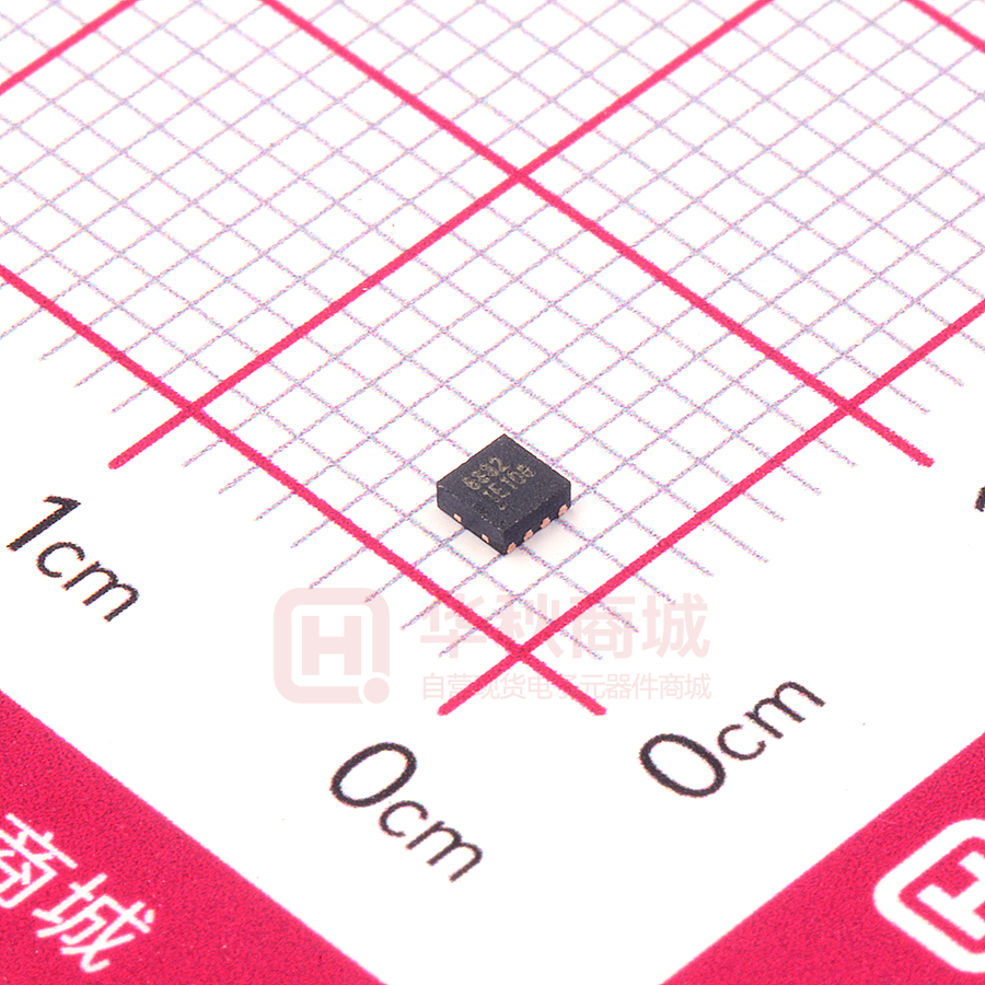

    通用放大器 TDFN8L_2X2MM_EP 2通道 1.1MHz 500mV/µs
RS6332XTDE8 数据手册
RS6331S, RS6332S RS6331, RS6332, RS6334 1.1MHz, Rail-to-Rail I/O CMOS Operational Amplifier FEATURES DESCRIPTION • • HIGH GAIN BANDWIDTH:1.1MHz RAIL-TO-RAIL INPUT AND OUTPUT 0.6mV Typical Vos • • INPUT VOLTAGE RANGE: -0.1V to +5.6V with Vs = 5.5V SUPPLY RANGE: +2.5V to +5.5V • SHUTDOWN: RS6331S/RS6332S • • SPECIFIED UP TO +125°C MicroSIZE PACKAGES: SOT23-5, SOT23-6 The RS6331, RS6332, RS6334, RS6331S, RS6332S families of products offer low voltage operation and rail-to-rail input and output, as well as excellent speed/power consumption ratio, providing an excellent bandwidth (1.1MHz) and slew rate of 0.5V/us. The op-amps are unity gain stable and feature an ultra-low input bias current. The devices are ideal for sensor interfaces, active filters and portable applications. The RS6331S, RS6332S include a shutdown mode. Under logic control, the amplifiers can be switched from normal operation to a standby current that is less than 1uA.The RS6331, RS6332, RS6334, RS6331S, RS6332S families of operational amplifiers are specified at the full temperature range of −40°C to +125°C under single or dual power supplies of 2.5V to 5.5V. APPLICATIONS • SENSORS • PHOTODIODE AMPLIFICATION • ACTIVE FILTERS • TEST EQUIPMENT • DRIVING A/D CONVERTERS PIN CONFIGURATIONS -IN 2 4 -IN +IN 3 V- 4 N.C. 7 V+ 6 OUT 5 N.C. SOT23-5 V- 2 3 5 SOT23-6 REV B.6 -IN B 3 +IN B V- 4 5 En A 5 - A B NC EN OUT A 1 7 V+ -IN A 2 6 OUT +IN A 5 NC 8 1 -IN 2 +IN 3 V- 4 4 V+ SOIC-8(SOP8) EN -IN Note: N.C. indicates no internal connection V+ - + D + - 3 5 -IN B 6 7 14 OUT D 13 -IN D 12 4 +IN B OUT B A 11 - + B + C V+ 9 OUT B - 8 -IN B 7 +IN B 6 En B 1 V+ 2 +IN B 3 16 15 14 13 RS6334 12 +IN D 11 V- 10 +IN C 9 -IN C V- +IN C 9 -IN C TQFN3x3-16L -IN B SOIC-14(SOP14),TSSOP-14 1 +IN A +IN D 10 8 10 MSOP-10 4 5 6 7 8 OUT B +IN 6 - 2 -IN D OUT + 4 + -IN A +IN A RS6334 - - RS6331S 1 OUTB 7 6 B+ 4 RS6331S SOT23-5 OUT V- 3 A -IN A 3 +IN A + 1 V+ OUT A 2 2 V+ + V- - IN -IN A OUT A 8 SOIC-8(SOP8),MSOP-8, TSSOP-8,TDFN2x2-8L,TDFN3x3-8L 5 1 1 SOIC-8(SOP8),MSOP-8 RS6331B + IN OUT A OUT D - 8 N.C. + 1 OUT C 3 N.C. N.C. 2 V+ + V+IN 5 - 1 + OUT RS6332S RS6332 RS6331 + RS6331 OUT C www.run-ic.com RS6331S, RS6332S RS6331, RS6332, RS6334 ABSOLUTE MAXIMUM RATINGS (1) Supply Voltage, V+ to V-...............................................7.0V Input Terminals, Voltage (2) …………... – 0.5 to (V+) + 0.5V Current (2)…………………....…..... ±10mA Storage Temperature ……….…………… −65°C to +150°C Operating Temperature ……….………… −40°C to +125°C Junction Temperature................................................150°C Package Thermal Resistance @ TA = +25°C SOT23-5, SOT23-6………………….………………200°C/W MSOP-10, SOIC-8, TSSOP-8.……….…………... 150°C/W SOIC-14, TSSOP-14………….……….……………100°C/W Lead Temperature (Soldering, 10s) ……………........260°C ESD Susceptibility HBM …......................................................................5000V MM ……………………….........………………...……….400V ESD SENSITIVITY CAUTION ESD damage can range from subtle performance degradation to complete device failure. Precision integrated circuits may be more susceptible to damage because very small parametric changes could cause the device not to meet its published specifications. (1) Stresses above these ratings may cause permanent damage. Exposure to absolute maximum conditions for extended periods may degrade device reliability. These are stress ratings only, and functional operation of the device at these or any other conditions beyond those specified is not implied. (2) Input terminals are diode-clamped to the power-supply rails. Input signals that can swing more than 0.5V beyond the supply rails should be current-limited to 10mA or less. PACKAGE/ORDERING INFORMATION 2 www.run-ic.com RS6331S, RS6332S RS6331, RS6332, RS6334 ELECTRICAL CHARACTERISTICS (At TA = +25C, Vs=5V, RL = 10kΩ connected to VS/2, and VOUT = VS/2, unless otherwise noted.) PARAMETER CONDITIONS TJ RS6331S, RS6332S, RS6331, RS6332, RS6334 MIN TYP MAX UNIT POWER SUPPLY Vs Operating Voltage Range 25C IQ Quiescent Current/Amplifier 25C PSRR Power-Supply Rejection Ratio Vs=2.5V to 5.5V, Vcm=(V-)+0.5V 2.5 58 25C 72 -40C to 125C 65 5.5 V 80 uA 90 dB INPUT Vos IB Input Offset Voltage Input Offset Voltage Average Drift Input Bias Current Ios Input Offset Current Vos TC Vcm Common-Mode Voltage Range 3 2 -40C to 125C Vs= 5.5V Vs= 5.5V, Vcm =-0.1V to 4V CMRR 0.6 25C Common-Mode Rejection Ratio Vs= 5.5V, Vcm =-0.1V to 5.6V mV uV/C 25C 1 10 pA 25C 1 10 pA 5.6 V 25C -0.1 25C 71 -40C to 125C 68 25C 60 -40C to 125C 57 25C 94 90 dB 80 OUTPUT RL=2KΩ, Vo= 0.15V to 4.85V AOL Open-Loop Voltage Gain RL=10KΩ, Vo= 0.05V to 4.95V Iout 85 25C 100 -40C to 125C 90 dB 110 25C 25 8 mV 25C 55 mA Slew Rate 25C 0.5 V/us Gain-Bandwidth Product 25C 1.1 MHz Phase Margin 25C 64 ° 1.3 us 2.3 us Output Swing From Rail RL=2KΩ RL=10KΩ -40C to 125C 105 Output Short-Circuit Current FREQUENCY RESPONSE SR GBP PM ts Setting Time,0.1% Overload Recovery Time VIN·Gain≥VS NOISE en Input Voltage Noise Density f = 1KHz 25C 22 nV/√Hz f = 10KHz 25C 20 nV/√Hz ENABLE/SHUTDOWN(RS6331S,RS6332S) IQ(OFF) 25C
