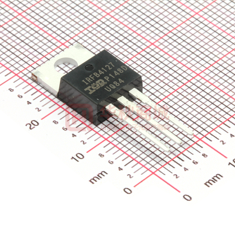

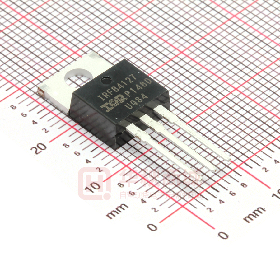

    通孔 N 通道 200 V 76A(Tc) 375W(Tc) TO-220AB
IRFB4127PBF 数据手册
PD -97136A IRFB4127PbF HEXFET® Power MOSFET Applications l High Efficiency Synchronous Rectification in SMPS l Uninterruptible Power Supply l High Speed Power Switching l Hard Switched and High Frequency Circuits VDSS RDS(on) typ. max. ID D G S Benefits l Improved Gate, Avalanche and Dynamic dV/dt Ruggedness l Fully Characterized Capacitance and Avalanche SOA l Enhanced body diode dV/dt and dI/dt Capability l Lead-Free G D 200V 17m: 20m: 76A S TO-220AB G D S Gate Drain Source Absolute Maximum Ratings Symbol ID @ TC = 25°C Parameter Max. Continuous Drain Current, VGS @ 10V Units 76 ID @ TC = 100°C Continuous Drain Current, VGS @ 10V 54 IDM Pulsed Drain Current c 300 PD @TC = 25°C Maximum Power Dissipation 375 W Linear Derating Factor 2.5 VGS Gate-to-Source Voltage ± 20 W/°C V dv/dt TJ Peak Diode Recovery e 57 Operating Junction and -55 to + 175 TSTG Storage Temperature Range A V/ns °C 300 Soldering Temperature, for 10 seconds (1.6mm from case) 10lbxin (1.1Nxm) Mounting torque, 6-32 or M3 screw Avalanche Characteristics EAS (Thermally limited) Single Pulse Avalanche Energy d IAR Avalanche Current c EAR Repetitive Avalanche Energy f mJ 250 See Fig. 14, 15, 22a, 22b, A mJ Thermal Resistance Typ. Max. RθJC Symbol Junction-to-Case j ––– 0.4 RθCS Case-to-Sink, Flat Greased Surface 0.50 ––– RθJA Junction-to-Ambient ij ––– 62 www.irf.com Parameter Units °C/W 1 8/28/08 IRFB4127PbF Static @ TJ = 25°C (unless otherwise specified) Symbol Parameter V(BR)DSS ΔV(BR)DSS/ΔTJ RDS(on) VGS(th) IDSS Drain-to-Source Breakdown Voltage Breakdown Voltage Temp. Coefficient Static Drain-to-Source On-Resistance Gate Threshold Voltage Drain-to-Source Leakage Current IGSS RG(int) Min. Typ. Max. Units Gate-to-Source Forward Leakage Gate-to-Source Reverse Leakage 200 ––– ––– 3.0 ––– ––– ––– ––– ––– 0.23 17 ––– ––– ––– ––– ––– ––– ––– 20 5.0 20 250 100 -100 Internal Gate Resistance ––– 3.0 ––– Conditions V VGS = 0V, ID = 250μA V/°C Reference to 25°C, ID = 5mAc mΩ VGS = 10V, ID = 44A f V VDS = VGS, ID = 250μA μA VDS = 200V, VGS = 0V VDS = 200V, VGS = 0V, TJ = 125°C nA VGS = 20V VGS = -20V Ω Dynamic @ TJ = 25°C (unless otherwise specified) Symbol gfs Qg Qgs Qgd Qsync td(on) tr td(off) tf Ciss Coss Crss Coss eff. (ER) Coss eff. (TR) Parameter Min. Typ. Max. Units Forward Transconductance Total Gate Charge Gate-to-Source Charge Gate-to-Drain ("Miller") Charge Total Gate Charge Sync. (Qg - Qgd) 79 ––– ––– ––– ––– Turn-On Delay Time ––– Rise Time ––– Turn-Off Delay Time ––– Fall Time ––– Input Capacitance ––– Output Capacitance ––– Reverse Transfer Capacitance ––– Effective Output Capacitance (Energy Related)h ––– ––– Effective Output Capacitance (Time Related)g ––– 100 30 31 69 17 18 56 22 5380 410 86 360 590 ––– 150 ––– ––– ––– ––– ––– ––– ––– ––– ––– ––– ––– ––– S nC ns pF Conditions VDS = 50V, ID = 44A ID = 44A VDS = 100V VGS = 10V f ID = 44A, VDS =0V, VGS = 10V VDD = 130V ID = 44A RG = 2.7Ω VGS = 10V f VGS = 0V VDS = 50V ƒ = 1.0MHz VGS = 0V, VDS = 0V to 160V h VGS = 0V, VDS = 0V to 160V g Diode Characteristics Symbol Parameter Min. Typ. Max. Units IS Continuous Source Current ––– ––– 76 ISM (Body Diode) Pulsed Source Current ––– ––– 300 VSD trr (Body Diode)c Diode Forward Voltage Reverse Recovery Time Qrr Reverse Recovery Charge IRRM ton Reverse Recovery Current Forward Turn-On Time Notes:  Repetitive rating; pulse width limited by max. junction temperature. ‚ Limited by TJmax, starting TJ = 25°C, L = 0.26mH RG = 25Ω, IAS = 44A, VGS =10V. Part not recommended for use above this value . ƒ ISD ≤ 44A, di/dt ≤ 760A/μs, VDD ≤ V(BR)DSS, TJ ≤ 175°C. „ Pulse width ≤ 400μs; duty cycle ≤ 2%. 2 A Conditions MOSFET symbol showing the integral reverse D G p-n junction diode. TJ = 25°C, IS = 44A, VGS = 0V f TJ = 25°C VR = 100V, IF = 44A TJ = 125°C di/dt = 100A/μs f TJ = 25°C S ––– ––– 1.3 V ––– 136 ––– ns ––– 139 ––– ––– 458 ––– nC TJ = 125°C ––– 688 ––– ––– 8.3 ––– A TJ = 25°C Intrinsic turn-on time is negligible (turn-on is dominated by LS+LD) … Coss eff. (TR) is a fixed capacitance that gives the same charging time as Coss while VDS is rising from 0 to 80% VDSS. † Coss eff. (ER) is a fixed capacitance that gives the same energy as Coss while VDS is rising from 0 to 80% VDSS. ‡ When mounted on 1" square PCB (FR-4 or G-10 Material). For recom mended footprint and soldering techniques refer to application note #AN-994. ˆ Rθ is measured at TJ approximately 90°C www.irf.com IRFB4127PbF 1000 1000 VGS 15V 10V 8.0V 7.0V 6.0V 5.5V 5.0V 4.5V 100 10 BOTTOM 1 0.1 ≤ 60μs PULSE WIDTH Tj = 25°C 4.5V 0.01 100 BOTTOM 10 4.5V 1 ≤ 60μs PULSE WIDTH Tj = 175°C 0.1 0.1 1 10 100 0.1 VDS , Drain-to-Source Voltage (V) 10 100 Fig 2. Typical Output Characteristics 3.5 1000 ≤ 60μs PULSE WIDTH 100 10 TJ = 25°C 1 0.1 4.0 5.0 6.0 7.0 VGS = 10V 3.0 2.5 (Normalized) TJ = 175°C 3.0 ID = 44A RDS(on) , Drain-to-Source On Resistance VDS = 50V ID, Drain-to-Source Current(Α) 1 VDS , Drain-to-Source Voltage (V) Fig 1. Typical Output Characteristics 2.0 1.5 1.0 0.5 8.0 -60 -40 -20 VGS, Gate-to-Source Voltage (V) 8000 Ciss 4000 2000 Coss Crss 1 ID= 44A VDS = 160V VDS = 100V 12 VDS = 40V 8 4 0 10 100 VDS , Drain-to-Source Voltage (V) Fig 5. Typical Capacitance vs. Drain-to-Source Voltage www.irf.com Fig 4. Normalized On-Resistance vs. Temperature VGS, Gate-to-Source Voltage (V) Coss = Cds + Cgd 0 20 40 60 80 100 120 140 160 180 16 VGS = 0V, f = 1 MHZ Ciss = Cgs + Cgd, Cds SHORTED Crss = Cgd 6000 0 TJ , Junction Temperature (°C) Fig 3. Typical Transfer Characteristics C, Capacitance (pF) VGS 15V 10V 8.0V 7.0V 6.0V 5.5V 5.0V 4.5V TOP ID, Drain-to-Source Current (A) ID, Drain-to-Source Current (A) TOP 0 20 40 60 80 100 120 QG Total Gate Charge (nC) Fig 6. Typical Gate Charge vs. Gate-to-Source Voltage 3 IRFB4127PbF 1000 ID, Drain-to-Source Current (A) ISD , Reverse Drain Current (A) 1000 TJ = 175°C 100 10 TJ = 25°C 1 OPERATION IN THIS AREA LIMITED BY R DS (on) 100μsec 100 1msec 10 10msec 1 Tc = 25°C Tj = 175°C Single Pulse VGS = 0V 0.0 0.2 0.4 0.6 0.8 1.0 1.2 1 1.4 60 40 20 0 75 100 125 150 175 V(BR)DSS, Drain-to-Source Breakdown Voltage (V) ID , Drain Current (A) 80 50 1000 260 Id = 5mA 240 220 200 180 -60 -40 -20 0 20 40 60 80 100120140160180 TC , CaseTemperature (°C) TJ , Temperature ( °C ) Fig 9. Maximum Drain Current vs. Case Temperature Fig 10. Drain-to-Source Breakdown Voltage 1000 EAS, Single Pulse Avalanche Energy (mJ) 8.0 6.0 Energy (μJ) 100 Fig 8. Maximum Safe Operating Area Fig 7. Typical Source-Drain Diode Forward Voltage 25 10 VDS , Drain-toSource Voltage (V) VSD, Source-to-Drain Voltage (V) 4.0 2.0 0.0 ID 8.2A 13A BOTTOM 44A TOP 800 600 400 200 0 0 40 80 120 160 VDS, Drain-to-Source Voltage (V) Fig 11. Typical COSS Stored Energy 4 DC 0.1 0.1 200 25 50 75 100 125 150 175 Starting TJ, Junction Temperature (°C) Fig 12. Maximum Avalanche Energy Vs. DrainCurrent www.irf.com IRFB4127PbF Thermal Response ( Z thJC ) 1 D = 0.50 0.1 0.20 0.10 τJ 0.05 0.01 R1 R1 τJ τ1 R2 R2 R3 R3 R4 R4 τC τ2 0.02 τ1 0.01 Ci= τi/Ri Ci i/Ri τ3 τ2 τ4 τ3 τ4 τ Ri (°C/W) 0.02 0.083333 0.181667 0.113333 τι (sec) 0.000019 0.000078 0.001716 0.008764 Notes: 1. Duty Factor D = t1/t2 2. Peak Tj = P dm x Zthjc + Tc SINGLE PULSE ( THERMAL RESPONSE ) 0.001 1E-006 1E-005 0.0001 0.001 0.01 0.1 t1 , Rectangular Pulse Duration (sec) Fig 13. Maximum Effective Transient Thermal Impedance, Junction-to-Case 100 Allowed avalanche Current vs avalanche pulsewidth, tav, assuming ΔTj = 150°C and Tstart =25°C (Single Pulse) Avalanche Current (A) Duty Cycle = Single Pulse 0.01 10 0.05 0.10 1 Allowed avalanche Current vs avalanche pulsewidth, tav, assuming ΔΤ j = 25°C and Tstart = 150°C. 0.1 1.0E-06 1.0E-05 1.0E-04 1.0E-03 1.0E-02 1.0E-01 tav (sec) Fig 14. Typical Avalanche Current vs.Pulsewidth EAR , Avalanche Energy (mJ) 250 Notes on Repetitive Avalanche Curves , Figures 14, 15: (For further info, see AN-1005 at www.irf.com) 1. Avalanche failures assumption: Purely a thermal phenomenon and failure occurs at a temperature far in excess of Tjmax. This is validated for every part type. 2. Safe operation in Avalanche is allowed as long asTjmax is not exceeded. 3. Equation below based on circuit and waveforms shown in Figures 16a, 16b. 4. PD (ave) = Average power dissipation per single avalanche pulse. 5. BV = Rated breakdown voltage (1.3 factor accounts for voltage increase during avalanche). 6. Iav = Allowable avalanche current. 7. ΔT = Allowable rise in junction temperature, not to exceed Tjmax (assumed as 25°C in Figure 14, 15). tav = Average time in avalanche. D = Duty cycle in avalanche = tav ·f ZthJC(D, tav) = Transient thermal resistance, see Figures 13) TOP Single Pulse BOTTOM 1% Duty Cycle ID = 44A 200 150 100 50 0 25 50 75 100 125 150 175 Starting TJ , Junction Temperature (°C) PD (ave) = 1/2 ( 1.3·BV·Iav) = DT/ ZthJC Iav = 2DT/ [1.3·BV·Zth] EAS (AR) = PD (ave)·tav Fig 15. Maximum Avalanche Energy vs. Temperature www.irf.com 5 IRFB4127PbF 50 ID = 1.0A ID = 1.0mA 5.0 40 ID = 250μA 4.0 IRRM - (A) VGS(th) Gate threshold Voltage (V) 6.0 3.0 2.0 30 20 IF = 29A VR = 100V 10 1.0 TJ = 125°C TJ = 25°C 0 -75 -50 -25 0 25 50 75 100 125 150 175 100 200 300 400 500 600 700 800 900 1000 TJ , Temperature ( °C ) dif / dt - (A / μs) Fig. 17 - Typical Recovery Current vs. dif/dt 60 3000 50 2500 40 2000 QRR - (nC) IRRM - (A) Fig 16. Threshold Voltage Vs. Temperature 30 20 10 0 1500 1000 IF = 44A VR = 100V IF = 29A VR = 100V 500 TJ = 125°C TJ = 25°C TJ = 125°C TJ = 25°C 0 100 200 300 400 500 600 700 800 900 1000 100 200 300 400 500 600 700 800 900 1000 dif / dt - (A / μs) dif / dt - (A / μs) Fig. 18 - Typical Recovery Current vs. dif/dt Fig. 19 - Typical Stored Charge vs. dif/dt 3000 2500 QRR - (nC) 2000 1500 1000 500 0 IF = 44A VR = 100V TJ = 125°C TJ = 25°C 100 200 300 400 500 600 700 800 900 1000 dif / dt - (A / μs) 6 Fig. 20 - Typical Stored Charge vs. dif/dt www.irf.com IRFB4127PbF Driver Gate Drive D.U.T ƒ - ‚ - - „ * D.U.T. ISD Waveform Reverse Recovery Current +  RG • • • • dv/dt controlled by RG Driver same type as D.U.T. ISD controlled by Duty Factor "D" D.U.T. - Device Under Test VDD P.W. Period VGS=10V Circuit Layout Considerations • Low Stray Inductance • Ground Plane • Low Leakage Inductance Current Transformer + D= Period P.W. + + - Body Diode Forward Current di/dt D.U.T. VDS Waveform Diode Recovery dv/dt Re-Applied Voltage Body Diode VDD Forward Drop Inductor Current Inductor Curent ISD Ripple ≤ 5% * VGS = 5V for Logic Level Devices Fig 21. Peak Diode Recovery dv/dt Test Circuit for N-Channel HEXFET® Power MOSFETs V(BR)DSS 15V DRIVER L VDS tp D.U.T RG + V - DD IAS VGS 20V A 0.01Ω tp I AS Fig 22a. Unclamped Inductive Test Circuit RD VDS Fig 22b. Unclamped Inductive Waveforms VDS 90% VGS D.U.T. RG + - VDD V10V GS 10% VGS Pulse Width ≤ 1 µs Duty Factor ≤ 0.1 % td(on) Fig 23a. Switching Time Test Circuit tr t d(off) Fig 23b. Switching Time Waveforms Id Current Regulator Same Type as D.U.T. Vds Vgs 50KΩ 12V tf .2μF .3μF D.U.T. + V - DS Vgs(th) VGS 3mA IG ID Current Sampling Resistors Fig 24a. Gate Charge Test Circuit www.irf.com Qgs1 Qgs2 Qgd Qgodr Fig 24b. Gate Charge Waveform 7 IRFB4127PbF TO-220AB Package Outline Dimensions are shown in millimeters (inches) TO-220AB Part Marking Information EXAMPLE: T HIS IS AN IRF1010 LOT CODE 1789 AS SEMBLED ON WW 19, 2000 IN T HE AS SEMBLY LINE "C" Note: "P" in as sembly line position indicates "Lead - Free" INT ERNAT IONAL RECT IFIER LOGO AS SEMBLY LOT CODE PART NUMBER DAT E CODE YEAR 0 = 2000 WEEK 19 LINE C TO-220AB packages are not recommended for Surface Mount Application. Note: For the most current drawing please refer to IR website at: http://www.irf.com/package/ Data and specifications subject to change without notice. This product has been designed and qualified for the Industrial market. Qualification Standards can be found on IR’s Web site. 8 IR WORLD HEADQUARTERS: 233 Kansas St., El Segundo, California 90245, USA Tel: (310) 252-7105 TAC Fax: (310) 252-7903 Visit us at www.irf.com for sales contact information. 08/08 www.irf.com IMPORTANT NOTICE The information given in this document shall in no event be regarded as a guarantee of conditions or characteristics (“Beschaffenheitsgarantie”) . With respect to any examples, hints or any typical values stated herein and/or any information regarding the application of the product, Infineon Technologies hereby disclaims any and all warranties and liabilities of any kind, including without limitation warranties of non-infringement of intellectual property rights of any third party. In addition, any information given in this document is subject to customer’s compliance with its obligations stated in this document and any applicable legal requirements, norms and standards concerning customer’s products and any use of the product of Infineon Technologies in customer’s applications. The data contained in this document is exclusively intended for technically trained staff. It is the responsibility of customer’s technical departments to evaluate the suitability of the product for the intended application and the completeness of the product information given in this document with respect to such application. For further information on the product, technology, delivery terms and conditions and prices please contact your nearest Infineon Technologies office (www.infineon.com). WARNINGS Due to technical requirements products may contain dangerous substances. For information on the types in question please contact your nearest Infineon Technologies office. Except as otherwise explicitly approved by Infineon Technologies in a written document signed by authorized representatives of Infineon Technologies, Infineon Technologies’ products may not be used in any applications where a failure of the product or any consequences of the use thereof can reasonably be expected to result in personal injury.
